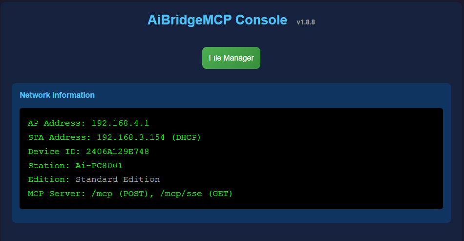

AiBridgeMCP v1.8.8a Release Preparation
■ UI & Display Unification
  • Added "Ai-" prefix to MCP tool responses
    - get_system_info: "Ai-Observatory"
    - get_network_status: "Ai-Observatory"
  • Unified all "Location" references to "Station"
    - Web UI Control Panel
    - File Manager labels
    - Serial output (INFO/VER)
  • Refreshed system subtitle
    - Old: "Serial AI Bridge"
    - New: "Bridge Across Decades"

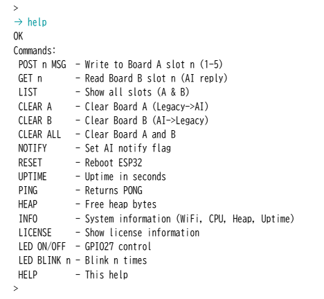

      AiBridgeMCP Nano implements two primary features:
      1. Retro-Micro AI Chat (Serial Bridge)
      This allows 1980s legacy computers—like CP/M machines, Apple II, and MSX—to "chat" directly with modern Large Language Models (LLMs). If you grew up with these 8-bit legends, there's something surreal and rewarding about seeing a Z80-based system discussing code or philosophy with a state-of-the-art AI.
