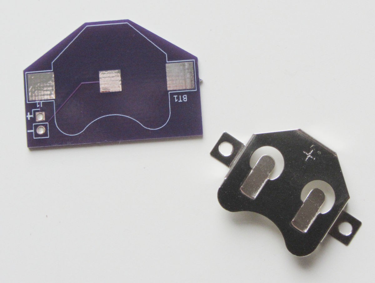

    Backup battery
    The backup battery is based on a CR2032 3V Lithium cell. It uses a custom board and a clip purchased in China. It is very compact, cheap and easy to assemble.
    backupBatteryClipParts.jpg:

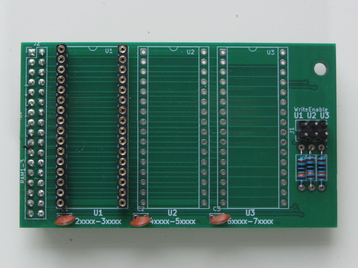

    The Extension board is assembled and the plan is to fill it with data mimicking an 1 M Byte ROM, which should be recognized as drive K: on the PX-4. The other memory ranges are not supported by the Operating System, but can be used as extra non-volatile memory. One option is to keep backups for the active RAM Disk.

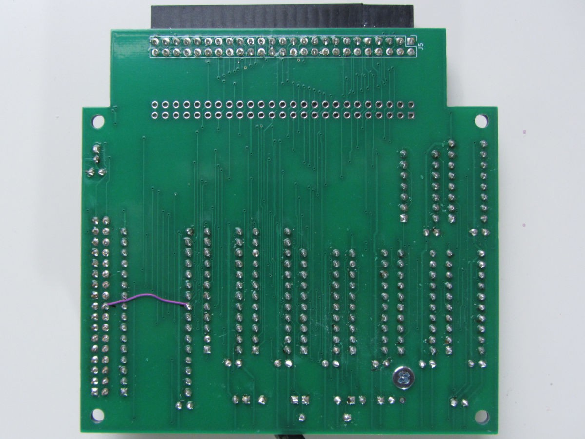

    Board correction
    When designing the new PX-8 board, it was found /OE line is not connected. That is what you get if you use more than one name for the same signal. The wire is from J2-26 to U11-24 (the /OE pin).
    px-4RD_OEbodgeWire.jpg:

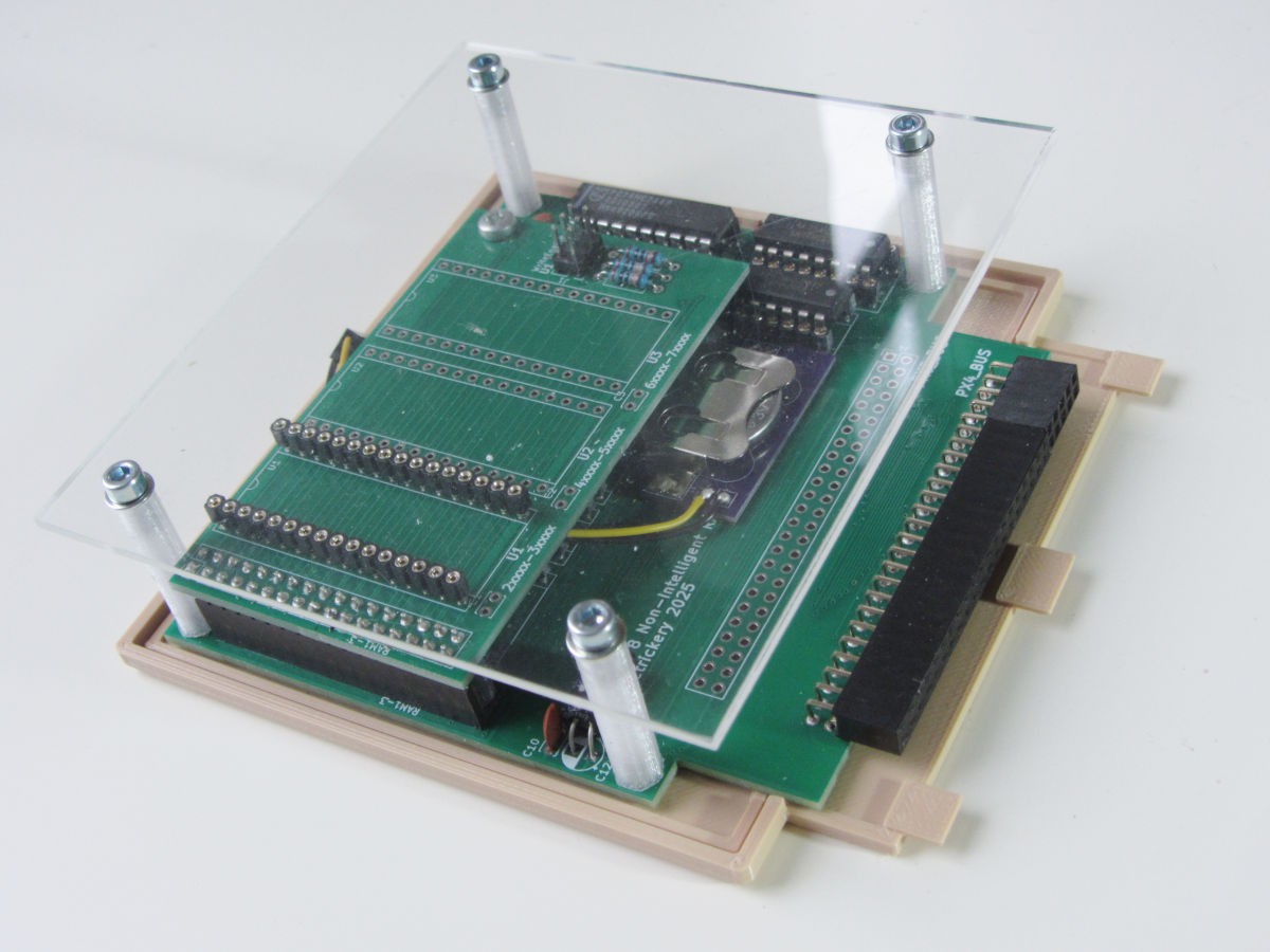

    The current case is large enough to contain the base RAM Disk board, Extension board and backup battery. For just the base board a lower case could be designed, but this is left to the user :-).

  • Completed the cases (first version)
    fjkraan02/28/2026 at 11:28 0 comments
    The cases are finally completed, alas not in the typical Epson-non-white, but a kind of beige (Devil's Design, PETG). The PX-4 version is Ok, but the PX-8 case (and actually the board) are less optimal. It is too wide and partially obscures the RS-232c port and the BCR port. Nothing that a board and case redesign can't fix, but one case for both the PX-4 and PX-8 was worth the try. The circuit is the same, only the bus pin-out differs.
