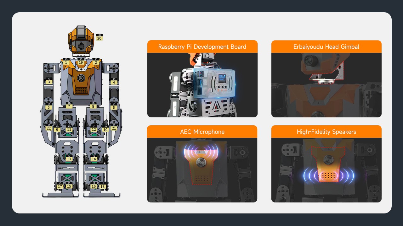

  • Degrees of Freedom (22 DOF) Breakdown:
    • Head: 2 DOF (Pan/Tilt for vision tracking)
    • Shoulders/Arms: 2 DOF (Shoulder) + 4 DOF (Arms) + 2 DOF (Hands)
    • Lower Body: 10 DOF (Legs) + 2 DOF (Feet)
  • Actuation: Powered by XRS300 High-Voltage Serial Bus Servos.
    • Stall Torque: ≥30kgf.cm @ 12V.
    • Feedback: Real-time position, temperature, and load monitoring via the serial protocol.
3. Electronic Architecture & Sensing
The system adopts a master-slave control architecture to balance high-level AI reasoning and low-level motor control.
  • Compute Brain: Raspberry Pi 4B (4GB RAM) running Ubuntu 18.04.
  • Motion Controller: PWR.ROSBOT.X dedicated driver board. It handles DC-DC power management (SY8120ABC), audio amplification, and acts as a hardware abstraction layer for the 22 servos.
  • Sensing Suite:
    • IMU: MPU6050 6-axis gyroscope for attitude estimation and gait stabilization.
    • Vision: 1080P 120° Wide-angle USB camera (Robot-Eye 4.0).
    • Audio: High-precision AEC (Acoustic Echo Cancellation) Microphone + 1W Speaker for voice interaction.

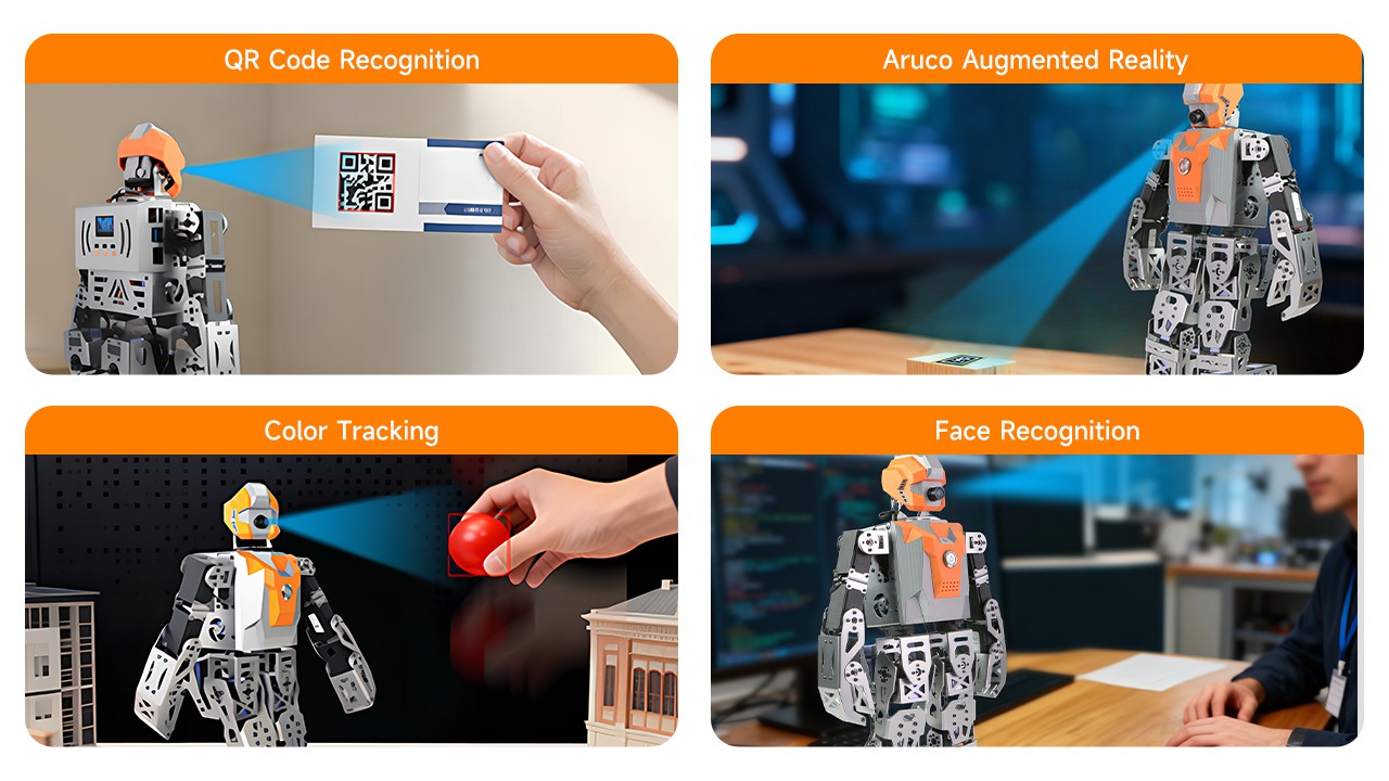

  • Vision Pipeline: OpenCV-based modules for face recognition, color tracking, and QR code localization.

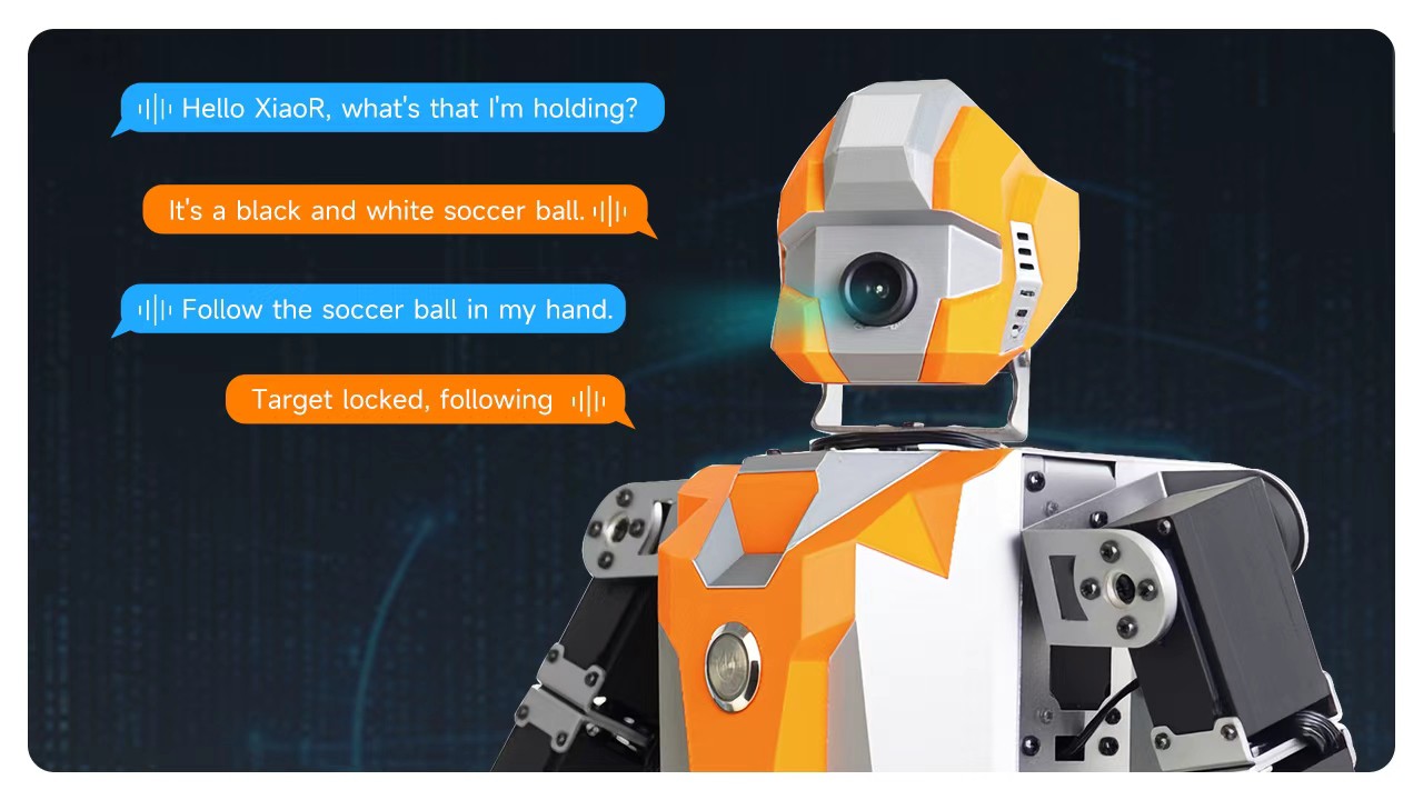

The defining feature of Samuroid is its Multimodal AI Integration.
By connecting to DeepSeek and Doubao LLM APIs, the robot performs semantic parsing of natural language. Instead of hard-coded commands, the robot can understand intent:
  • Input: "I am tired, show me some fun."
  • Process: LLM interprets "tired" -> selects "Dance" action group -> triggers ROS Action Server.
  • Feedback: Real-time status report via the integrated voice system.

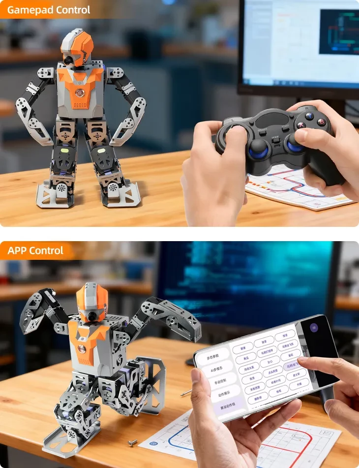

  • Communication: Dual-band WiFi (2.4G/5G), Bluetooth 5.0, PS2 Wireless Controller.

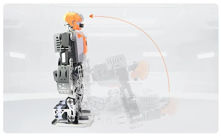

    • 22 Degrees of Freedom (DOF): Full human-like range of motion for complex maneuvers and rapid recovery from falls.

    For perception, SamuRoid integrates a 1080P wide-angle camera combined with OpenCV-based computer vision algorithms. We are experimenting with several AI vision capabilities including:
    - face recognition
    - color recognition
    - QR code detection
    - object tracking
    - autonomous ball tracking and kicking

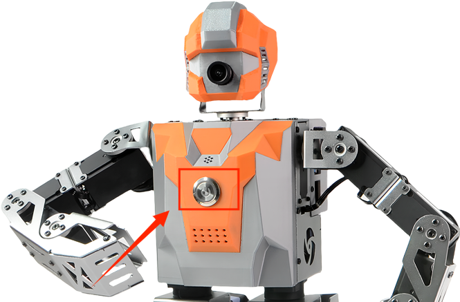

  • 1
    Instructions for turning the device on and off
    a. Locate the circular main power switch on the chest of the SamuRoid humanoid robot.
    b. Press the switch lightly to turn it on. Once powered on, the switch will illuminate with a red indicator light, signifying that the power is connected.
    c. Please wait patiently for approximately 40 seconds while the robot's built-in Ubuntu operating system starts up.
    d. When you hear the voice prompt "Mech Warrior ready!", it means the robot has entered standby mode and is ready for operation.
