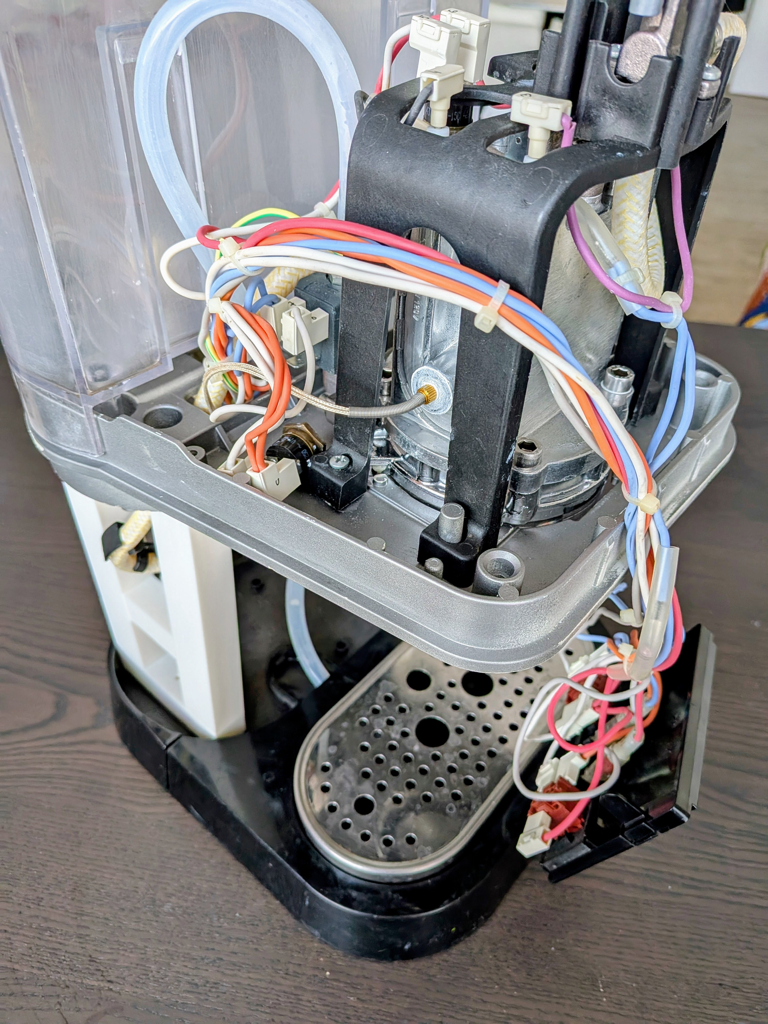

    The Overhaul
    Since the last update, a lot of hardware work has been happening on the bench. I picked up a **Gaggia New Baby 06** to serve as the new testbed for the Oximite system.
    The first order of business was a complete teardown and overhaul of the machine to ensure a clean baseline. Overall, the restoration was a huge success, with the only lingering mechanical issue being a stubborn Over Pressure Valve (OPV) that currently isn't working as it should. I'll need to circle back to that, but the machine is otherwise structurally sound.
    Making Room for Brains
    To actually test the custom electronics, I needed space inside the chassis. I ended up 3D printing a set of custom pylons to hold the main mounting plate. This simple mod effectively creates a lower "basement" compartment giving me plenty of clearance to securely install the prototype control boards and run wiring without interfering with the high-voltage or wet components.

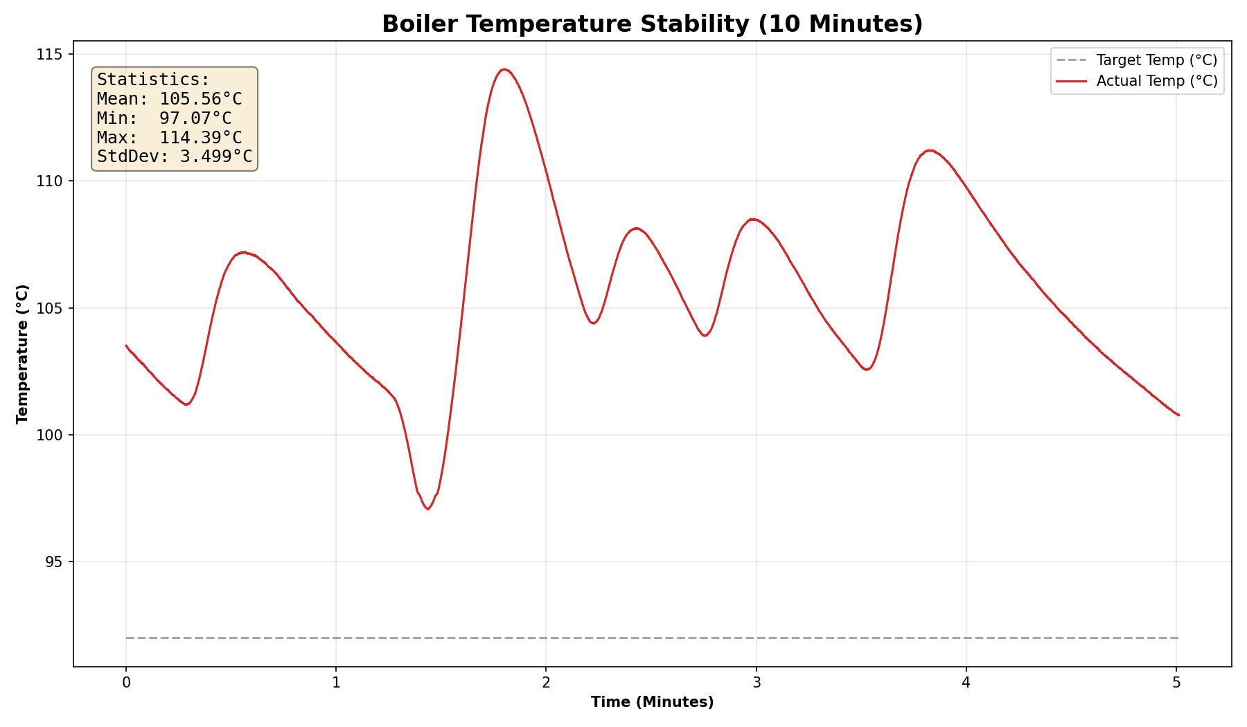

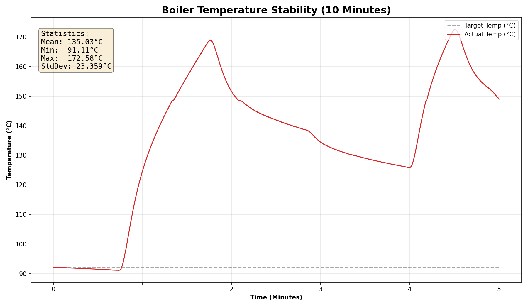

    Data Logging the Factory Thermostats
    Before stripping out the original control loop, I wanted to understand exactly how the stock machine behaves. I installed an NTC thermistor and spent some time logging the thermal curves driven by the factory brewing and steam thermostats (which are an absolute mechanical beauty to look at).
    This data logging led to a fascinating realization about my software design, and raised some great engineering questions for the next phase.
    The "Burst Mode" Dilemma: To Boost or Not to Boost?
    In the current iteration of my software, I implemented a "burst mode"—a feature that artificially spikes the heating power the moment a shot begins to compensate for the influx of cold water into the boiler.
    However, looking at the thermal graphs of the stock machine, I'm starting to think this software boost might be unnecessary. The data shows the factory setup sitting at a rather hot mean temperature of ~101°C right before a shot. As the shot starts, the water rapidly loses heat to the group head and portafilter (a drop of about 7 degrees), bringing it perfectly down to the ~94°C "sweet spot".
    As the shot progresses, the thermal losses decrease at roughly the same rate as the boiler temperature drops. It looks like the Gaggia engineers relied entirely on this natural thermal balancing act to keep the output temperature surprisingly stable!

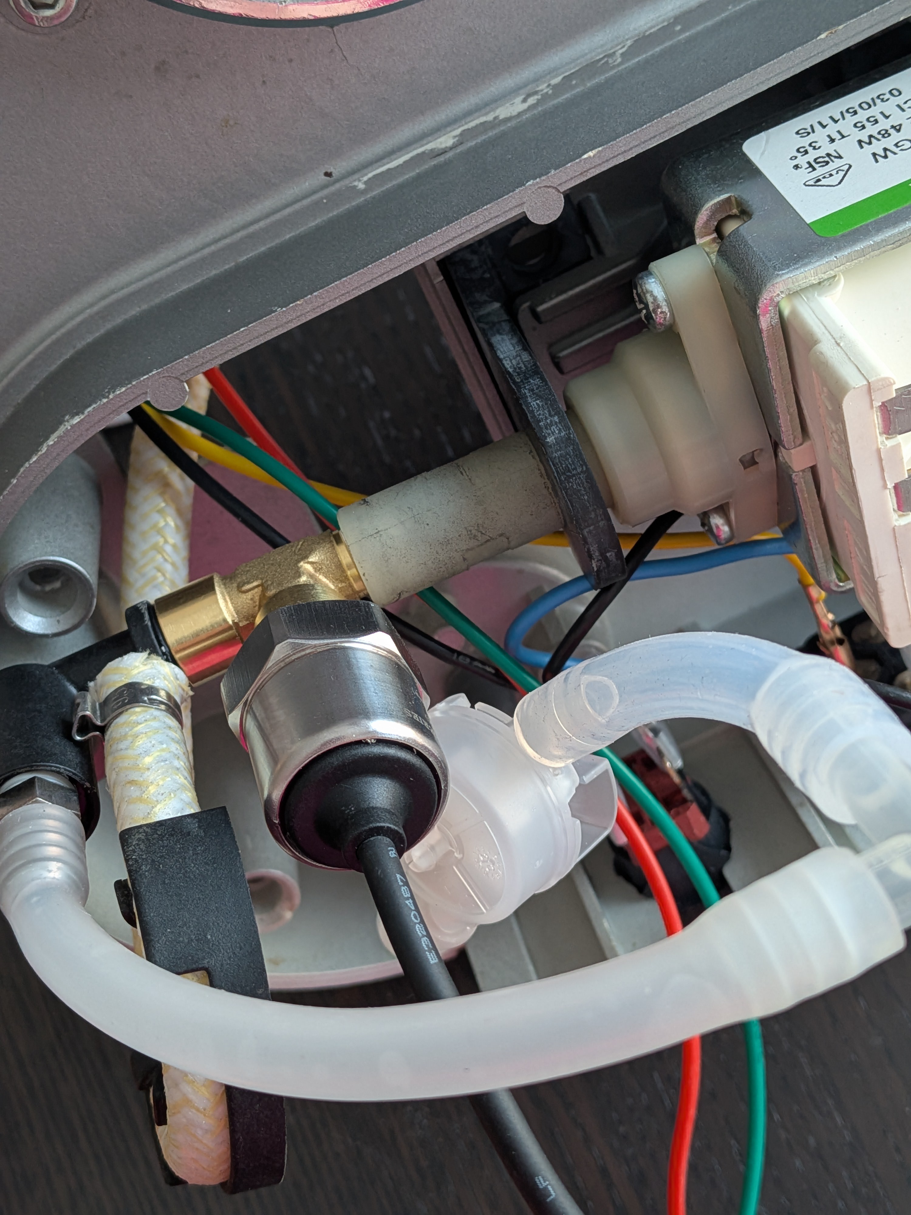

    The physical plumbing is finally coming together! I received the necessary Tee-connectors and an analog manometer, which allowed me to successfully plumb the pressure transducer into the hydraulic system.
    Here is what the test bench looks like right now:

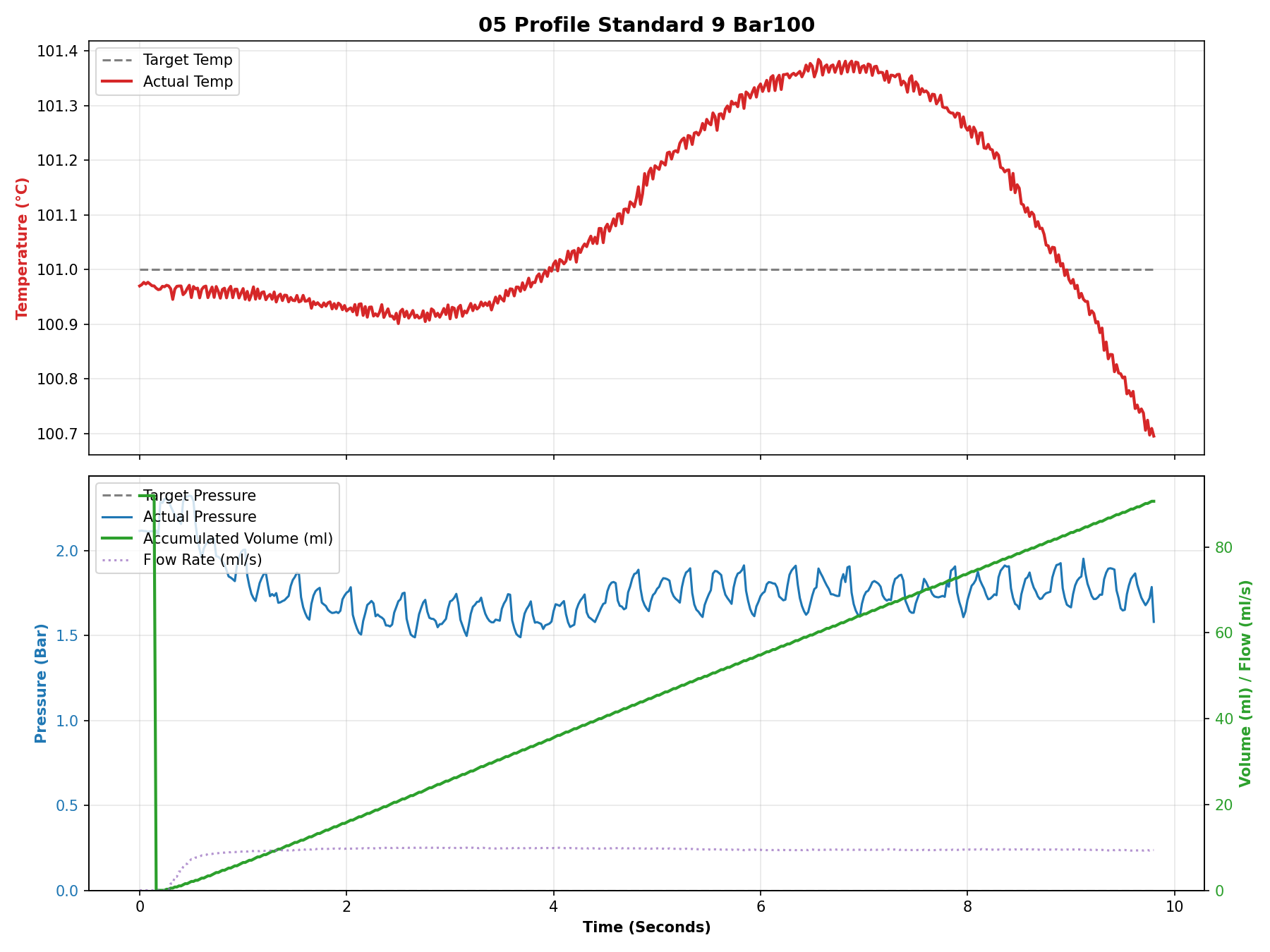

    2. Taming the Pressure (PID Control)
    With the pump behaving linearly, I closed the loop. After running some experiments with the p_kp and p_ki coefficients, I successfully brought the system under control. The machine can now rapidly hit and hold a target pressure without oscillating. (Note: Ignore the temperature line in the graph below—the NTC sensor is currently disconnected while I focus on hydraulics!)
    3. The "Shot Saver" (Dynamic Flow Limiting)
    One of the coolest software features I’ve implemented is a dynamic flow limit. In standard espresso, if your coffee puck cracks (channeling), the physical resistance disappears, the flow rate spikes, and the shot is ruined.
    I tested my safety clamp: I set a hard maximum flow limit in the active profile. As you can see in the telemetry, the exact moment the flow hits the limit, the system aggressively drops the pressure to clamp the flow rate, effectively "saving" the shot!

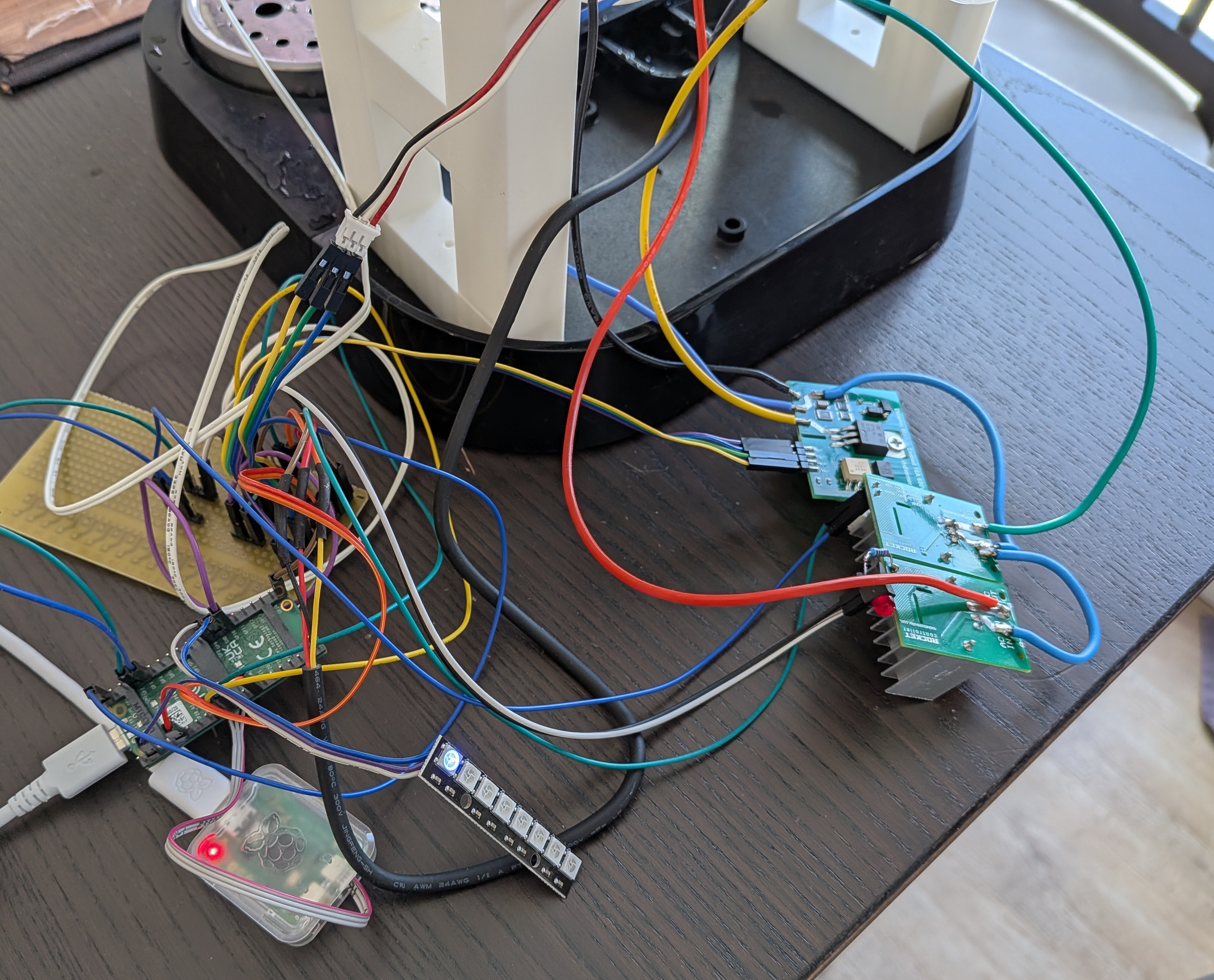

    It’s time to dive into the hardware and software that actually makes the pressure profiling possible. Controlling a vibratory water pump requires precise AC phase control. To do this, we need to detect the exact moment the AC waveform crosses zero volts, and then wait a calculated number of microseconds before firing a Triac.
    Here is the schematic I am using for the zero-cross detection and Triac firing circuit:
    And here is how the modified board turned out:
    Testing the Control Loop
    Before hooking the system up to high-pressure boiling water, I needed to verify the control loop. I set up a mock environment using a potentiometer to simulate the analog pressure transducer.
    As I twist the knob to create an artificial pressure "error," the PID controller instantly recalculates and adjusts the AC phase delay to compensate. Here is the bring-up video showing the dual-PIO system running flawlessly and maintaining stable control:
