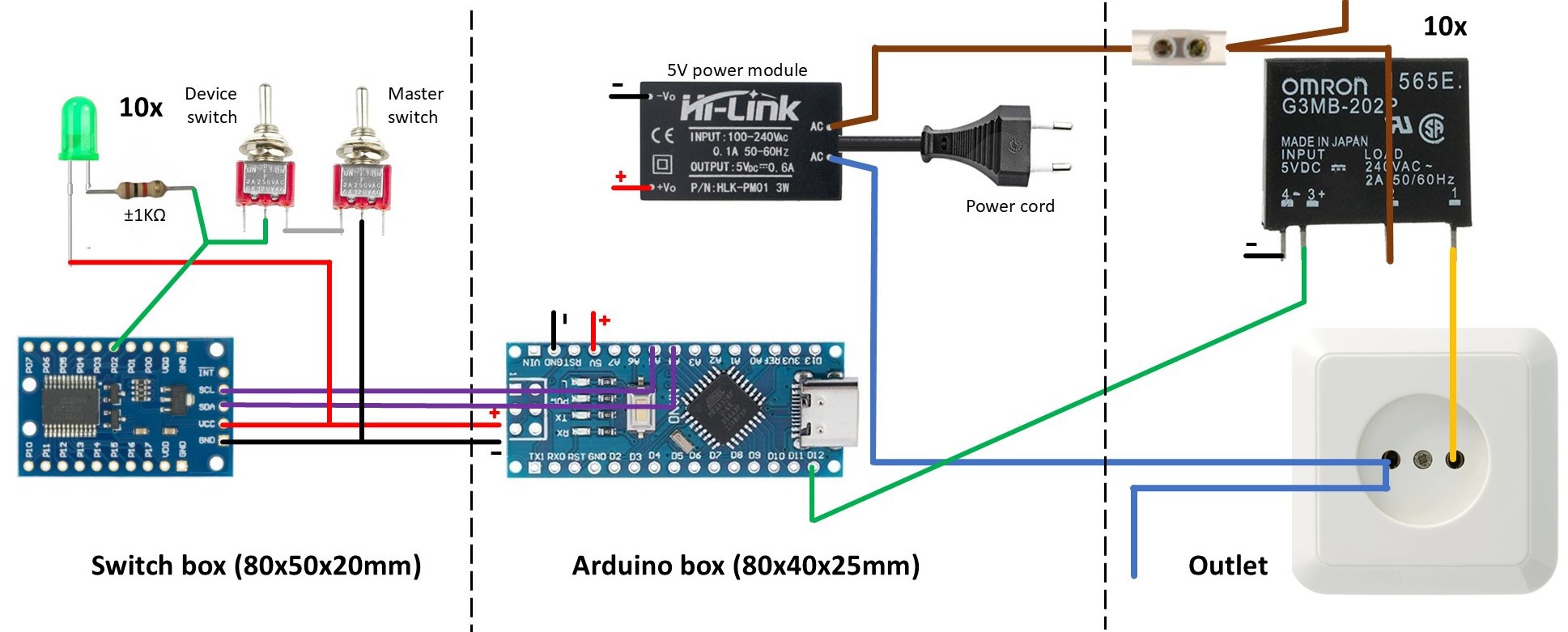

This project addresses that unconveniant issue by bringing all power control to the front of the workbench: clear, accessible switches for each device.
But the real magic is the master switch.
At the end of the day, I flip one switch and everything that’s currently on shuts down instantly. No walking along the bench, no hunting for tiny power buttons, no second-guessing myself when I lock the door.

I flip that same master switch again, and only the devices I had enabled the day before come back on automatically. Same setup, same tools, same workflow — ready to go in one click.

The system uses:
  • An Arduino-compatible controller
  • An I/O port extender for easy connection of 10 switches
  • Solid state relays to switch mains power
  • A compact switch box for user input
  • An isolated 5V power module for the control electronics
Individual switches toggle each outlet, while the master switch acts as a global power gate without losing the on/off state of each channel.
