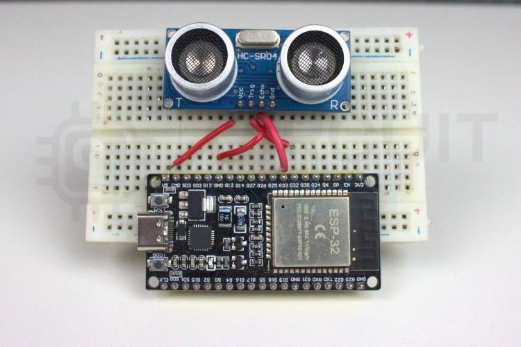

  • ESP32 development board – connects to Wi-Fi and runs your logic.
  • Ultrasonic distance sensor (e.g., HC-SR04) – detects object proximity.
  • Breadboard and jumper wires – for tidy prototyping.

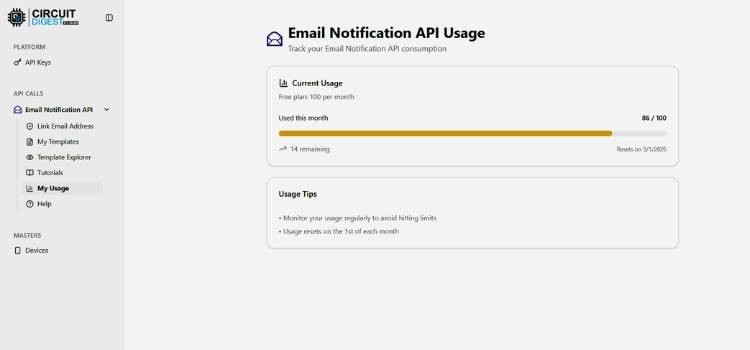

1. Register & Link Email
  1. Sign up or log into CircuitDigest Cloud.
  2. Navigate to the Email Notification API section.
  3. Add your email and verify it with the OTP sent to your inbox.
  4. Link up to five addresses and choose or create an email template.
CircuitDigest Cloud provides 80+ templates and lets you preview how your alerts will appear once delivered.

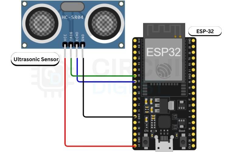

Wiring the Ultrasonic Sensor
Connect the trigger and echo pins of the sensor to two GPIOs on the ESP32 (e.g., GPIO 32 for trigger and GPIO 33 for echo). Provide proper power and ground, and verify your sensor’s voltage requirements (3.3 V or 5 V).

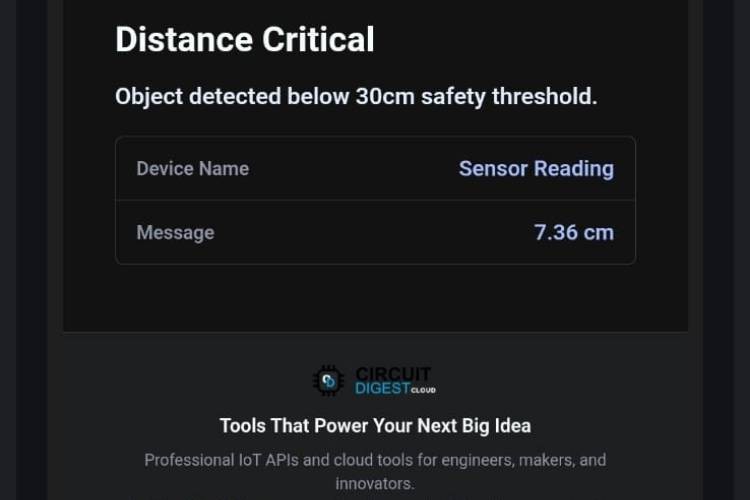

  3. If the measured value drops below your threshold (e.g., 30 cm), it triggers an email.
  4. A secure HTTPS request (JSON) is sent to the CircuitDigest Cloud Email API with your chosen template and dynamic data (like sensor values).
  5. The cloud platform handles delivery instantly to the verified email address.
