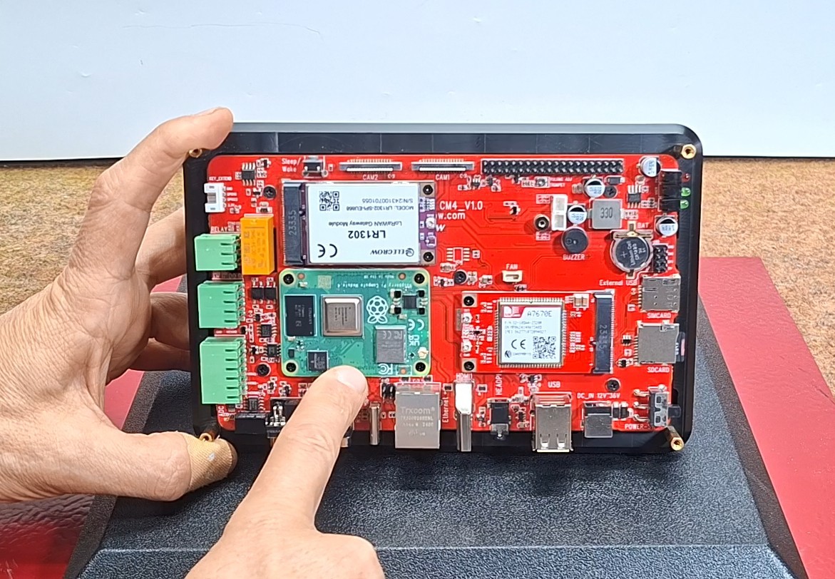

This time I will present you a very simple way to make an Internet radio with a vintage tube radio look, but with advanced functions and features. For this purpose I use the Crowpanel 7 inch Pi Terminal All-In-One Module Raspberry Pi Computer from Elecrow.
This is a robust device with industry standards that guarantees durability as well as stable and long-lasting work. I accidentally got the idea from the radiobasteleien blog, a retro-looking Internet radio that is based on the Bob Rathbone Internet Radio Project. However, I decided to make my own simple version of an internet radio based on the aforementioned display module. The hardware part as well as the housing from one of my previous projects where you can see the making process in more detail.

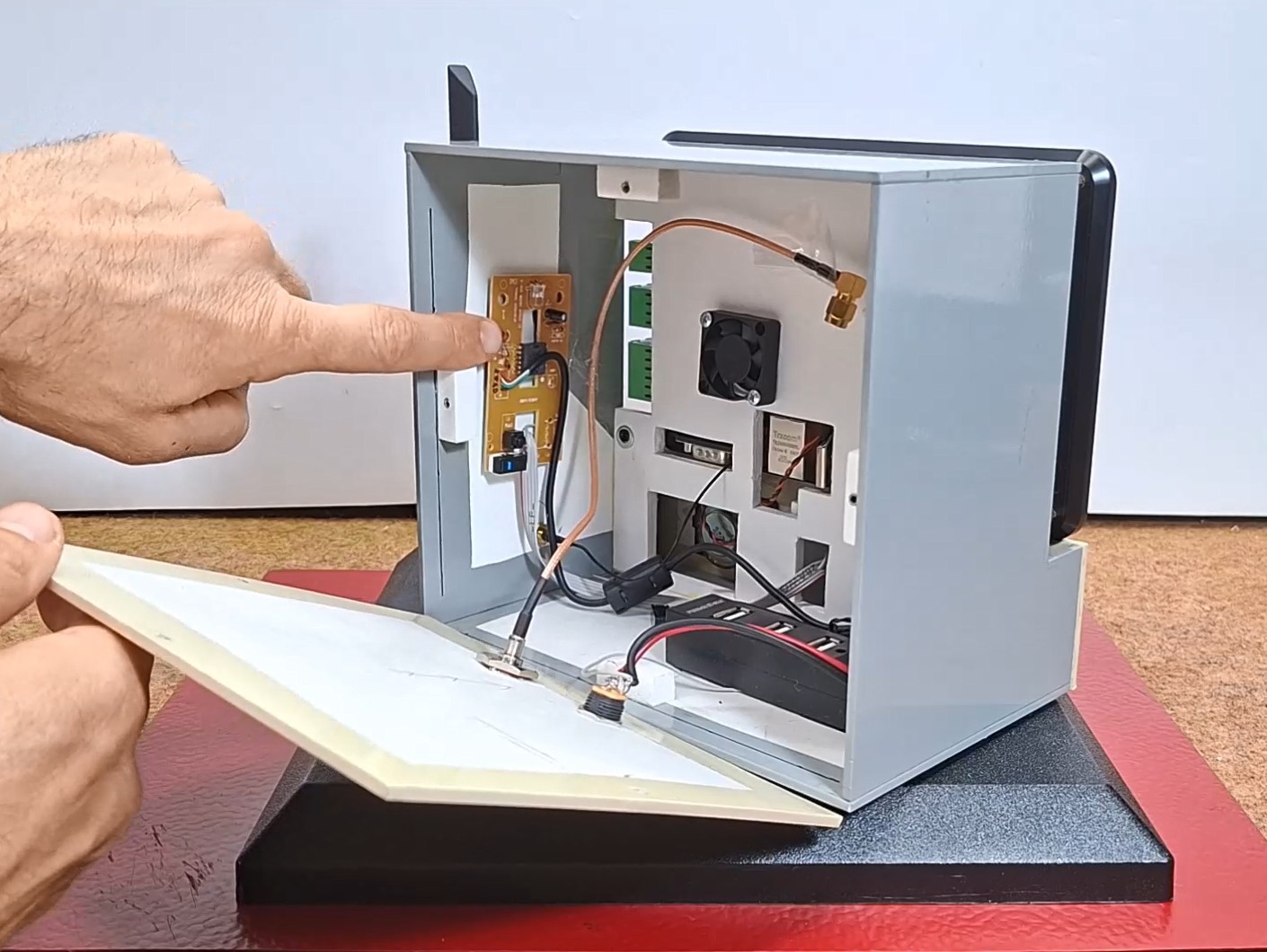

To keep the authentic retro style I use a rotary encoder that simulates the station selection button on old radios. In fact, this rotary encoder is part of an old USB mouse connected to the Raspberry Pi terminal. This simplifies both the hardware design and the software control of the rotary encoder.

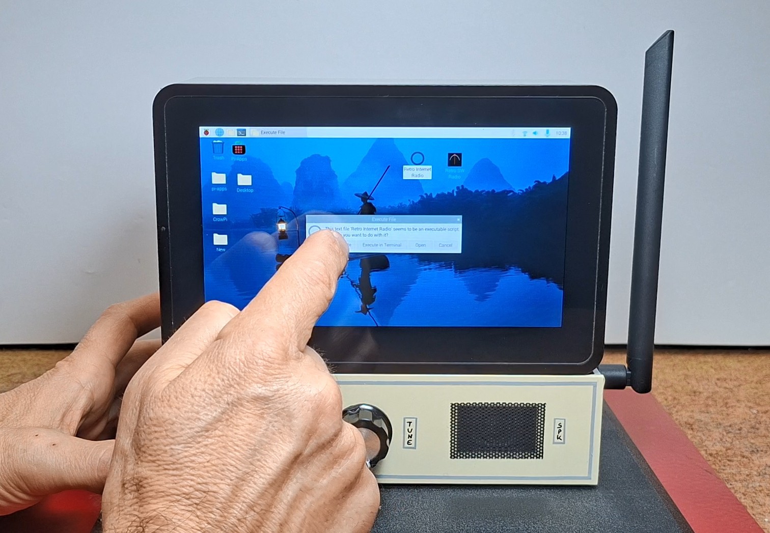

And now the most interesting part, let's see how the device works in real conditions. We start the operating system, on whose desktop there is an Internet radio icon, which is a shortcut to the python script "retro_ui". The icon is started, and the entire desktop turns into a vintage tube radio scale.
By turning the rotary encoder, the red pointer also moves. It can be noticed that the pointer stops, i.e. jumps at precisely certain places and does not move continuously. These points are the entered Internet radio stations. We enter the addresses of the desired Internet radio stations in the "stations.txt" file, which is located in "/home/pi/radio/stations.txt". The entire display (scale) is divided into as many equal parts as we have entered stations (for example, I currently have 22 stations entered). In...
