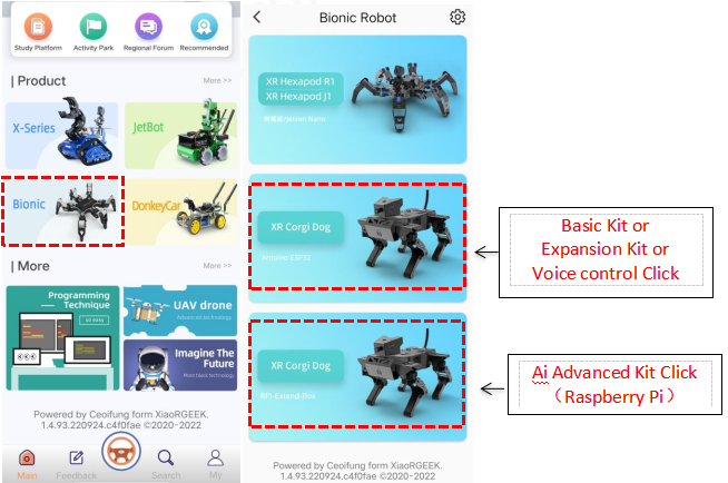

    Connecting the robot dog
    After activating the robot dog, open your phone's WLAN/Wi-Fi settings and search for nearby wireless signals. This step is the same as connecting to a wireless router normally. Find the wireless signal starting with "XiaoRGEEK_Dog" and connect to it.
    If you see a message such as "Unable to access the Internet" after connecting, this is normal because the robot dog WiFi works in local area network mode.
    Notice: If you are an AI advanced version user, you need to find and connect to the wireless signal starting with XiaoRGEEK_RPI_Extend_Box (not the wireless signal starting with XiaoRGEEK_Dog). For details on this version, please refer to “V AI Advanced Kit Expansion Box.”
    Open the APP, click "Bionic" in the product series, and then select the XR Corgi Dog to enter the control interface.
