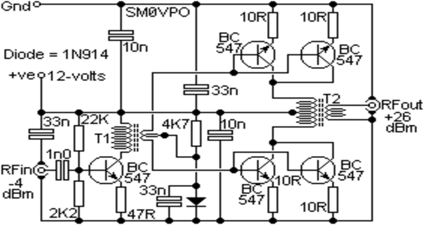

Pre amplifier
Transformer T1
  • BN43-2402
  • Primary: 14 Turns
  • Secondary: 1 + 1 Turns
Transformer T2
To drive a 50 Ohm antenna or 50 Ohm band pass filter:
  • BN43-2402
  • Primary: 12 Turns
  • Secondary: 8 + 8 Turns
To drive a final stage with MOSFETs the Turns are those of the following schematic, i.e.:
  • BN43-2402
  • Primary: 2+2 Turns
  • Secondary: 3 Turns

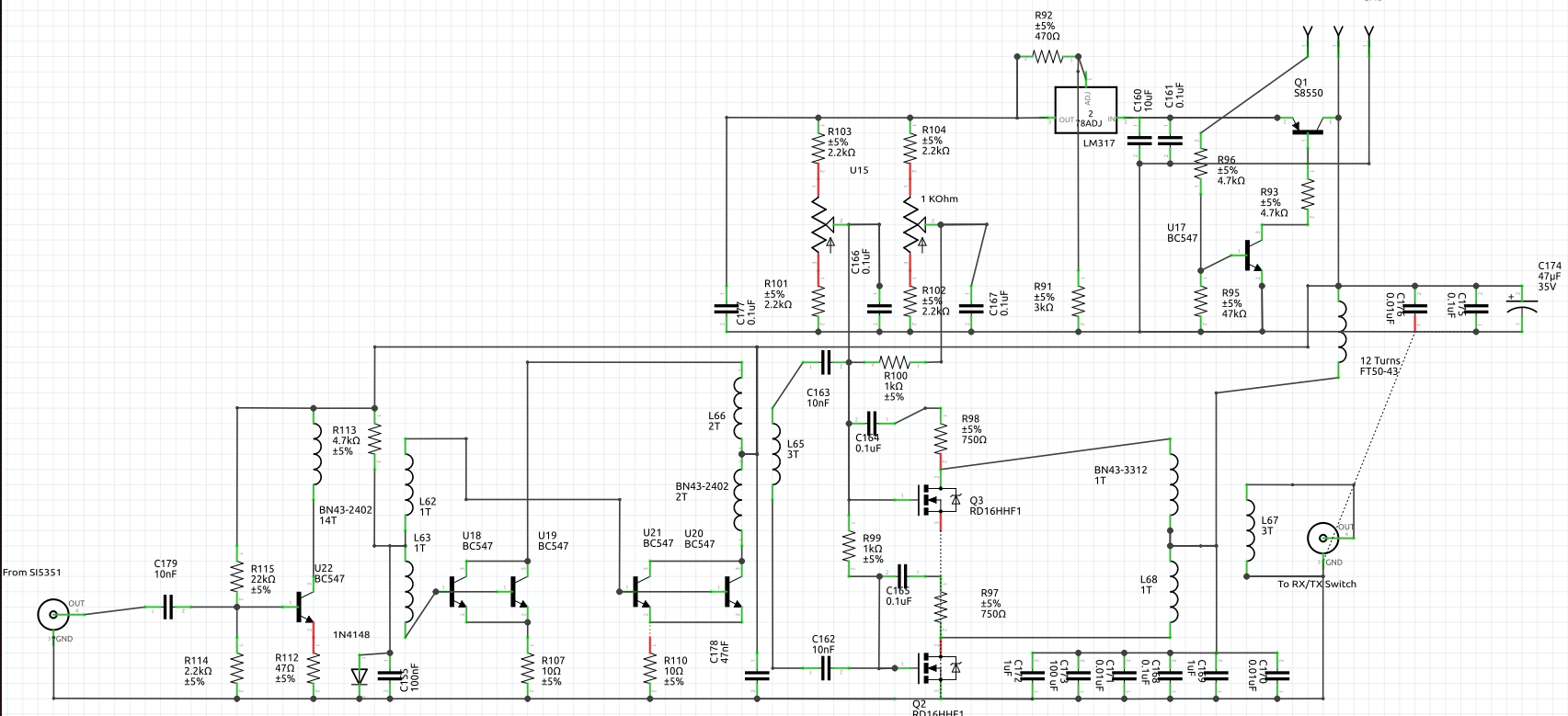

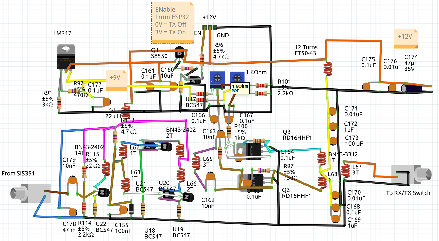

10 W amplifier
To obtain 10 Watts from 1 to 14 MHz and 5 Watts at 21 and 28 MHz I added 2 x RD16HHF1 in push pull.
For the best results they need:
  • some gate polarization (especially at 21 and 28 MHz) to work in class AB to be set by two potentiometers
  • a command to set such polarization only when transmitting to avoid useless heating and power consumption
