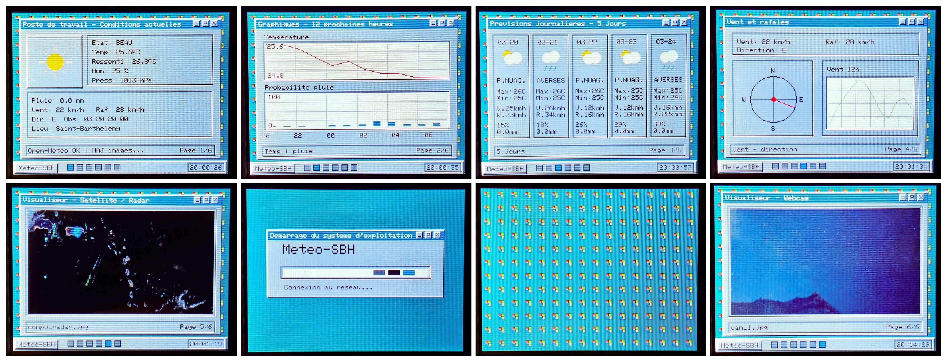

The result is this project: an ESP32 Cheap Yellow Display (ESP32-2432S028 / CYD) mounted inside a custom 3D-printed CRT-style enclosure, running a Windows 95 inspired user interface that displays:
  • current weather conditions
  • short-term forecast graphs
  • daily forecast
  • wind and gust data
  • a live webcam image
  • a satellite/radar image
To make it feel more like a real miniature computer, I also designed a mechanical front-button linkage so the rear buttons on the CYD can be pressed from the front of the case using lever arms. The finished unit is powered by an internal Li-ion battery, with a charging module and a 5V buck converter, so it can run completely wire-free.

Main Features
Windows 95 style interface
The whole UI is styled with classic retro desktop elements:
  • title bars
  • beveled panels
  • status bars
  • simple desktop-like windows
  • page indicators
The interface cycles automatically through multiple pages, but it can also be changed manually.
Multiple weather pages
The software currently includes six pages:
  1. Current conditions
    Displays current weather with icon, temperature, apparent temperature, humidity, pressure, rain, wind, gusts, direction, and observation time.
  2. Hourly forecast graphs
    Shows the next hours using simple graphs for temperature and rain probability.
  3. Daily forecast
    Displays several days of forecast with compact weather icons and min/max values.
  4. Wind page
    Includes wind speed, gusts, direction, a compass-like indicator, and a 12-hour wind graph.
  5. Satellite / radar image viewer
    Downloads and displays a remote satellite/radar composite image.
  6. Webcam viewer
    Downloads and displays a remote webcam image.
Image caching
Satellite and webcam images are stored in SPIFFS, so the device can keep showing the latest downloaded content even if the network is temporarily unavailable.
Local weather data caching
Weather JSON is also cached locally, which makes the interface more resilient and improves startup behavior.
Wi-Fi + NTP time sync
The ESP32 connects to Wi-Fi, syncs time via NTP, and uses that for the on-screen clock and timestamps.
Asynchronous networking
Network operations are handled in a separate task so the UI remains responsive while data and images are being downloaded.
