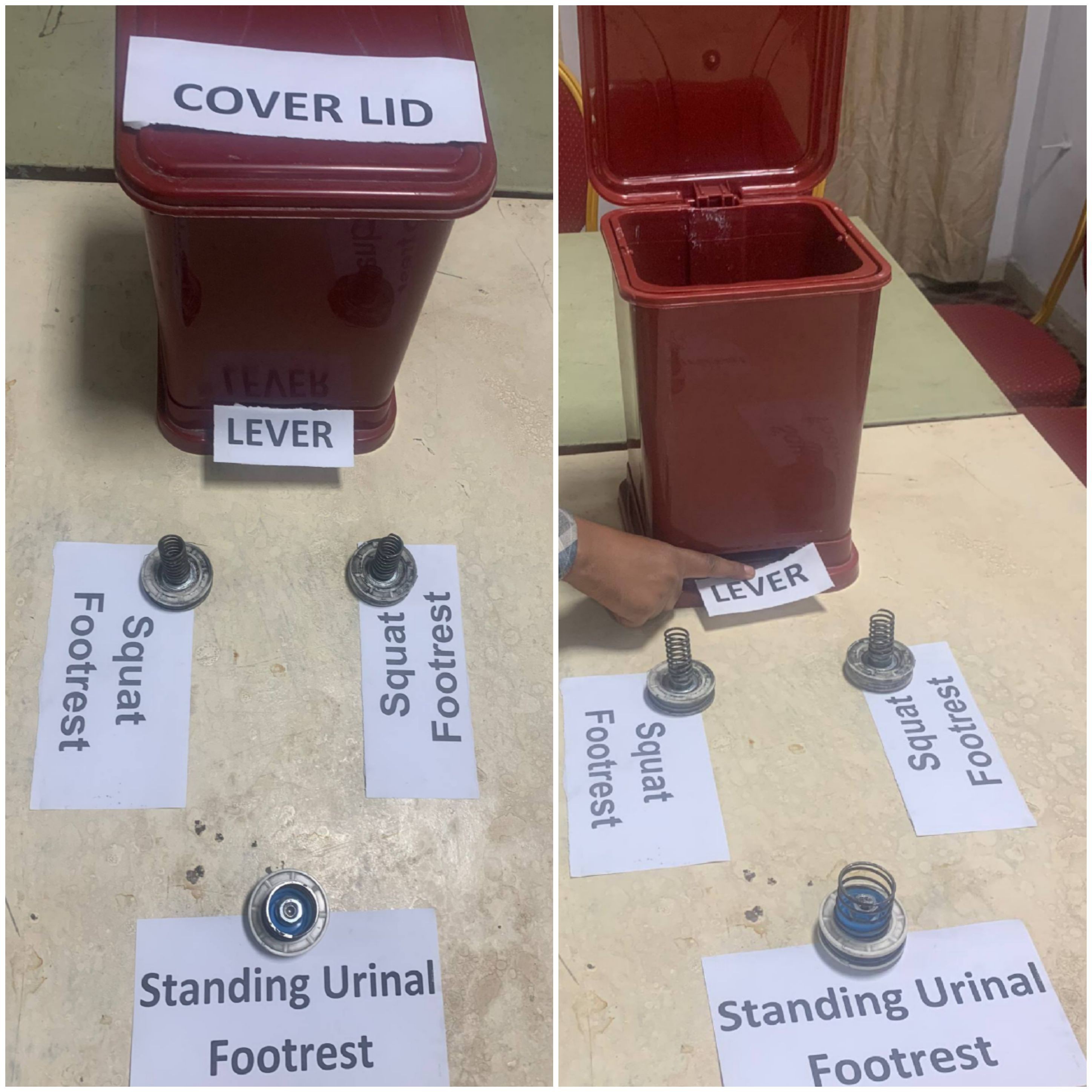

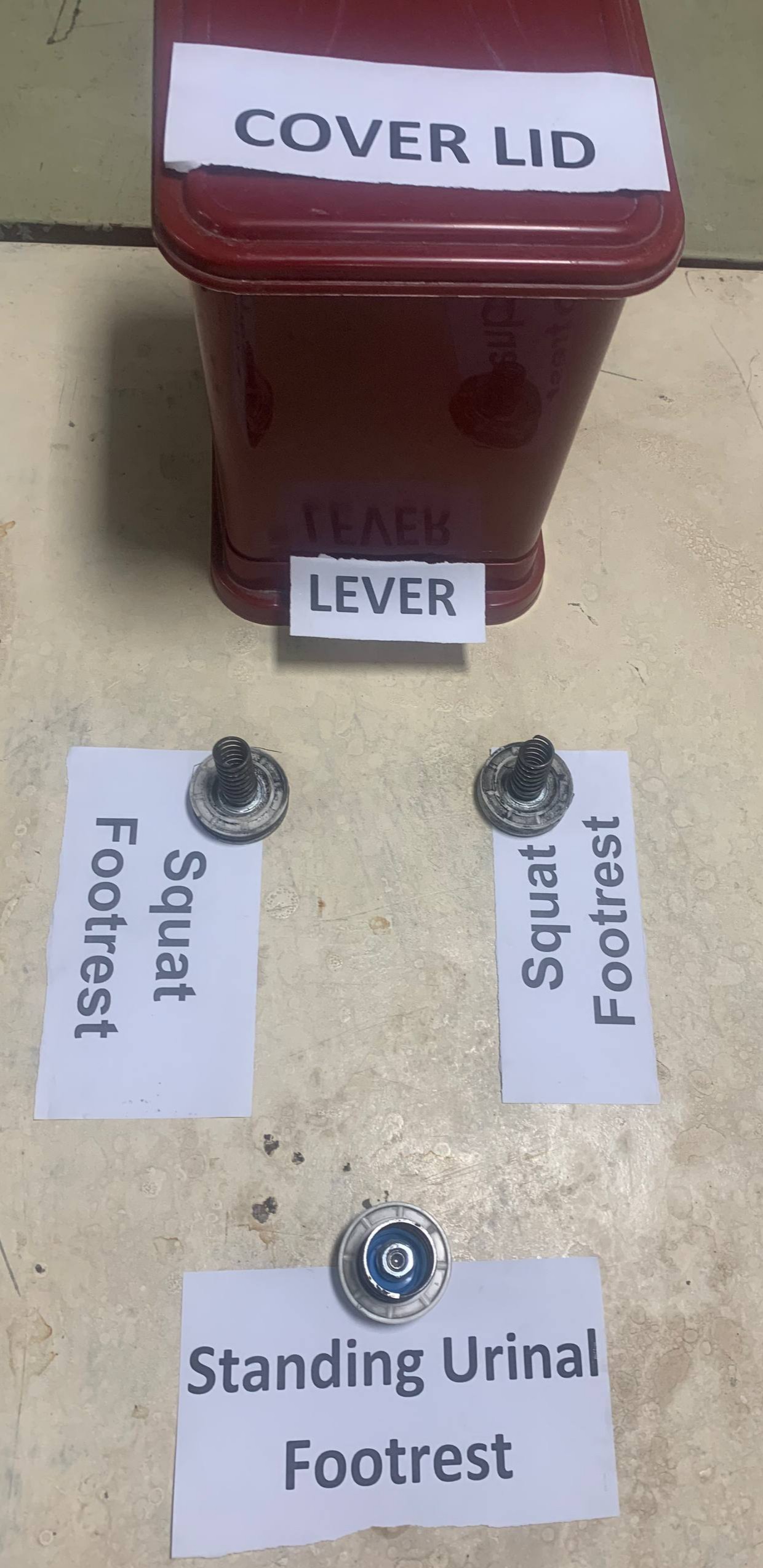

To build the simplest form of prototype, I had an inspiration to use Pedal Bin for opening and closing the squat toilet cover lid by integrating 3 spring load system (2 springs for the squatting footrest and 1 spring for standing urinals footrest). The spring systems will be connected with each other by connecting plates or rod structure in order to push the lever of the Pedal Bin to activate the lid opening.

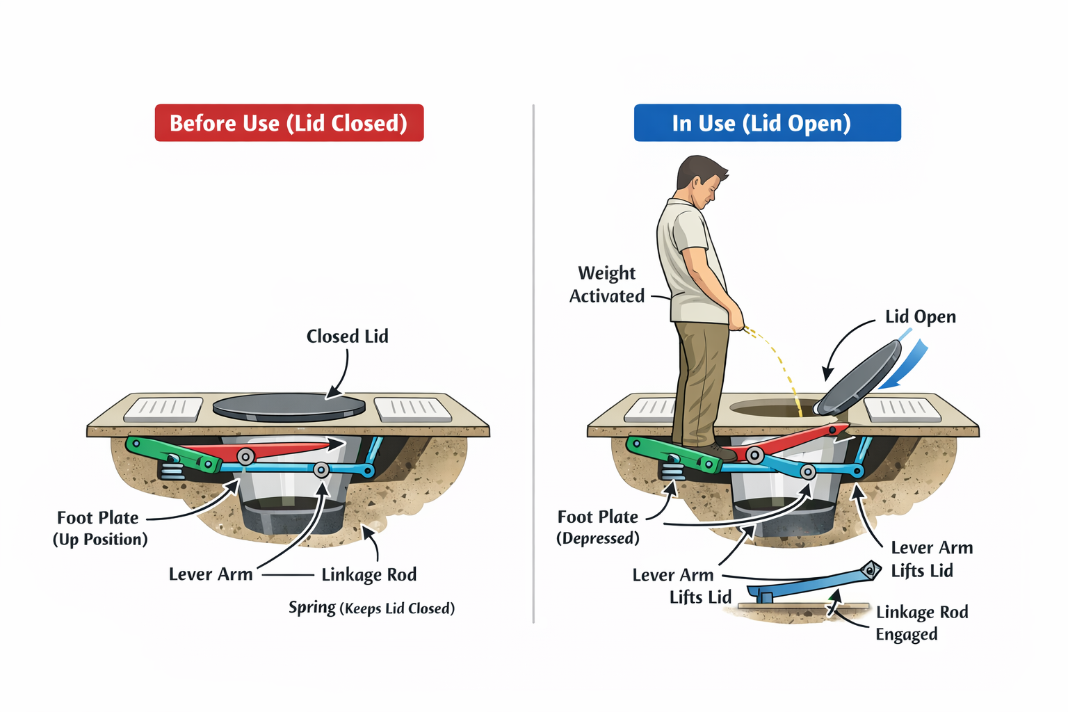

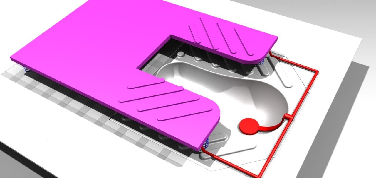

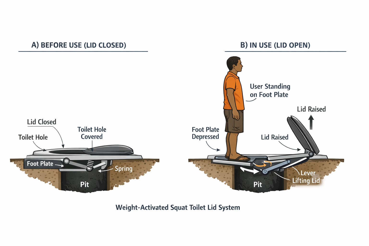

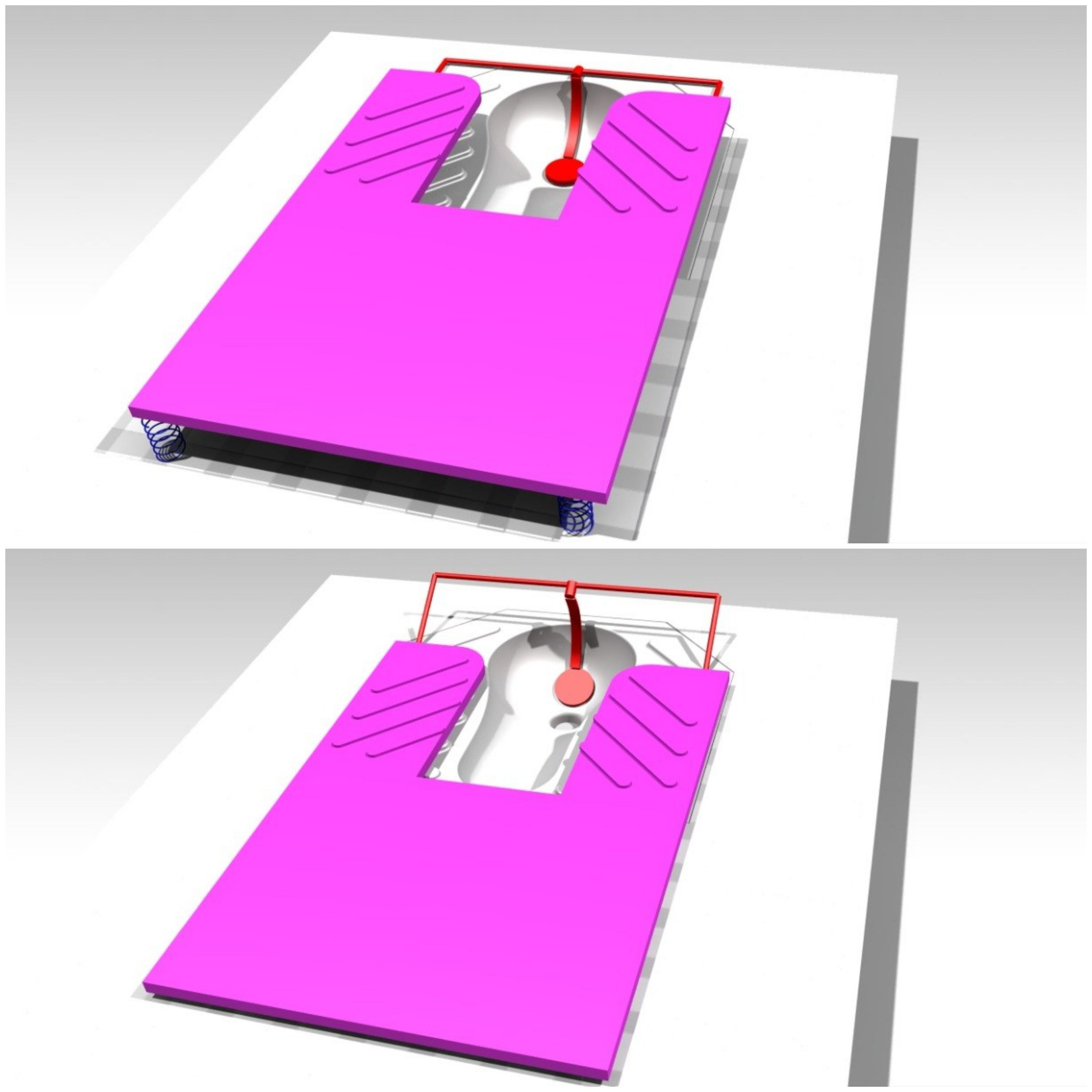

    The system is a mechanically actuated squat toilet cover integrated into a weight sensitive platform. The toilet opening remains closed when the facility is not in use. When a user steps onto the platform, their body weight compresses the spring supported plate. This movement activates a linkage mechanism that automatically opens the toilet opening. Once the user leaves, the springs return the platform to its original position, causing the cover to close again.

anime_penpal wrote 03/10/2026 at 17:46 point
Images have obvious signs of AI generation. Idea is iffy as it is set up, because you aren't squatting from that far in front, the opening platforms should be on the sides and it should slide backward.
Anteneh Gashaw wrote 03/30/2026 at 11:18 point
@anime_penpal Feel free to see the design for MVP or the prototype and thank you for your suggestion of the mechanism but I think mine is better.... FYI AI is great tool to describe your visualization to people
