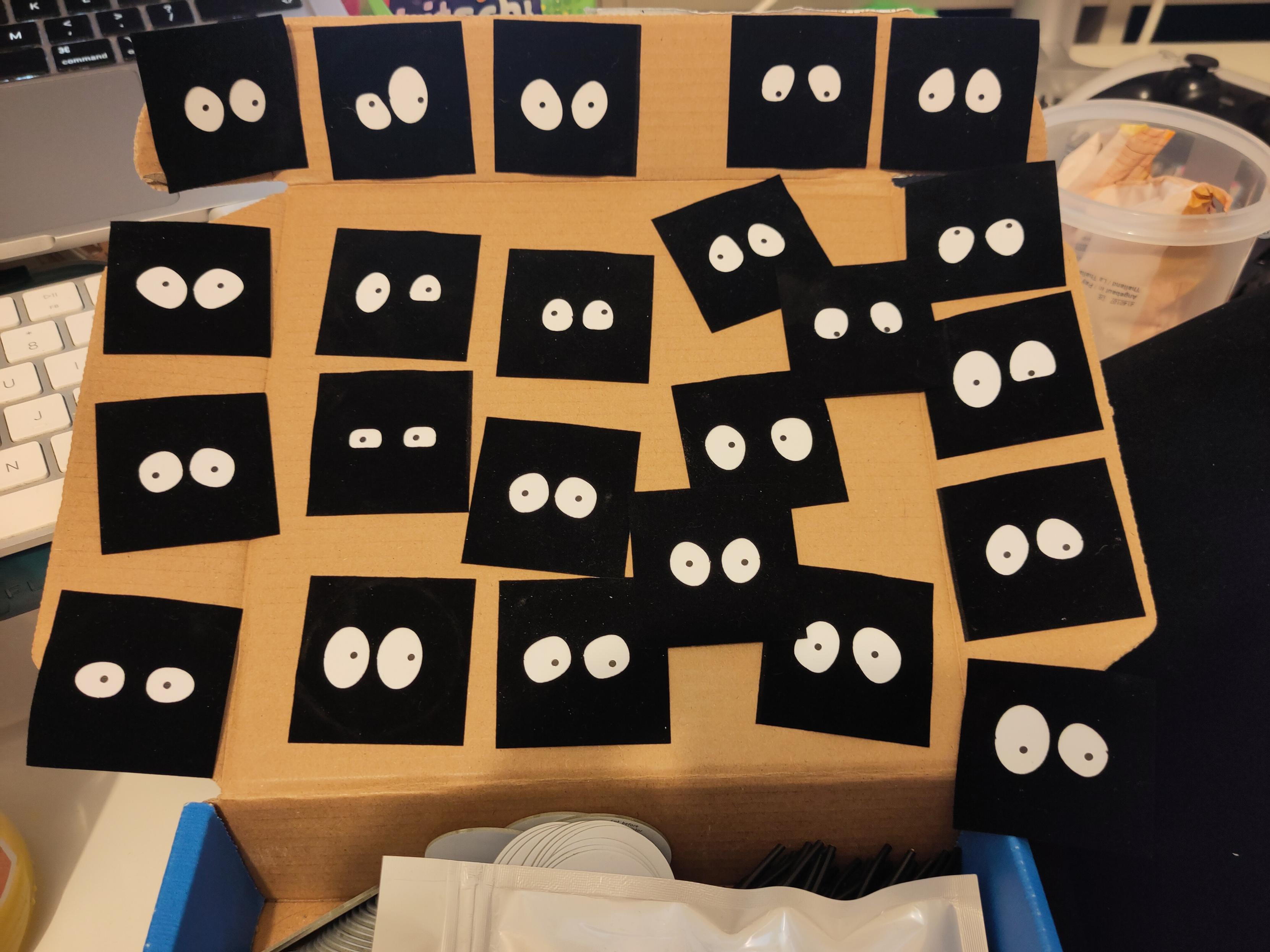

This is more of a crafty simple add-on, than a technically complicated. I wanted to expand my skills a bit and went for working with a plotter - cut velour / vynil sticker, that covers a PCB. The different cutouts for the eyes will hopefully produce unique PCBs, in combination witha uniquely shaped, resin-cast RGB LED. The single core wires will allow for different postures of the legs and the arms that are holding and powering the LED.

    There were two choices for the shape of the velour stickers: either cut out the perfect circle and then live with the consequences of misplacing them - or cutout the circle after applying a bigger square. I went for the latter, which worked out ok! I'm going over every corner of the PCB with a black marker anyways, to keep the appearance as black as possible. The velour is great for absorbing the light shining on it.

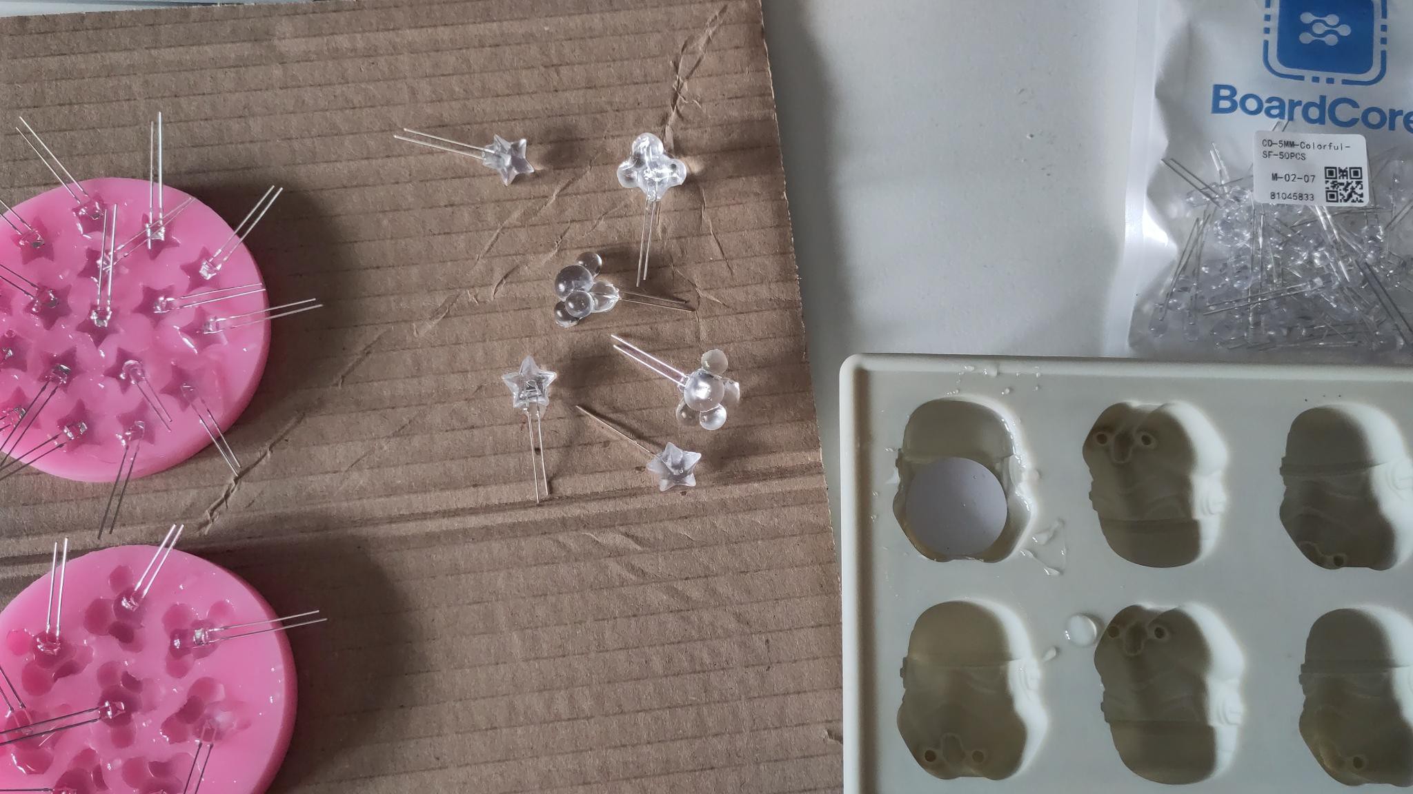

  • Resin-casting the LEDs
    davedarko2 days ago 0 comments
    I found some molds on Aliexpress that seem to fit well with the soot sprites in shape and size, so I will not make my own molds for this. With every run I get around 25 weirdly shaped LEDs, which is nice. I even have a leftover mold in form of stormtrooper ice cubes now.
