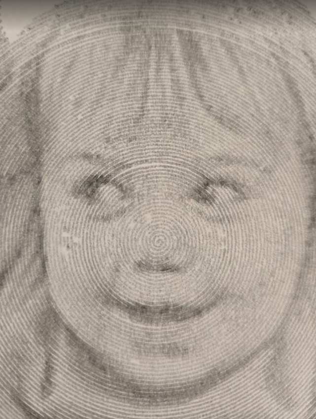

AutoGraph is possibly the world's first pencil plotter. It operates on the principle that the force applied between graphite and paper controls the darkness of the marking. It features force control between the paper and graphite and automated graphite dispensing. It uses the same machine instructions as a laser cutter. The results are so much fun that I keep coming back to make improvements and push it's capabilities.
How it works:
  • Force control between the graphite and paper. Force control is achieved using a series elastic actuator design. A non-contact hall effect position sensor is used to measure the displacement of a compression spring. A hobby servo motor (with the internal potentiometer hacked for absolute position sense) is commanded to compress the spring against the graphite according to the targeted force. The control strategy is nothing fancy (i.e. no custom PID loop). The system just tries to minimize the error between the current spring displacement and the commanded spring displacement. Making the system minimize error as fast as possible is critical because it has a huge impact on drawing quality. The faster the system can respond, the higher print resolution it can achieve at higher xy machine feed rates.
  • Automated graphite dispensing. A photogate sensor is triggered when the graphite wears down and the pencil gets too close to the paper. The system then commands a feed hold at the controller to pause the xy machine. While paused, the servo motor moves the mechanical pencil to up a position that depresses the top of the pencil. The system returns to the last commanded force. Finally, the system commands a cycle start to resume the drawing.

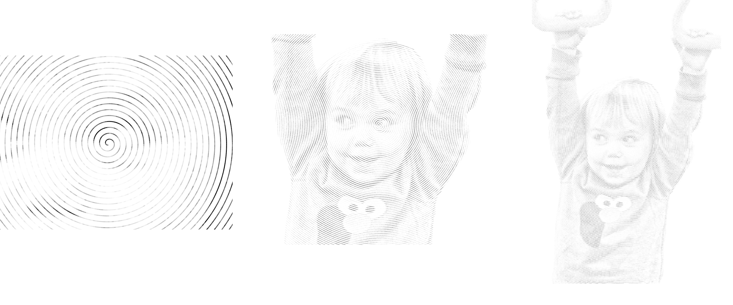

    As part of my batch at the Recurse Center, I completed a script that maps bitmap images to an archimedes spiral. The goal was to develop a tool path strategy that is entirely unique to the AutoGraph pencil plotter capabilities.
    I had previously been using LaserGRBL to generate tool paths that scan horizontal and vertical like is appropriate for a laser engraver. This has achieved great results, but there is no reason why the AutoGraph needs to constrained to just horizontal and vertical lines. Print speeds are slow compared to a laser engraver so the mechanical dynamic benefits of moving straight along the xy axes are less impactful.
    GitHub Repo
    Pencil plotter capabilities are unique but also sit on this interesting bridge between pen plotters and laser engravers. Unlike pen plotters that vary marking density to achieve the effect of light and dark, pen plotters and laser engravers are able to achieve light and dark with even the smallest marking. This allows laser engravers and pencil plotters to achieve higher printing resolution that a pen plotter. Color is where pen and pencil plotters start to share more in common. Pens are available in so many different mediums and colors. While there is not as much variety in graphite pencil leads, they still have a dozen options in hardness and at least a rainbow of colors.
