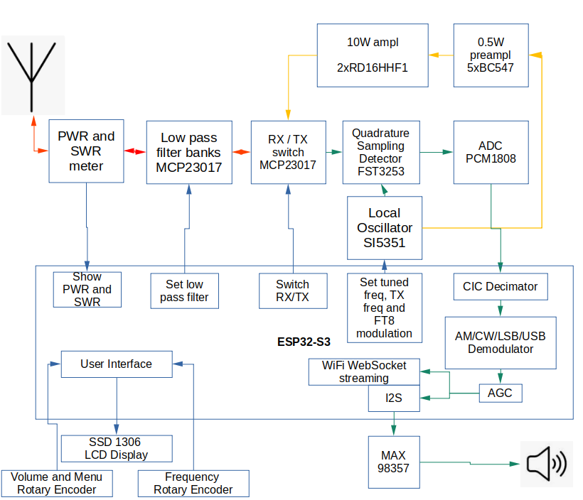

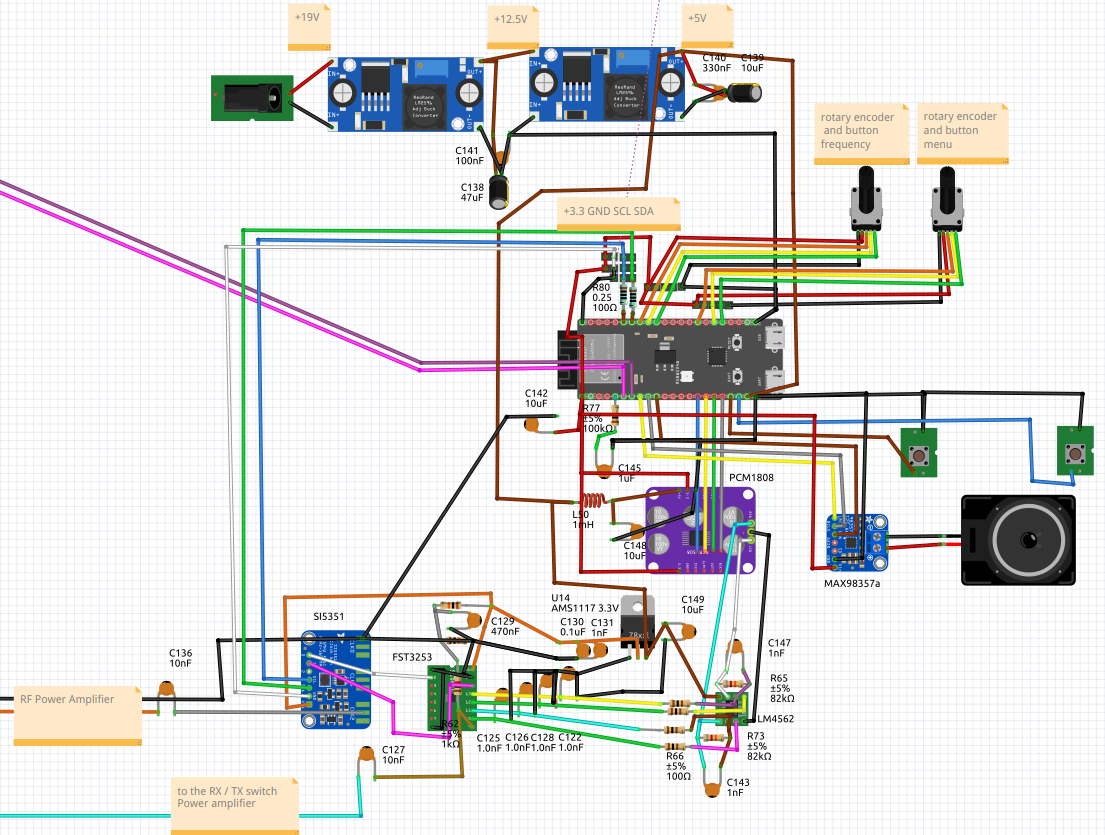

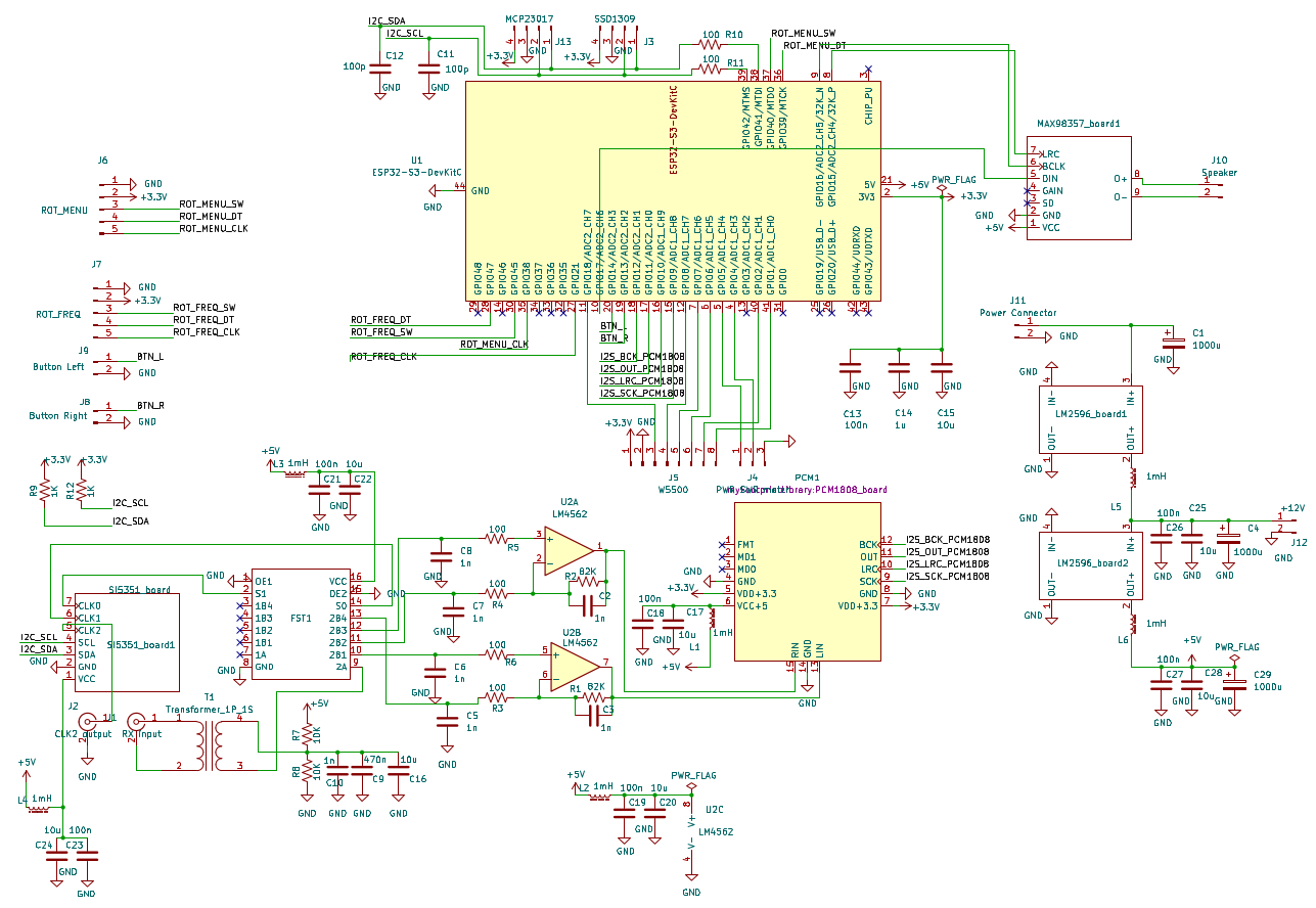

Overall Architecture
The design combines four key subsystems:
  1. RF signal conditioning (filters and switching)
  2. RF measurement (directional coupler and detectors)
  3. digital control (ESP32 + MCP23017 filters switching + MAX98357 audio out)
  4. operator interface (encoders, display, buzzer)
Together these blocks form the front-end control and monitoring infrastructure of a modern QRP HF transceiver platform

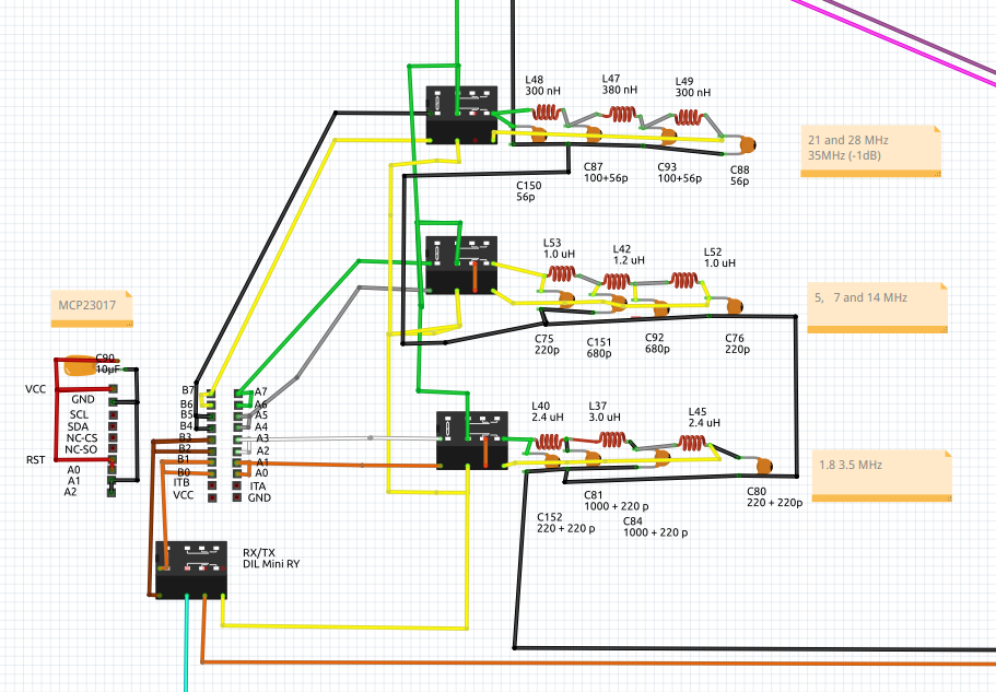

2. Low-Pass Filter Bank
The RF signal passes through a bank of relay-selected low-pass filters (LPF) designed to suppress harmonic emissions during transmission.
The filters cover the HF spectrum using three bands:
FilterHam Bands CoverageFrequency Range
LPF11.8 – 3.5 MHz0.1 - 5 MHz
LPF25 – 7 – 14 MHz5.1 - 10 MHz
LPF321 – 28 MHz10.1 - 30 MHz
Each filter is a 7 poles Chebishev LC network built with toroidal inductors and RF capacitors.
Functions:
  • Suppress transmitter harmonics
  • Maintain regulatory spectral purity
  • Provide good impedance matching in the passband
Latch Relays route the RF signal through the correct filter depending on the operating frequency selected by the controller.
The relay bank is driven by an I²C GPIO expander, the MCP23017.
This device expands the number of digital outputs available to the controller and performs several tasks:
  • Drives filter-selection relays
  • Controls RX/TX switching relays
  • Simplifies wiring by using the I²C bus
Using an expander allows the microcontroller to manage many control lines while using only two pins (SDA and SCL).

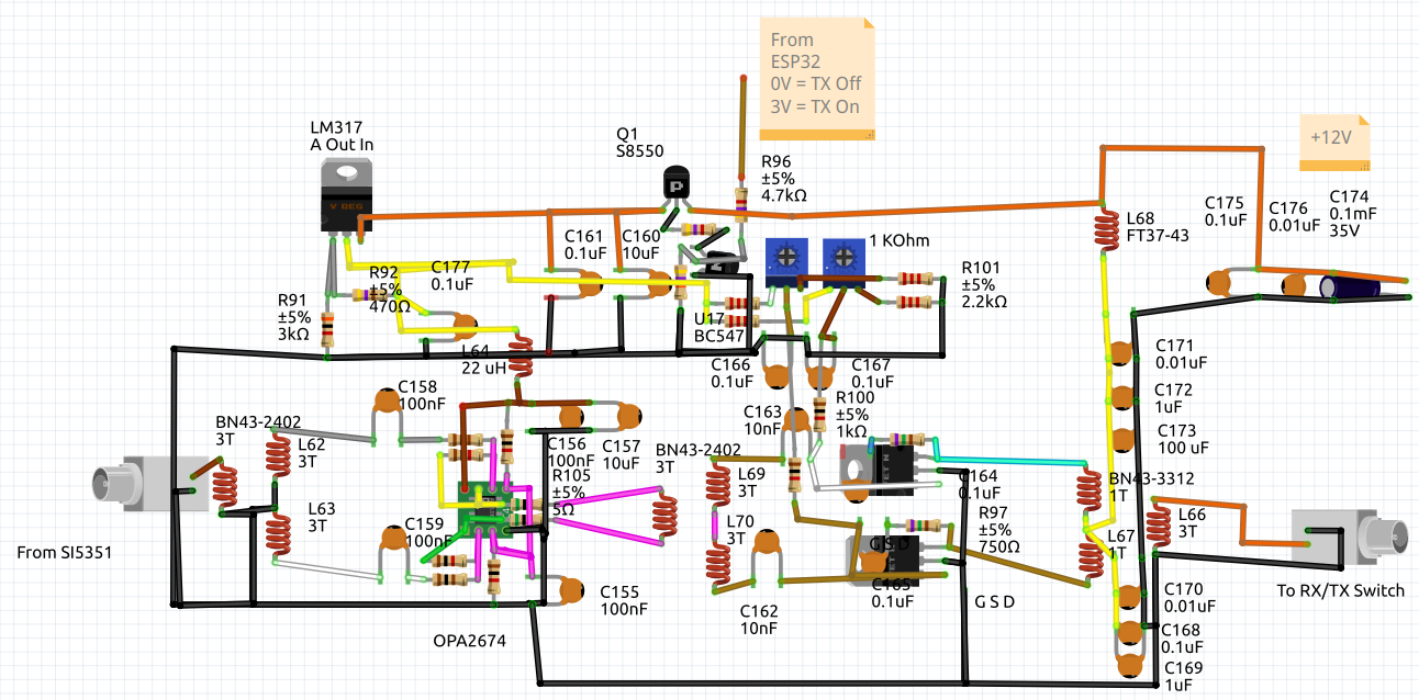

3. RF Power Amplifier Interface
The filtered RF signal connects to the RF power amplifier stage.
This block represents the connection point between the low-level RF system and the final amplifier.
Key roles:
  • Deliver clean RF drive to the PA
  • Route the transmit signal through the filter bank
  • Return the received RF path toward the receiver
Proper impedance control (50 Ω) throughout this section is essential to minimize insertion loss and reflections.
For a complete description, please see my project: 1-30 MHz 0.5-1W (up to 10W) class C amplifier
4. Microcontroller Control System
The central controller is an ESP32 microcontroller board.
It manages:
  • the RF control logic
  • the Digital Signal processing
  • the user interface
  • WiFi or Ethernet communication
Responsibilities include:
  • Selecting the appropriate low-pass filter
  • Reading SWR and power measurements
  • Managing RX/TX switching
  • Driving the display
  • Handling user input from rotary encoders and buttons
The ESP32-S3 provides significant processing capability and built-in peripherals, making it well suited for digital control of RF equipment.
SDR Functionalities:
  • LSB, USB, CW, AM Demodulation
  • IQ Processing: DC removal
  • Phase and amplitude correction
  • CIC decimation filters
  • downsample ADC IQ data to audio rates
  • Hilbert transform for SSB demodulation
  • FT8
    • integrated FT8 encoding
    • FT8 decoding at the moment happens via an external FT8 decoder server but an integrated solution is under development. See
    • QSO management (CQ / Answer)
    • others QSOs view

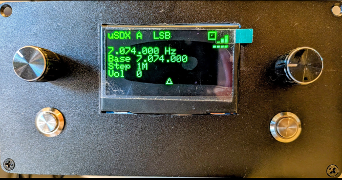

5. User Interface
The interface allows the operator to control and monitor the system.
Main elements include:
  • Frequency rotary encoder (on the right) for tuning
  • Volume rotary encoder (on the left)
  • Menu rotary encoder for configuration
  • Push...

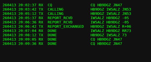

  • An almost perfect FT8 sequence
    Guido - IW5ALZ04/27/2026 at 07:38 0 comments
    About 15 days ago I succeeded to follow this almost correct FT8 sequence, but it had a few issues.
    Issue
    I decoded HB9DGZ answer -05 at 20:05:37 but its transmission was since 20:05:15 till 20:05:27 (my decoding took 10 seconds)
    Therefore (waiting for the even slot) I could plan to send R+06 only 1 minute later, since 20:06:30 till 20:06:42.
    In the meantime HB9DGZ, not seeing my reply, correctly retried answer -05 since 20:06:15 till 20:06:27 which I decoded at 20:06:36.
    At last, at 20:06:30 till 20:06:42 I transmitted R+06
    Promptly, HB9DGZ decoded R+06 and transmitted RR73 since 20:06:45 till 20:06:57, which I decoded  7 seconds later at 20:07:04
    My upgraded sequence
    I answered SV9TLU transmitting JN53                        since 9:33:00 till 9:33:12
    At 9:33:15 SV9TLU transmitted -06 to me                    since 9:33:15 till 9:33:27
    I decoded -06 before 9:33:30 so I could answer R+06 since 9:33:30 till 9:33:42
    Final consideration
    Since last SV9TLU CQ (at 9:32:57) till its RR73 (at  9:33:57) elapsed only 1 minute
    To see my software improvements, see my my Github

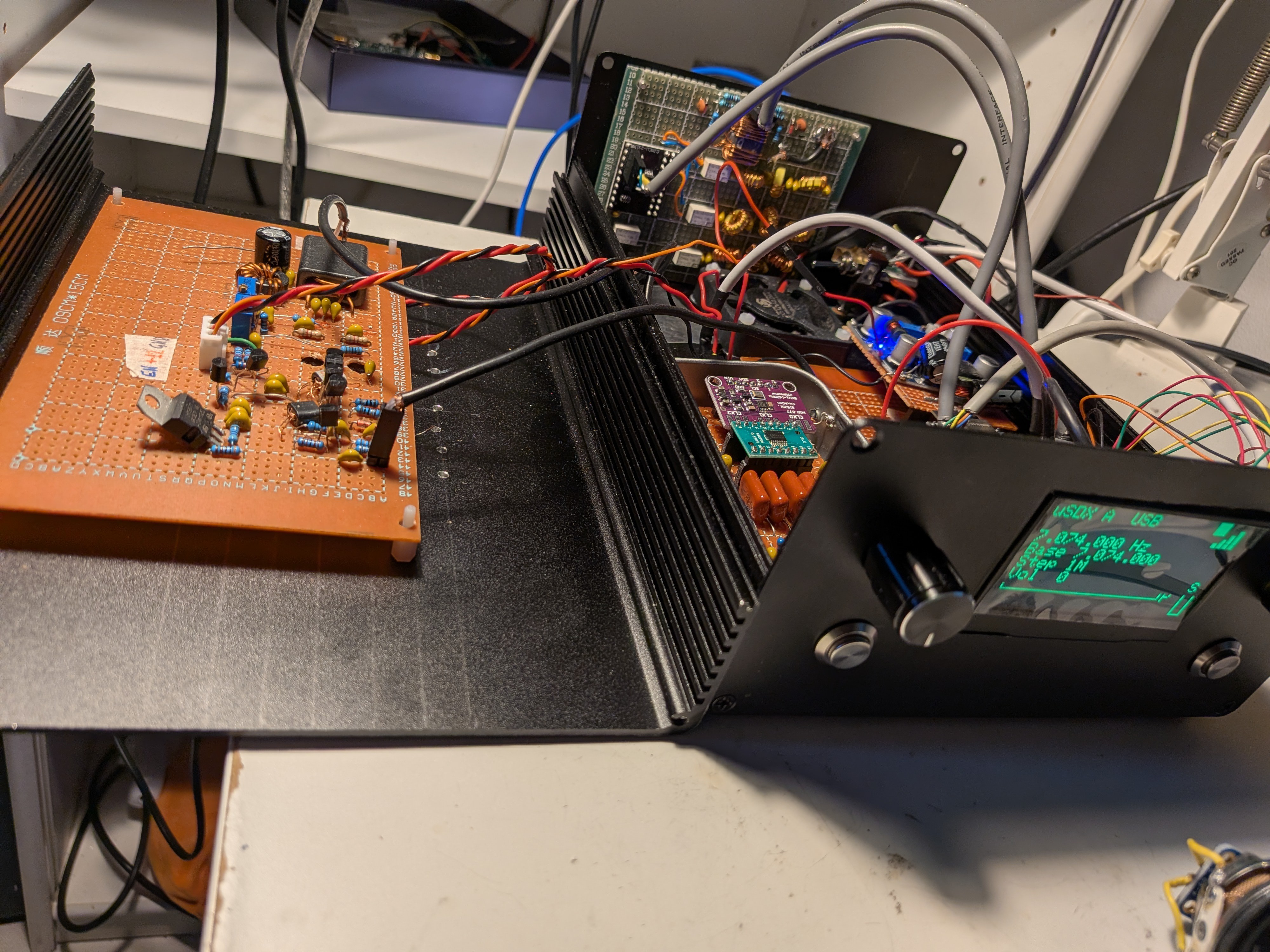

  • The complete assembly
    Guido - IW5ALZ04/11/2026 at 15:05 0 comments
    After finishing the RF amplifier and mounting it on the inner side of the aluminium box top, I can say the hardware assembly is quite consolidated.
    The RF amplifier is on the left, with the two RD16HHF1 in push pull screwed directly on the inner side of the cover (below the perfoboard).

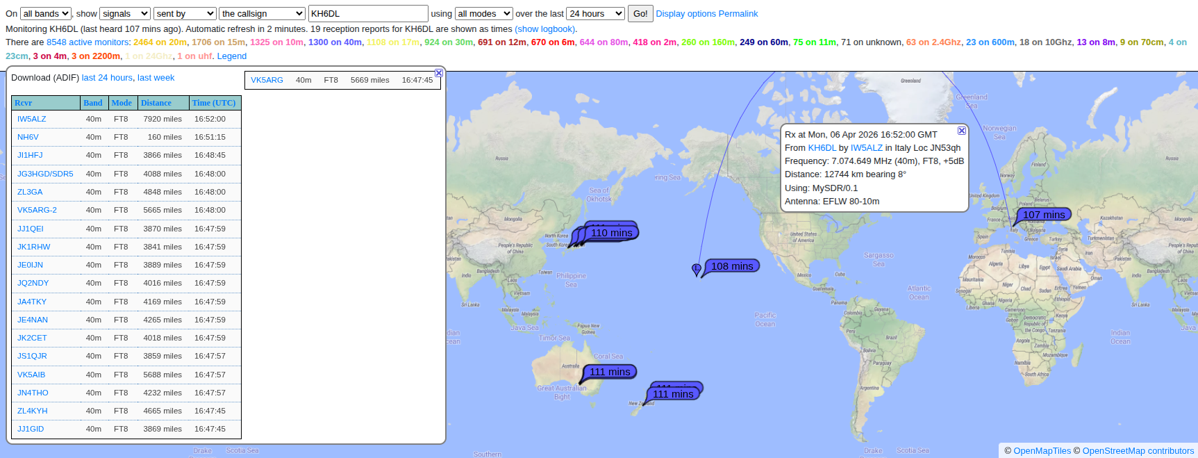

  • From the Hawaii
    Guido - IW5ALZ04/06/2026 at 18:44 0 comments
    20260406 20:48:00 CET
    With this receiver connected to my 10-160m mutilband End Fed Long Wire antenna I can receive a lot of FT8 spots from all over the world.
    I was the only one, in Europe, to receive a message from KH6DL over the last 24 hours.
    My antenna is nothing special as it's located at about 6 meters from the ground, between some buildings. Therefore I think my receiver is not so bad!

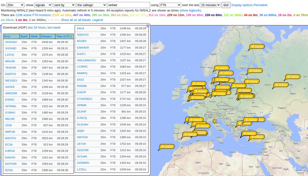

  • My FT8 transmitter works!
    Guido - IW5ALZ03/28/2026 at 09:45 0 comments
    Mar 28th 2026
    This morning I tested a single CQ IW5ALZ JN53 transmission (8W)  and I got:

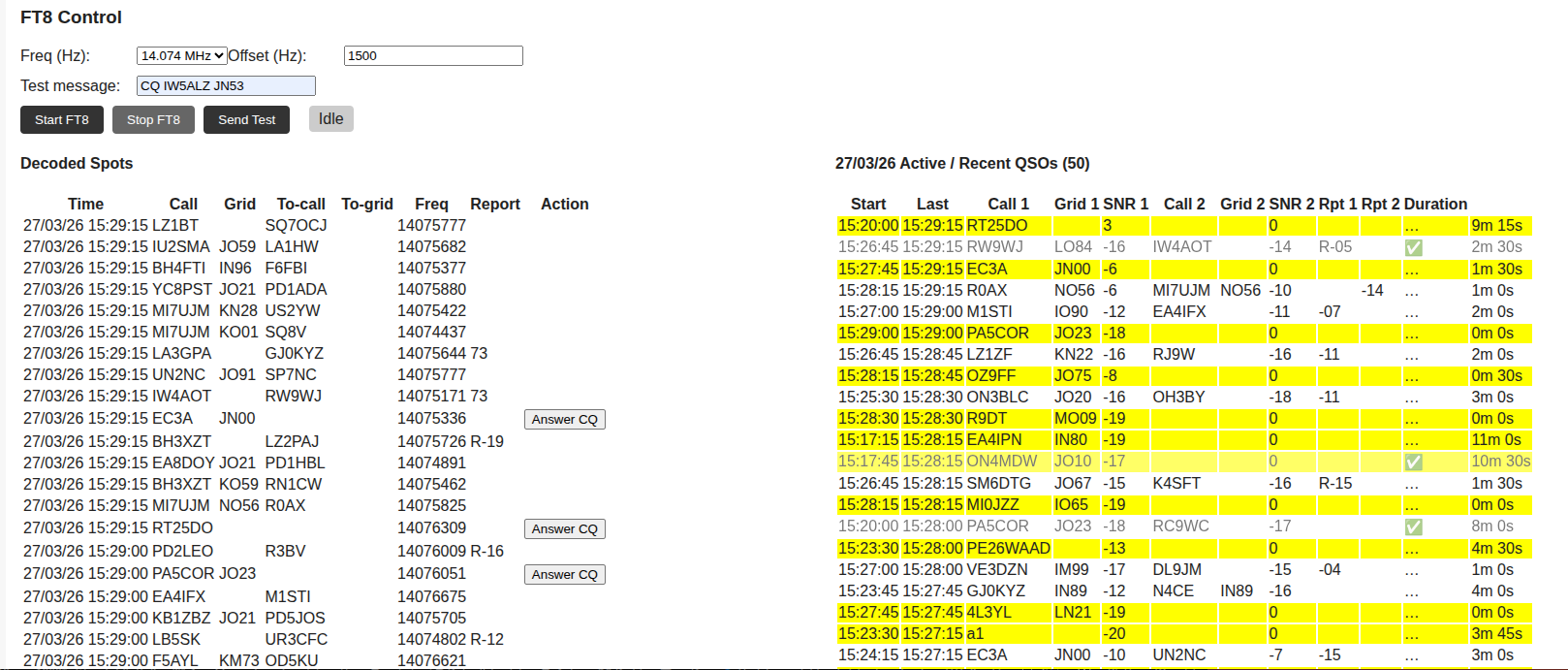

  • FT8 QSOs Manager
    Guido - IW5ALZ03/27/2026 at 14:37 0 comments
    In the web portal I added a spot (on the left) and QSO (on the right) decoder:
    (TODO) You could answer a CQ directly pushing Answer CQ.
  • Power Amplifier
    Guido - IW5ALZ03/13/2026 at 17:53 0 comments
    I start from the SI5351 CLK2 signal, which is a (more or less) square wave with an amplitude around 3 Vpp.
    At the moment I've built a 0.5 - 1 W amplifier (1-30 MHz 0.5-1 Watt class C amplifier) which works pretty well, but I'd like to reach 5 Watts at least.
    For this reason I'd like to replicate this schematic
    that I found here 20w-broadband-hf-1-55mhz-power-amplifier.
    I modified only the voltage control part, using 2 bjt's instead of 2 MOSFET's because I have no P channel MOSFET.
