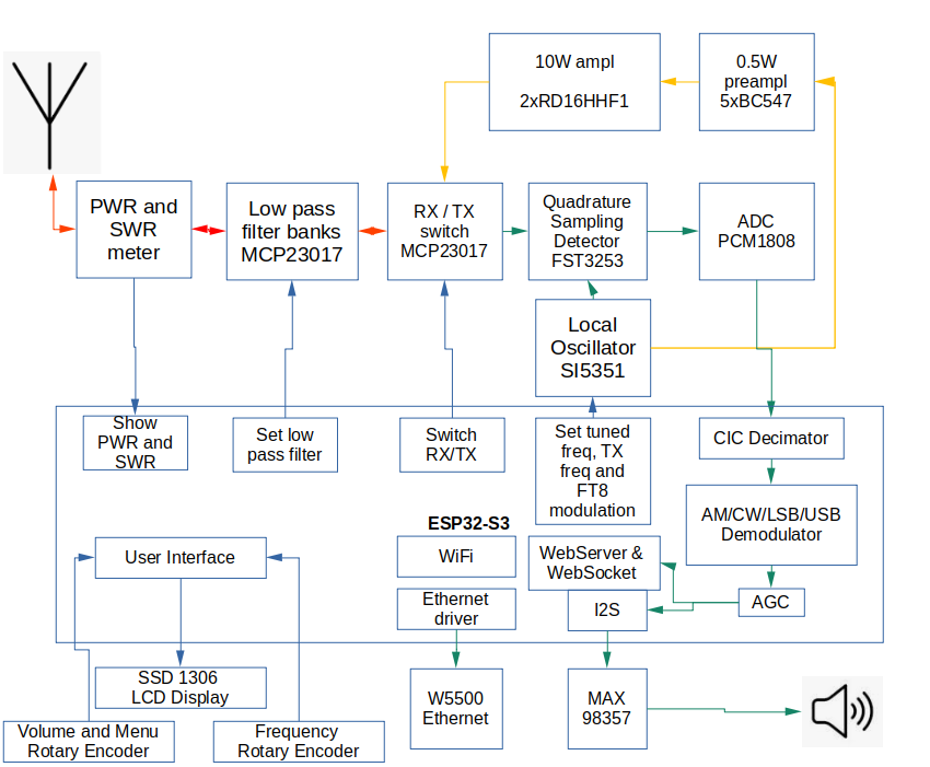

Overall Architecture
The design combines four key subsystems:
- RF signal conditioning (filters and switching)
- RF measurement (directional coupler and detectors)
- digital control (ESP32 + MCP23017 filters switching + MAX98357 audio out)
- operator interface (encoders, display, buzzer)
Together these blocks form the front-end control and monitoring infrastructure of a modern QRP HF transceiver platform

4. Microcontroller Control System
The central controller is an ESP32 microcontroller board.
It manages:
- the RF control logic
- the Digital Signal processing
- the user interface
- WiFi or Ethernet communication
Responsibilities include:
- Selecting the appropriate low-pass filter
- Reading SWR and power measurements
- Managing RX/TX switching
- Driving the display
- Handling user input from rotary encoders and buttons
The ESP32-S3 provides significant processing capability and built-in peripherals, making it well suited for digital control of RF equipment.

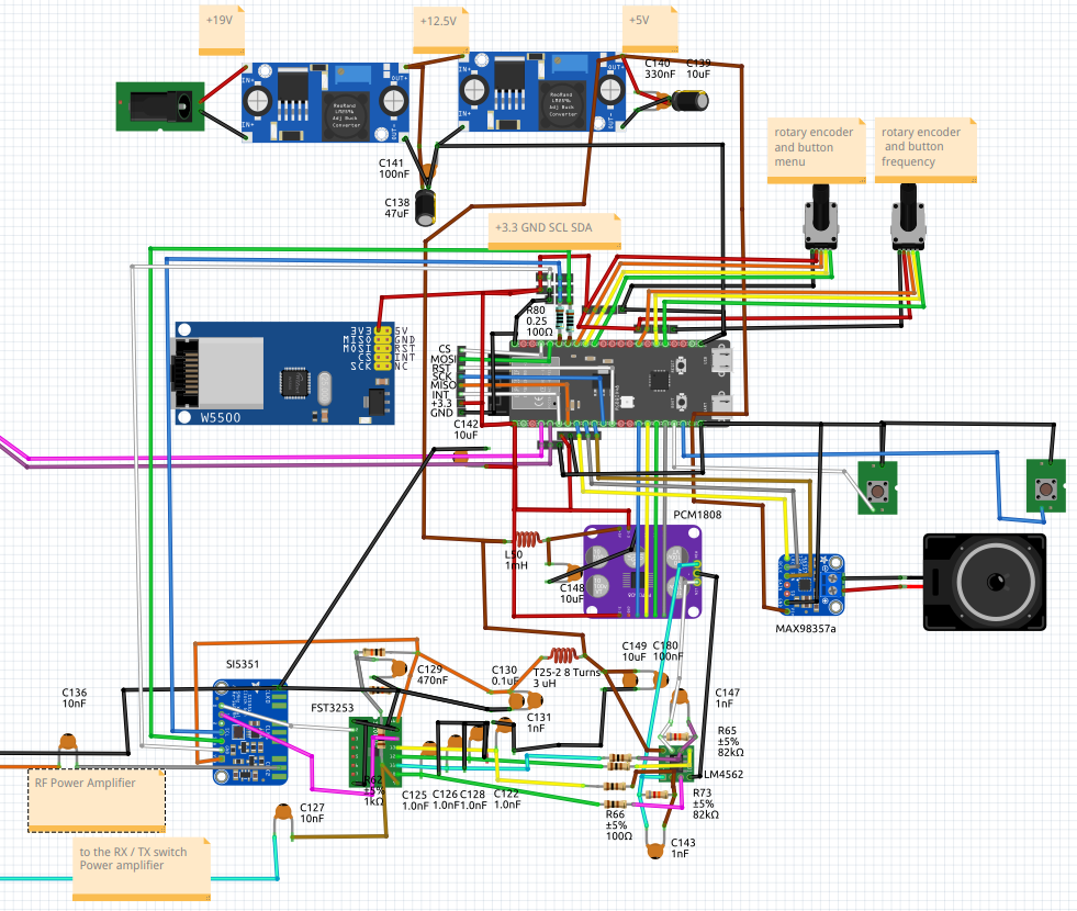

6. Power Supply System
The system is powered from an external DC source.
Multiple voltage rails are generated:
| Voltage | Purpose |
| ~ 19 V | Main input supply |
| 12.5 V | RF Power Amplifier circuit |
| 5 V | ESP32 and modules |
| 3.3 V | Quadrature Sampling Detector (FT3253) and ADC Op Amp front end (LM4562) |
Switching regulators generate the intermediate voltages efficiently, while a linear regulator produces the clean 3.3 V rail required by the Quadrature Sampling Detector (FST3253).

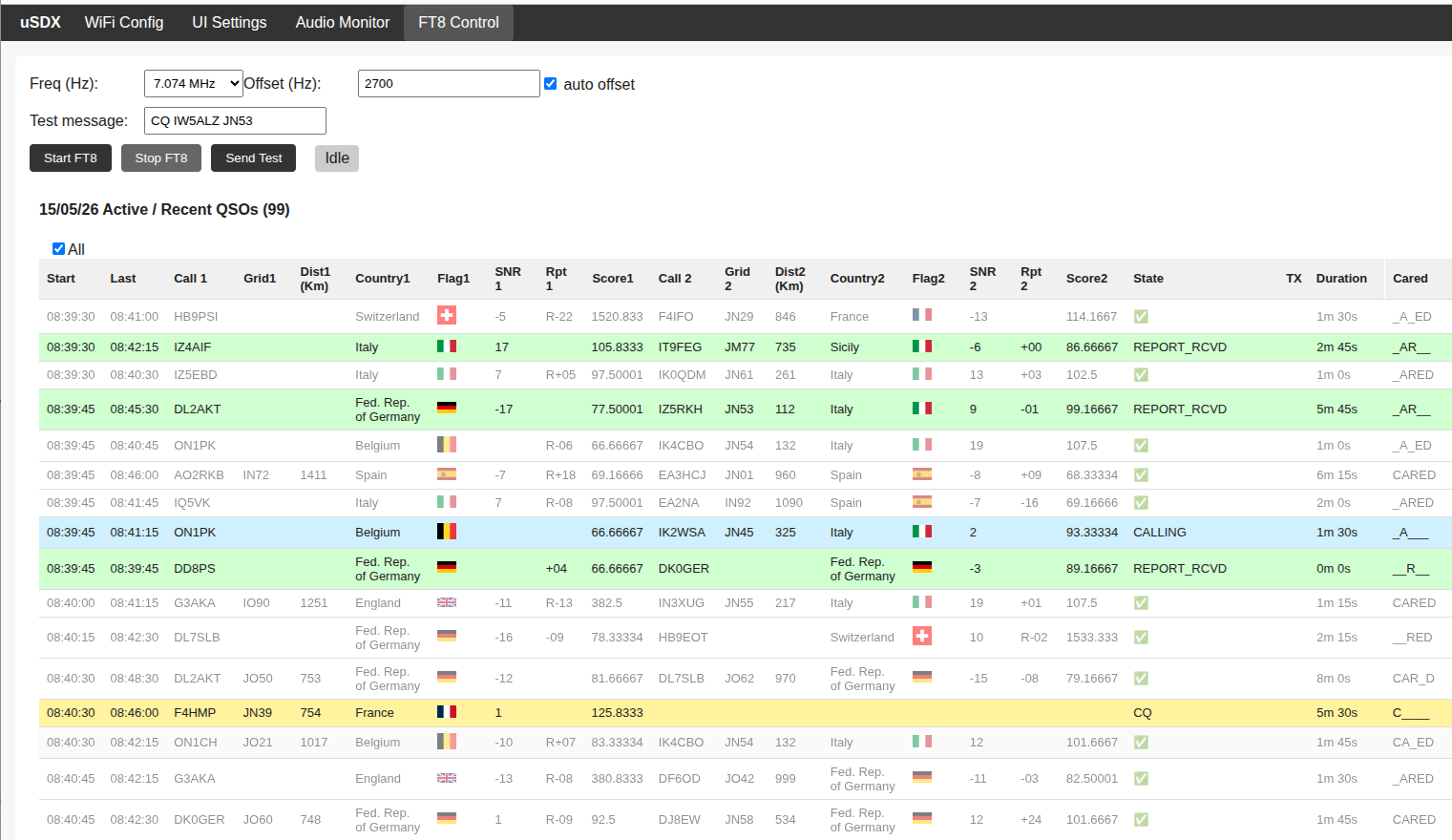

7. WiFi or Ethernet
I included the Ethernet option using a W5500 module. You can choose between WiFi and Ethernet (not both) when building software. See https://github.com/guido57/usdx and https://hackaday.io/project/205224/log/247713-a-new-challenge-ethernet
