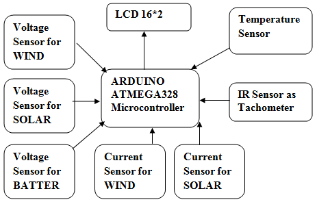

An Arduino-based monitoring system measures voltage, current, RPM, and temperature. These parameters are displayed on a 16×2 LCD so the performance of the system can be observed in real time.

    Monitoring System Development
    An Arduino monitoring system was created to measure voltage, current, RPM, and temperature. These values are displayed on an LCD.

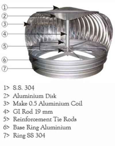

    Step 1 – Preparing the Ventilator
    A rooftop ventilator was selected and inspected to ensure smooth rotation. The central shaft was prepared to mount the generator rotor.
    Specifications:
    Technical Specifications
    Considered
    Outer Diameter
    810 mm
    Neck Diameter
    610 mm
    Blade Thickness
    0.5 mm
    Number of blades
    42
    Type of blades
    Aluminum
    Approximate Weight
    6.5 kg
    Center assembly
    MS Galvanized

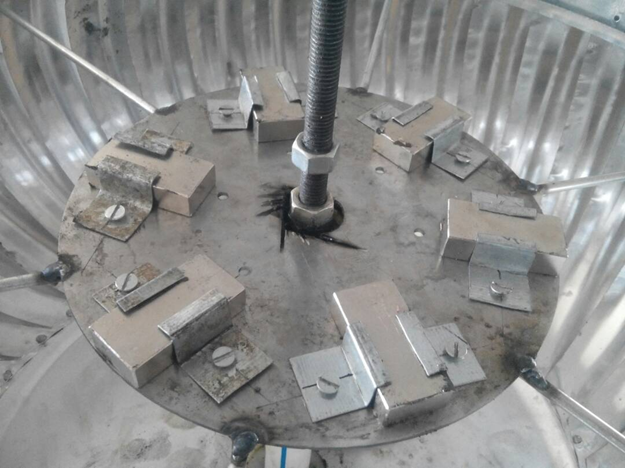

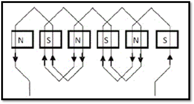

    Step 2 – Building the Generator Rotor
    Neodymium magnets were mounted on a circular rotor plate with alternating polarity. Proper spacing was maintained between magnets.
    A permanent magnet generator is a generator where the excitation field is provided by a permanent magnet instead of a coil.
    Here the rotor Of our generator is a Permanent magnet type rotor which consists of  4 neodium magnets (one of the strongest magnet) whose grade is N52 . Magnets are placed 90 degree with each other.
    Specifications:
    Considered
    Number of magnets in each Disc
    6
    Length of each magnet
    5 cm
    Breadth of each magnet
    1.5 cm
    Height of each magnet
    1.25 cm
    Strength of each magnet
    2.5 Wb
    Material Of disc
    Mild Steel
    Diameter
    20cm
  • 3

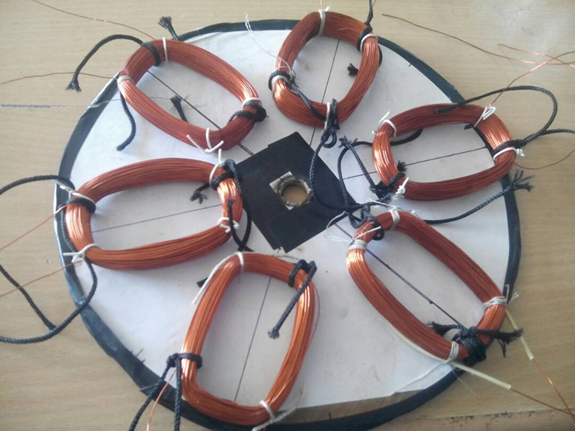

    Step 3 – Winding the Stator Coils
    Copper wire was wound into multiple coils. Each coil contained approximately 230 turns. The coils were fixed onto a stator plate.
    Wire gauge is a measurement of how large a wire is, either in diameter or cross sectional area. This determines the amount of electric current a wire can safely carry, as well as its electrical resistance .
    We have used 26gauge of winding wire in our project which induces
    Considered
    Diameter
    20cm
    Material
    Wood
    Type of Winding
    Distributed
    Conductor Material
    Copper (Cu)
    Resistance of winding
    30 ohms
    Phases
    Single Phase
    Gauge Of conductor
    26 swg
    Stator is a static part of generator the armature winding of a Generator is almost invariably on the stator. The field winding is usually on the rotor and excited by dc current, or permanent magnets.
    No: of Turns= 230
    Number of coils= 6
    Coil span= 5cm
    DISTRIBUTED WINDING: As name suggest, all conductor are distributed in one slot under a pole. If no. of slot is more than no. of pole. Means, winding is distributed in many slot under a pole.
