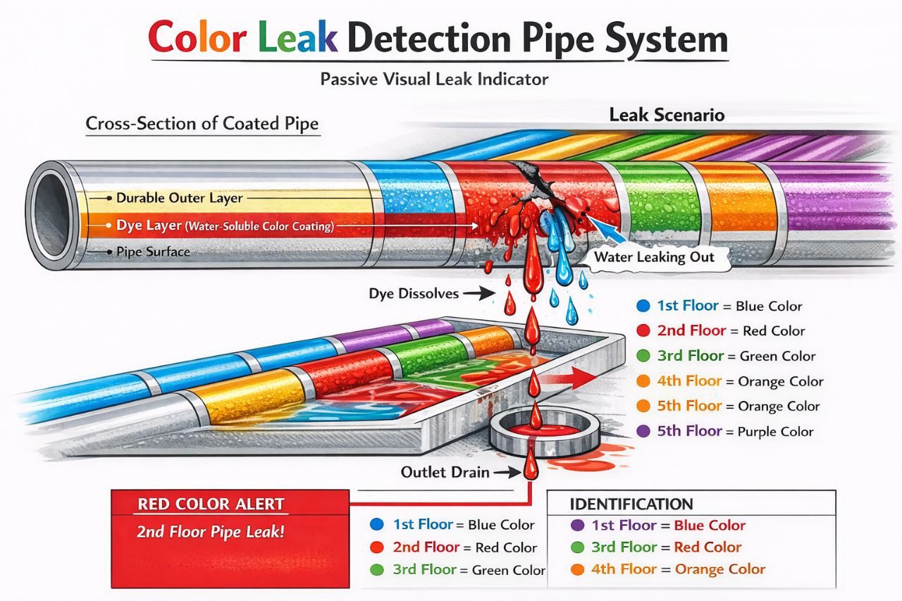

This project introduces a passive visual leak detection system that operates entirely without electricity, providing real time identification of leaks across multi story buildings. Each pipe is externally coated with a water soluble, color coded layer, with unique colors assigned to each floor or pipeline. When a leak occurs, escaping water contacts the external coating dissolving the dye, which flows along the pipe or structure to the nearest visible outlet. The color of the water immediately identifies the leaking pipe and its location, enabling rapid maintenance response and reducing damage.

Water leakage in building plumbing systems is a common and costly problem. In residential complexes, commercial buildings and multi story facilities hidden leaks inside ceilings, service shafts or walls can remain unnoticed for long periods. When these leaks are eventually discovered they often have already caused structural damage, mold growth, water waste and expensive repairs. Modern leak detection technologies typically rely on electronic sensors, monitoring systems or automated building management platforms. While effective these solutions require electricity, wiring infrastructure, periodic maintenance, and technical expertise making them costly and sometimes unreliable during power interruptions.
This project proposes a Passive Color Coded Pipeline Leak Detection System, a simple and reliable method designed to detect leaks in real time without using electricity or electronic components. The concept is based on a physical and chemical response to leaking water rather than electronic sensing. In this system, water pipes are externally coated with a water soluble colored layer that functions as a passive indicator. Each pipeline or building floor is assigned a unique color coating. The coating remains stable under normal conditions but dissolves when exposed to leaking water from the pipe.
When a pipe develops a crack, joint failure or corrosion hole the escaping water comes into contact with the external colored coating. The water dissolves a small amount of the dye, producing colored leak water. This colored water travels along the pipe surface or nearby structure and becomes visible at inspection points such as floor drains, ceilings, service shafts or nearby outlets. Because every pipe or floor uses a distinct color code maintenance personnel can immediately identify which pipeline or building level is responsible for the leak. This visual signal enables rapid troubleshooting and targeted repair without the need for complex diagnostic equipment.
