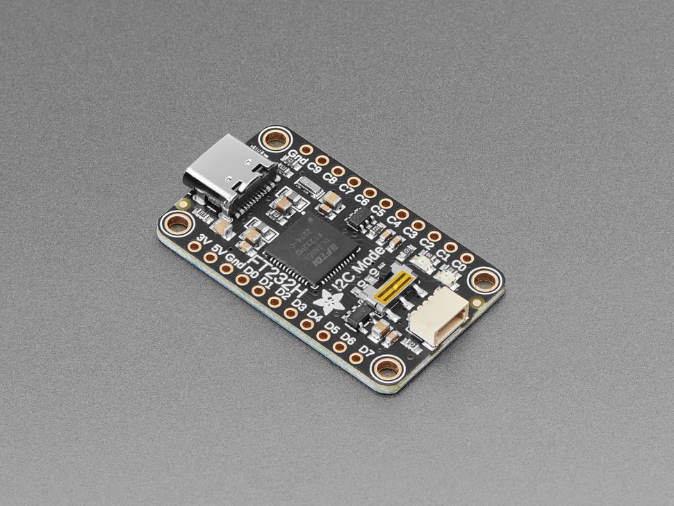

Adafruit makes a breakout board for the FTDI FT232H.
The FT232H normally functions as a USB-to-serial converter, and by default, shows up as a Virtual Com Port when you connect to a computer over USB.
Adafruit explains in their tutorial how to use the libusbK driver with it instead of the default FTDI drivers. That means the device will show up as a libusbK device instead.

What's cool about this FT232H set up it is possible, and easy! You can run python code on your computer, and still communicate directly with hardware peripherals over standard protocols, like I2C.
It's explained in more detail in this tutorial.
I went through the setup, and got the python libraries installed.
