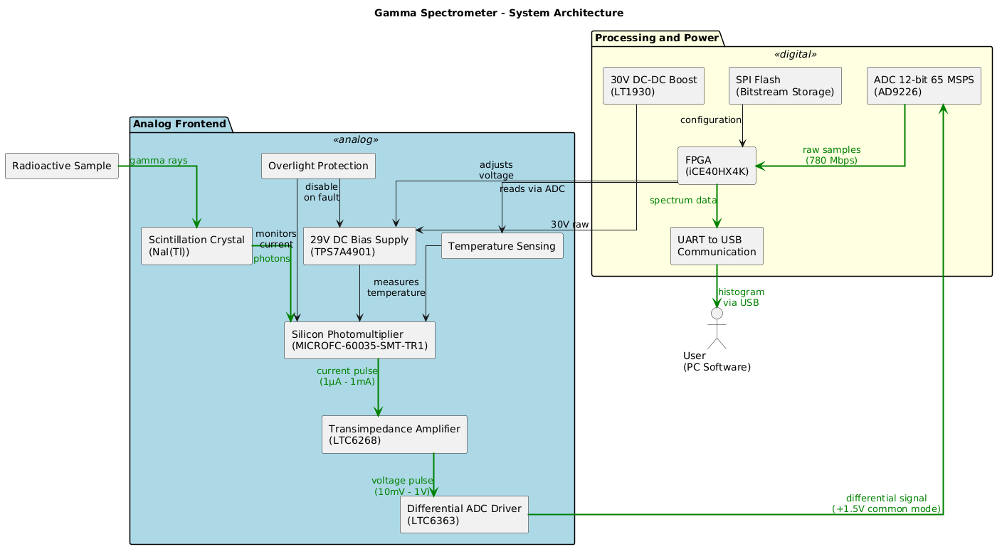

Hardware
Architecture Overview
The hardware consists of four main parts:
Analog Processing
Handles low-level currents produced by the sensor (typically 1uA - 1mA pulses, 10mV - 1V after amplification):
  • NaI(Tl) Scintillator Crystal - Converts gamma rays into visible light pulses through scintillation
  • Silicon Photomultiplier: MICROFC-60035-SMT-TR1 SiPM - Converts light pulses from the scintillator crystal into electrical current pulses
  • Amplifier: OPA690 - can be configured either as a charge amplifier or as a transimpedance amplifier (TIA), depending on the selected feedback network. In the current design, the amplifier is configured as a charge amplifier.
    • Charge Amplifier Configuration. In this mode, the amplifier integrates the input current pulse generated by the SiPM and converts the total collected charge into a proportional output voltage. The output voltage is defined by the feedback capacitor: This can also be expressed as: Where: The total charge generated by the Silicon Photomultiplier (SiPM). The feedback capacitance of the integrator or transimpedance stage. The time-dependent input current pulse from the detector.
    • Transimpedance Amplifier (TIA) Configuration. In this configuration, the output voltage is proportional to instantaneous input current: Where: The feedback resistor that determines the gain of the transimpedance stage. The instantaneous input current flowing from the sensor into the amplifier.
  • Differential ADC Driver: AD8139 - Converts the single-ended amplifier output into a differential signal suitable for the ADC input. It also sets the required common-mode voltage (1.5 V) needed by ADC.
  • Bias Supply - Provides a stable and filtered 29 V bias voltage for the SiPM. The bias voltage is adjustable to compensate for temperature-dependent gain variation of the SiPM.
Note: Analog pulse shaping and peak detection are not used - raw signal is digitized directly and processed in FPGA.
Digital processing
Performs high-speed sampling and real-time pulse analysis:
  • ADC: AD9238 - 2-channel, 12-bit, 40 MSPS sampling rate. ch channel produces 480 Mbps (60 MB/s), resulting in 960 Mbps (120 MB/s) total sample data rate.
  • FPGA: iCE40HX4K - Real-time digital pulse processing (trapezoidal filtering, peak detection, histogram generation)
  • SPI Flash: MX25L1606EM1I-12G - Stores FPGA configuration bitstream
  • SPI Port - External header for FPGA programming
  • UART to USB Converter: CH340X - Communication interface to PC.

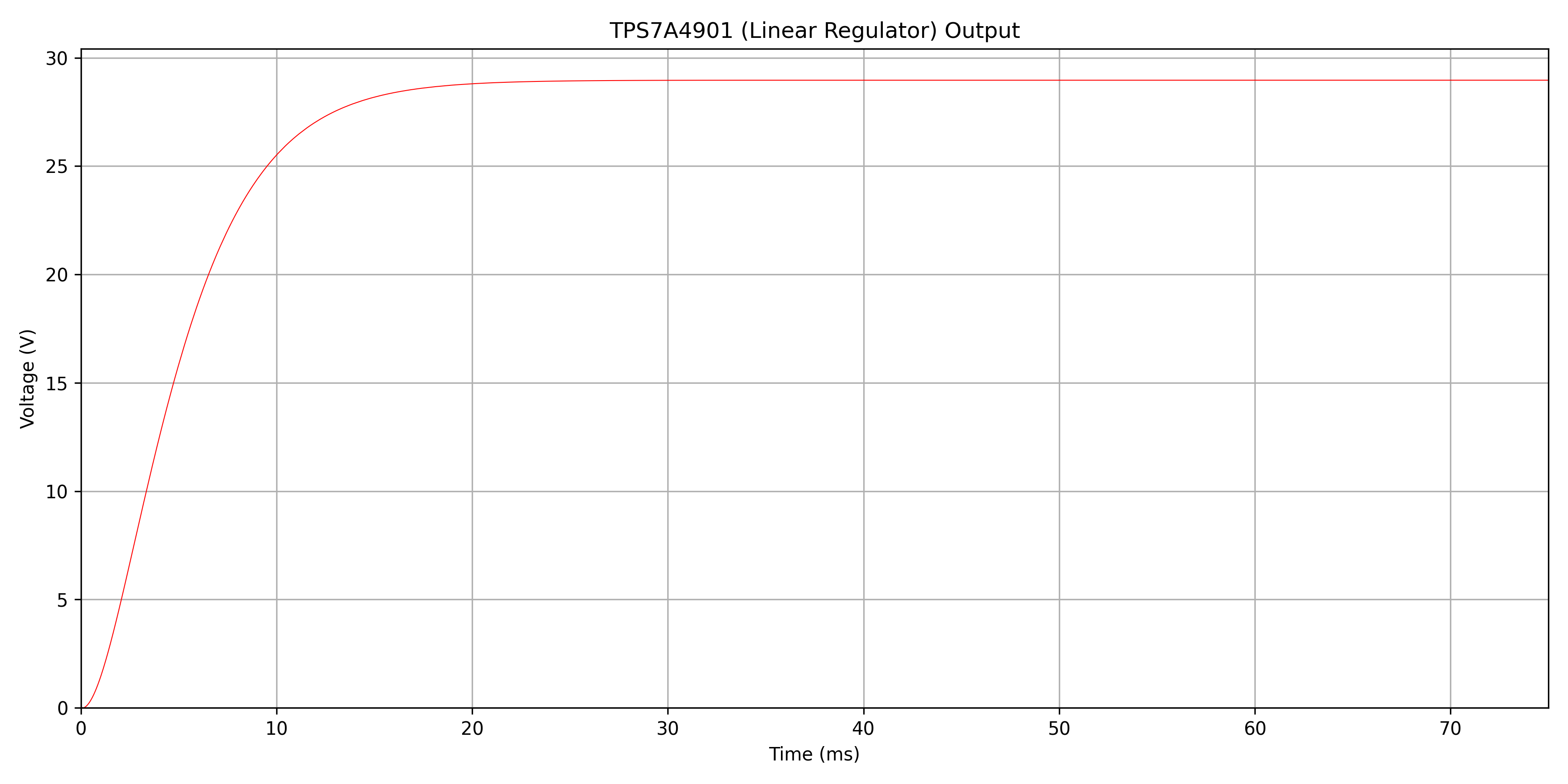

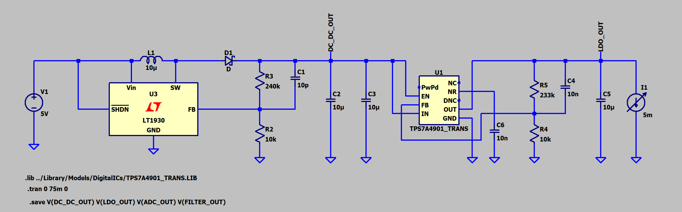

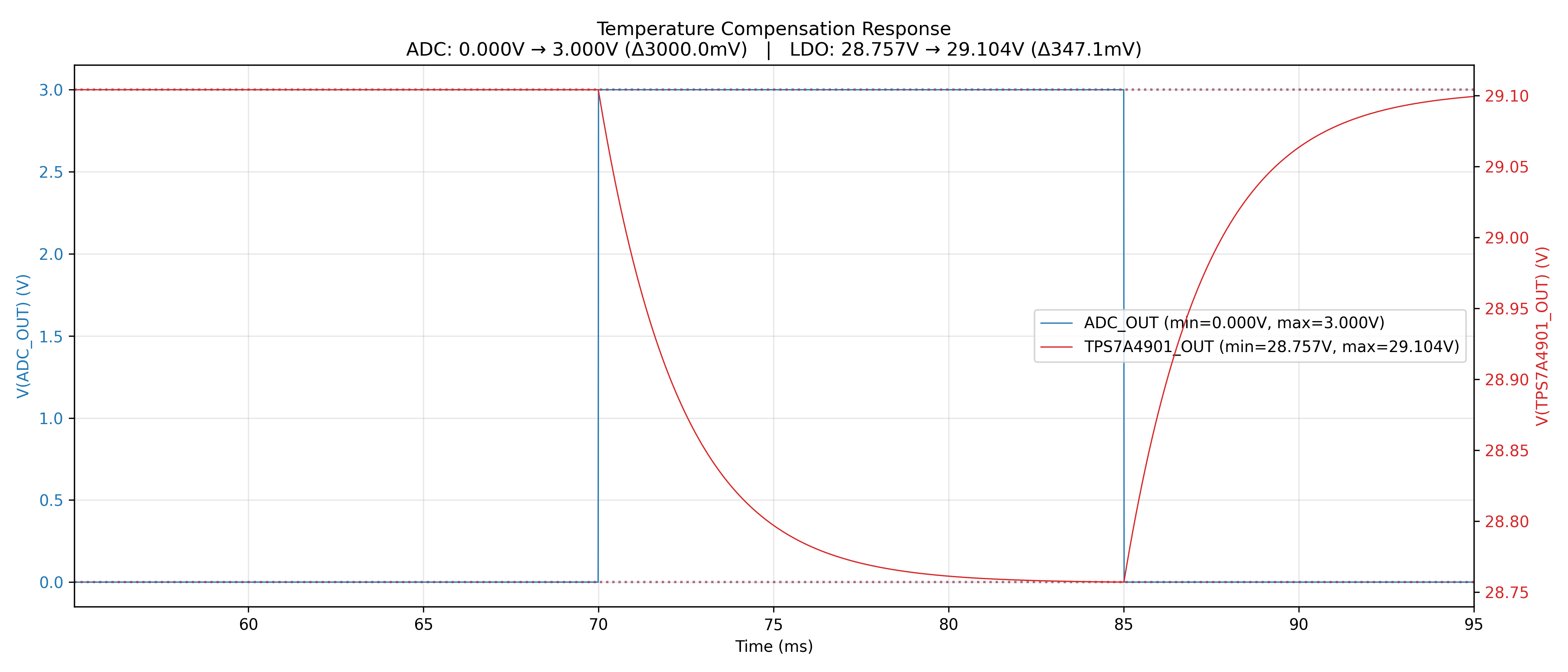

    Most important, there's  a relatively cheap photomultiplier diode, looks perfect for this project: MICROFC-60035-SMT-TR1.
    I've decided to change plans and use a regular DC/DC converter plus a silent voltage regulator at the output; this way, the output voltage will be well-stabilized and can be adjusted for temperature changes.
    If I made the math right, mentioned above diode needs a bias of 28.89V - 29.22V (why it's not constant later on in post) assuming the device will work in temperature range of 20C-35C (meaning 15C span)?
    I've made this simulation and it seems to work (but it's just a simulation):

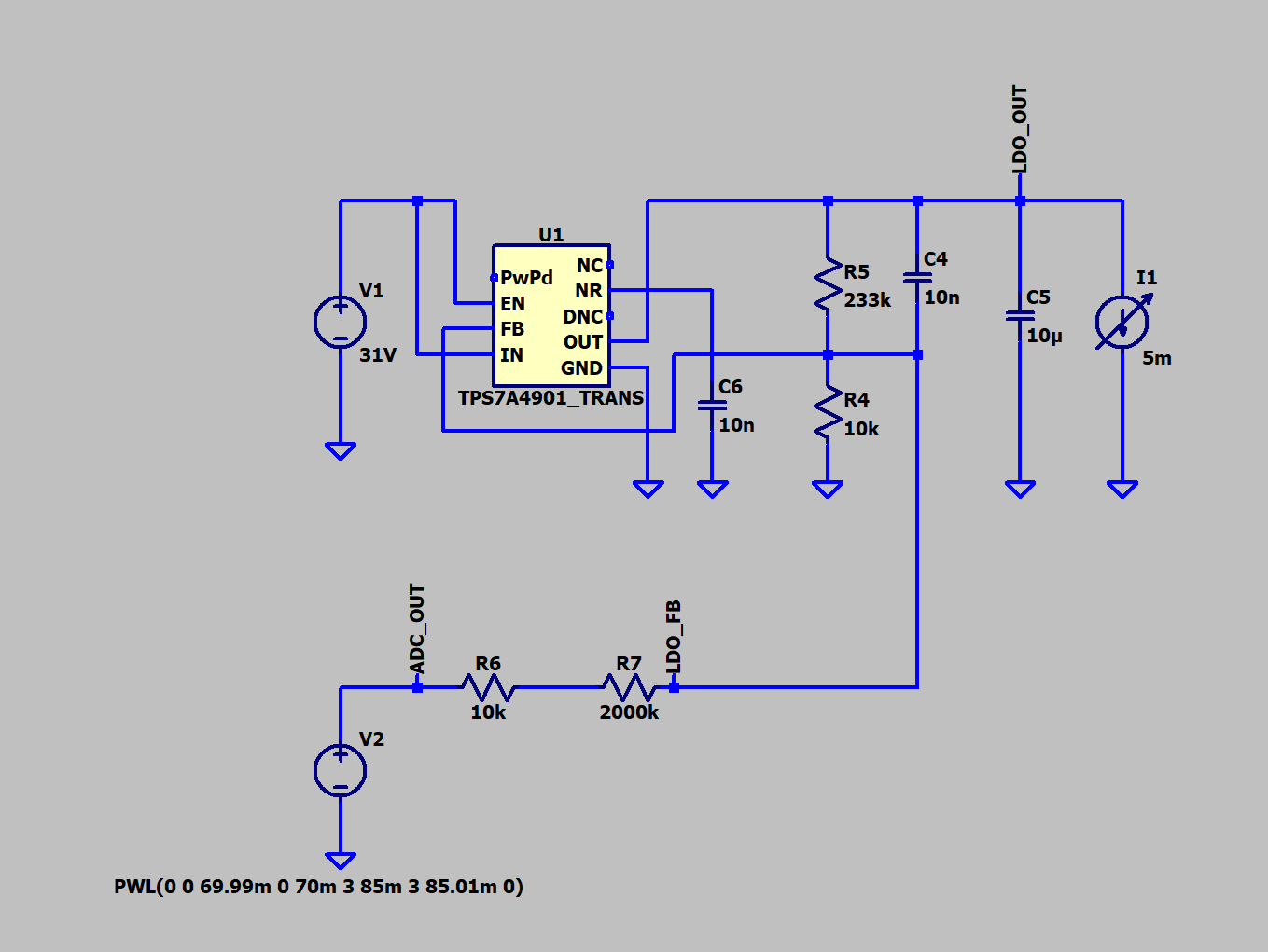

    The silicon photomultiplier (SiPM) requires not only a stable bias voltage, but also temperature-dependent voltage adjustment. This is necessary to compensate for the parameter called "temperature dependence of Vbr" (breakdown voltage), specified in mV/°C. As the SiPM temperature increases, its breakdown voltage shifts, causing its detection characteristics to change. To maintain consistent meassurements, the bias voltage must be increased proportionally - by the specified mV/°C value for each degree of temperature rise.
    The TPS7A4901DGNR regulator uses a feedback (FB) pin to monitor its output via a resistor divider. By injecting additional voltage into this node, we trick the regulator into sensing a higher-than-actual output, causing it to reduce the real output voltage. This provides a mechanism for precise voltage adjustment through an external control signal directly from microcontroller or via DAC for better precision.
    I didn't simulate gathering the actual temperature, as this seems easy.
    The diagrams were made in LTspice, and then raw output files were parsed in Jupyter Notebook Python to produce the above diagrams; this way, the diagrams look much better, and it's possible to do extra math.
    Jupyter Notebook is a web server that acts as a nice wrapper for small scripts, etc.; it's not a full IDE, but it works great for small snippets of code. It's containerized and launched inside Docker, but the web port is exposed so that on the host it can be accessed via a web browser.

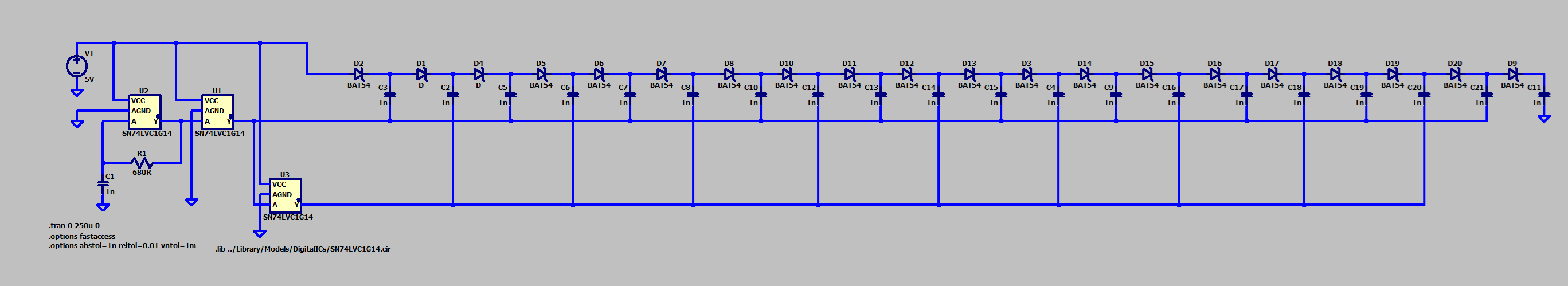

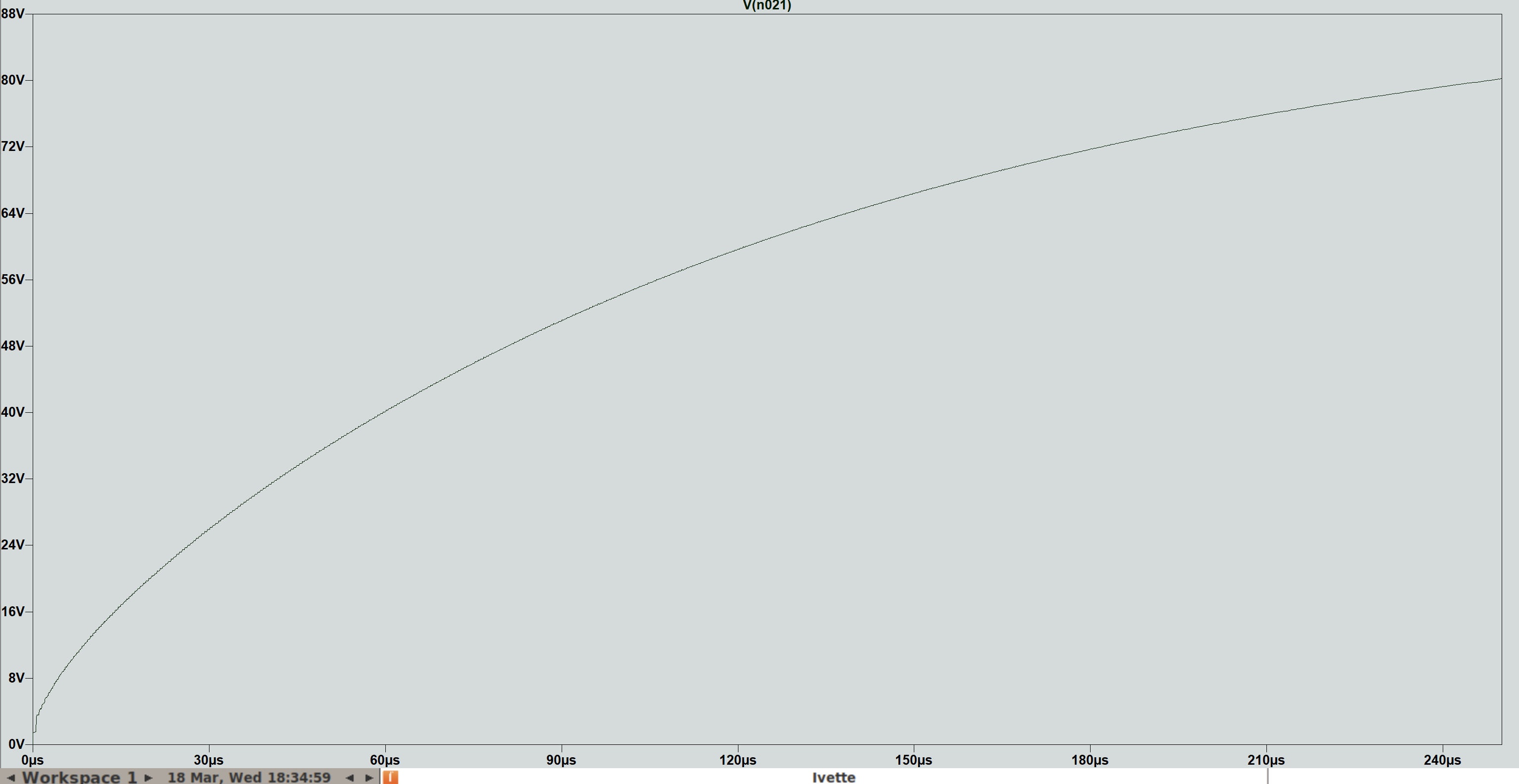

    I was thinking about a DC/DC converter to produce the needed -70V, but then I would need a coil or a transformer in it, and I don't want to mess up the small signal from the diode with EMI interference from a coil. Maybe that's not a problem at all; I don't know, as I haven't built such a thing before.
    I then moved toward a voltage multiplier and designed a Dickson charge pump using LTspice, which at least in theory would give me the needed -70V from a usual 5V. Here is the circuit and simulation:
    Will this circuit work in real conditions with all the parasitic capacitances, resistances, etc? I don't know, so I will put space on the PCB for both batteries in series and this charge pump. If the pump works, great, if not, I will use batteries in the first prototype.
