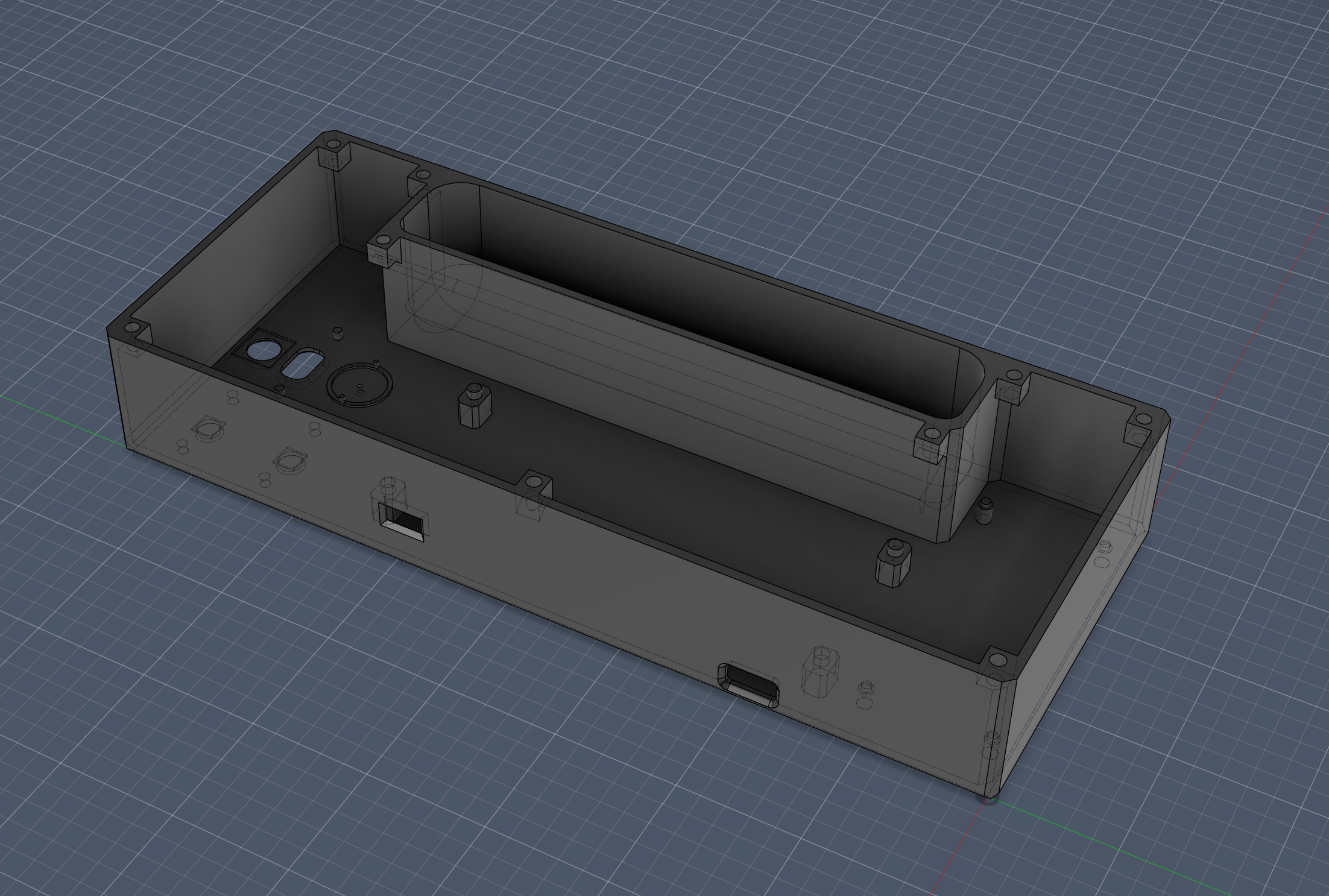

    The housing/case, whatever you want to call it has evolved quite a bit since the last update.
    I've iterated and come up with something that whilst quite brutalist and monolithic, still feels 'hand held' and depending on the size of said hands, should be comfortable in one hand. Have been through about a spool of PLA getting things like hole and standoff placement just right, even with calipers and a keen eye, it takes a little tweaking each time.
    I'm still working on the idea of creating layers.
    This first 'base' layer will be housing the Radiacode 110, powerboard with double 5000mah 3.7v battery cell things, 1x ESP32-S3 board, which will be the main sensor board, the rear facing 5MP OV5640 camera along with IR thermal sensor, the 10w LED flashlight, UV light and omnidirectional microphone.
    We'll see how things fit but the next layer is planned to hold the 2x ESP32-S3 boards for the cameras, the 9-way sensor (IMU, mag, comp) and the GPS module. probably need to fit the push button pcb on this layer too.
    The top layer will have the front facing cam and mic, same as the bottom layer. It will also have the screen with it's ESP32-S3 and the gas/temp/humidity sensor.
    I think that's all the things?

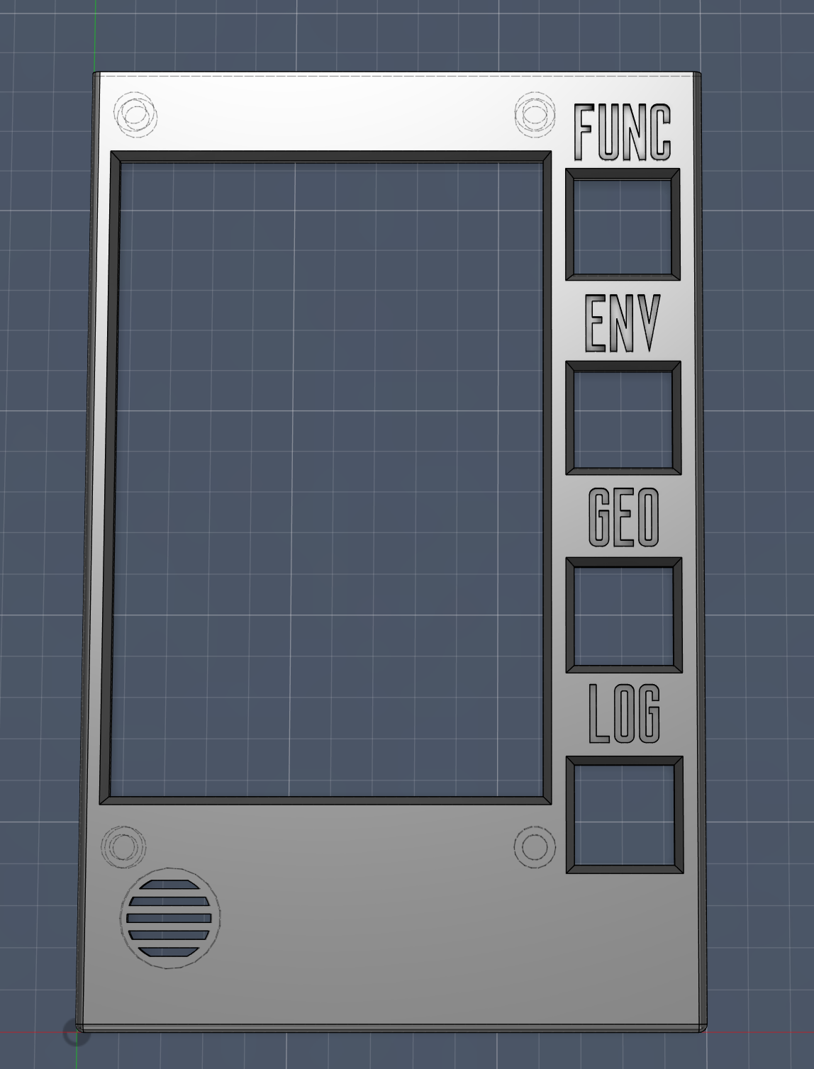

    So with a working TFT, ToF and a Radiacode, I started to think about the housing and overall design for the project. I had wanted to go with a flip design originally, like the TNG Tricorder, but that was clearly out of the question if I wanted to be able to have the Radiacode 110 in there, whilst a ridiculously small footprint for what it is and what it does, it's length means that if I were to add flip to the omni-corder, it would still have to be really long. So I scrapped that idea and have gone with just a chunky unit. First design was just a box with space for the screen and a slot for the Radiacode to slide into. A key consideration in this whole design is that I want to be able to take the Radiacode out easily so that I can use it standalone still.
    The second iteration of this came after I started to flesh out the UI concept a bit more. I decided that rather than having everything on the touchscreen as I had planned at the start, I'd add some physical buttons for the mode and page switching. I thought this would give the device a nice retro-futuristic vibe, be practical and free up UI screen space and be a direct call-back to the TNG tricorder design.
    So that's what's happening with that.
    First concept was to have everything slot in from the top, then have a 'cap', housing sensors, connect to the top to finish it off.
    Next itiration was to create a layerd approach to the unit, still with the cap idea.
    Now I'm working on a third iteration, where I'm scrapping the whole cap concept and leaning fully into the layers idea and since the entire project direction recently switched to using 3 ESP32 boards rather than one, a complete design overhaul is needed.

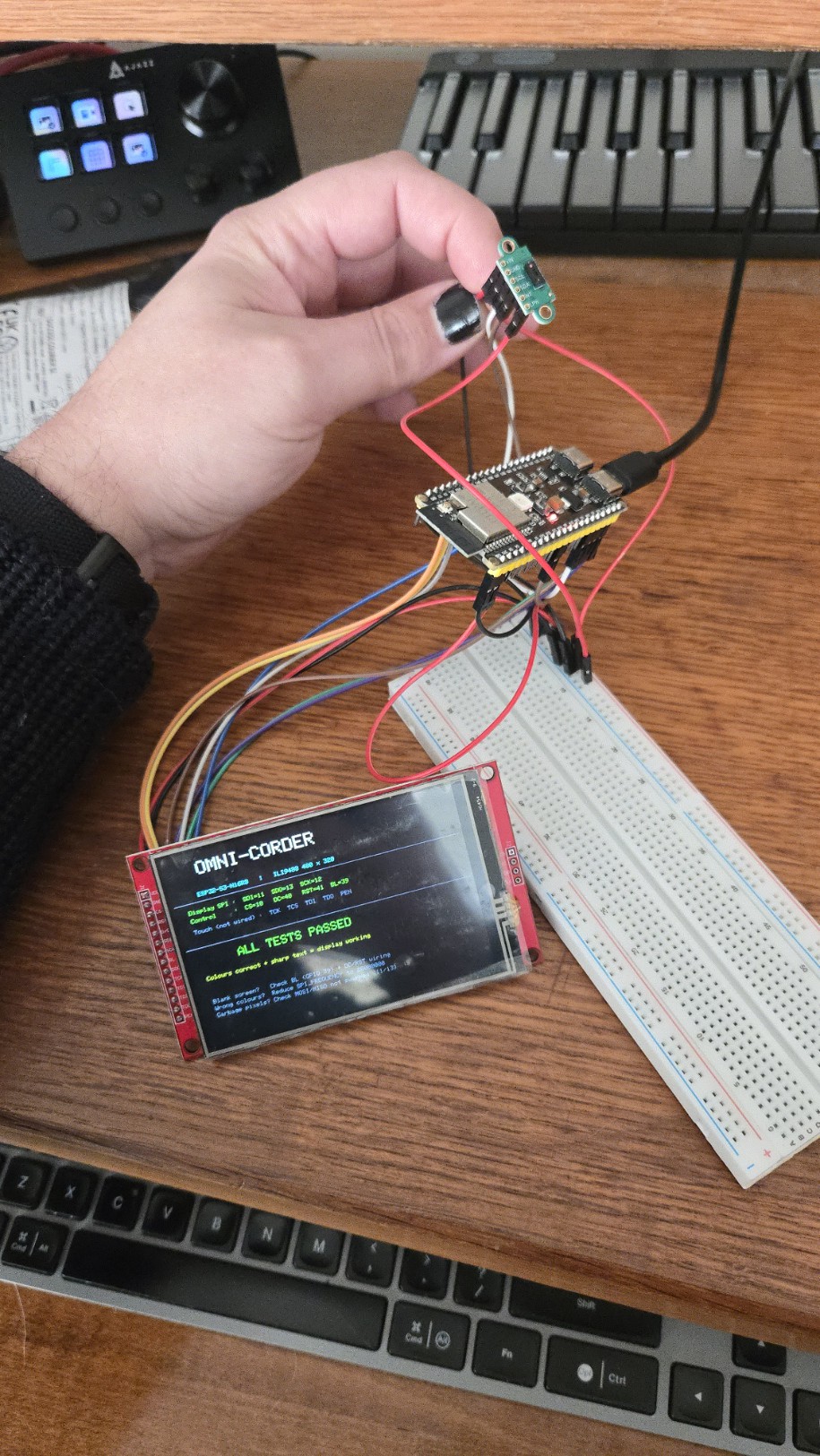

    Phase 1: Display + ToF
    Duration: ~3–4 hours (estimated)
    Activity: Hardware bring-up, debugging, combined display demo
    This was the main hardware bring-up session. Several issues encountered and resolved before everything worked. The main issue was that the TFT did not work as expected and there was basically no help or documentation online.
    Display (ILI9488) bring-up
    Wired ILI9488 to ESP32-S3 per pin assignments in TECH_STACK.md. Initial attempts failed silently or crashed.
    Issues encountered:
    1. Guru Meditation / StoreProhibited at boot — caused by using GPIO 35/36/37 for SPI. These are internally wired to the OPI PSRAM chip and cannot be used as general GPIO. Moved SPI to GPIO 10/11/12.
    2. Guru Meditation even with bare sketch — flash mode was DIO. The N16R8 requires QIO mode. Added `board_build.flash_mode = qio` and `board_build.arduino.memory_type = qio_opi` to platformio.ini.
    3. Serial Monitor completely silent — ESP32-S3 native USB requires `-DARDUINO_USB_CDC_ON_BOOT=1` build flag. Without it, the Serial class has no output.
    4. Crash inside tft.init() — TFT_eSPI defaulted to SPI3 (GPIO 35/36/37 area). GPIO 10–12 are on SPI2. Fixed with `-DUSE_HSPI_PORT` and `-DTFT_MISO=-1`.
    After resolving all four issues, the display worked correctly: full 480x320 colour, correct colours, no flickering.
    ToF Sensor (VL53L5CX) bring-up
    Wired VL53L5CX to I2C on GPIO 8/9. Added external 4.7 kOhm pull-ups on SDA and SCL.
    Issues encountered:
    5. VL53L5CX header not found — include path was wrong. Correct header is `SparkFun_VL53L5CX_Library.h` (not `_Arduino_Library.h`).
    6. I2C Error -1 / sensor not responding — AliExpress breakout has no onboard pull-up resistors. Added 4.7 kOhm from SDA to 3.3 V and SCL to 3.3 V externally.
    7. Sensor dots (retrying forever at startup) — LPN pin was floating. Wired LPN to 3.3 V. Sensor responds immediately after.
    After resolving issues, sensor confirmed working. Reads 8x8 depth array (64 values per frame)...
