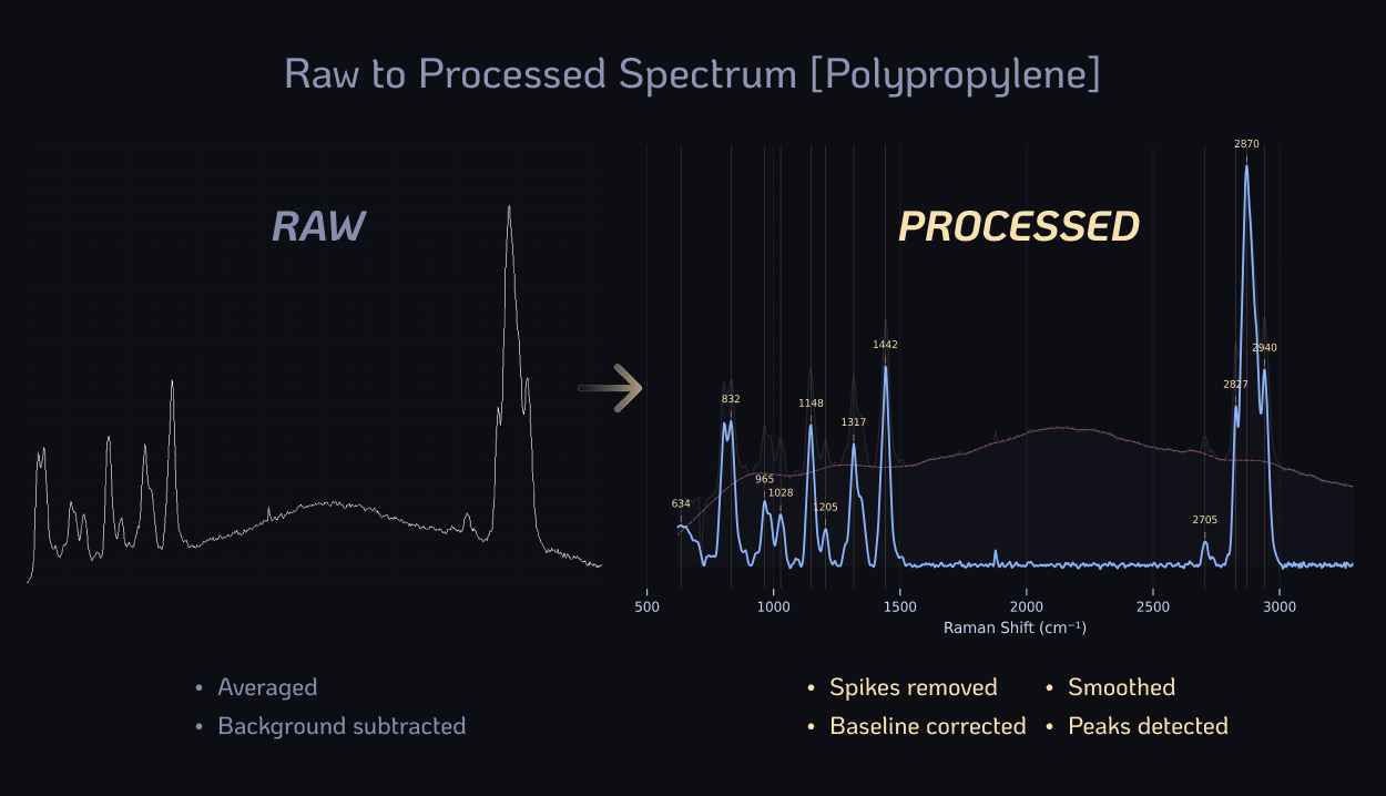

Signal Processing
The acquired spectrum is processed to remove residual background and fluorescence and make it legible: cropping and Raman-shift conversion, cosmic spike removal, baseline correction (ALS / arPLS / SNIP), smoothing and normalization. Peaks can additionally be detected, fitted (pseudo-Voigt) and matched against a reference library - though fitting matters more for high-resolution, calibrated instruments than for this one, where the 100 µm slit sets the resolution floor.

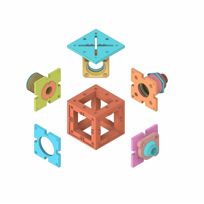

    Step 2 — 3D Printing Notes
    All parts print without supports, and each is printed only once (except where noted in the parts table on GitHub). I printed on a Bambu P1S with a 0.4 mm hardened steel nozzle, sliced in BambuStudio.
    Material: ideally dark, non-reflective, and stiff. I used black PETG-CF (matte, my favorite); PLA-CF is a sensible alternative.
    Settings:
    • Layer height 0.12 mm — at least for anything with threads or fine features
    • 4 walls, 50 % gyroid infill
    • Seam position Nearest (or Random) for better thread fit
    • "Precision" parameters set to 0.001 mm (may just be placebo)
    Orientation: print faces flat / perpendicular to the build plate — especially threads, which must be printed vertically for clean engagement. "Auto-Orient" should always do the trick.
    Overview Graphic; be aware that parts might have been slightly modified!
    Order & tips:
    1. Print Base-Cube, Base-Cube-Top and the four Cube-Inserts (Sample, Dump, Laser, FilterFocus) first, then the remaining grouped parts.
    2. The Base-Cube is the most demanding part due to overhangs — everything else is easy.
    3. For the Cube-Inserts and Cube-Lid, let the build plate cool fully before removal, or you risk permanently warping the part.
    4. Also print the two spanner tools (Spanner_SM1RR, Spanner_SM05RR) — they make tightening the retaining rings much easier later.

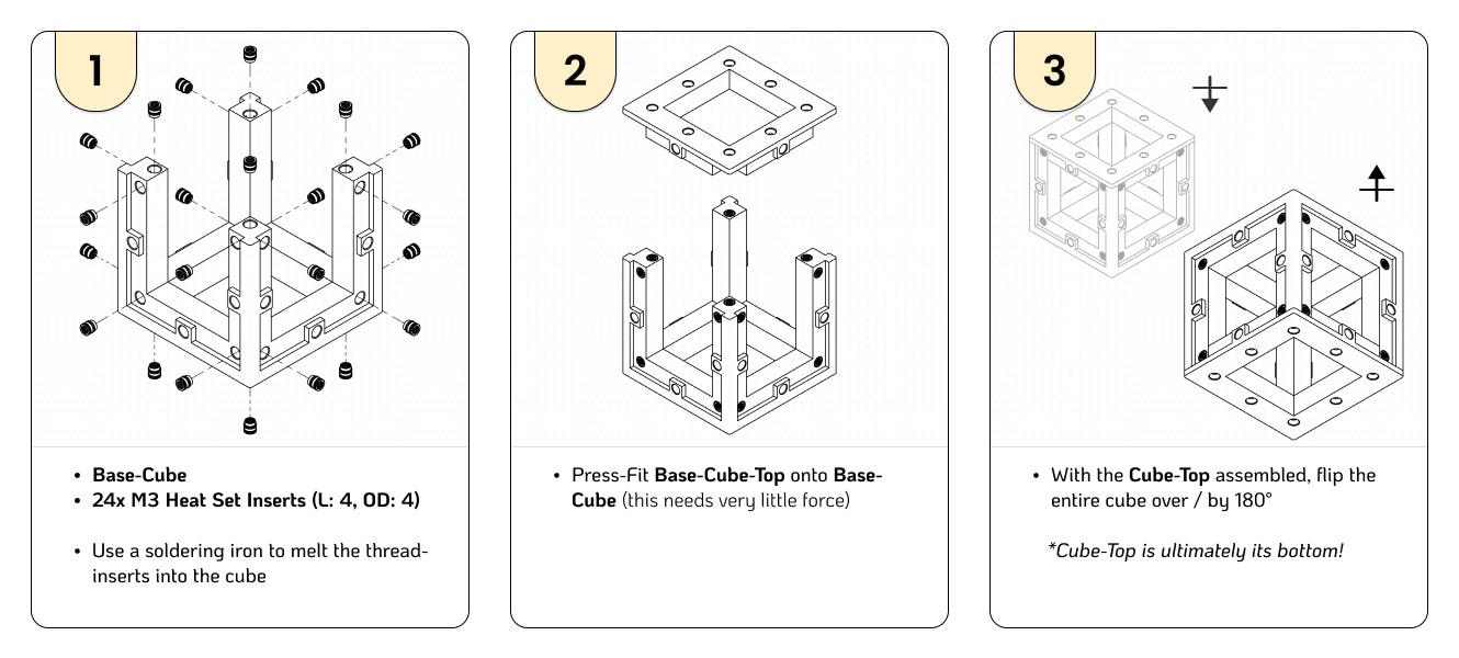

    Step 3 — Base Cube
    Printed: Base-Cube, Base-Cube-Top
    Sourced: 24× M3 heat-set inserts (4 mm length, Ø4 mm), 24× M3×8 screws
    1. Melt the heat-set inserts into the bosses of the Base-Cube using a soldering iron. Keep the iron perpendicular and let the plastic — not force — do the work.
    2. Fasten Base-Cube-Top with M3×8 screws.
    You don't have to populate every insert at first. I initially left out the bottom row and one full side — the side that later takes the Beam Dump — because that opening doubles as access to the adjustment screws of the 45° mirror inside. The Cube-Insert clearances are relatively tight (tighter still if the cube's overhangs sagged a little), and during testing I ran most inserts on just 2 screws (top-left + bottom-right).
    The following sub-assemblies (Steps 4–7) don't need to be built in order.
