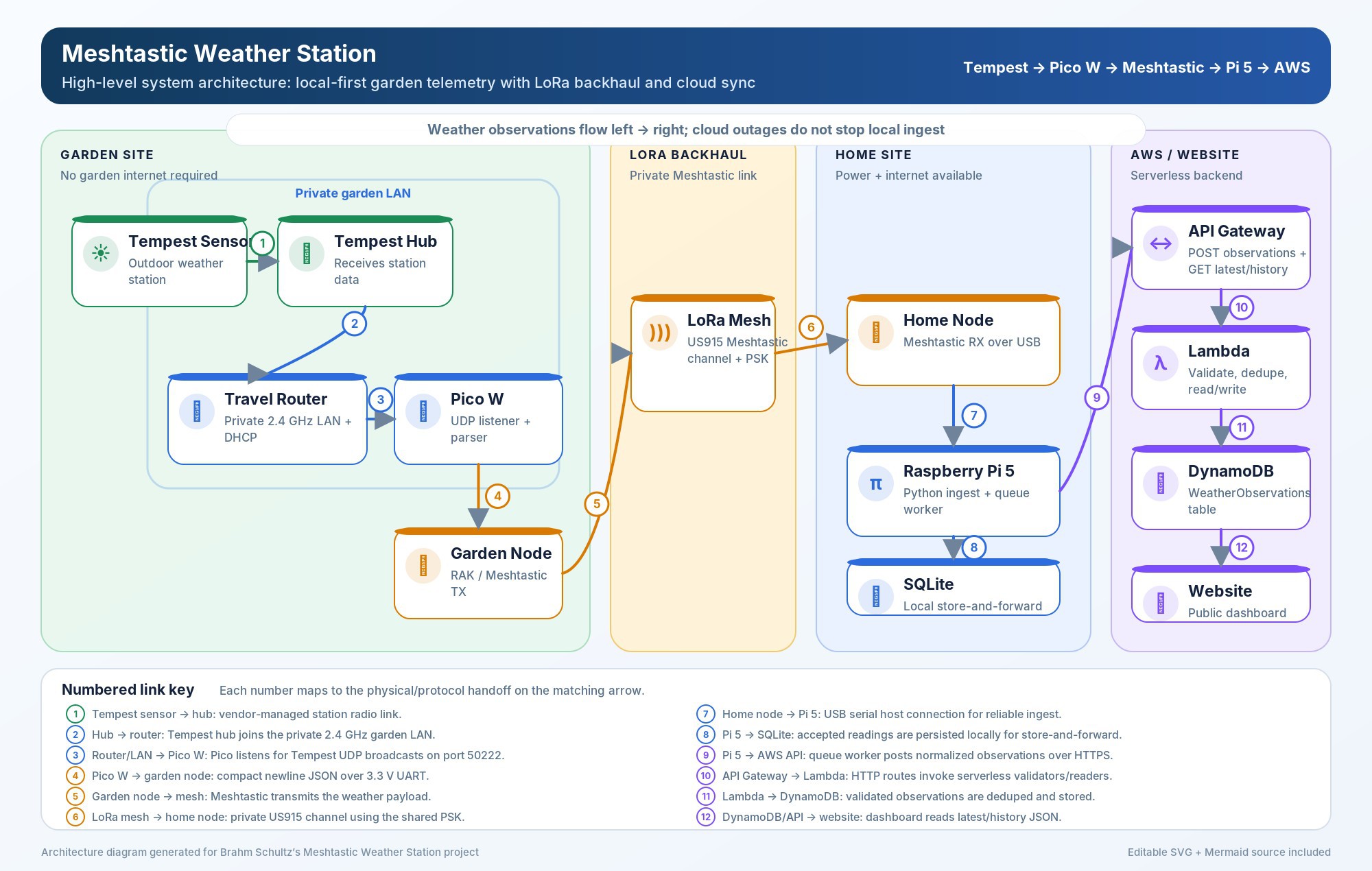

Weather is collected using a WeatherFlow Tempest station and transported back to the house over a long-range Meshtastic LoRa link. A Raspberry Pi 5 then ingests, stores, and forwards the data to AWS for visualization and long-term storage.
The goal is to build a reliable, low-power pipeline from sensor → radio → server → cloud.

Tempest Sensor → Tempest Hub (Wi-Fi LAN) →Wireless Mini Portable Travel Router → Raspberry Pi Pico W (UDP listener) → UART → Garden Meshtastic Node → LoRa Mesh → Home Meshtastic Node → USB → Raspberry Pi 5 Server → Local storage (SQLite for store and forward) → AWS API ( self hosted api later)

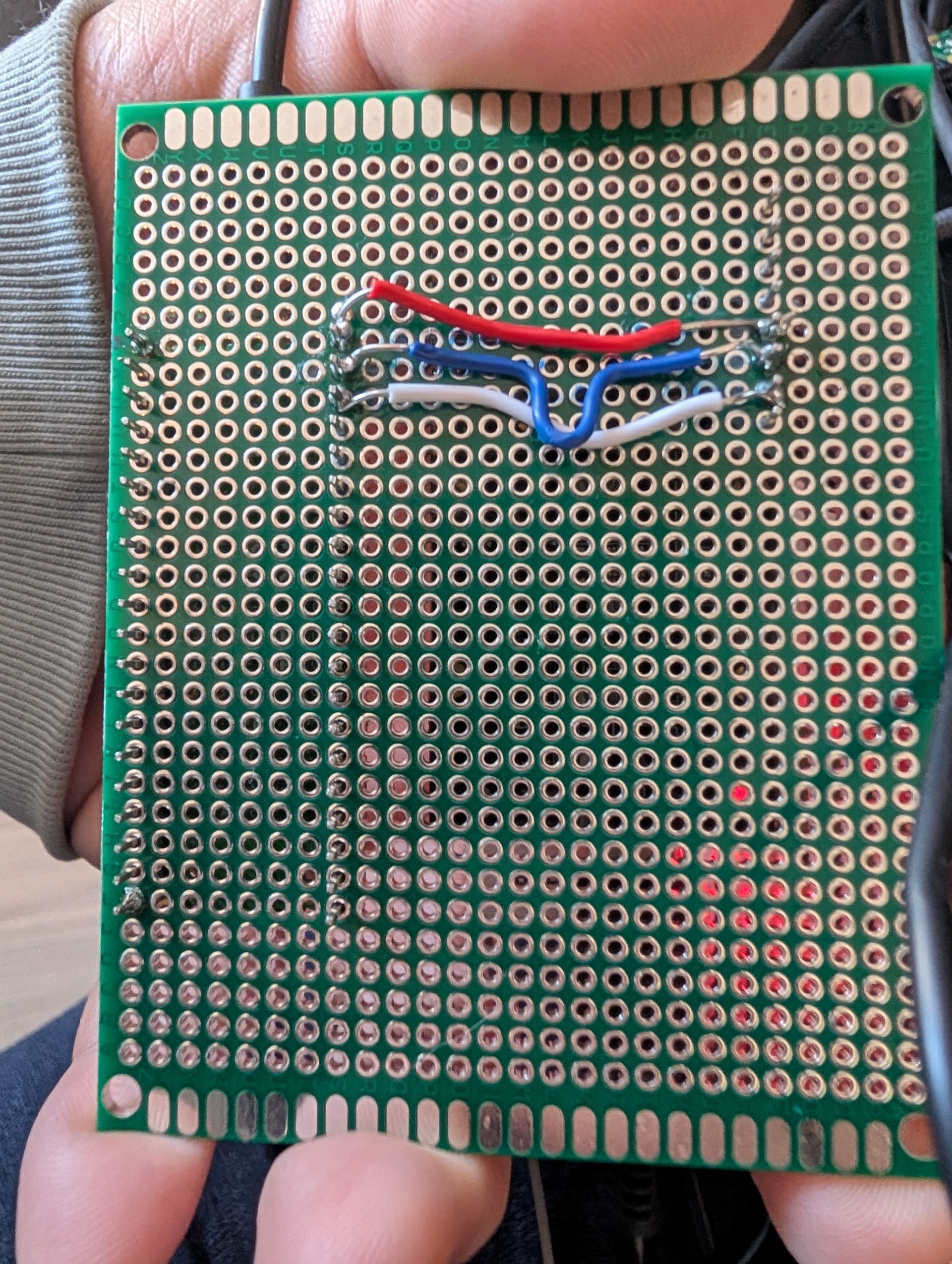

    6. next connect the pico to the rak4631 garden node as shown below:
    Pico GP0 (TX) -> RAK RX1
    Pico GP1 (RX) -> RAK TX1
    Pico GND      -> RAK GND
    you can use jumper cables or solder wires, in the image shown i have a used 9*15 mm perfboard and soldered wires.
    back of perf board
    soldered wires to the pins

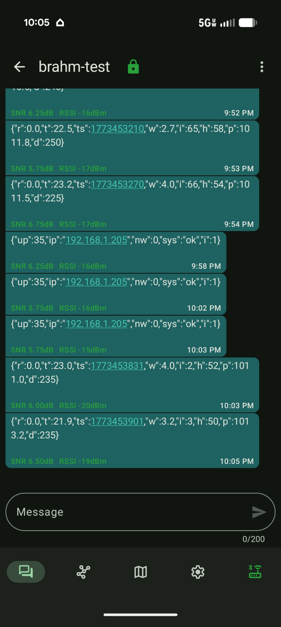

    7. plug in the rak4631 home node and connect with the meshtastic app. Make sure both nodes are using the same channel and frequency config.
    8. you should see messages flowing from the mock weather station to the pico over udp on wifi, then to the rak4631 garden node over uart, and finally to the home node over the meshtastic network. you can verify by checking the meshtastic app and connecting the home node to view the messages.
    messages flowing to home node viewed on the meshtastic app
