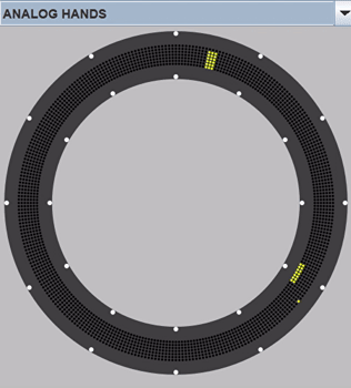

Can we imagine a non-standard flipdots matrix? What about a ring instead of a rectangle? With around 300 segments, the angle between them drops below 2°, which is good enough to make the circle feel continuous and visually acceptable.
And it’s now almost natural to see it as a clock.

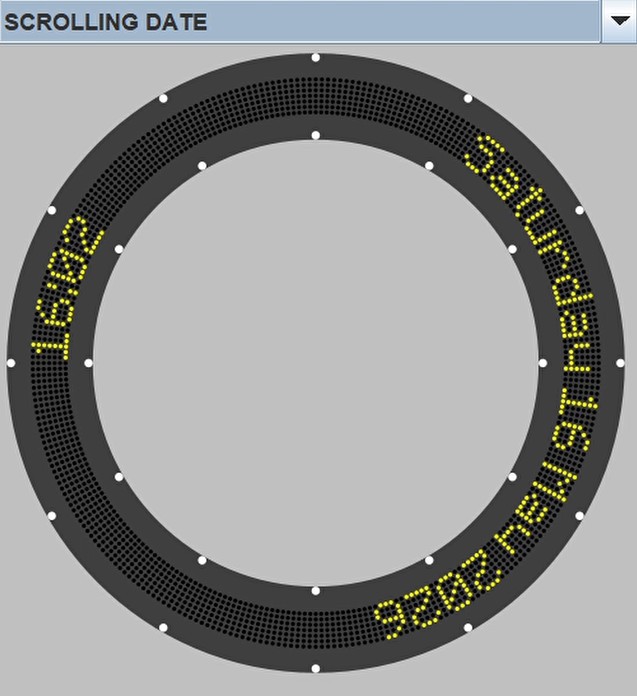

So far, I have the following features: – WiFi hotspot for setup from a computer or phone – Time synchro once per day via NTP – Night mode: dots updated only every 10 minutes for quieter...
