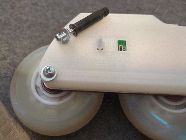

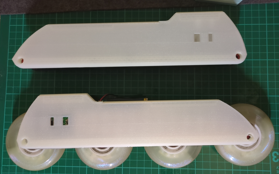

    I made an appointment at my local library to print the left and right faceplates on their Bambu Labs X1C printer. It came out with a great surface finish from the PEI build plate. The natural PLA diffuses the light nicely. I'm so incredibly glad resources like this are available to the public. Since these parts are printed as a single piece, they should be robust enough for field testing.

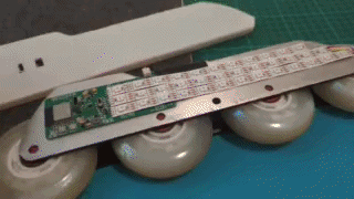

    I've printed a split version of the faceplate in natural PLA on my small printer, then glued it together to get a rough idea of the look and fit. I also tested how the code worked with the lights. Despite how rough it looks, I'm pleased with the result. I just need to figure out a simple reliable way to attach the faceplate. I may just use double sided tape for a first try. I also need to tune the parameters in my code so the lights seem more responsive.

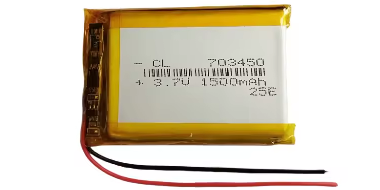

    For initial testing, I've been using an unlabeled battery from a conference badge I had lying around. It just happened to have the 2 pin JST PH 2mm female connector. I checked the polarity and voltage with my multimeter. Voltage was correct, but black was positive and red was negative. So I traced the wire to the battery protection circuit and it had the correct plus and minus symbols to back my findings. I charged it up and plugged it in... then it powered right up. Ran my test code without issue. I was a bit surprised, not sure why I was expecting something to fail.
    Since I don't want to rely on that old battery, I started to search for one online. I wanted something that would last a few hours, I decided to look for a 1500 mah, since I've seen plenty of lit up badges run off one for the day, so long as they aren't at max brightness. I started looking for a battery pack on Aliexpress. I have some size constraints for the little gap between the frame and boot. The frame is 34mm wide, the height of the gap is 10mm and length about 100mm. After looking for a reasonable priced 2 pack, I found a 3.7V 703450 Lithium Polymer Battery that had the appropriate JST PH connector. It had a protection circuit, so I decided to buy it and paid $13.73 with shipping. I should get the part in a little over a week.

    I took a shot at quickly modeling a faceplate using TinkerCAD using the 3D scan as a reference. I hadn't used it for some time, so I was pleasantly surprised to find that they incorporated a new sketch tool. This allowed me to roughly outline the side of the frame and extrude it. I added some holes and gaps to account for the switch and usb port. I now had a basic face plate to print.
    The library didn't have any slots, so I'll probably split this model in two parts so I can print it on my 3D printer. I'll post some pictures of the first face plate mounted to the frame. I just plan to use some double sided tape. Eventually I'll make someting that attaches more firmly with clips or something.

    Here is the board assembled and adhered to the skate frame.The battery pack lives in the gap between most boots mount points. I forgot to add thermal reliefs to the ground pads for the LED strips when I changed the layout of the board. I was also impatient and adhered the PCB to the frame with some thermal tape. So I had a hard time soldering the ground pads... hopefully there aren't any major cold solder joints that will break when I subject this to vibrations on the asphalt.
    Fortunately everything else is still working. It remains low profile. So now I just need to 3D print a translucent cover to act as a light diffuser and dust/debris protection. I'll eventually add a conformal coating, but I expect to need to make changes as I test this.
