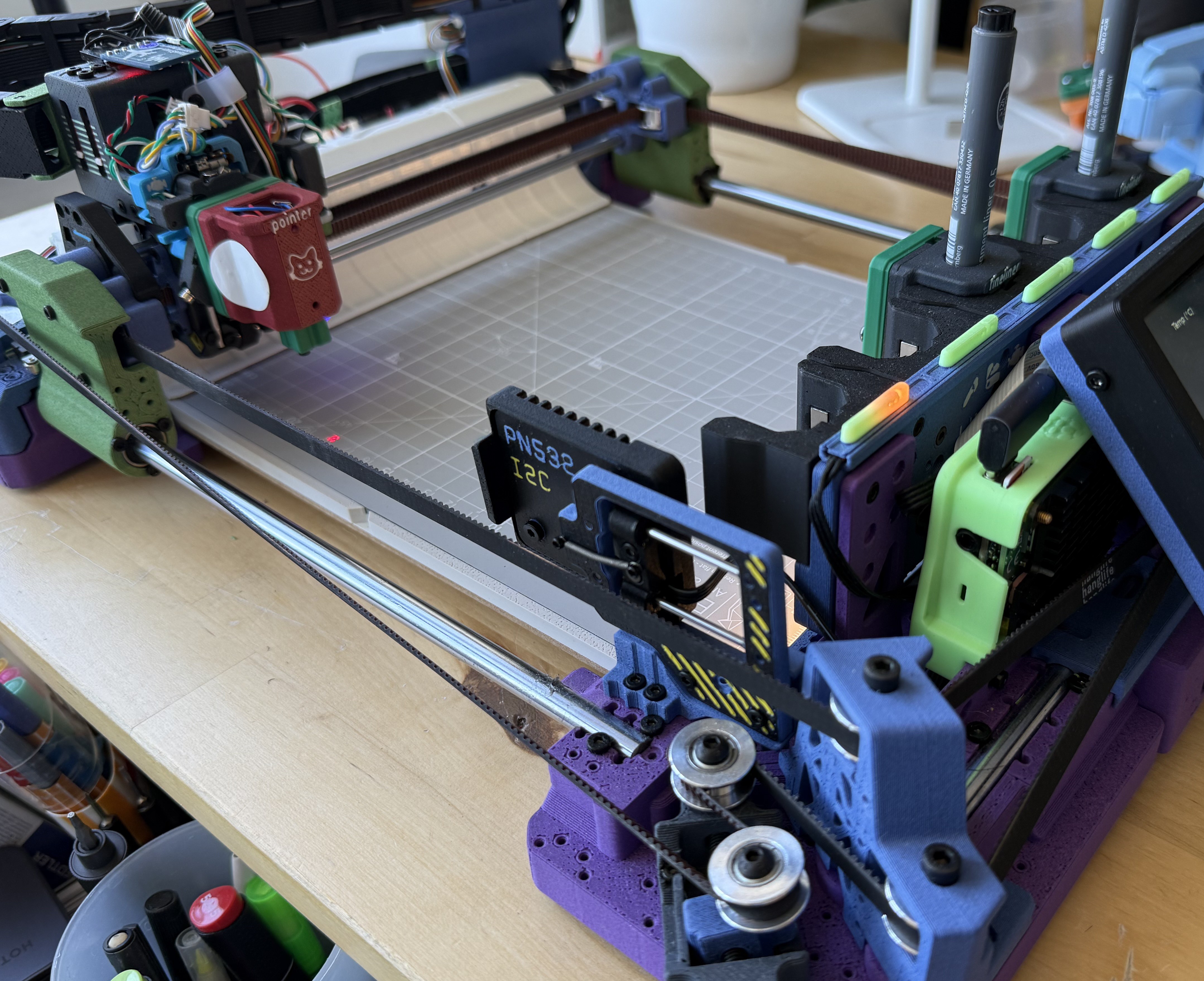

Limn is a Pen Plotter with an E3D style toolchanger. I built it using parts reclaimed from an old 3D printer, some new hardware parts, and 3D printed parts. It runs using Klipper and PrusaSlicer, similar to a regular printer.
Some key parts can be obtained from old 3D printers:

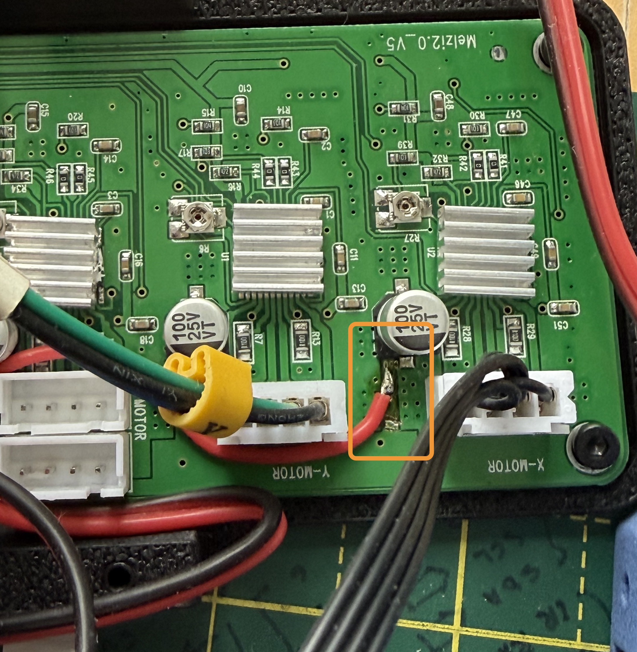

- Control Board (Melzi V2, modified to have 5V stepper voltage on two axes)
- 2x NEMA 17 Stepper Motors
- 8mm rods for the edges (Size can be variable, but need 2x of same length for X axis)
- 2x 6mm rods for the Y axis
- 6 & 8 mm linear bearings
- Idler pulleys
Apart from this plenty of screws, bearings, and belts are needed.

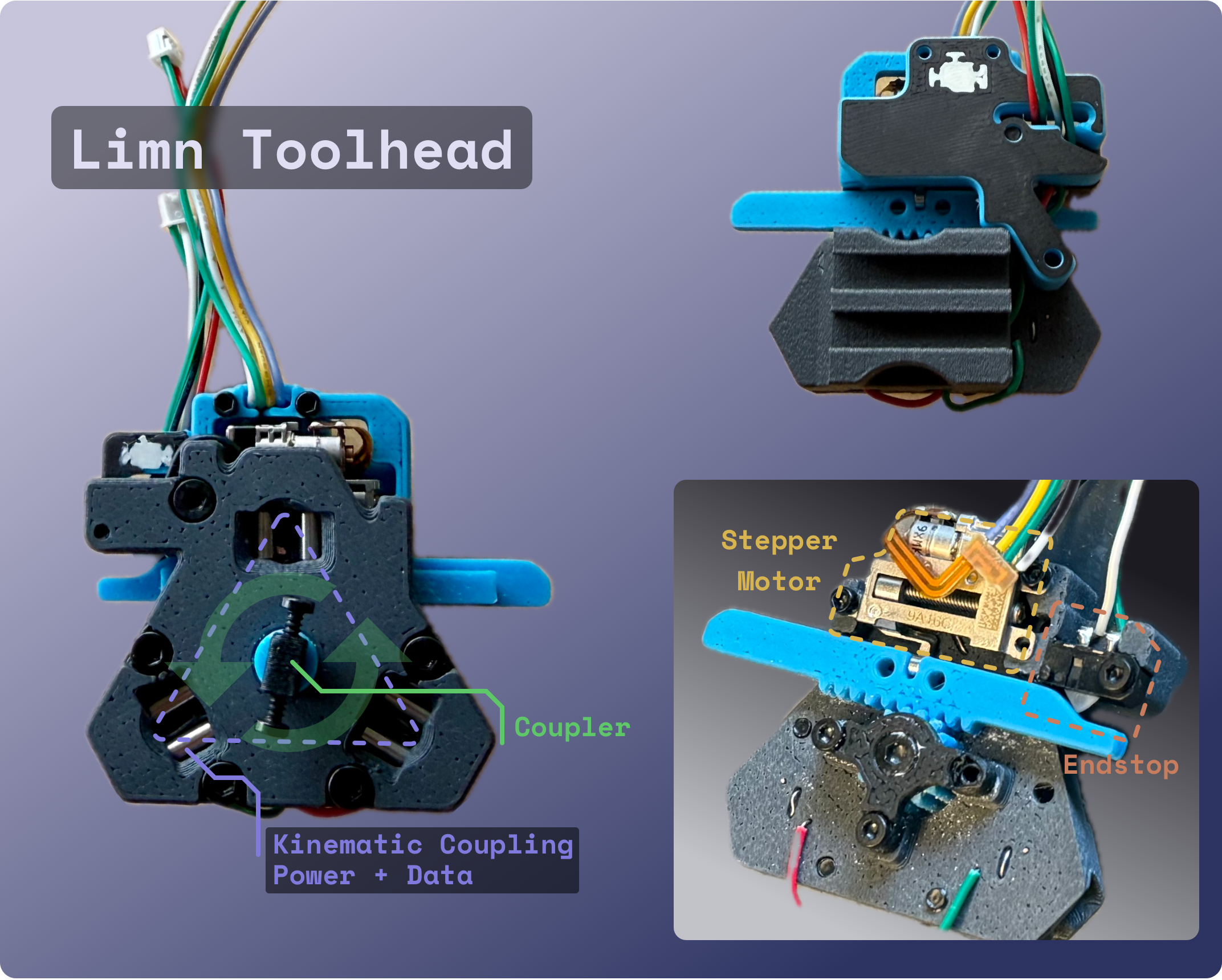

The design uses CoreXY framework. The Z axis is integral to the toolhead.

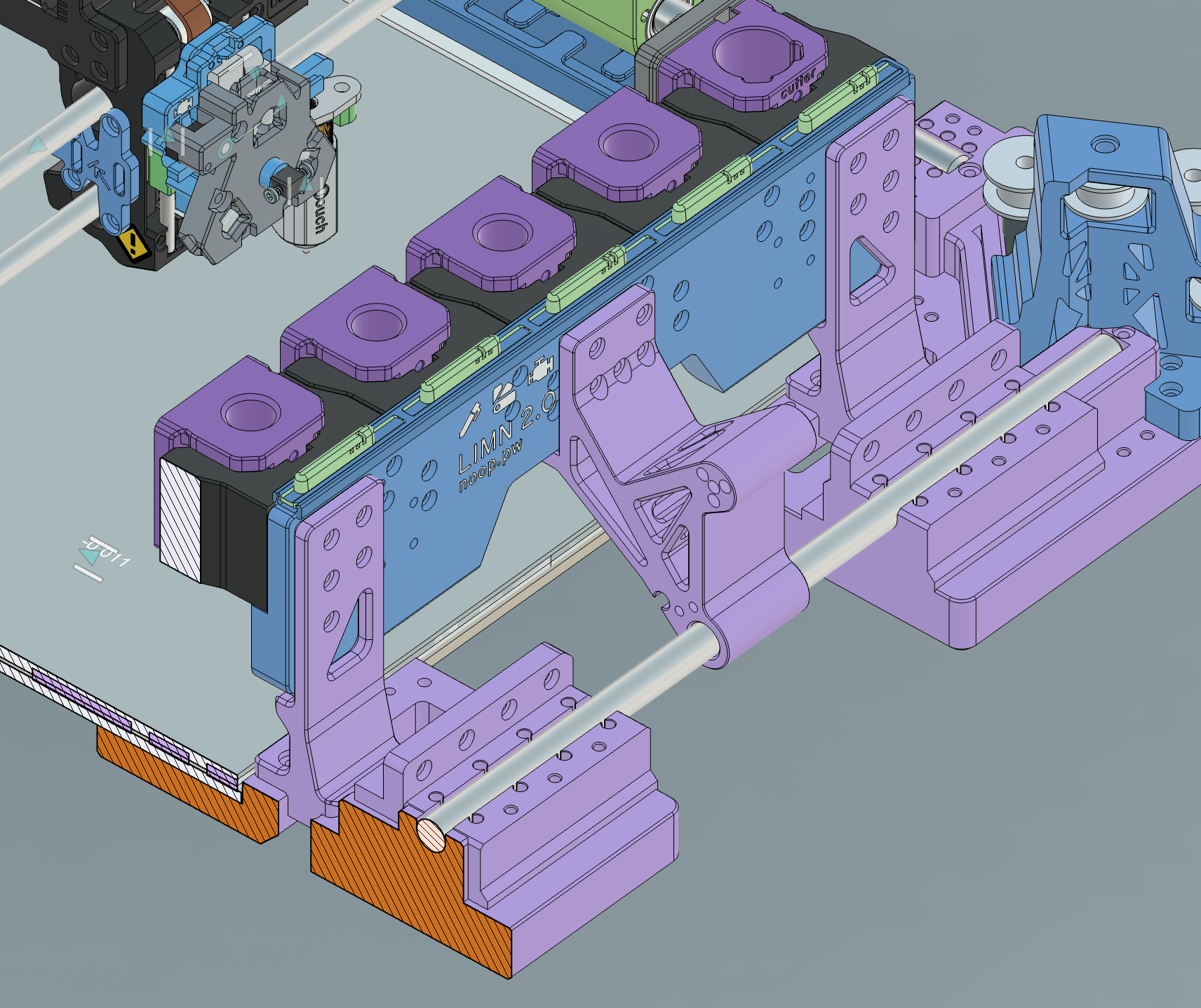

The toolchanger "locking" system uses a tiny linear stepper motor found on Aliexpress, which drives a rack to turn a gear on which the key is mounted. The torque is VERY low and is making it quite challenging to have a successful coupling.
We needed low wobble and low friction, so the rest of the design has to maintain precision for this to work. Also a bit of PTFE lube worked wonders!
The extra wires are conected to the screws and were intended to power/communicate with the tool in future. I've discovered since that the resistance is too high. Will retry or switch to pogo pins later after eliminating the coupling reliability.

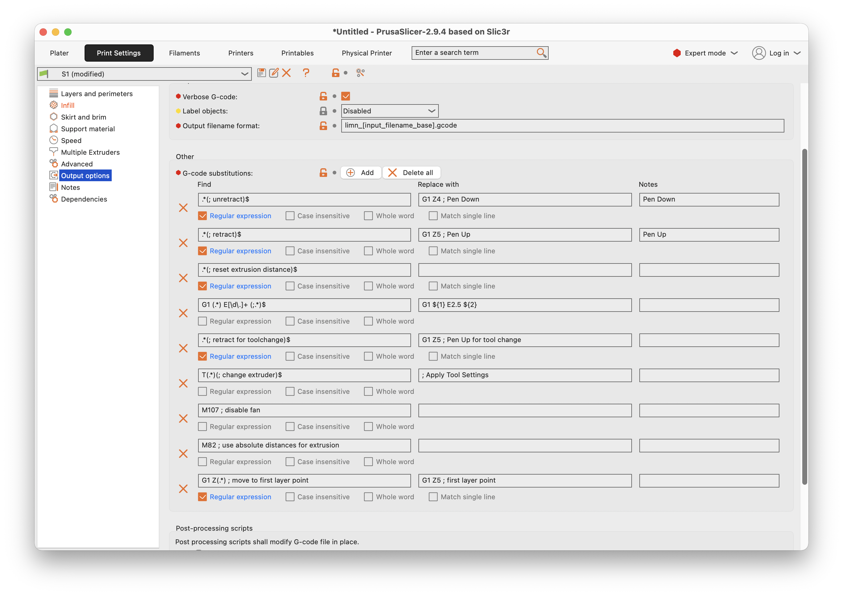

    After a few trials, updated code, and slicer config, Limn is now able to calibrate its tools. I managed to have ~0.2mm precision with the Resistive Touch Panel to align the tools. In fact, I still haven't trialled the Force Sensor Array because the Resistive Panel seemed quite good already -- at least with 0.5mm pens.

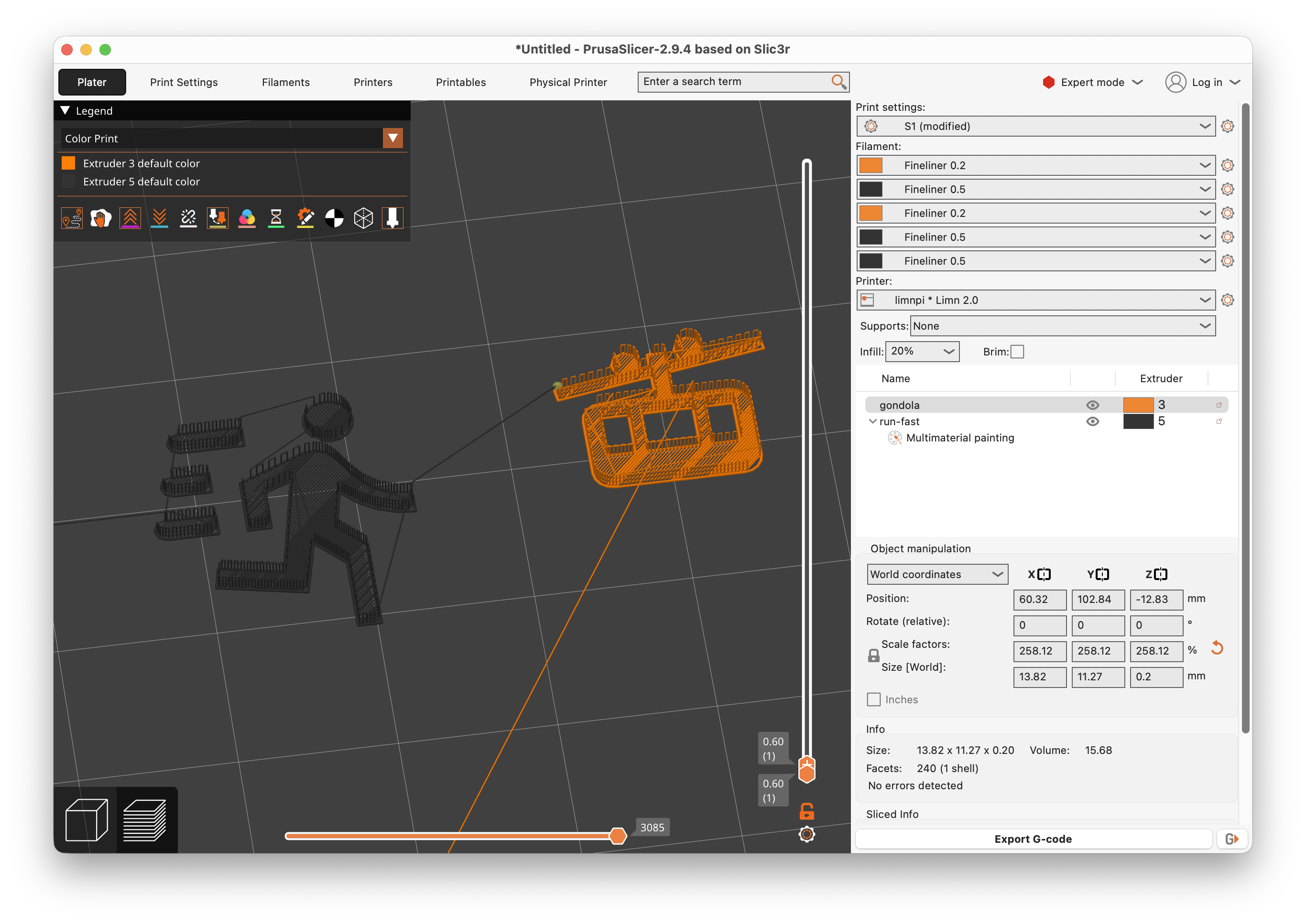

    I'm currently designing a few plots that I'd like to create before moving onto the next step: use the FSR sensor to improve the aligment accuracy.
    Additionally I figured a scheme to plot with more than 5 tools. First I added 5 more extruders in the slicer. On klipper when going from 5th to 6th tool, there will be a Pause and beep -- allowing me to manually swap all the tools.

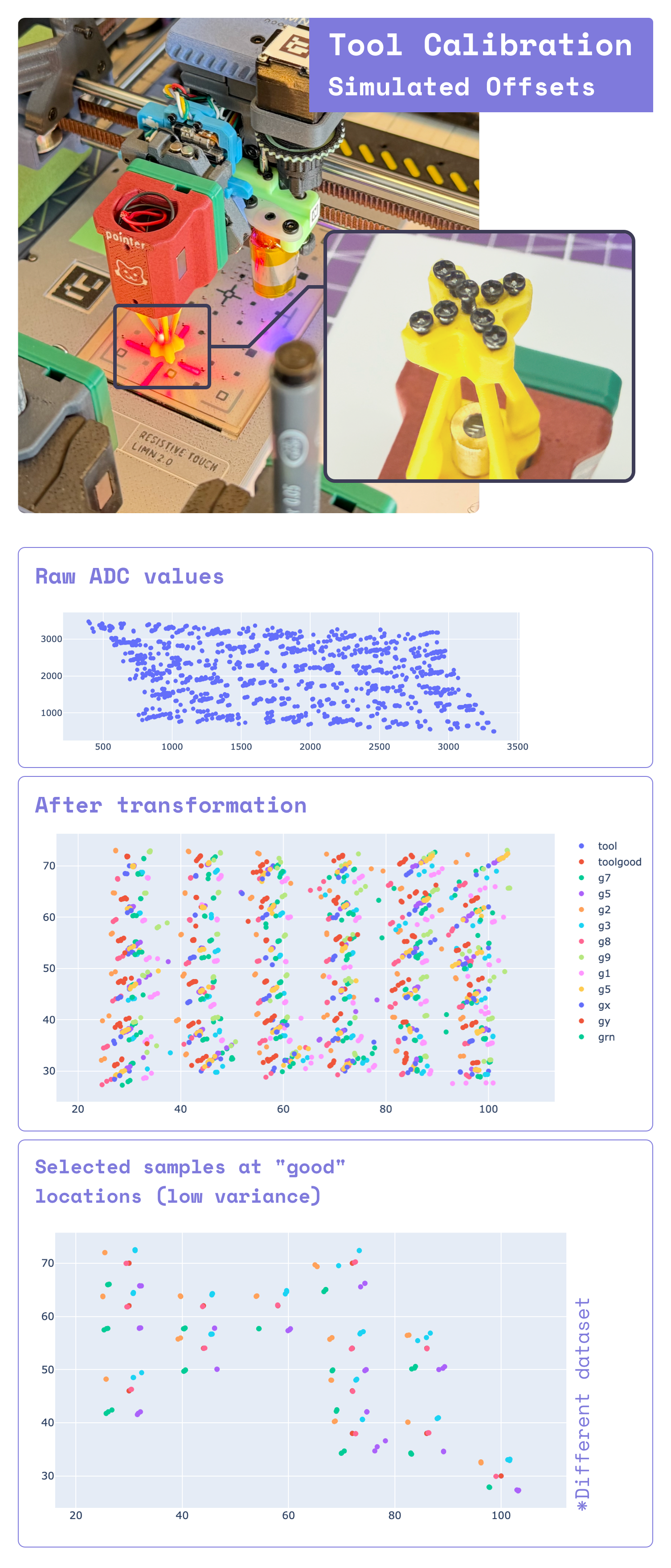

    Using the Resistive Touch Panel I collected an extensive set of samples in order to figure out how to get tool offset. I simulated deviations in XY using this probe (pictured) -- the desired offset from center could be achieved by unscrewing a particular screw a bit.
    There were 9 coordinates in total, and three samples were taken for each points in a grid. Raw values from the Resistive touch panels require filtering and transformation in order to obtain coordinates in plotter's space. Therefore a calibration step takes measurements at three locations (ref. AVR341 app. note) to get transformation parameters.
    Following show the data I collected, indicating that the resistive panels can get us close to alignment. The data and transformation steps are noted here.
    I've since concluded that I'll use the panel for rough XY and precise Z calibration. For getting precise XY calibration, I decided to use an 8x4 2.5mm array of Force Sensitive Resistors (FS-ARR-4x8). Idea being that we can aim for a particular cell and know precisely where we land.

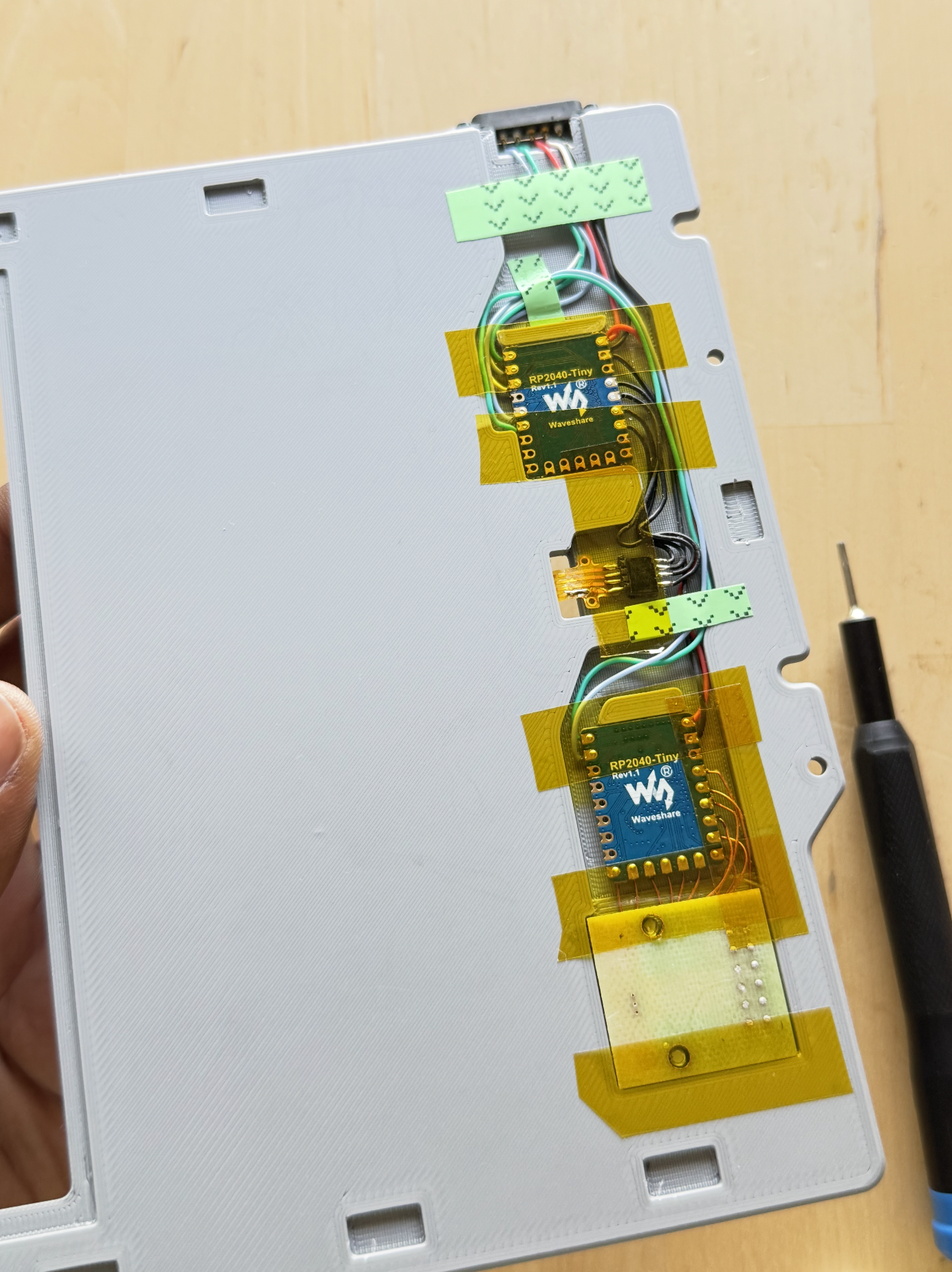

    I modified the bed to have two RP2040 modules (with 4 ADCs) each controlling the Resistive Touch Screen and FSR. I had to make the bed a bit thicker, at ~3.2mm, and sand a FFC breakoutboard to get everything to fit.
    The pogo pins induce noise and having power always present on the pins didn't seem like a great idea, so a third RP2040 can provide the power upon detecting the bed. The detection is by measuring the resistance between two pins on the connector. I posted a demo video:
    The three MCUs run micropython and I'm still working on the firmware. For this purpose we do not need to chase speed so upython seemed particularly nice.
    Here's an early picture of the back side:

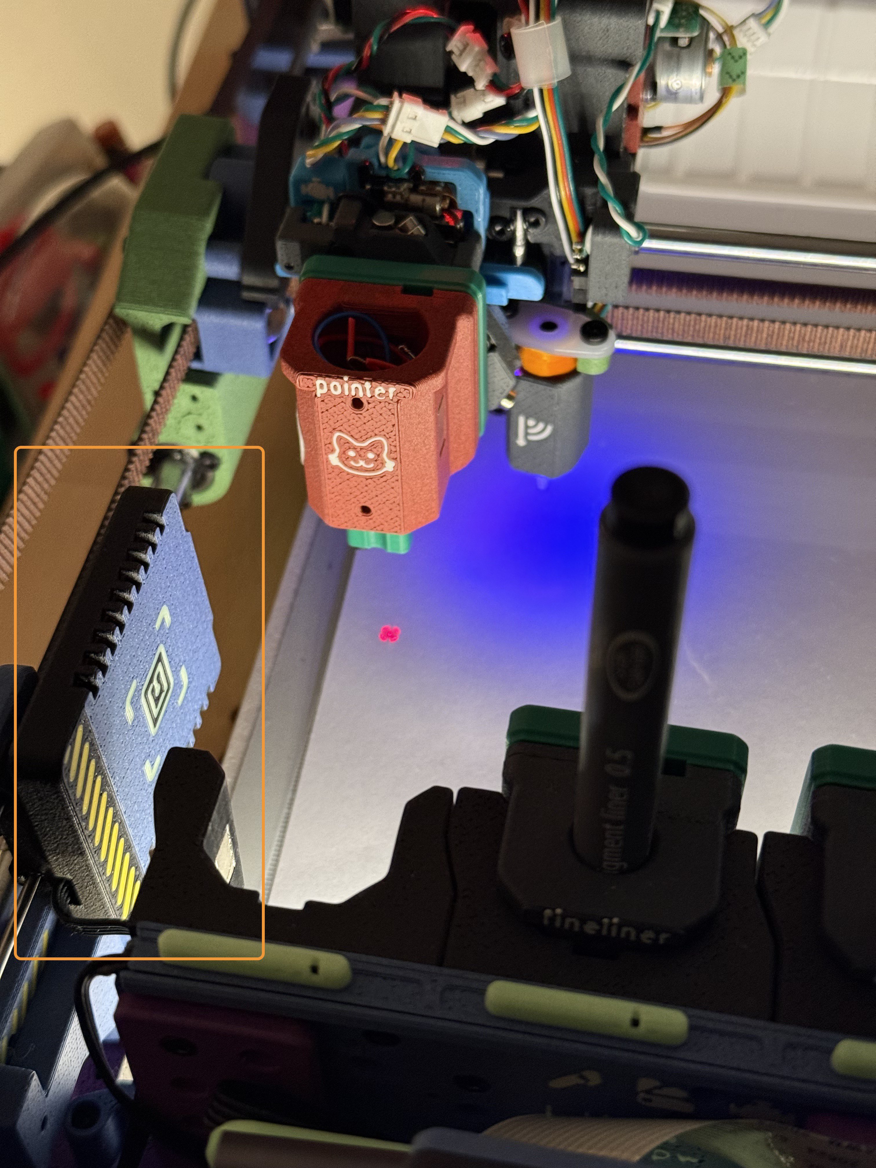

    I finally got around to implementing the initial version of tool alignment. As I mentioned in a previous post, it'd require extra effort to align each pen manually at true zero. Instead we opted for an RFID tag affixed to the tools. The tag currently contains XYZ offsets and a tool identifier. In future for tools such as paint markers we can also store attributes to inform the plotter to purge the pen at a given interval, or for cutting tools, the blade angle and cutting depth.
    To read the tag and apply tool parameters during print run on Klipper, I came up with a method as described below:
    1. Reading Tool Data when docking
    A klipper module is created that allows us to execute arbitrary shell commands. The output of this command would contain the "result" enclosed in a known heredoc style pattern. The gcode can read this result using the `printer` variable. Then we can apply the XYZ offset using `SET_GCODE_OFFSET` command. Of course this is a potential security vulnerability if we run unknown gcode, but something to be improved later (quite easily).

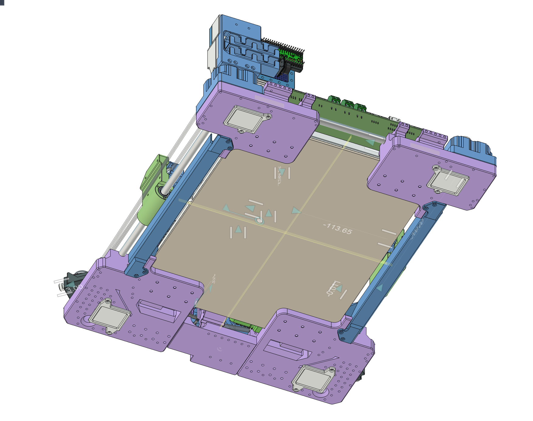

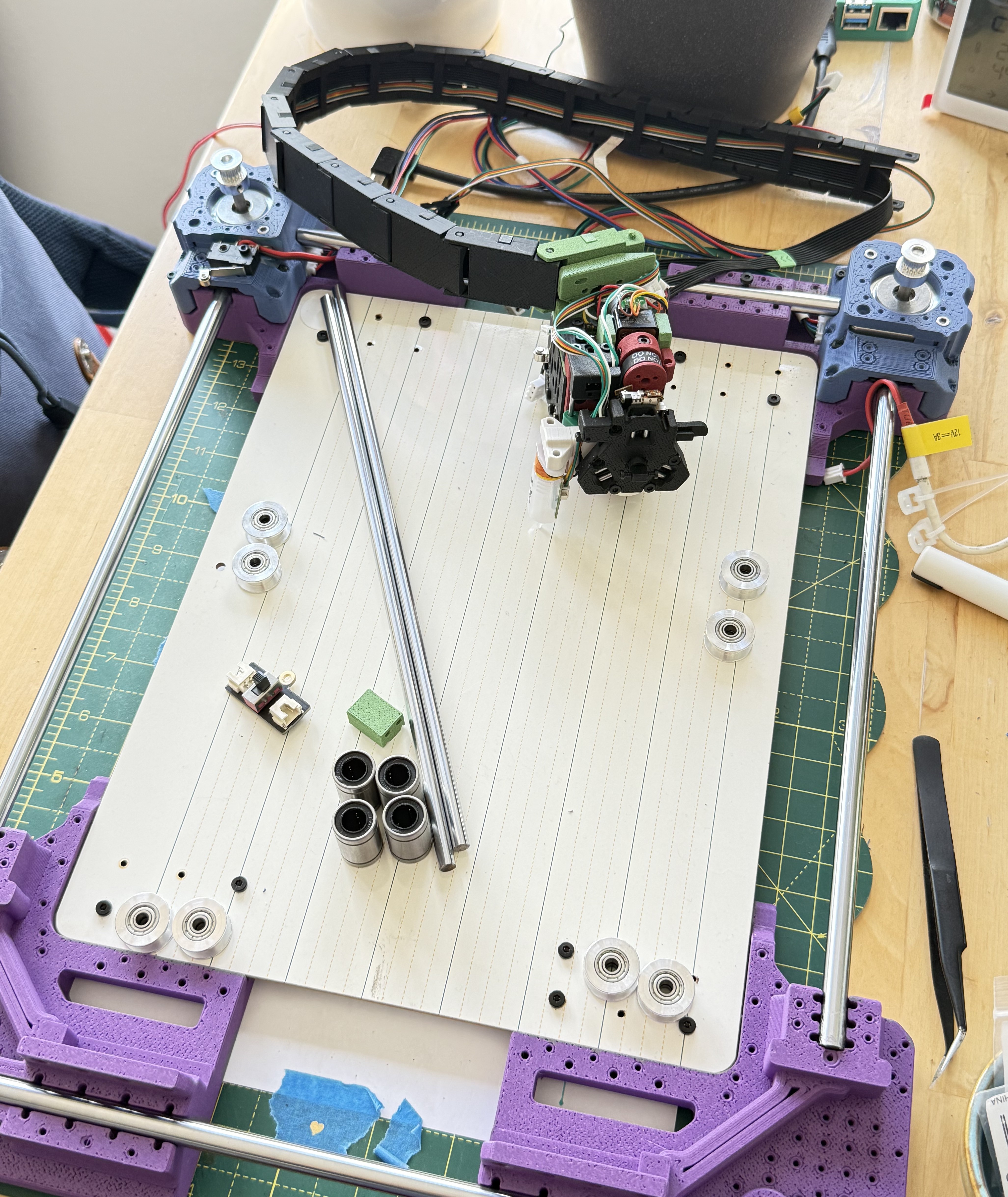

  • New Z axis, Plotter Bed, STEP Files
    Prashant Sinha04/21/2026 at 14:36 0 comments
    I spent some time reflecting and then decided to actually fix the backlash issue in the Z axis. My initial tests showed that the NEMA 8 motor would be good enough for a lead-screw driven axis. A 35mm M3 bolt was attached to a bracket with a nut and fixed with thread-locker. Then the "lead screw" is fixed to the motor using a coupler.
    The lead-screw, which drives the Z axis, is placed on one side. This posed a challenge because the "rider" would tilt up/down and jam. I looked around at slide mechanisms, and noticed that many optical drives a common layout -- the rider is kept level through triangular geometry. The following shows the current slider layout:
    This works surprisingly well, although is a bit slower than belted axis. I'd need to recalibrate the tool dock and also find the correct rotation-distance.
    Update: I'm reasonably close to correct value: 0.03 mm/rotation (the value is explained by the fact that I'm using no microstepping on a driver hard-wired for 16 microsteps. I can't use microstepping because the AVR MCU can't generate steps fast enough.) The probe accuracy is reasonably better:
    To keep the paper flat I designed a magnetic bed system adapted for A5 paper size. I believe it'd be good enough to cut/score paper as well.
    Checkpoint 1: I've published all the current design files in the GitHub repository. The Fusion360 file barely fits under 100MB (zipped) and is fully articulated. Also uploaded the STEP file.
    The printer config is no longer valid and I'll update them later.
    This took about four months of effort and I'm pleased with the results so far. I think the toolhead could be easily adapted to fit on other CoreXY frames as well, and hence I've grouped it (and others) together in the design files. Majority of the components were sourced from Bambu store and AliExpress.
    I'll also post the files to Printables next month along with some instructions.

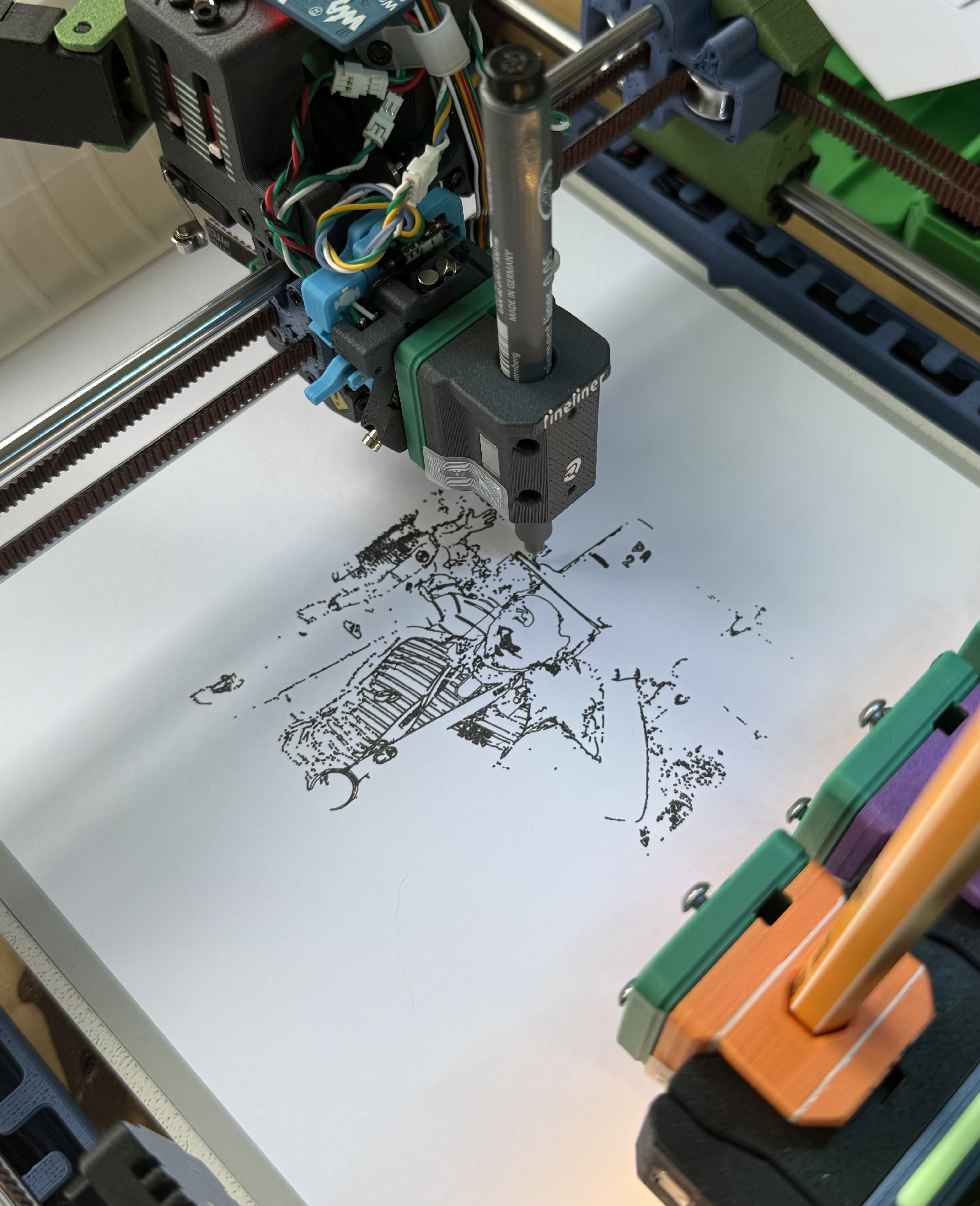

  • Interactive Plotting
    Prashant Sinha04/15/2026 at 21:15 0 comments

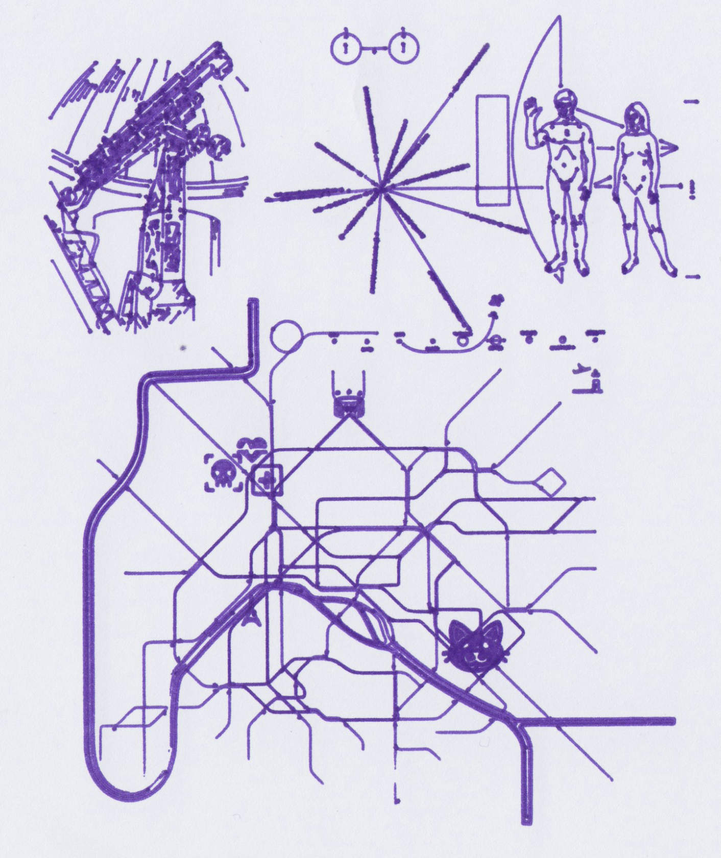

    I posted a quick video showing how I'm using the plotter currently. It's far from ideal but also quite efficient. Basically just dragging SVGs from Sketch to the slicer. As long as the paper doesn't move we can keep plotting at different areas.
    Apart from pen alignment, the core toolchanging part seems to work well now. Here are some plots I've done lately:
    > An image vectorized in Inkscape, 0.05mm
    > Drawings from Wikimedia Commons, 0.7mm
    > Pioneer Plaque, Paris Metro map (using toolchanger, misaligned). 0.05mm
    The paper curled at certain points but overall I'm happy with the results.
    > Paris Metro, Pioneer Plaque, Telescope. 0.7mm
  • RFID Read, Source available on GitHub
    Prashant Sinha04/11/2026 at 15:42 0 comments
    I posted a screencast where the plotter scans RFID tags on the tools. Still need to find out how to use the values read.
    Additionally, I was finally able to clean up a bit the klipper side of things. In the Limn repo I've published the current printer/toolchanger/rfid config. It's under MIT license. The README explains the contents.

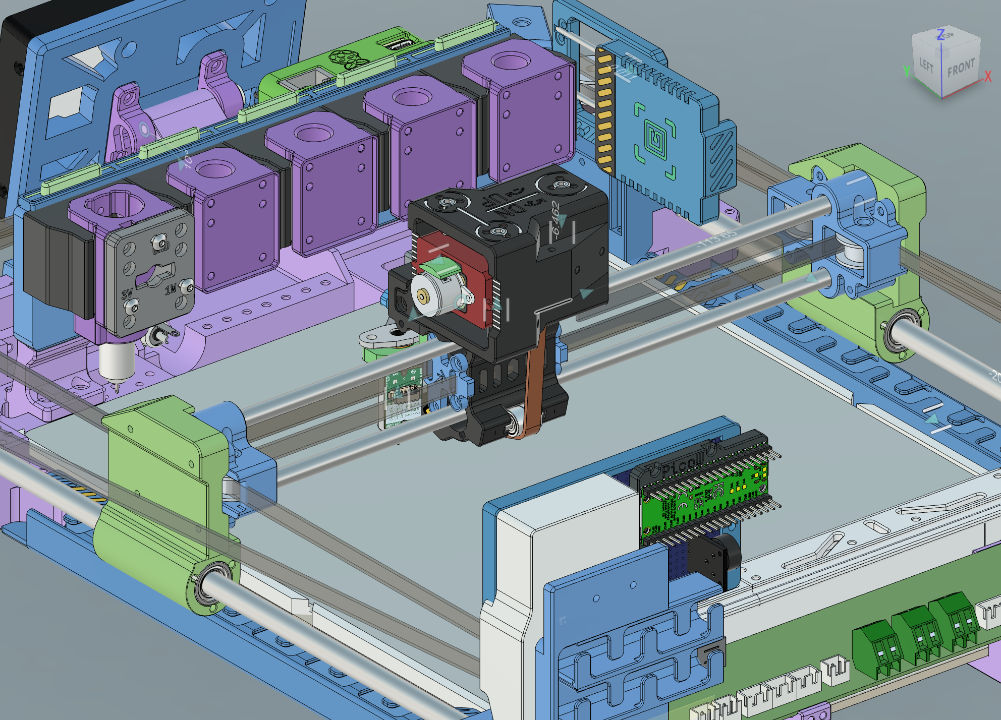

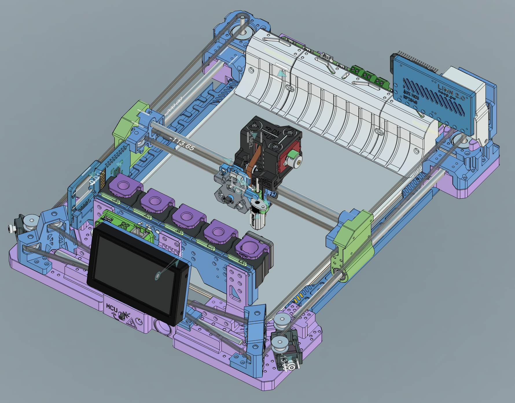

  • Under the hood
    Prashant Sinha04/10/2026 at 19:33 0 comments
    The plotter is designed to be scalable. Four components in each corners mate with variable lengths of rods/belts/base.
    A hard MDF board and the four steel rods on the edges together form a sufficiently rigid and square frame. I got the rods and bearings from a Tronxy 3D Printer Kit, as well as the driver PCB and XY Stepper Motors.
    The driver board uses 12V, and has 4 A4982 driver chips. Z axis is configured to drive dual Z axis motors so we have a different pinout here for the motors.
    I'd noticed the small SRM1509 and Linear motors get too hot on 12V regardless of proper VREF, so I cut the 12V trace and supplied external 5V to Z and K (the toolhead lock) axis drivers.
    When the belts are tensioned the frame is pulled inwards along the belt direction, which reduces the wobble. However it will likely deform when lifted in the current setup. There is not much to do unless we switch to a metal frame.
    The tool dock however needed special consideration as we need it to not move and survive the toolhead crashing into it. To keep it positioned the brackets (shown below) mate with a steel rod, and rest on the base. The middle one also acts as a hinge for the LCD.
    I'm quite close to finishing the design. I've built a 1:1 model in Fusion360, and would just like to give a shout to amazing people on GrabCAD and Printables (and elsewhere) for sharing their models. I'll be posting the STEP files on Printables (about a week or so). There are many parts, with some parts such as the K axis requiring special considerations (and it's pretty specific to the hardware I had at hand) so there's a bit of work left to do to documenting them. Almost all parts print without supports.
  • Detecting Tools, Tool Parameters, "Slicing"

    The tool docking mechanism relies on Maxwell Coupling for repeatability, however this repeatability only holds per tool. As such, different pens will land at varying positions on the paper for the same coordinate.
    My current understanding is that it will be too much effort to precisely align each tool, and rather it'd be easier to calibrate each tool against a reference tool (ideally the sharpest pen). Hence we need a way to configure the tool parameters (`{offset_x, offset_y, offset_z, depth...}`).
    For the sake of simplicity it'd be good that the printer handles this at runtime. Any print file could be printed by any tool/tools.
    I really did not want to reinvent any more wheels, so I stuck to PrusaSlicer. A new printer config, with custom gcode templates, multi-extruder toolhead, and some regex susbtitution later I can now drag an SVG file in the slicer, and generate the exact GCODE that klipper is expecting.
    Pen Up and Down motion is achieved by replacing `retraction` events. I chose to keep raw Z values here, and change Z-offset on klipper instead, so that the travel moves reflect actual pen moves in the preview. Similarly extrusions are kept only to have something in the preview, but are ignored by G1 macro.
    The slicer emits T0..T4 commands for each tool change. On klipper side custom macros translate these commands to actual movement.
    I still haven't figured out varying nozzle sizes while slicing but it should be possible.
    Back to detecting tools: A basic detection can be done by physical contact with the coupling surface -- on the tool's side we can bridge two screws with a wire. I'm aware of 1Wire EEPROM being a thing but did not find any to buy. There seems to be several Spool detecting projects, such as OpenSpools, which can use RFID readers to detect the spools. We could use something like that.
    To set the parameters there's now a spring-loaded-retractable RFID sensor mounted near the first tool. It can be slid back by the Y axis.
    (I did not realize that I wired the PN532 with I2C, but OpenSpools needs SPI connection. I'm too lazy to take it out so I'll likely have to figure out an alternative on this.)
    On the tools we stick a tag and the docking macro will eventually use the sensor for tool parameters.
