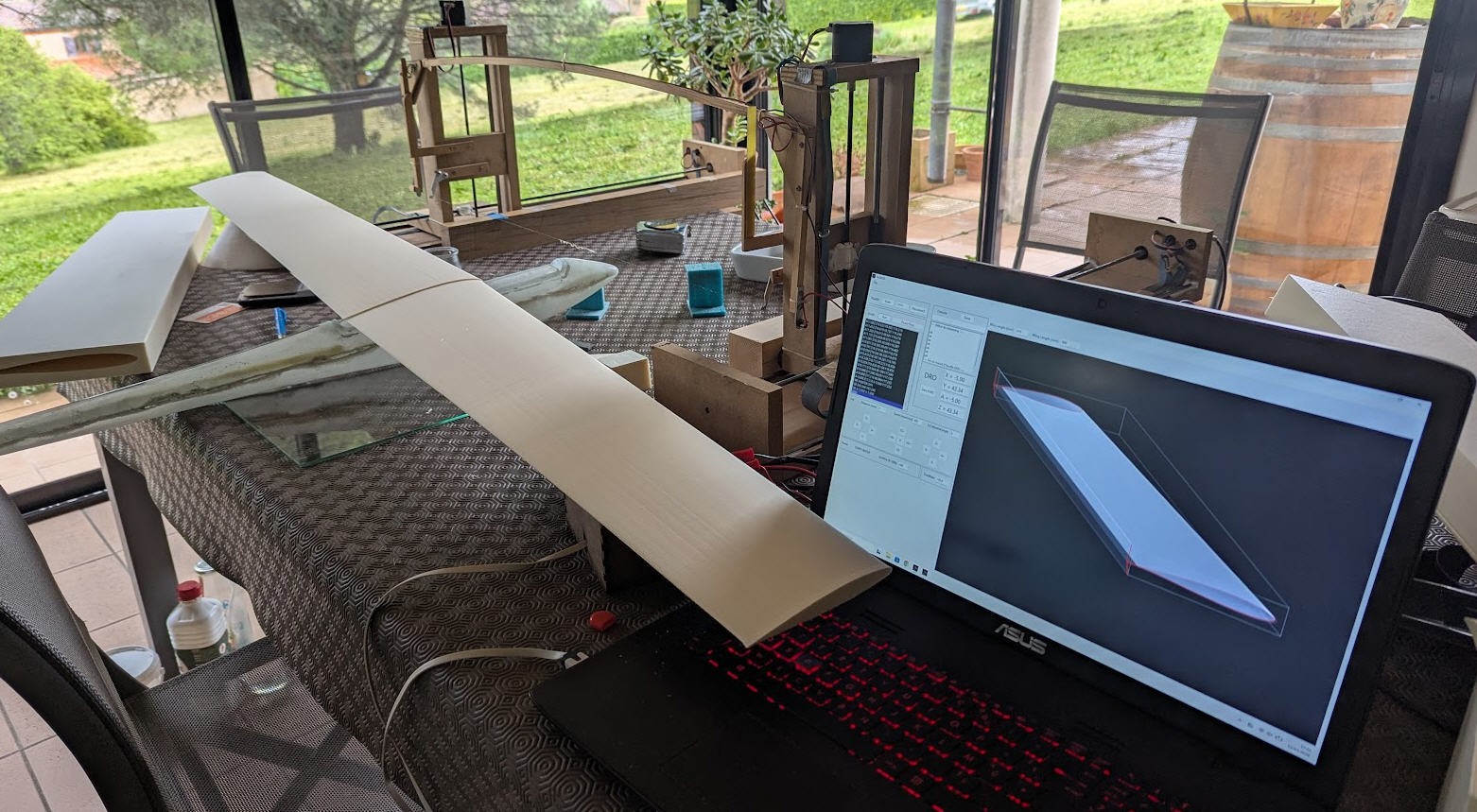

And the very first "full wing" cut with the tandem WiHoWi + hoWiGS
And no cheat it's hoWiGS which cuts this wing !

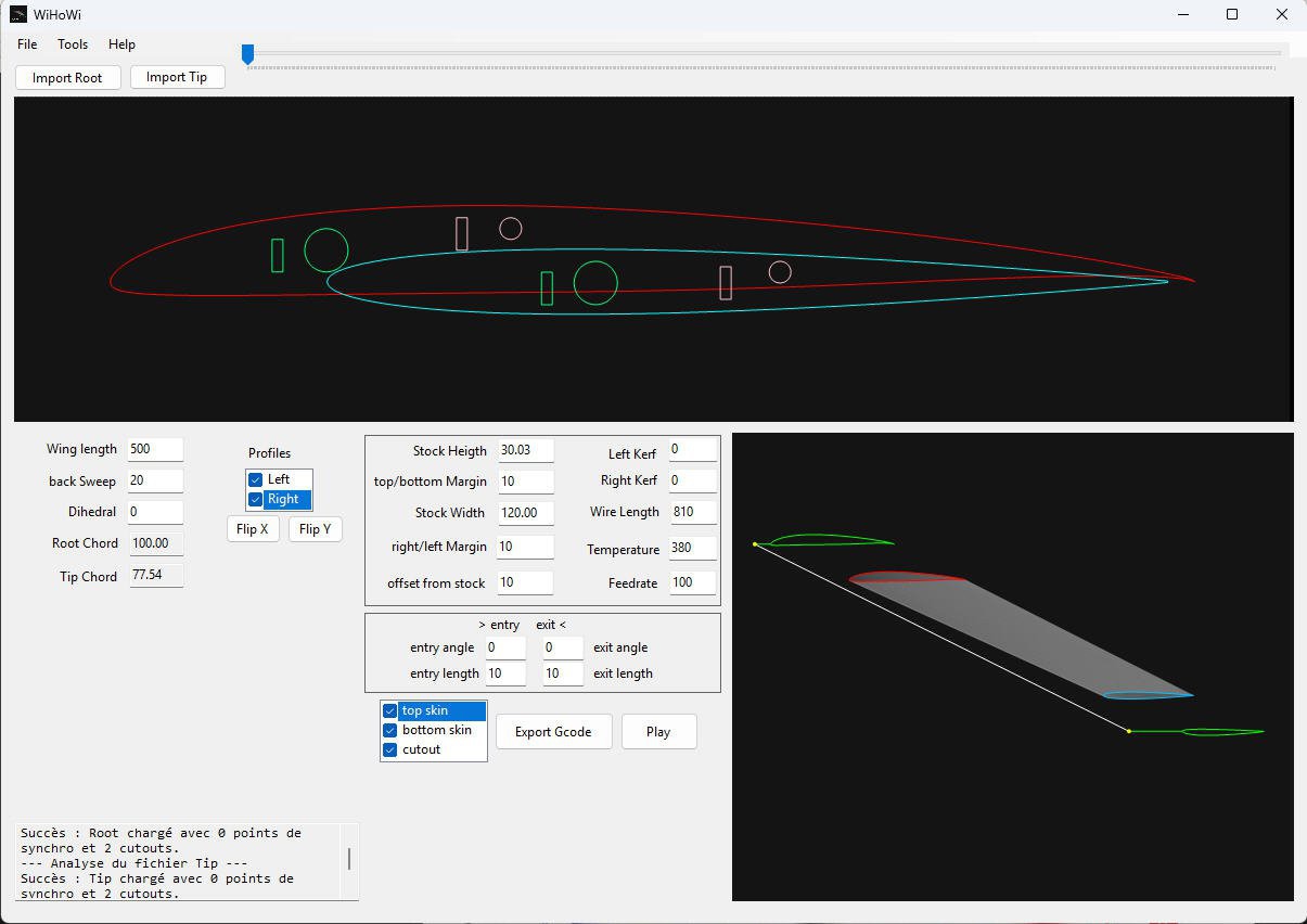

WiHoWI : Wise CNC 4-Axis Hot Wire Cutter
WiHoWI is a specialized CAD/CAM utility designed for 4-axis CNC foam cutting. At the beginning of this story, WiHoWI was "Wing Hot Wire" ... Now it is more "Wise Hot Wire" as it appeared to be generic enough to cut what you want to cut ... (almost) !
This software synchronizes two independant 2D profiles (Root and Tip) to generate precise G-Code for tapered wings, including complex internal cutouts and automatic stock material management.

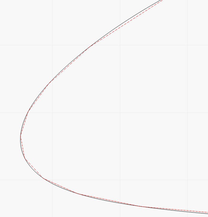

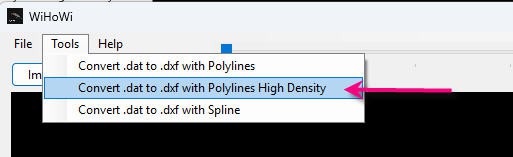

For simple wings WiHoWi can import or convert .dat file format into .dxf Polylines (High Density)
Convertion to polylines HD is by far the best way to to get high resolution profiles and get the best result from your foam cutter. Your .dat profile will be "faceless"  and so will be your wing...
to be compared with the red dashed profile below (.dat to Polyline) :
Accuracy key points :
  • When importing a .dat file, the default/only option is "High Density polylines" as explained above. This means that even poorly defined profiles...

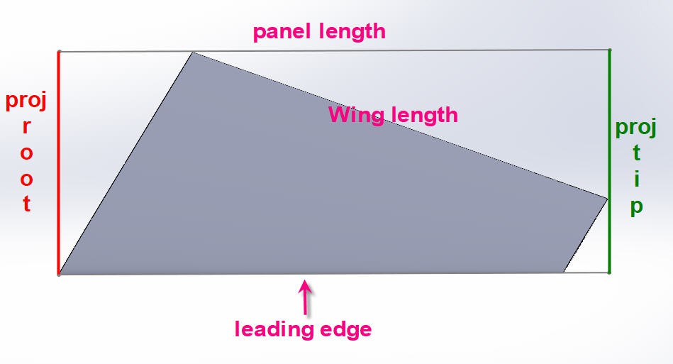

    Cutting a "delta wing" can be tricky and sometimes impossible...
    If your wing has a very high "backSweep" then it may not fit into the bed of your machine.
    Further more if the tip chord is way shorter than the root one, the tip will be burnt...
    "Only" solution :
    • turn your stock, put the Leading Edge of the wing parallel to the hotwire... and apply these tricks !
      • follow the root and tip profiles at constant same speed on both sides until you reach the trailing edge of the tip
      • then, on tip side, follow the trailing edge of the wing, while, on root side, you follow the rest of the root profile
    This idea is not mine and has been developped by Christophe Lauverjat and "Papy KiloWatt".

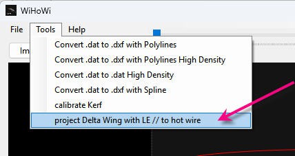

    Then select the menu tools "Delta wing"
    5 files will be generated and saved :
    • 2x .dxf for the projected profiles (with new projected chords)
    • 2x .dat for the projected profiles (normalized and without the chords)
    • 1x readme file with all geometry of the rotated wing
      Profiles for delta wings (WiHoWi menu tools)
      panel length                 : 575.66 mm
      wing length                  : 500.00 mm
      back sweep angle             : 21.80 °
      back sweep on wing           : 200 mm
      dist to root trailing edge   : 75.66 mm
      root chord                   : 300.0 mm
      tip chord                    : 100.0 mm

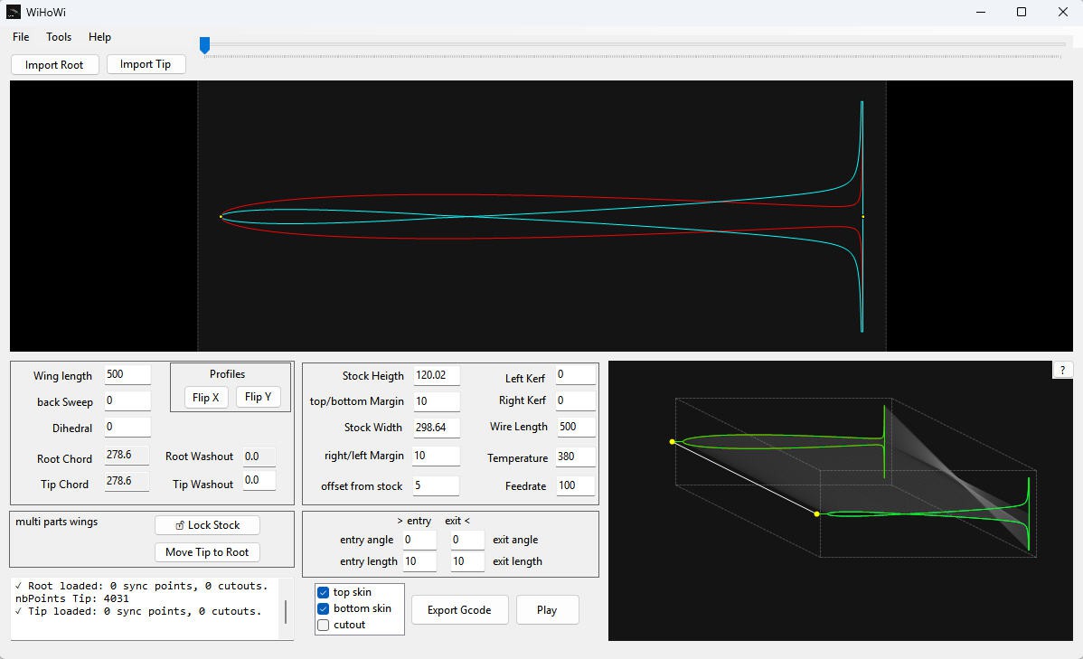

      root/tip chords projected    : 279.57 mm

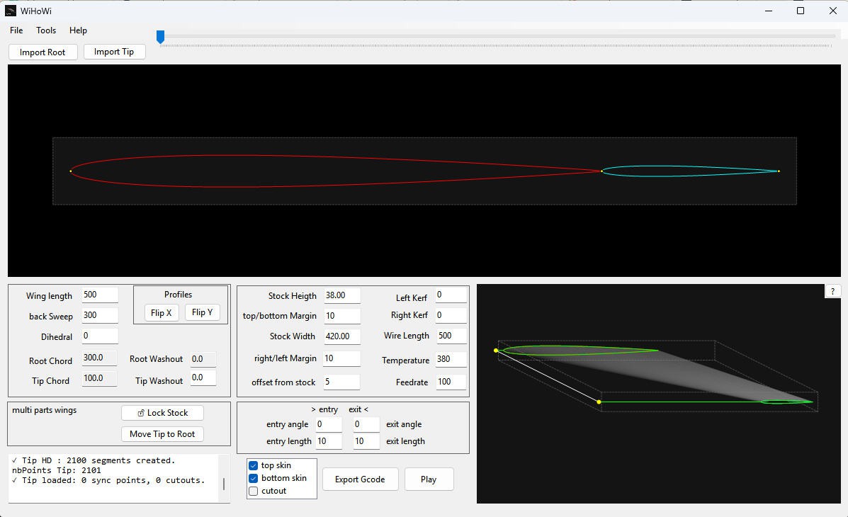

    Import the profiles into WiHoWi,
    • tune the news chords (bigger because of the backSweep angle)
    • tune the panel length (into the wingLength field ...I forgot to do it in the picture !...)
    • cut your stock at the dimensions of the finished wing
    • turn your stock with the backSweep angle
    • and cut these strange profiles !
