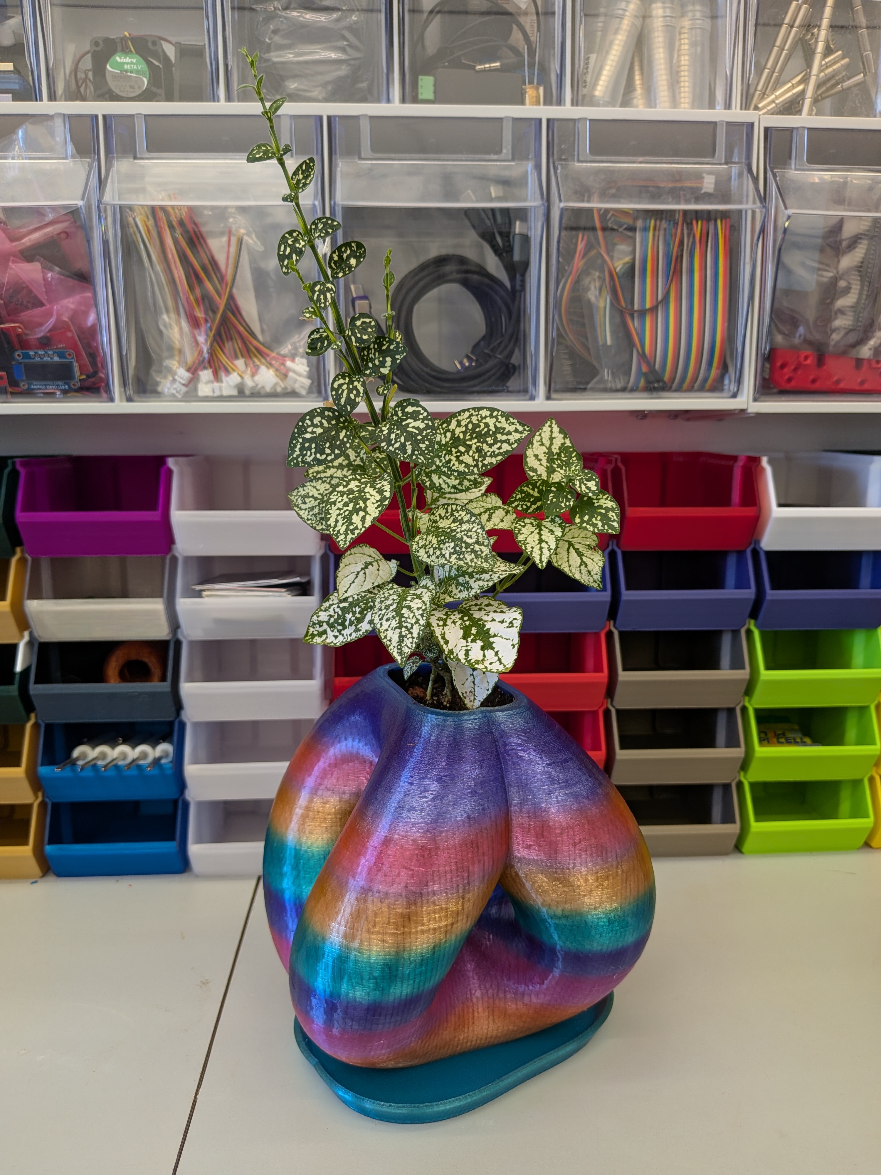

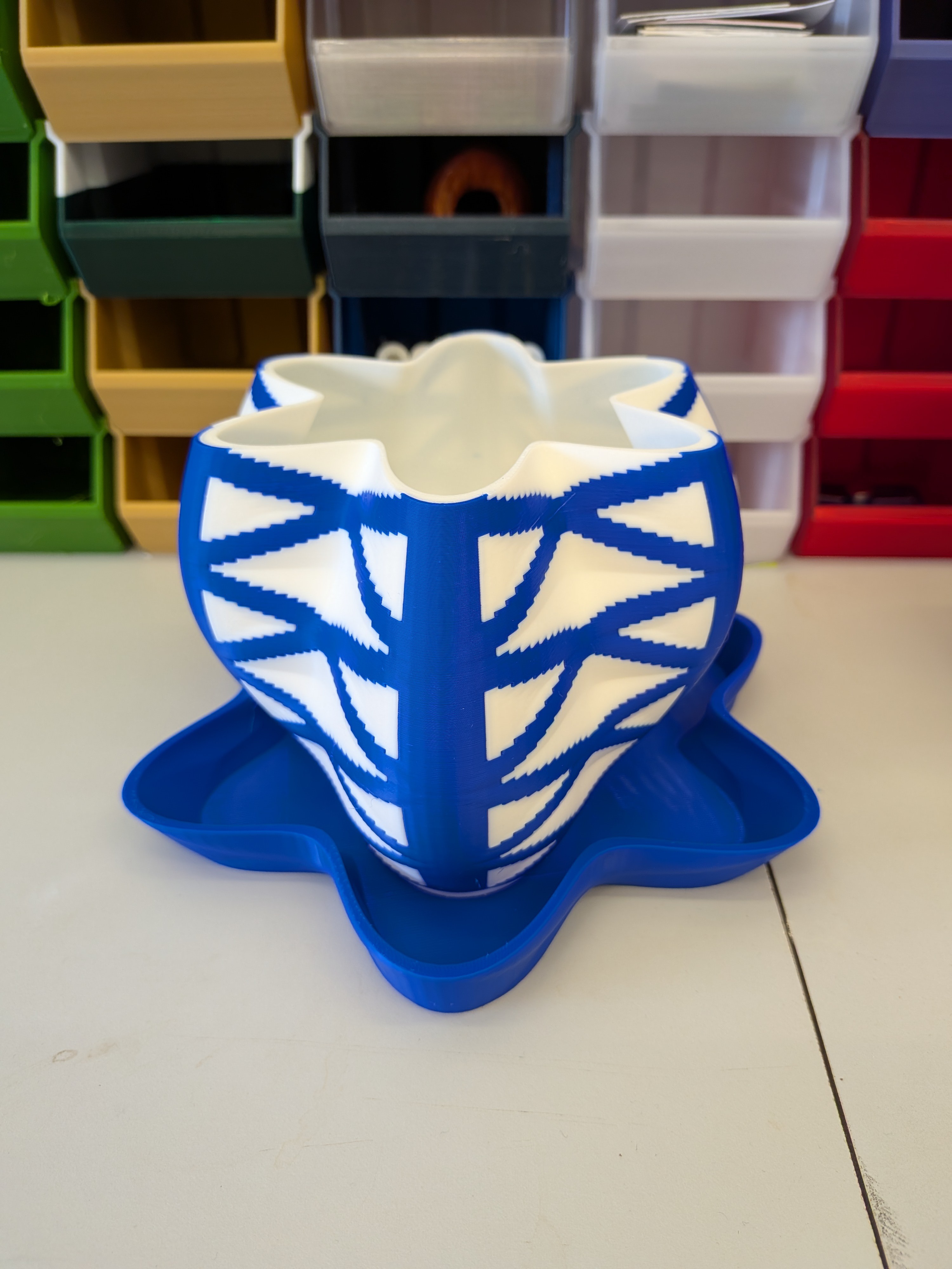

  • Actual Prints
    Arkadi04/19/2026 at 10:15 0 comments
    3-to-6_Petal_Morph_Bulged - Equation Driven Pot Designer https://arkadiraf.github.io/Equation-Driven-Pots/
    Spherical Ros Sweep tool: https://arkadiraf.github.io/Equation-Driven-Pots-App/SweepDesignerMobile.html

    - pattern-mask logic for selecting color regions
    - pattern depth, so the colored region becomes real geometry rather than only a visual overlay
    - multi-part 3MF export for slicer-based color assignment
    - STL export for standard single-mesh workflows
    - browser-based live preview
    - mobile-scaled GUI support while keeping the desktop interface intact
    One of the main goals with this tool was to keep the output practical for real 3D printing. The pattern body is generated as a separate printable part, and the export workflow was refined so the resulting parts load as a single multi-part object in slicer workflows rather than as a loose collection of overlapping meshes.
    The result is a more fabrication-oriented version of the project. The earlier tools were already useful for generating mathematical pot forms, but this version pushes the workflow closer to finished multi-color prints.
