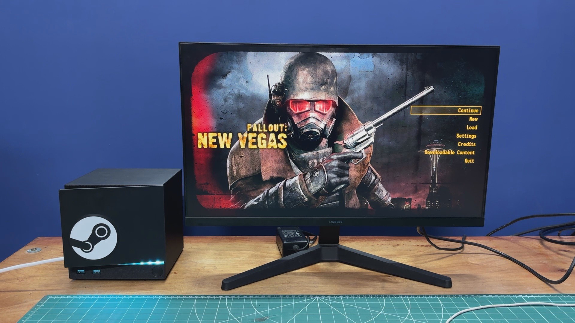

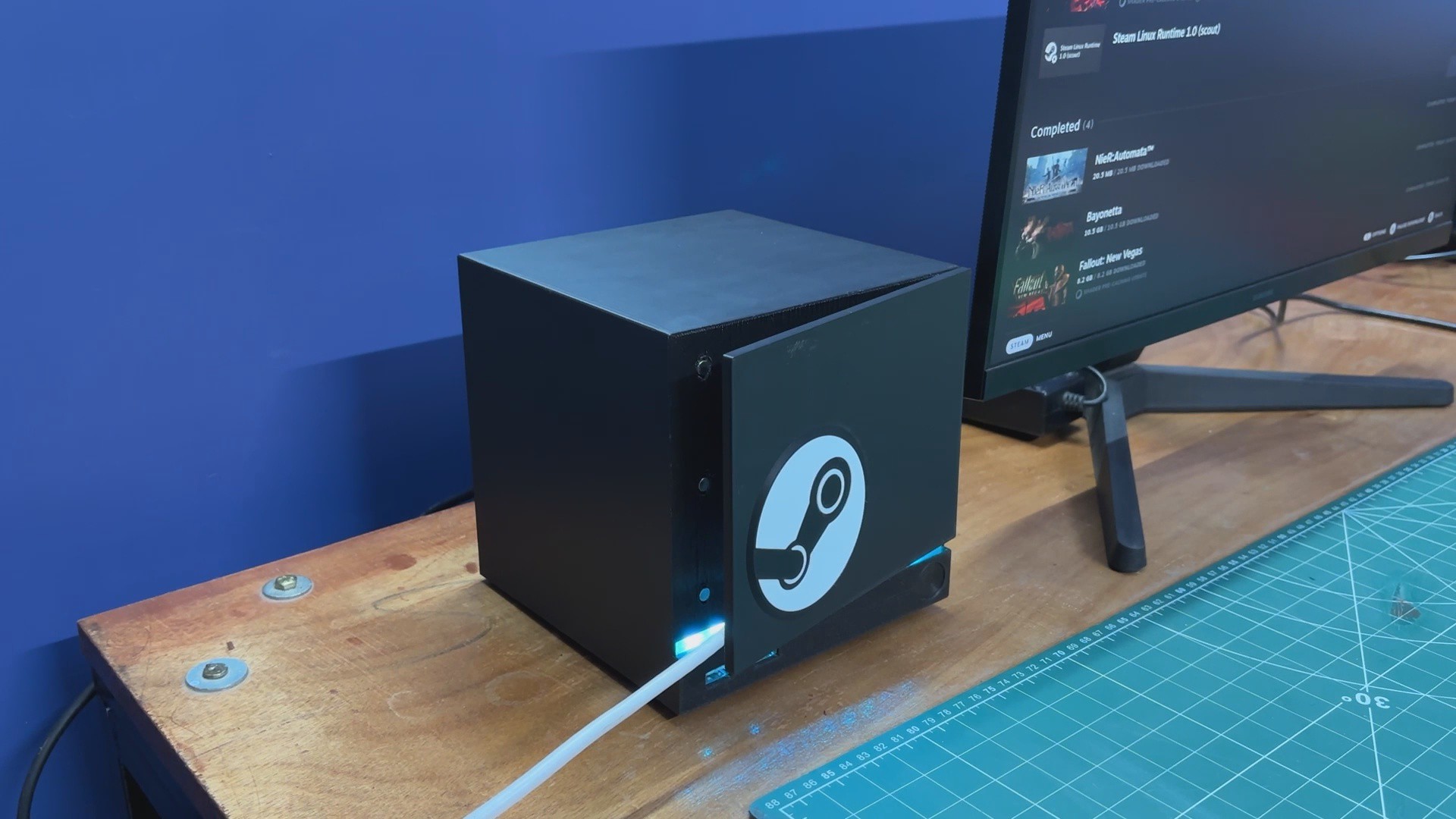

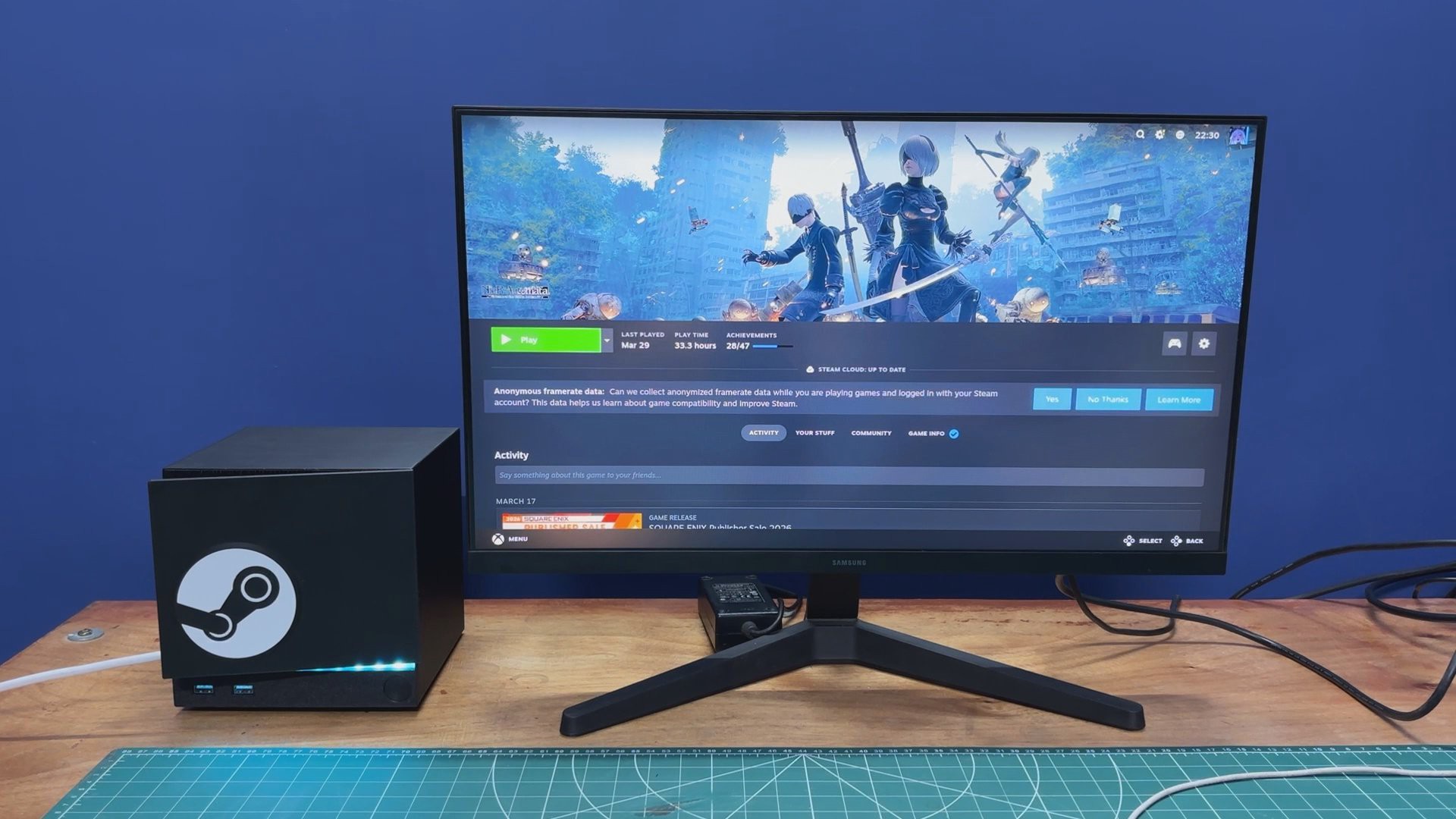

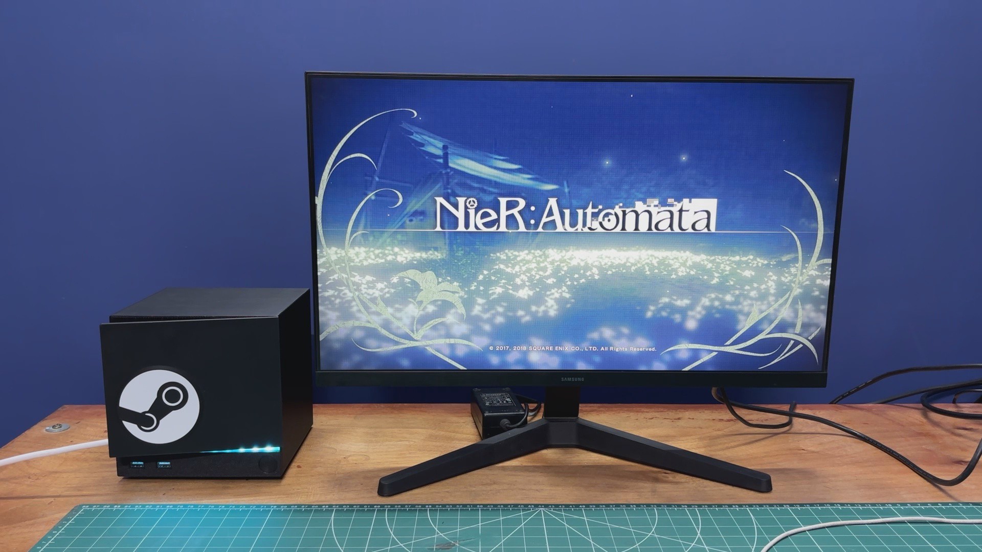

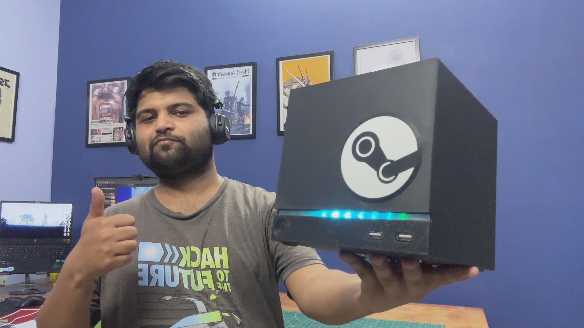

Greetings everyone, and welcome back! Meet my version of the new Steam Machine. The build was inspired by the new Steam Machine that was supposed to launch but got delayed due to the RAM crisis. I was actually planning to get one, but since I couldn’t, I decided to take matters into my own hands and build one from scratch. This time, I wanted to get as close as possible to the original design. After doing some research, I designed my own enclosure in Fusion 360, keeping the features and aesthetics as true to the official Steam Machine as possible.
On the front, I’ve added two fully functional USB ports, an LED light bar that plays custom animations, and even a magnetic front cover that can be easily detached and swapped with different designs.
At the heart of this build is the LattePanda IOTA, featuring an Intel N150 quad-core processor, paired with a 256GB NVMe Gen 3 SSD and 16GB of DDR5 RAM. For the operating system, I’m using Bazzite, which is a Linux distro built specifically for gaming, and it runs Steam on it.
Since this system uses an x86 Intel processor, games run seamlessly thanks to Proton. In a previous project using a Raspberry Pi, I had to rely on Box86 to translate ARM architecture for gaming, which added complexity. Here, with native x86 support, the experience is far more straightforward and efficient.
STEAM MACHINE

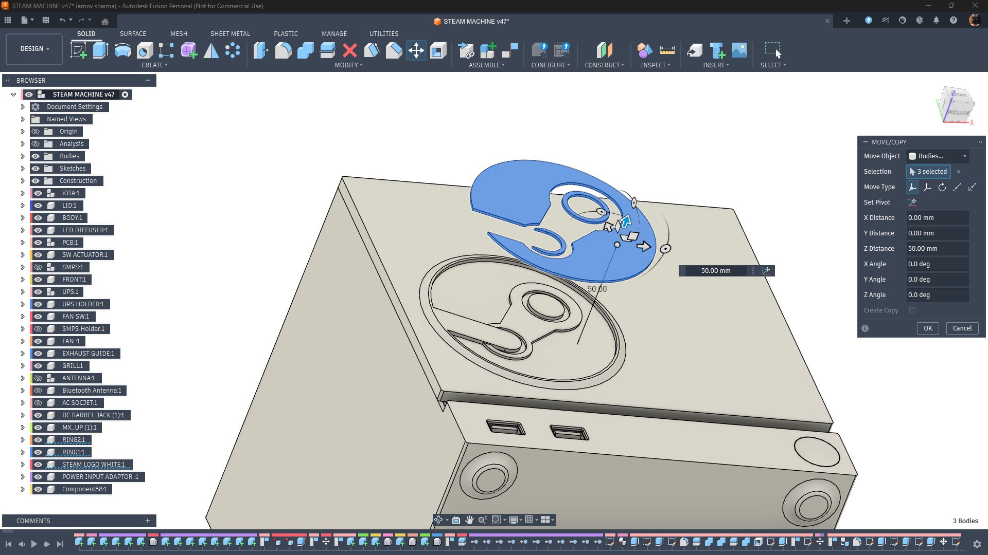

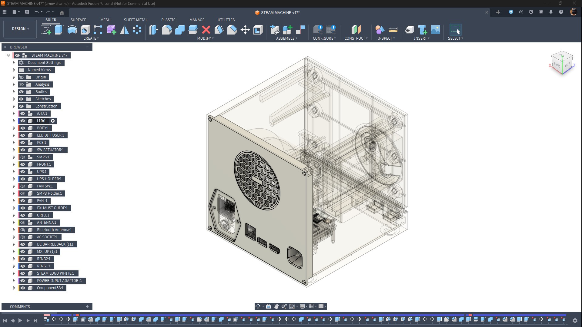

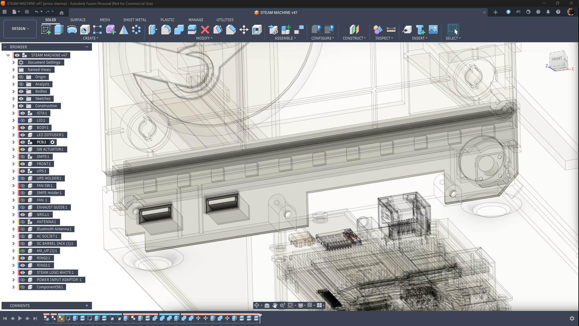

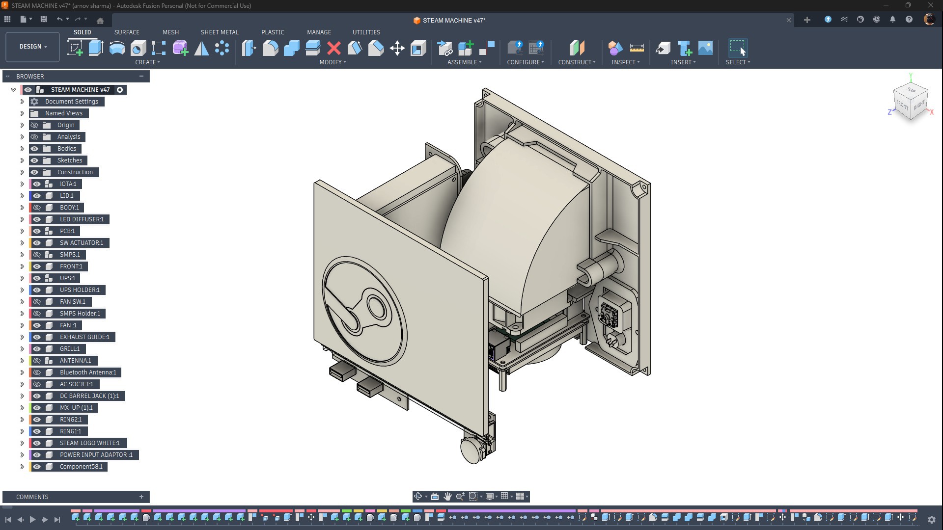

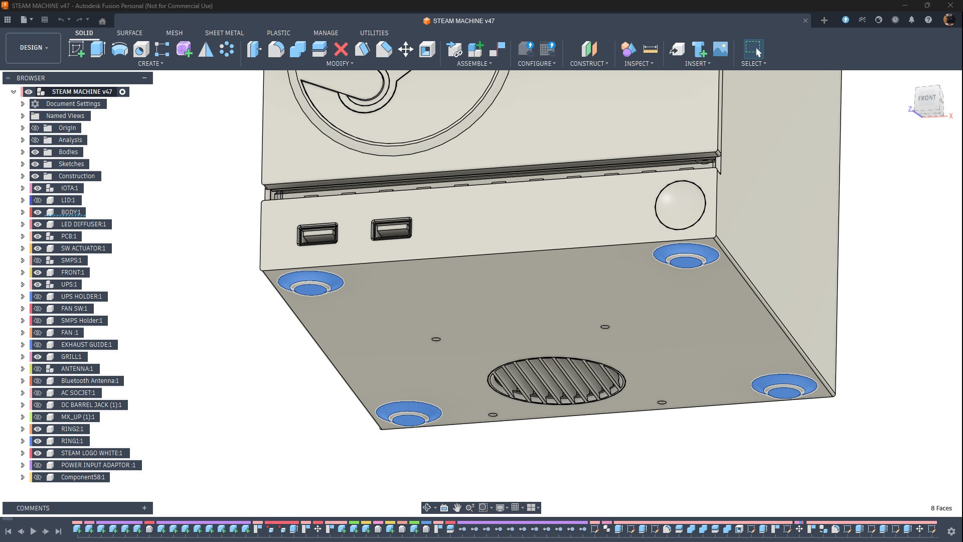

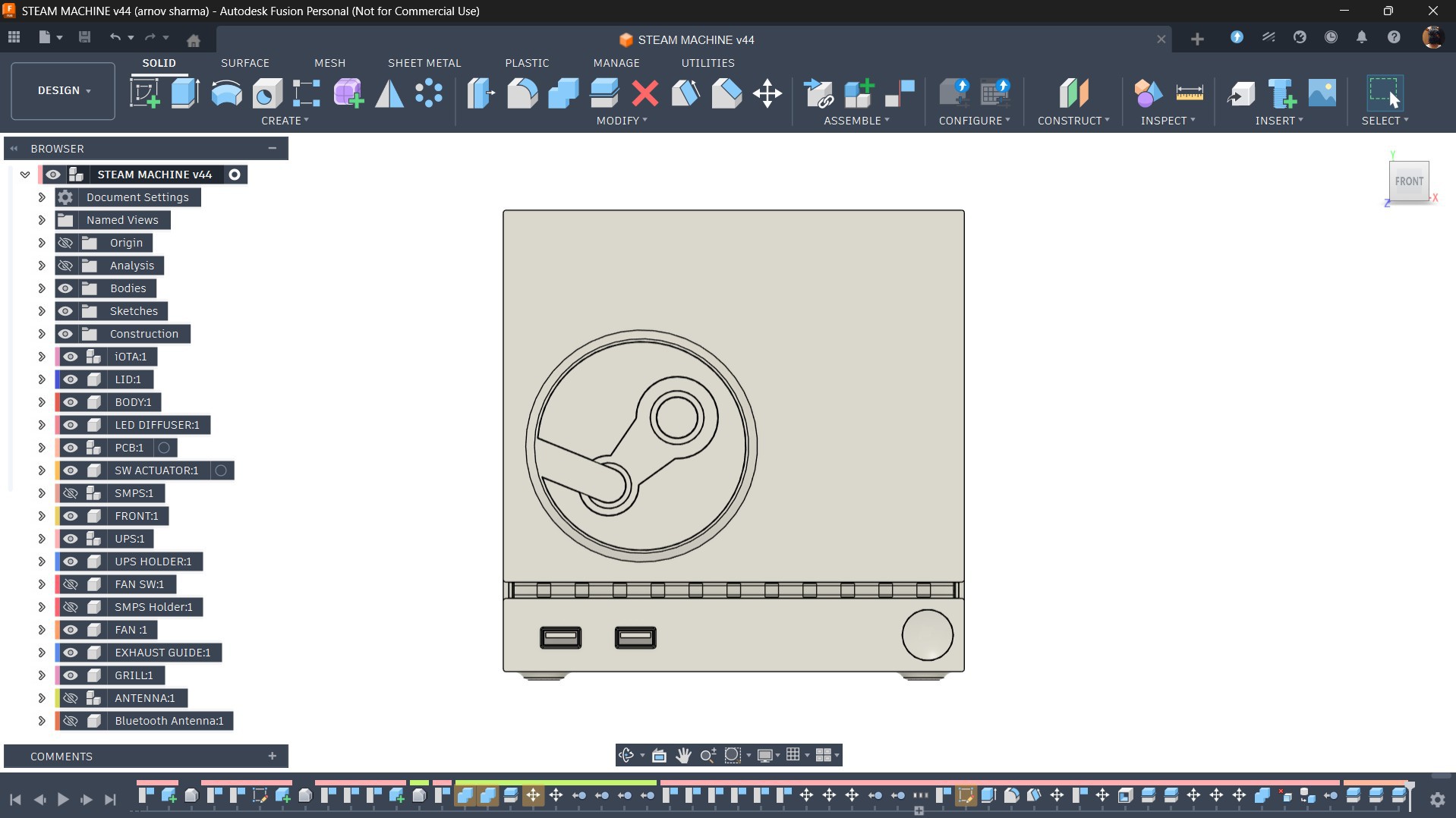

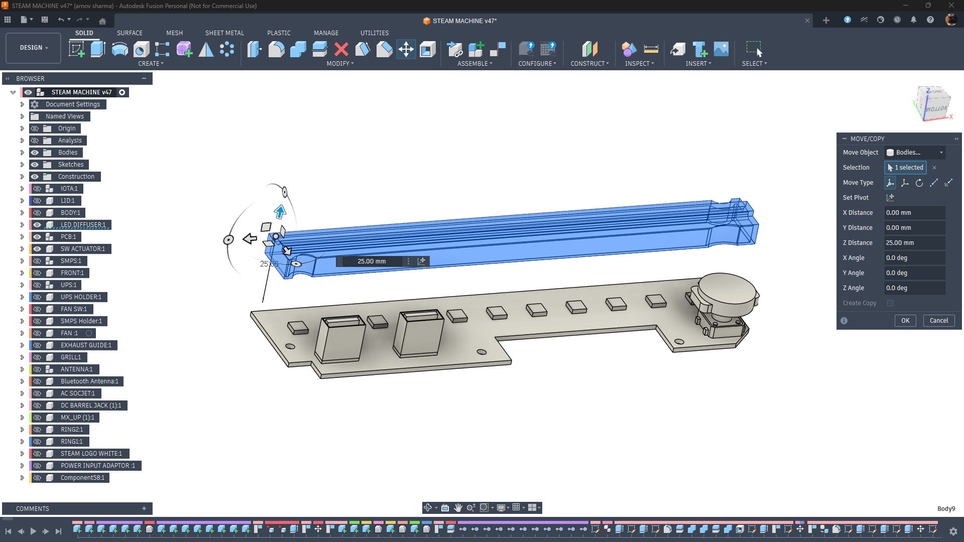

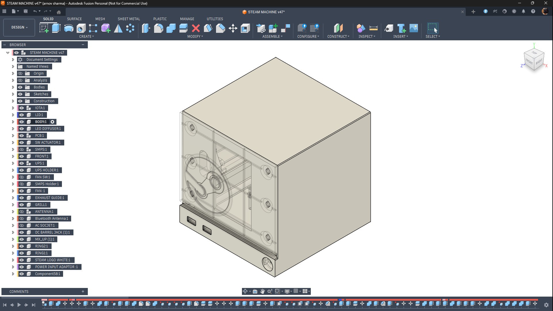

In Fusion 360, I created a box-like enclosure, mainly made up of two parts: the main body and the lid.
The front of the main body is modeled to closely match the front of the Steam Machine. It features a lower bar section that holds two USB ports on the left side and a push button on the right side. Slightly above the USB ports, there is a light bar that plays LED animations.
Above this LED bar sits the front cover, which is attached to the main body using magnets. I really like this removable cover design, as it allows for a lot of customization, both aesthetically and electronically....

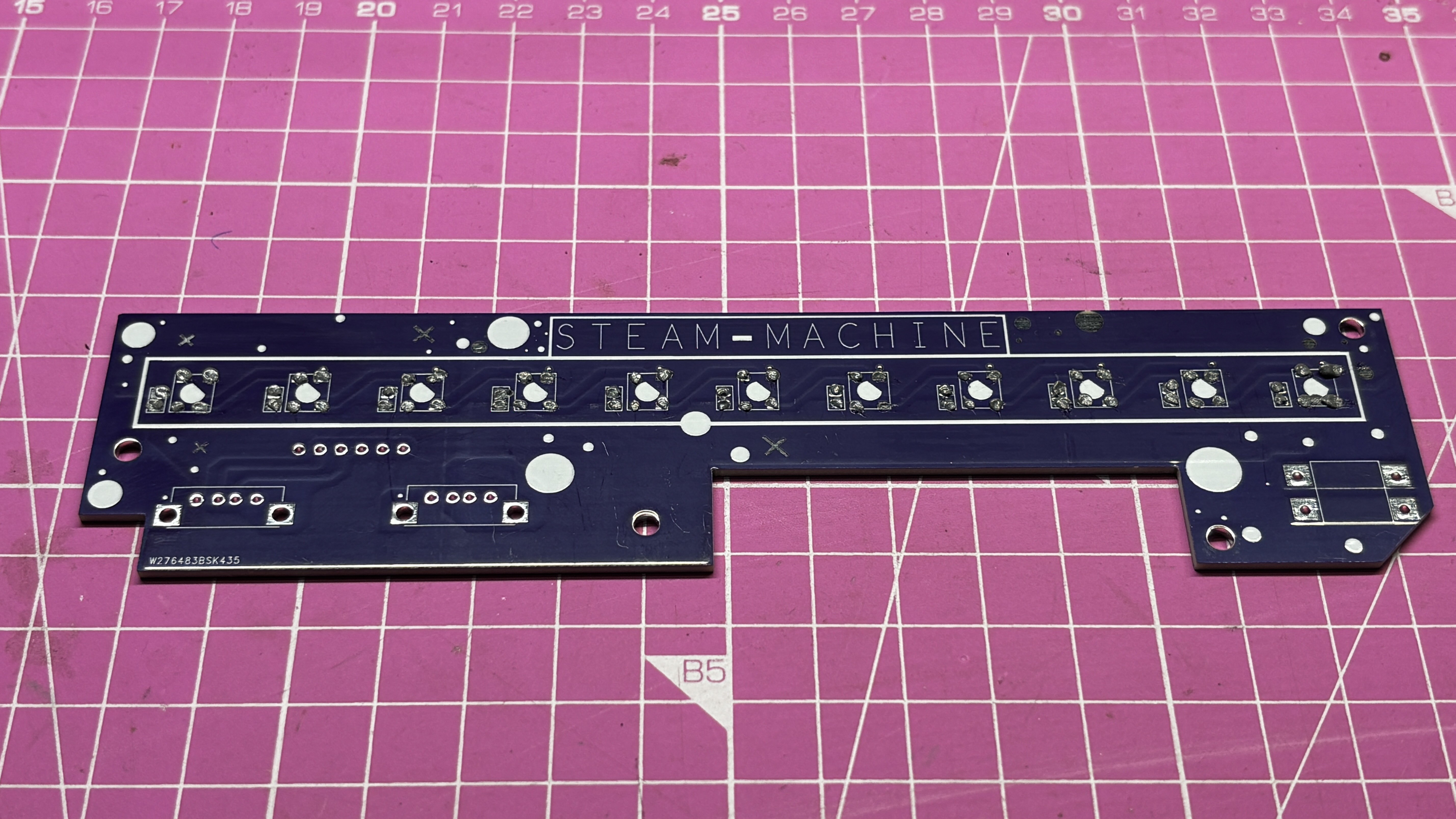

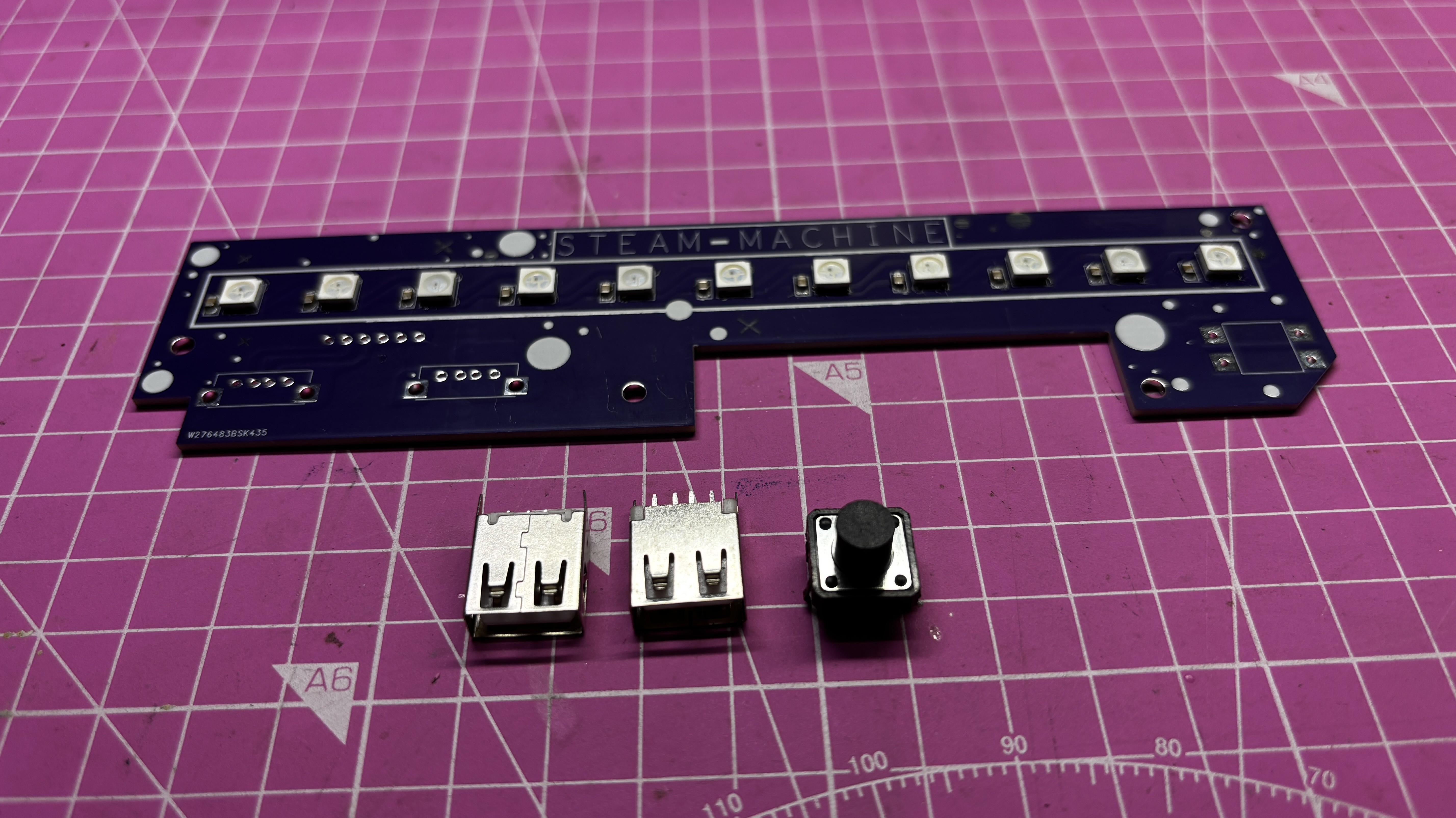

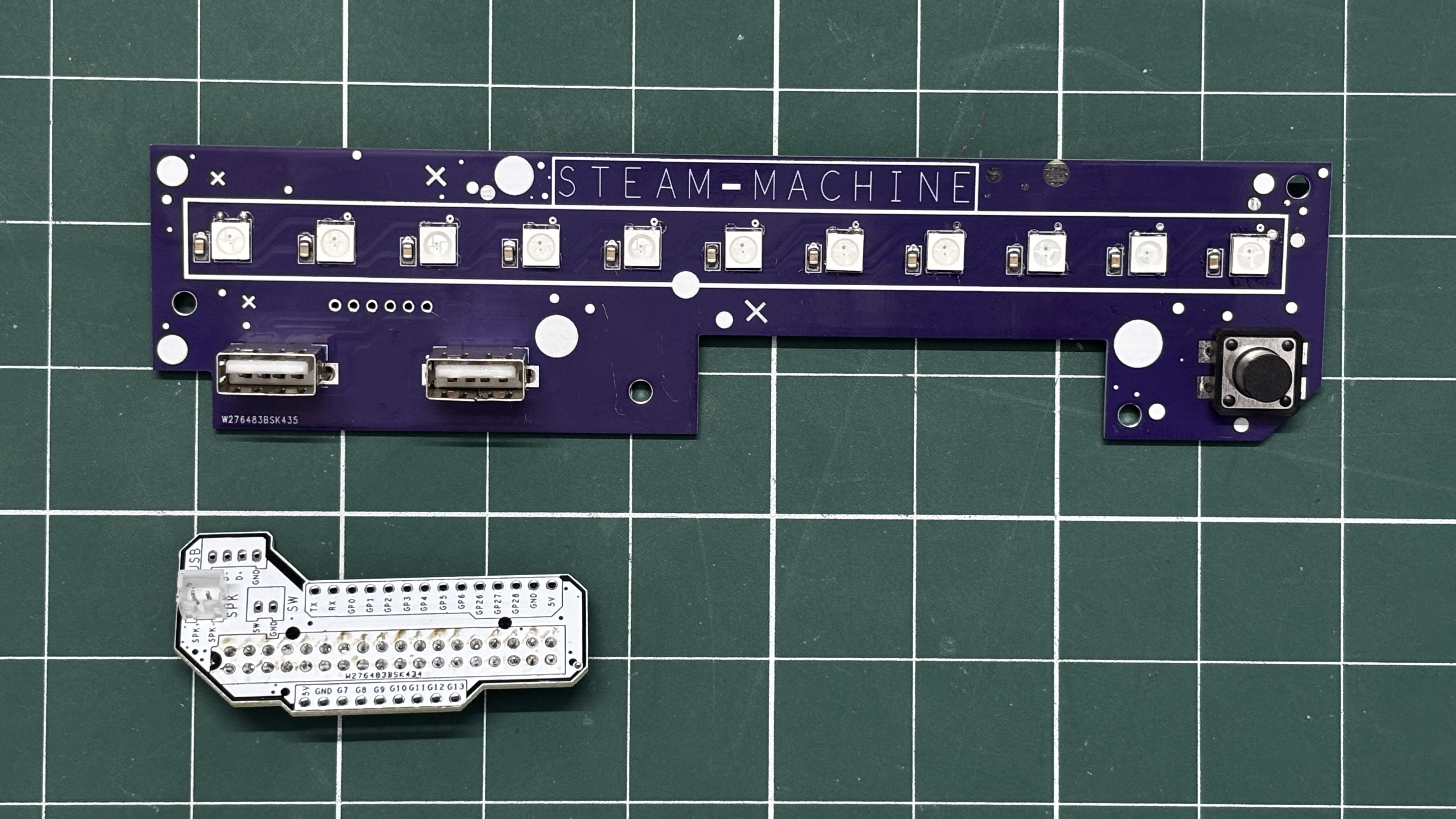

    PCB ASSEMBLY- FRONT IO BOARD

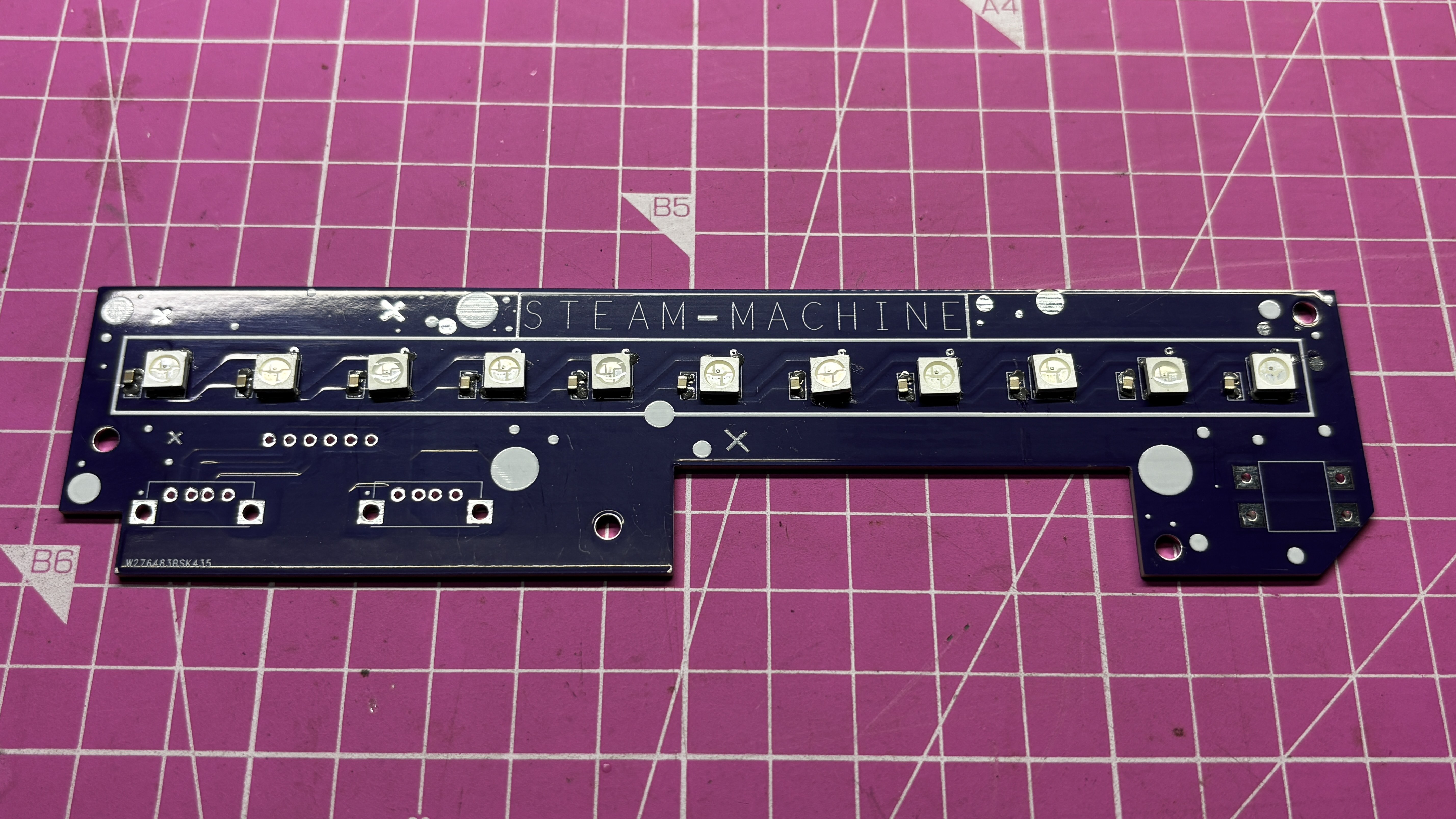

    • We begin the front I/O board assembly process by applying solder paste to all the SMD LED pads one by one using a solder paste dispensing syringe. Here, we are using SnPb 63/37 solder paste, which has a melting temperature of around 200°C.
    • Next, using tweezers, we pick up and place all seven WS2812B SMD LEDs and seven 100 nF decoupling capacitors in position.
    • The board is then placed on a reflow hotplate, which heats the PCB from below up to the solder paste melting temperature. As the temperature exceeds 200°C, the solder paste melts, and all SMD components are secured in place.

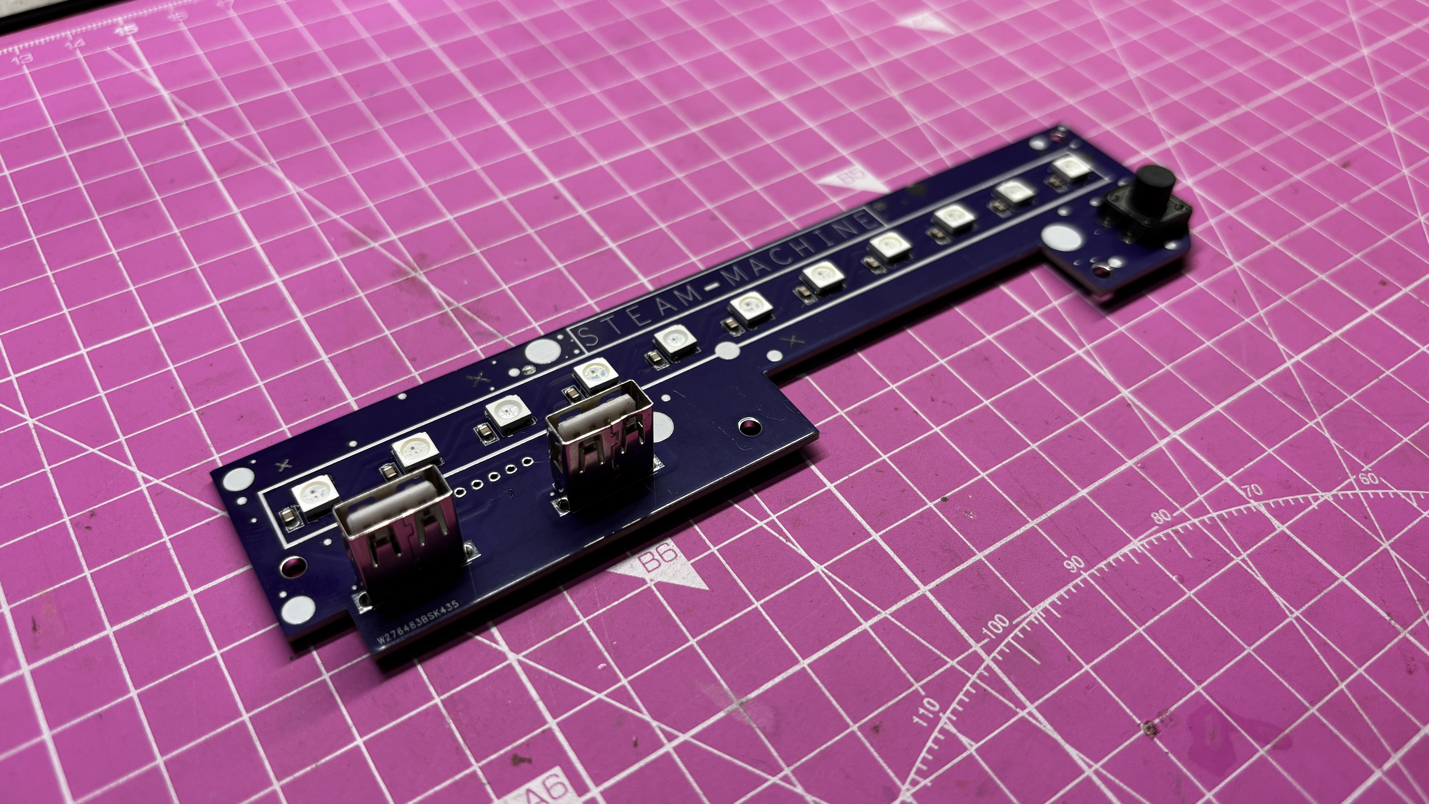

    • For the through-hole process, we place the 12×12 push button into its position from the front side of the I/O board, followed by two vertical USB ports.
    • The board is then flipped over, and all the leads of the through-hole components are soldered using a soldering iron, securing them to their pads and completing the assembly process.
  • 2
    PCB ASSEMBLY- IOTA BREAKOUT BOARD

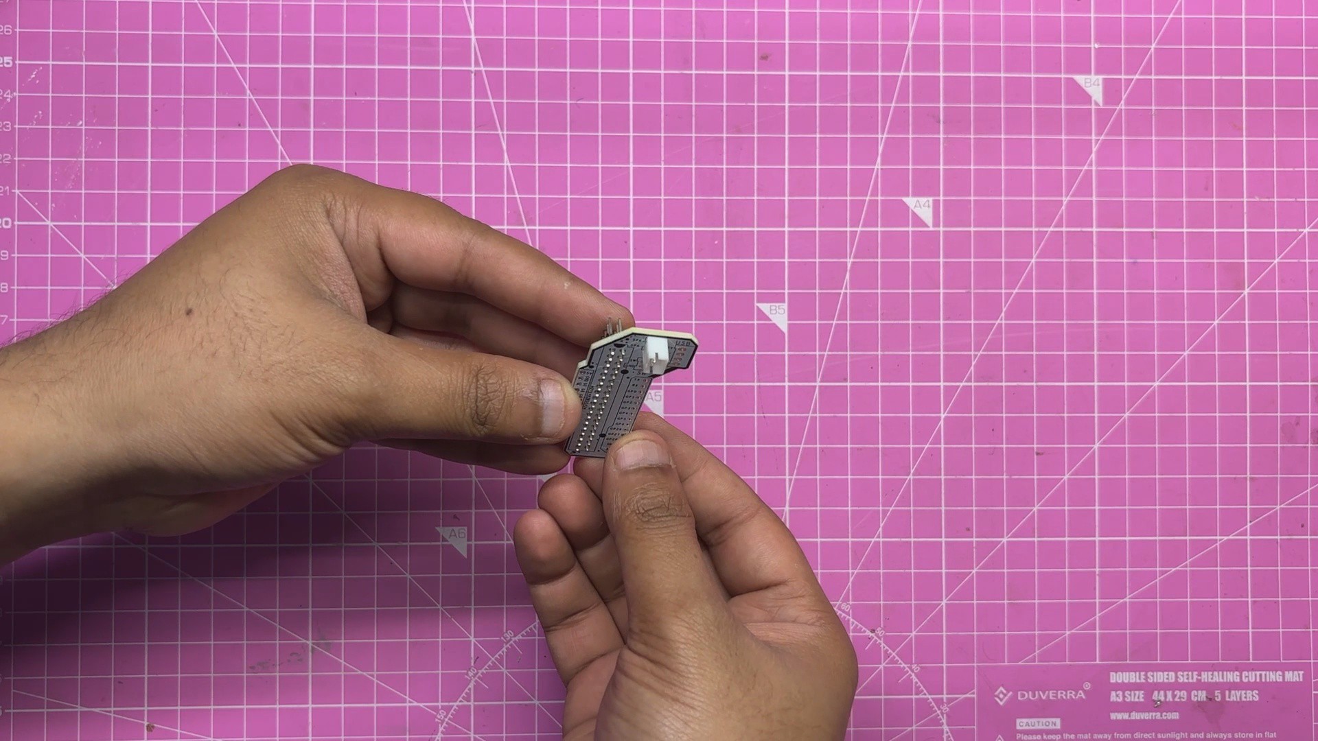

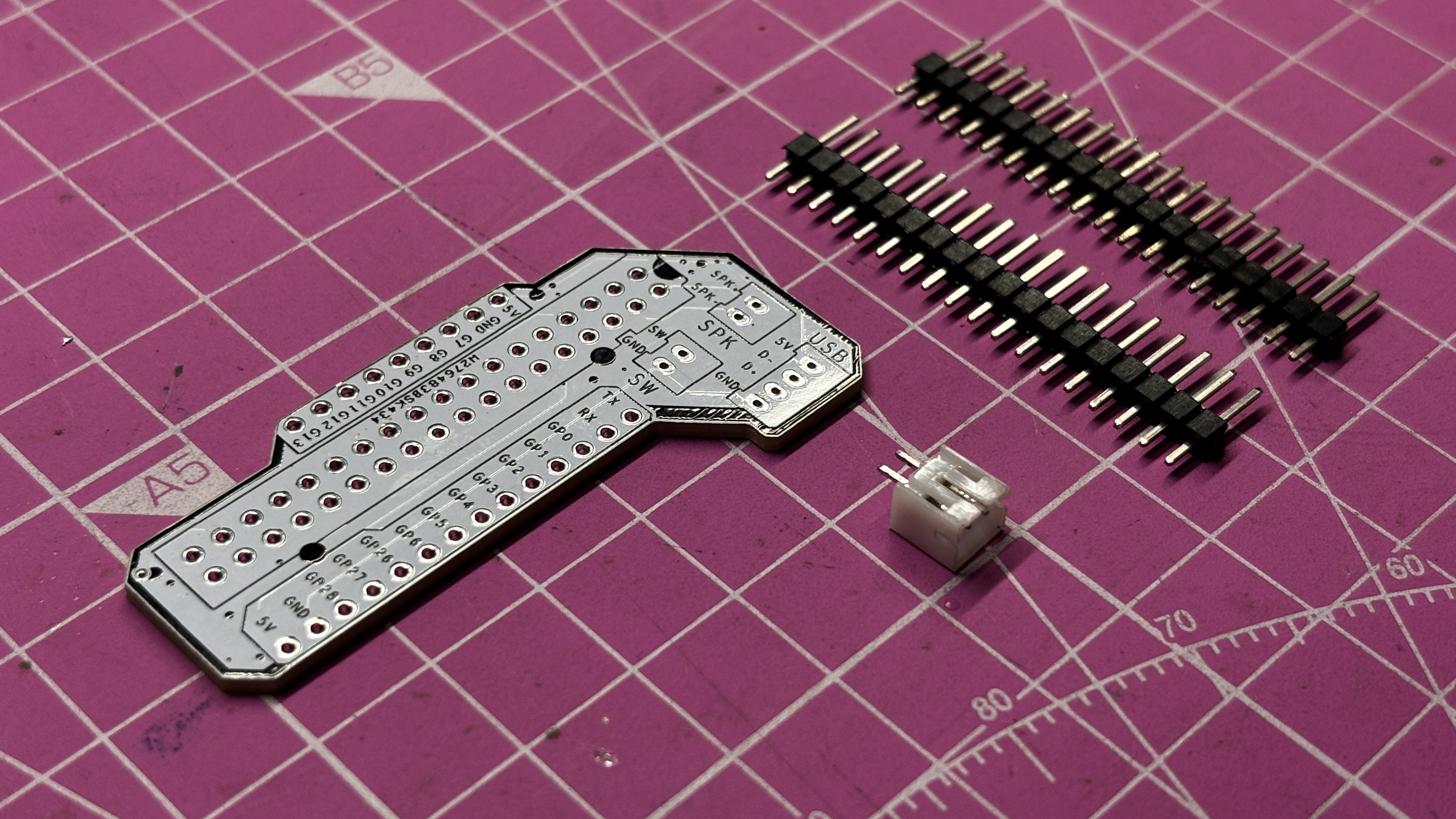

    The assembly for the IOTA breakout board was pretty simple.
    • We added two CON18 male header pins side by side to create a CON36 connector.
    • On the opposite side, we positioned the CON2 JST connector in place.

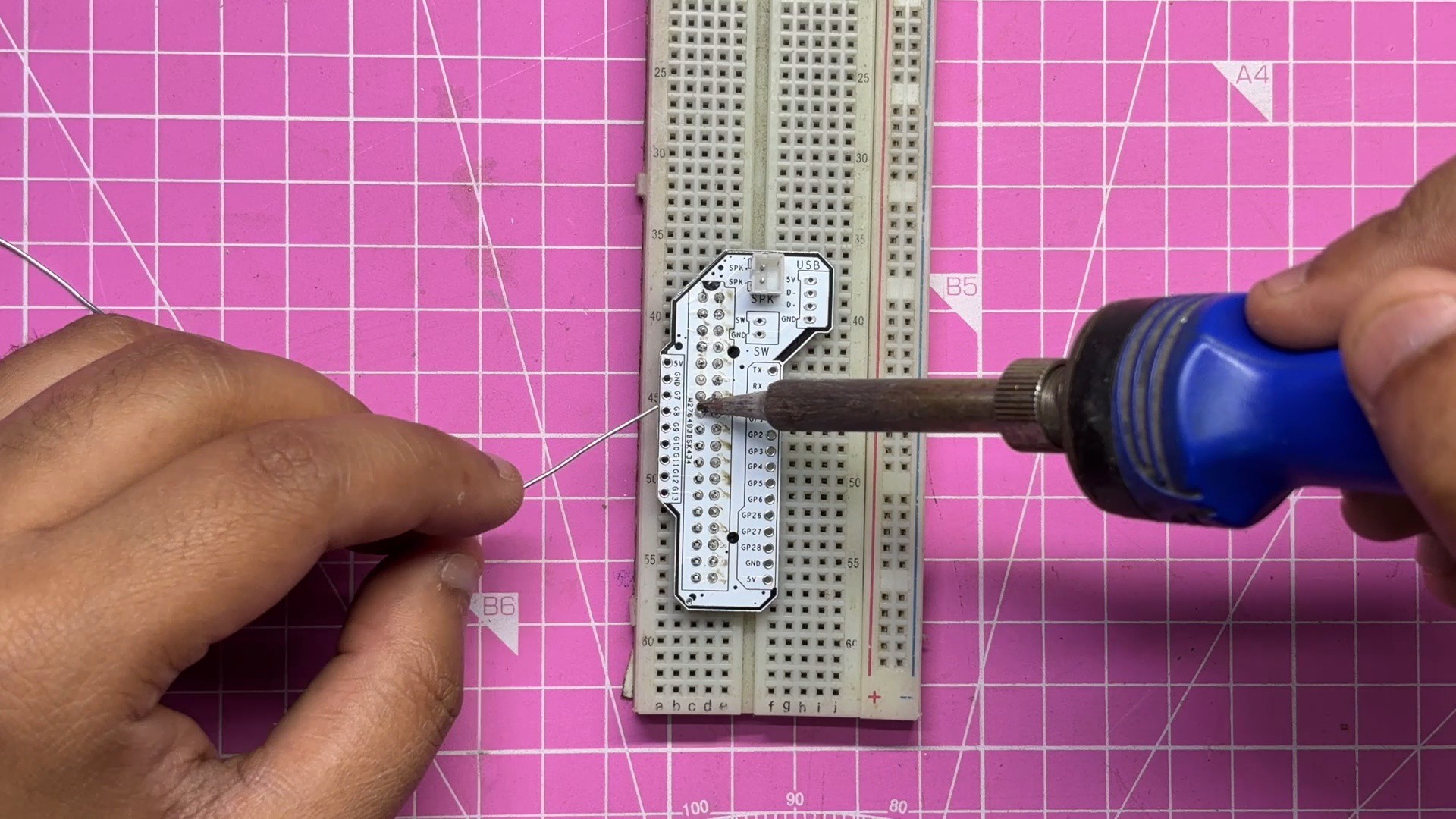

    • Next, for soldering the header pins, we placed the board on a breadboard. This is a useful pro tip when soldering header pins onto small modules or boards. If you place the header pins into the holes, they can sit slightly misaligned due to the tolerance between the pin and the pad hole. By placing the board on a breadboard, the header pins stay perfectly straight and aligned with the board, making it much easier to solder them cleanly.
    • After that, we soldered the pads of the CON2 JST connector, which completed the IOTA breakout board.
  • 3

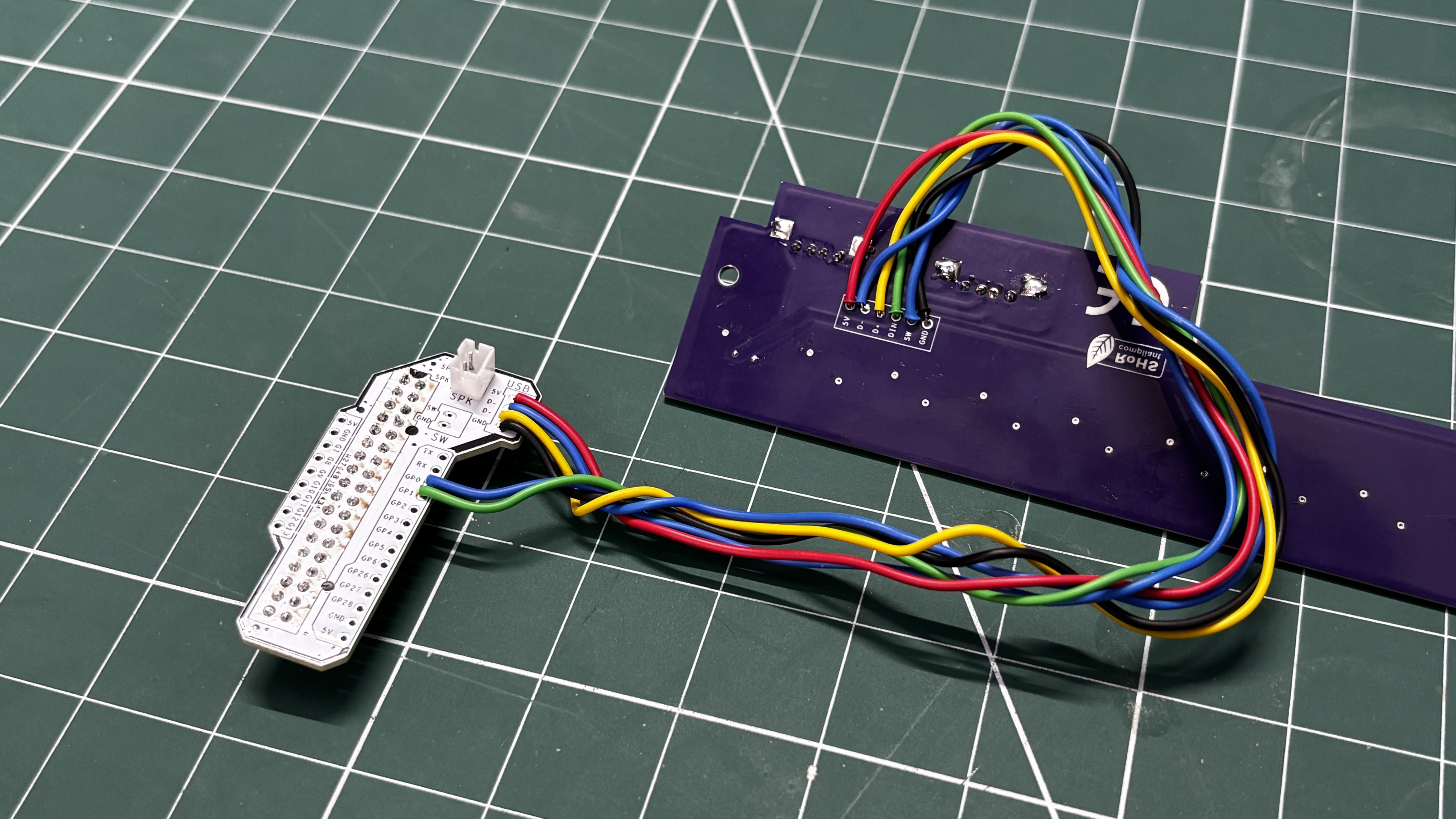

    FRONT IO BOARD & IOTA BREAKOUT BOARD SETUP

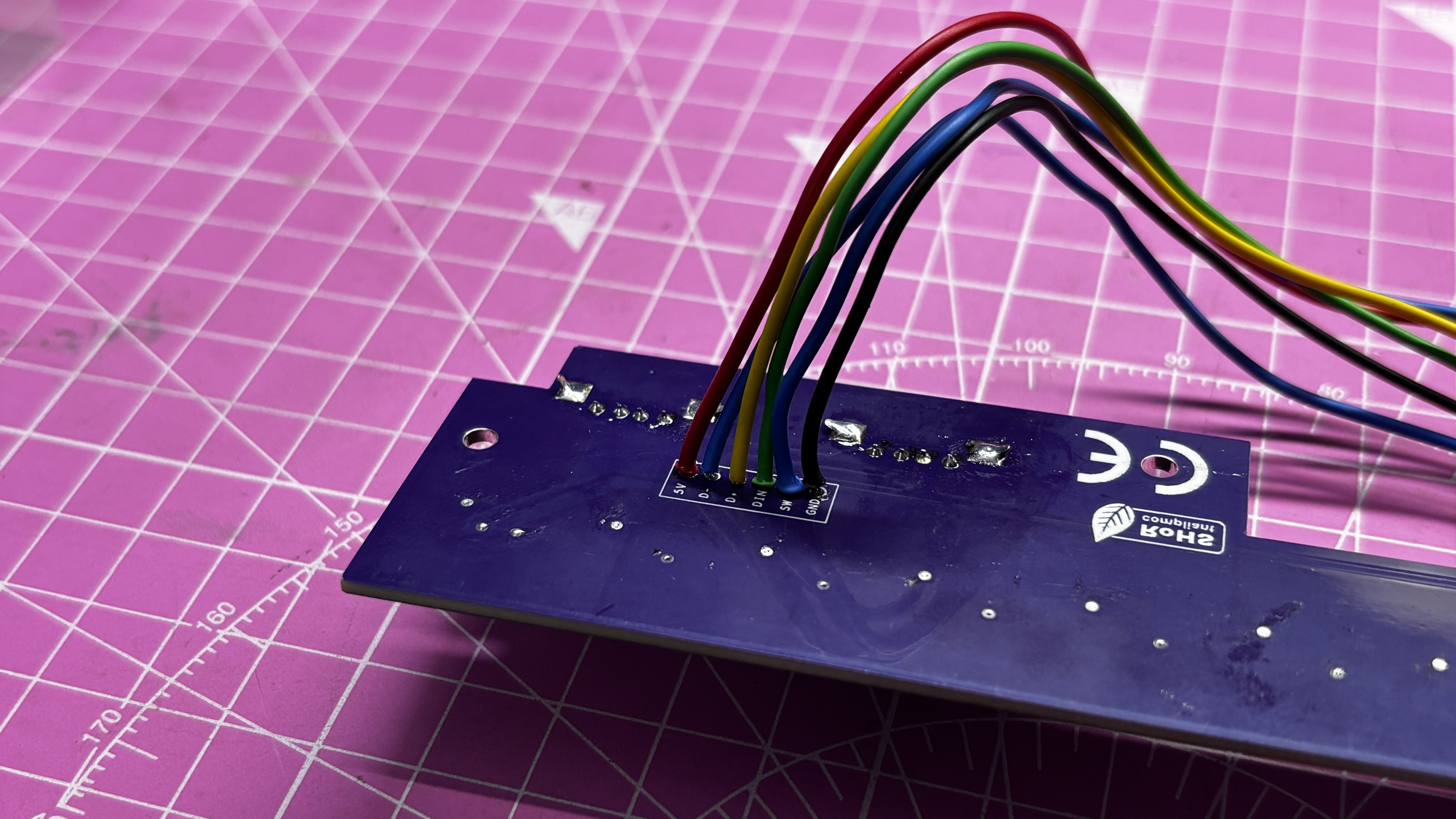

    The front I/O board and the LattePanda breakout board are connected together by linking the corresponding pins. First, the 5V pin of the breakout board is connected to the 5V on the front I/O board. The D+ pin is connected to D+ on the front I/O, and similarly, the D− pin is connected to D−.
    GPIO1 of the breakout board is connected to the LED DIN pin on the front I/O board, while GND is connected to GND. GPIO0 of the breakout board is connected to the button pin on the front I/O board.
    We used single-core silver-copper wire to make all the connections.
