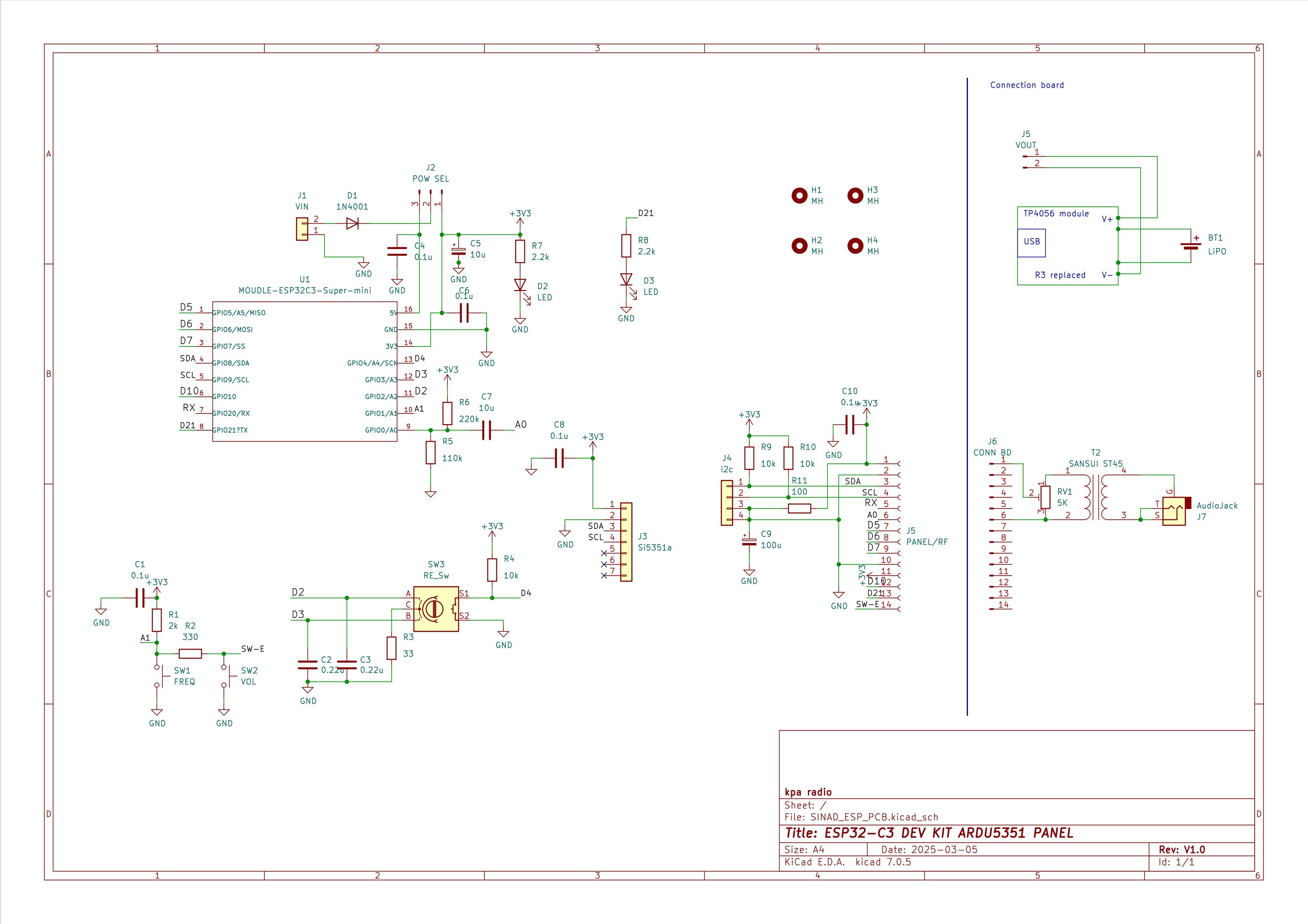

    Components and Circuitry
    The necessary components are the following circuit board components, components for the connection board (audio jacks, battery-related components, variable resistors and step-up transformer), wiring materials, and a case. The circuit diagram for the circuit board and an applied circuit diagram with added external components are shown. The step-up transformer is ST-45(600ohm:10ohm) of Sansui.
    Bill of Materials http://github.com/Nobcha/R909-VFO-ESP/blob/main/5531_esp_25_bom.pdf
    Circuit board schematics http://github.com/Nobcha/R909-VFO-ESP/blob/main/R909-VFO_ESP32_SCM.pdf
    Appliation circuit schematics

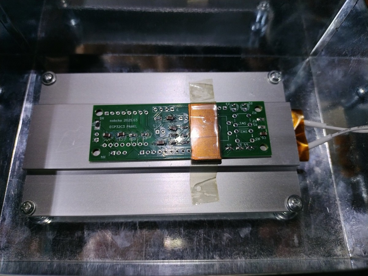

    This PCB needed to be quite compact, so all RC components except the aluminum electrolytic capacitors were surface-mounted.
    I found a heat plate with PTC-controlled maximum temperature on AliExpress. I used this heat plate and solder paste for soldering the surface-mount RC/C components.
    The component density isn't high, so hand soldering is also possible.
    After surface-mounting the components, the DIP components—electrolytic capacitors, sensors, switches, and pin headers—were soldered by hand.

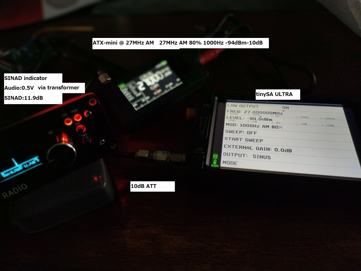

    I measured the receiving sensitivity at 27MHz (AM 80% Mod) with the ATX-mini HF/FM receiver using the Si4732. The value was -104dBm. To set it to 12dB SINAD, the volume adjustment had to be maximized and a step-up using a transformer was necessary.
    ATX-mini 27MHz 1000Hz 80% AM -104dBm 12dB SINAD
    SINAD measurement in progress   FFT view of the test signal
    In JH1LHV-OM's measurement example, the reading was -100dBm at 26MHz (AM 30% Mod), so the difference is likely due to the modulation depth setting. At 30% modulation, the SINAD did not rise above 12dB at my case.

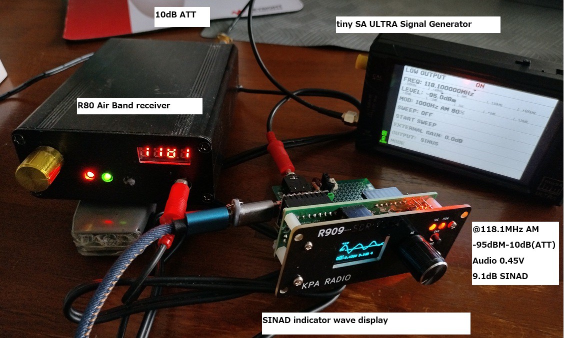

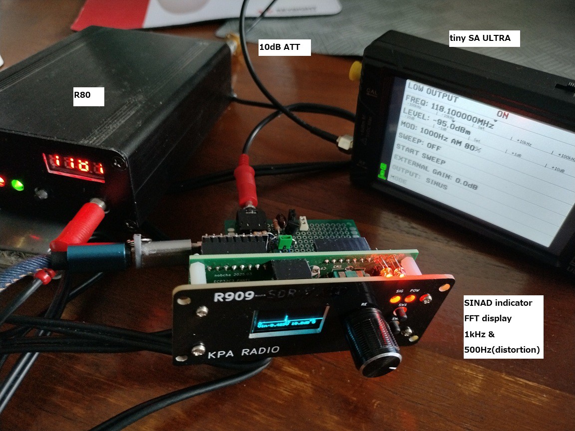

    I also checked the R80 Chinese-made airband receiver. This receiver has a configuration of NE602-MC3361-TA7640-LM386. A problem arose. Even with volume adjustment, the SINAD did not rise above 8dB. When using a deeper modulation of 80% at 1000Hz and examining the FFT, a component was found at 500Hz. Could this be due to the MC3361 chip being an FM chipset?
    Therefore, the sensitivity of the R80 airband receiver is equivalent to a SINAD of 8dB.
    R80 118.1MHz 1000Hz 80% AM -105dBm 9.1dB SINAD
    The FFT display helps visualize noise and distortion components.
