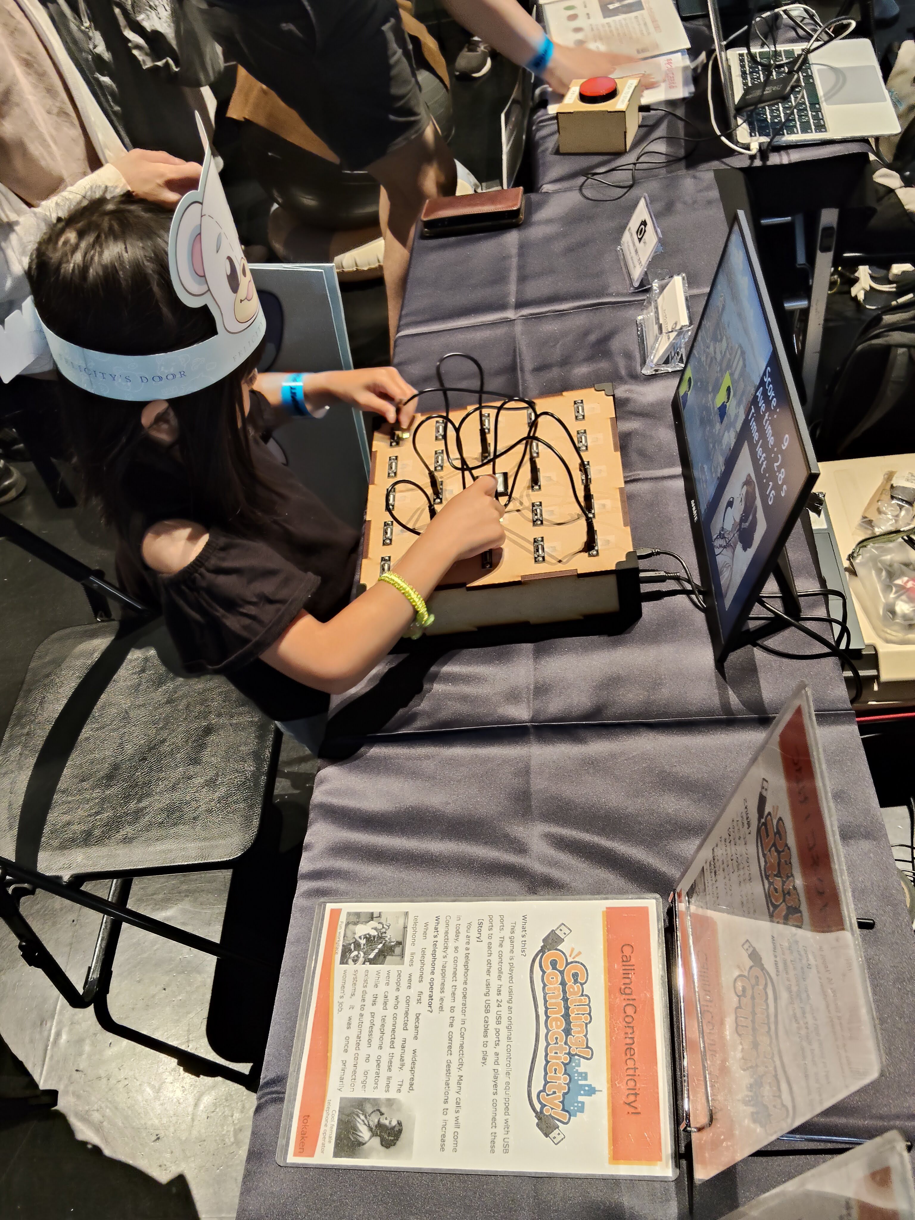

"Calling! ConnectiCity" ("つなげ!コネクトシティ!" in japanese) is a action puzzle game I made. This is a game themed around “telephone operators,” played with a controller that has many USB ports. The story is that you process people’s phone requests by connecting the ports with USB cables. To put it very simply... It is a game where you connect pairs of connectors whose LEDs are the same color on the controller using USB cables.
Game
The outline of the game is as follows.
When there is a phone request, the LEDs of two ports light up in the same color. These represent the caller and the receiver.
When you connect the ports of the same color using a USB cable, the connection is successful. This means you have successfully processed the request.
The objective is to process as many phone requests as possible within the time limit.
-> The more requests you process, the higher your score becomes.
Requests disappear after a while.
You can use any number of USB cables at the same time.
Game Screen
The game screen displays instructions on how to play and a panel corresponding to the controller. I worked hard to create it, but since most players play by looking at the LEDs on the controller, the game screen might not actually have been necessary.
Controller
The controller consists of 24 USB ports, 24 LEDs (each USB port and LED are arranged as a pair), and one button.
The USB connectors are Type-A. Therefore, when connecting connectors to each other, USB cables with Type-A connectors on both ends are required, but these are not normally available. USB has standards, and connections are based on a host-device relationship. Type-A is normally used on the host side, so if one end is Type-A, the other end is usually the device side, such as Type-B or micro Type-B. It is not normal for both ends to be Type-A. However, such cables can be found easily on sites such as AliExpress. Another reason I chose Type-A connectors is that they have a specific orientation; the frustration of trying to plug one in and failing because it is upside down also contributes to the difficulty. The button is used for actions such as starting the game.
