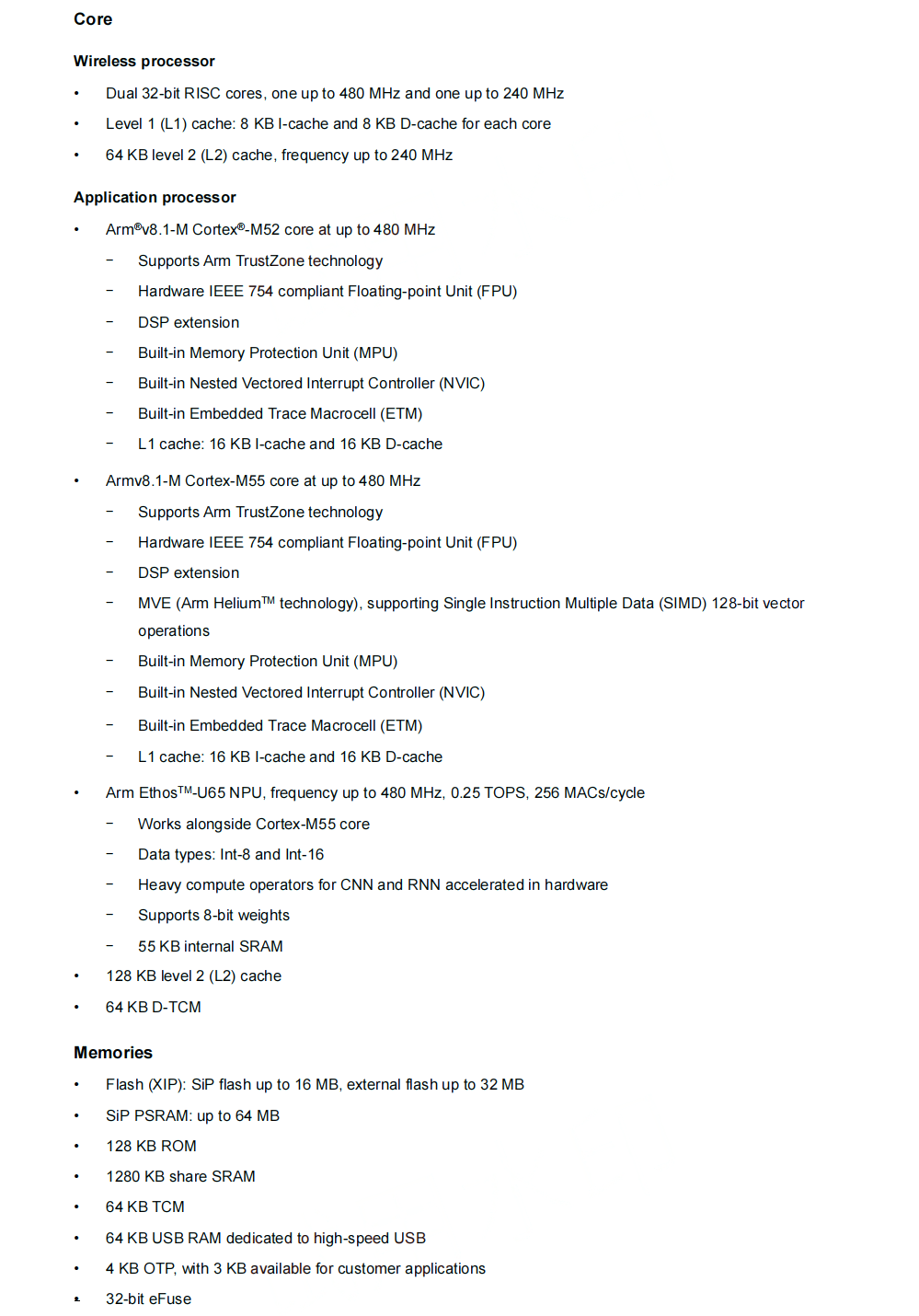

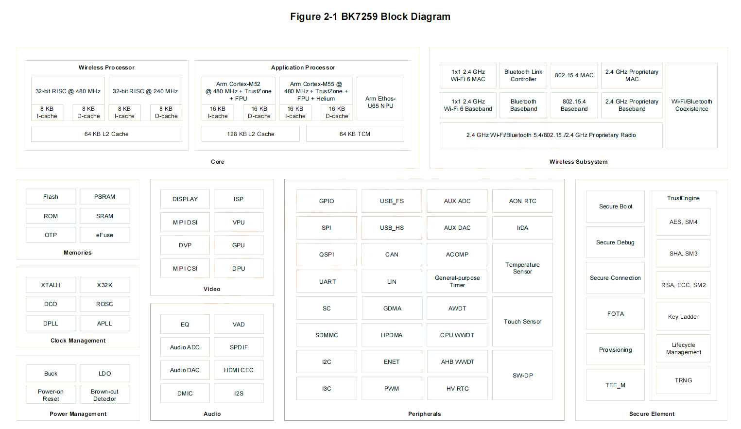

Block diagram of BK7259
05/11/2026 at 07:42 • 0 commentsIt is powerful and low-power, capable of driving at least 10.1 "800x1280 MIPI screens, and MIPI CSI and NPU have also been integrated. Preparing to start designing NGFF modules compatible with BK7258 for rapid validation.

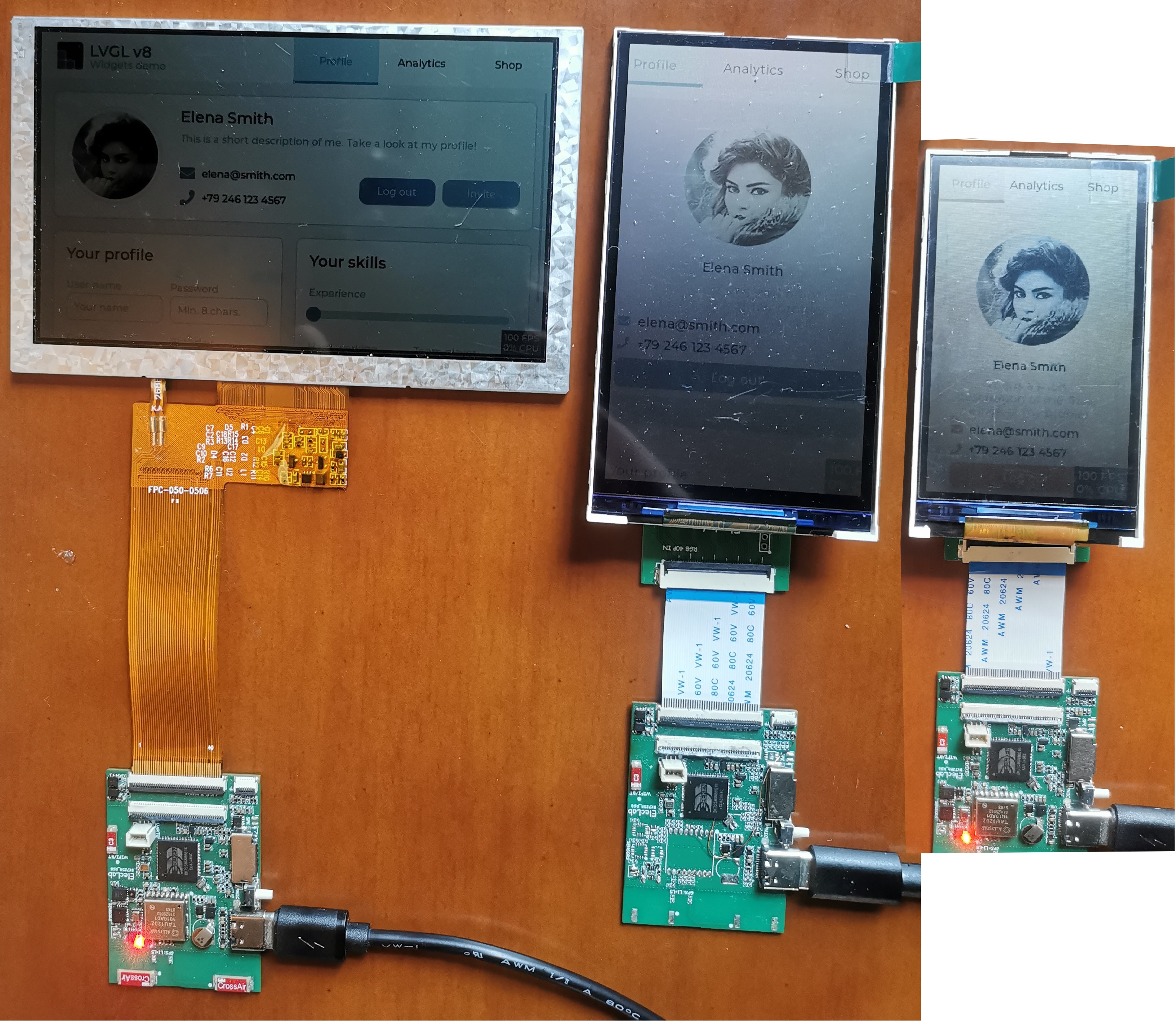

Add three drivers for the transflective LCD screen
04/28/2026 at 08:07 • 0 commentsWe tested three types of transflective LCD screens to determine which one consumed less current. Their dimensions, resolutions, and zero-backlight current are as follows:
3.0" 240x400 RLCD 5mA
4.0" 272x480 RLCD 10mA
5.0" 800x480 RLCD 56mA![]()

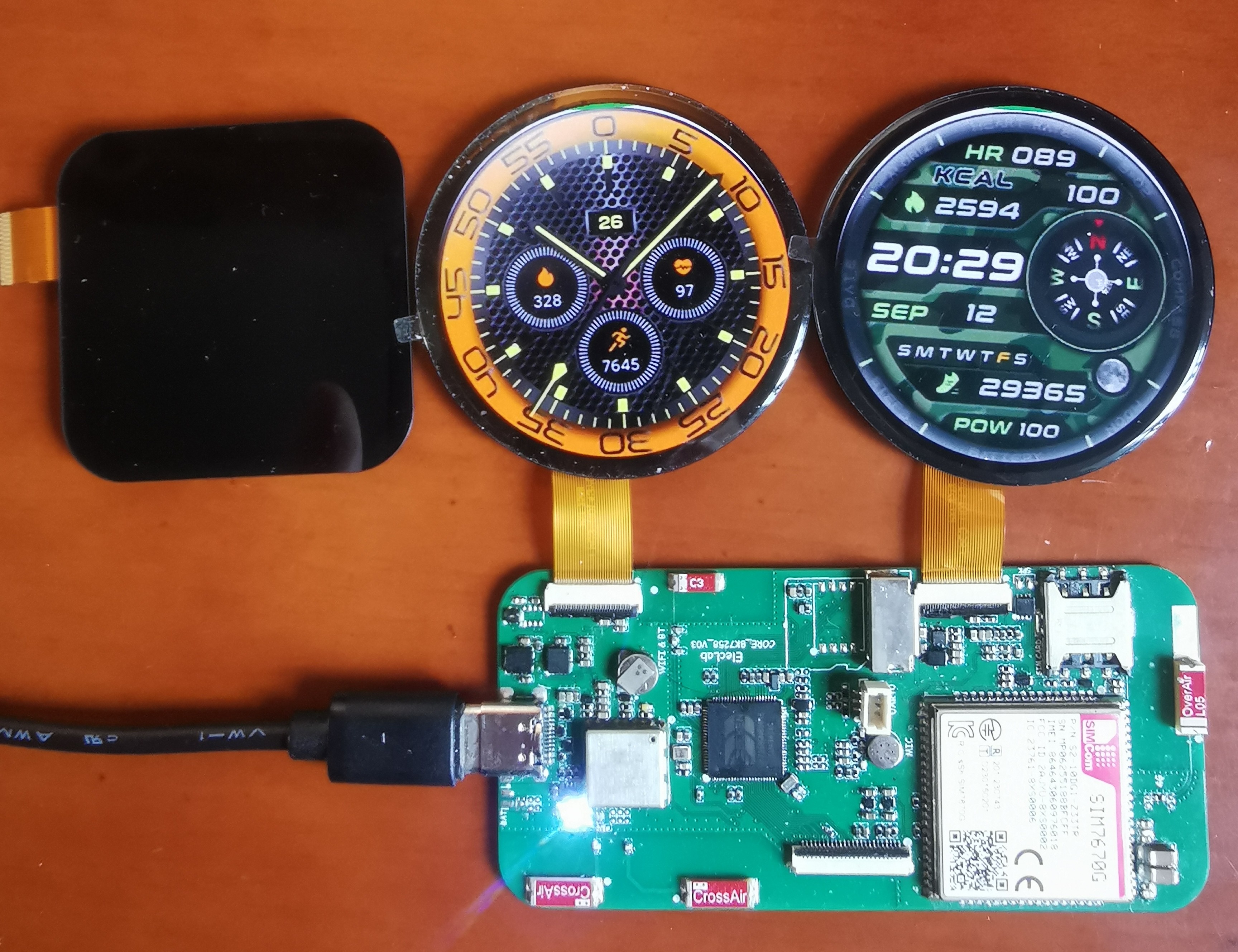

Add driver for Amoled 1.75" 466x466
04/28/2026 at 06:46 • 0 commentsWe have found a large-sized round smartwatch display with a resolution of 1.75" 466x466 AMOLED. On its left side is a maximum square display with a resolution of 2.16" 480x480 AMOLED. It boasts excellent display quality and low operating current. The current consumption is 75mA@5V when GPS is enabled. When GPS is turned off, the current consumption drops to 40mA. Therefore, the total current consumption is CPU + 2x AMOLED = 40mA@5V.

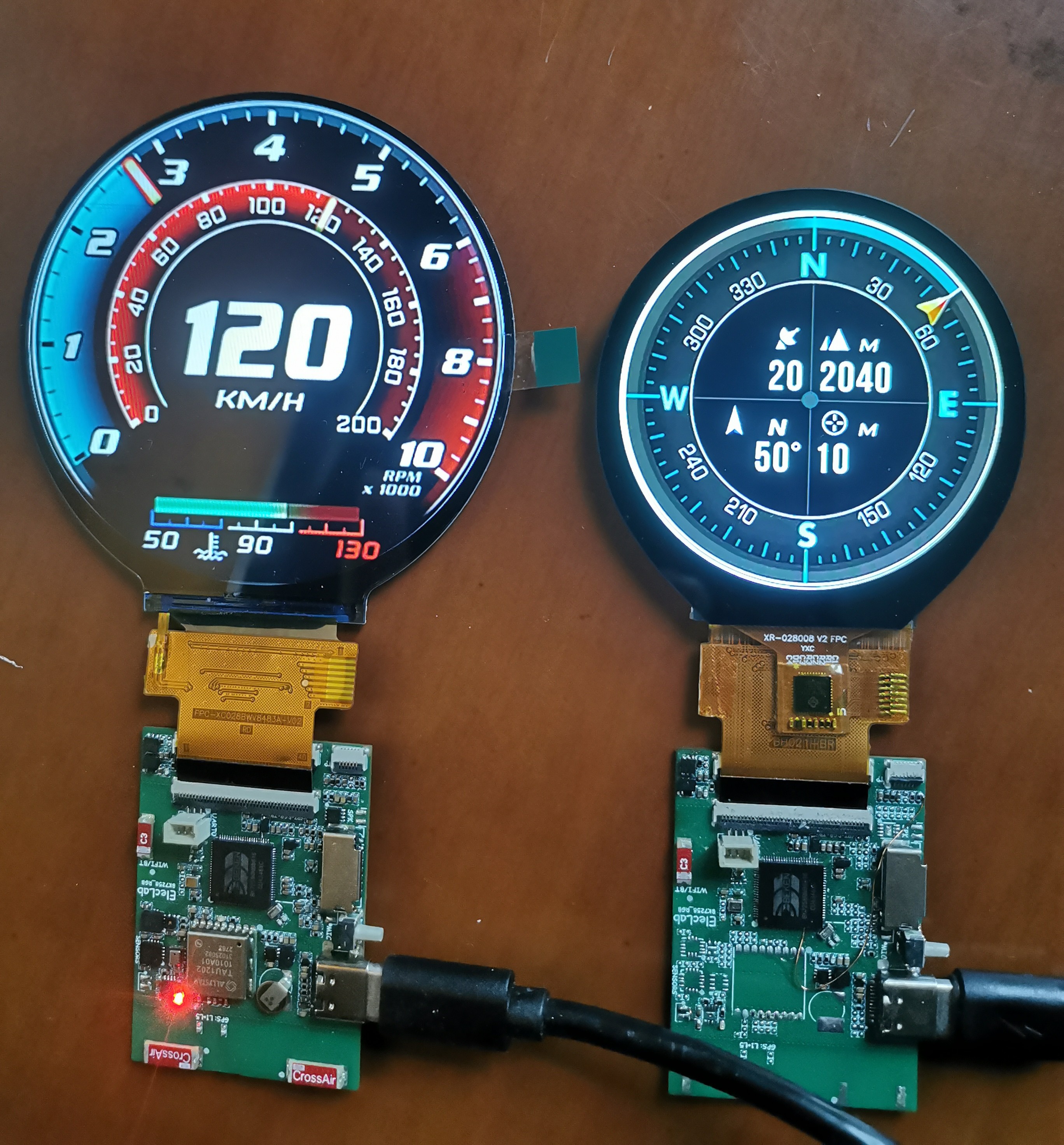

Add 2.8" 480x480 and 2.1" 480x480 round LCD screen driver
04/24/2026 at 01:08 • 0 commentsThese two round screens are only different in size, and their resolution is exactly the same.
Simulated aviation instruments and motorcycle instruments use such screens.

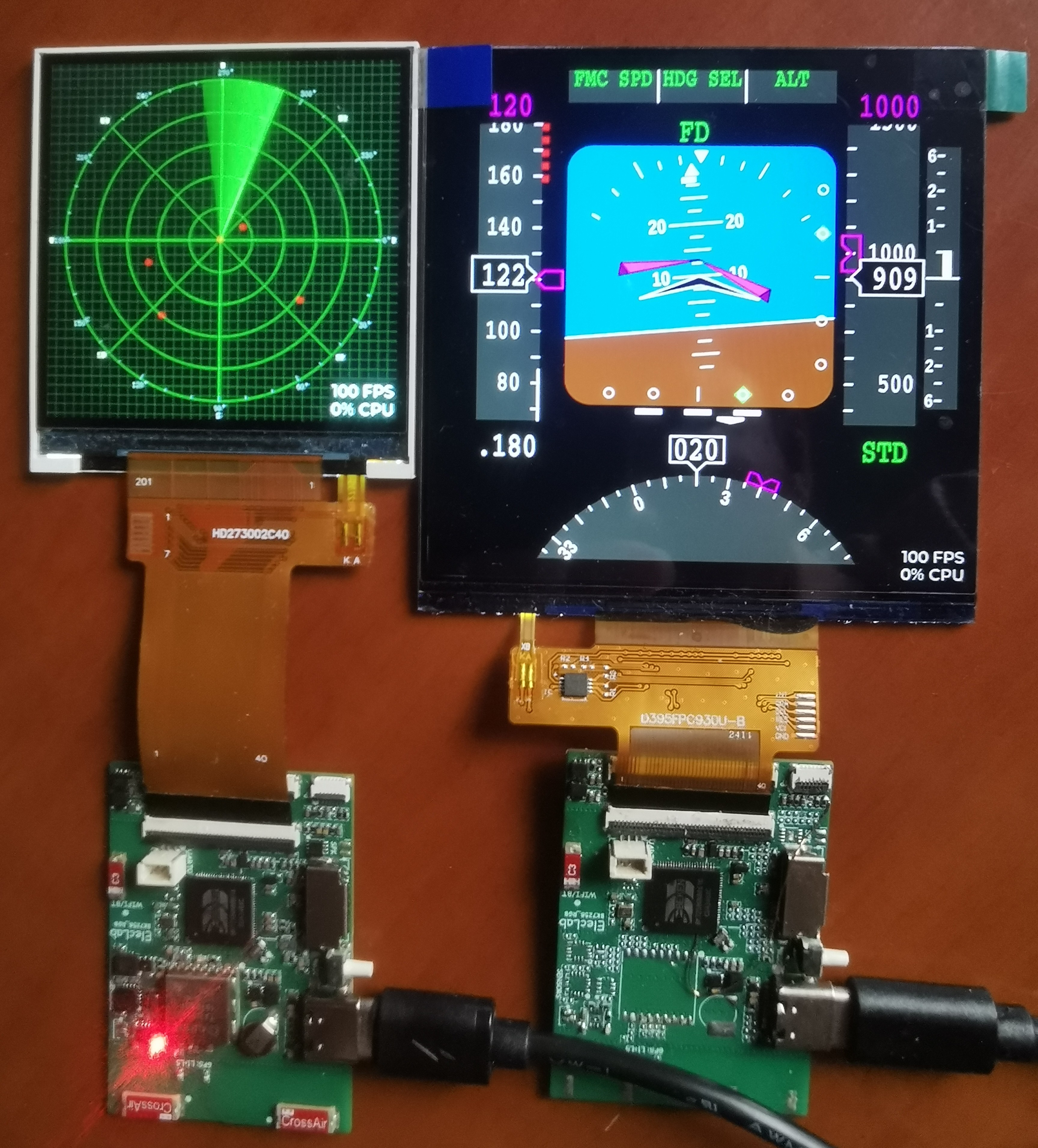

Add 2.73" 320x320 and 4.0" 480x480 square LCD screen driver
04/22/2026 at 04:06 • 0 commentsSquare LCD screens are very common in instruments, especially the 4" 480x480 is widely used in 86 boxes.
