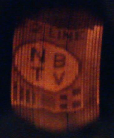

    There it is. It was hard to capture. What works is a global shutter 120fps capture with averaging.
    Still a bit distorted here, but come on, it's working already :)
    I'll play around a bit for beeing able to elaborate and improve on that.

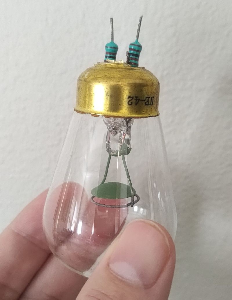

  • Crater Bulb
    Paul Kocyla07/04/2026 at 13:43 0 comments
    It wasn't easy to find the right neon bulb for that project. They are mostly too small.
    Those nice, big beehive lamps, that amateurs used in the 1920s, are not available on Ebay anymore.
    There are bulbs with large electrodes, but they are not that bright because of the coating, they are more decorative.
    I have two of those crater bulbs in the picture. This one was already broken, so I opened the base to check for the internal resistors. There are two inside, and they both have to go.
    I want the tube to draw current through the bulb, and they would be just in the way - reducing contrast.
    The tube itself will have enough internal resistance to prevent the current from running away.
    This one is either from the 1930s or a more modern replica (resistors look younger), but it is so far the closest I can get to a 1920s type. Technically very comparable, though.

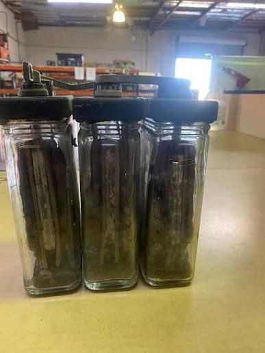

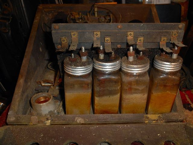

    OK, further research revealed that the battery eliminators back in the day used either massive coils with low resistance to solve it, or they used messy electrolytic cells as "filter batteries".
    The cleanest so far were small 6V lead acid batteries that were just charged in the background through a resistor and acted like a giant filter.
    I will try this next. I will try whatever helps. The easiest way would be to use indirectly heated tubes, but NO, I will not give up yet. Challenge is to stay in the lower 1920s and feel the pain they had...
    I found a picture of an early battery eliminator, and yes, it's got battery jars in there to solve exactly that problem. To be fair, I am not quite sure if those jars in the image are the actual battery cells or a messy electrolytic rectifier. Just read that this cheap form of rectification was a thing, too - updates will follow...
    This has to be the reason why indirectly heated filament tubes have been invented when the power grid was getting available everywhere - it's cheaper than those dirty workarounds. But OK, I'll do the dirty workaround because why not:
