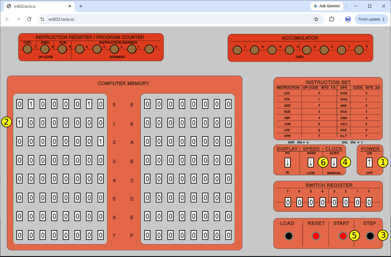

    By way of getting started I have written a simple "counting" program to run on the NRI 832.  Here it is:
    00   ADD 02       // Add the contents of memory location 02 to the accumulator.
    01   JMP 00       // Continue execution at memory location 00.
    02   01           // Data: set to the number 1.
     Here are the steps to run this program:
    1. Make sure that the POWER "switch" is ON. All of the switches (0, 1, ↓, ↑) can be toggled by simply clicking on them. NOTE: You can set all of the registers (A, B, E, I, PC) PLUS the RAM memory to zero by toggling POWER OFF then ON.
    2. Convert the program code to binary and enter it into the first 3 ROM memory locations. Remember that for instructions, the first 3 bits represent the opcode, and the remaining 5 bits the address.
    3. You should be able to now "press" (click) the STEP button repeatedly to advance the program 1 instruction for each click. As you do this the ACCUMULATOR lights should show the numbers 0, 1, 2, 3, etc. in order as binary.
    4. When you get tired of pressing STEP, you can change the CLOCK to AUTO by clicking on that switch.
    5. Then press the START button. The instructions will start executing automatically at 2 second intervals.
    6. Finally, if you find the AUTO execution pace too slow, you can switch SPEED to HIGH (about 10 instructions per second). You can pause the execution by clicking START again, and resume with yet another click.
    To "restart" the program, click the RESET button. The the registers (A, B, E, I, PC) will be cleared to zero, but the program and switch settings will remain untouched.

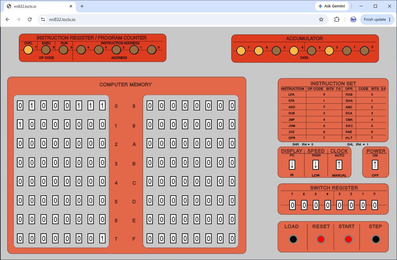

    I have put my NRI Model 832 Digital Computer Emulation up on the Web.
    Check out: https://nri832.loclx.io
    I have posted an NRI 832 Reference Manual and an NRI 832 Cheat Sheet to the Files section above.
