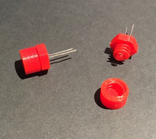

LED Holder With Threads.3mf
A panel mounted holder for 3 mm LEDs.
3mf - 237.93 kB - 04/28/2026 at 19:55

Button Cap.3mf
Shell to "decorate" the slide switches lever.
3mf - 81.07 kB - 04/28/2026 at 19:55

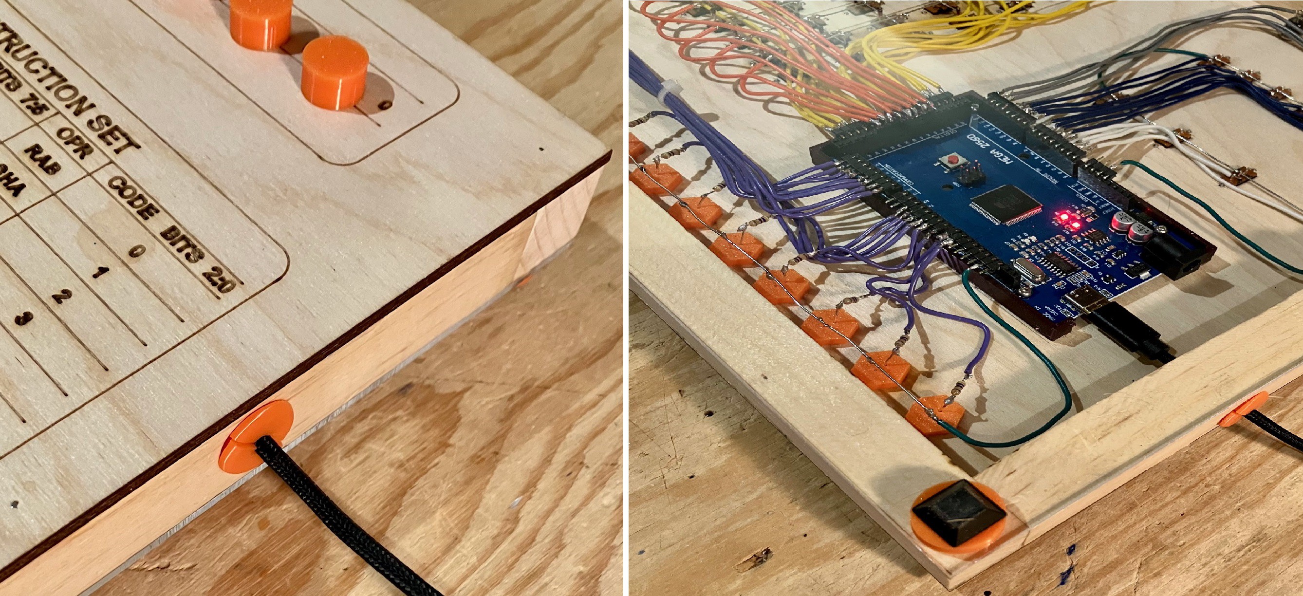

    I wrote a test routine that exercised all the hardware and was a bit surprised that everything mostly worked. There were a lot of solder joints I could have messed up. In the end I had to replace three of the push buttons that were a bit flakey.  Not sure what happened to them. I'll keep an eye on the replacements, and a lookout for some better buttons.
    I still wanted to show off "how the sausage was made", but needed  to protect the exposed wiring, so  I attached a clear acrylic laser cut bottom panel.
    Trust me, there is an acrylic panel there ;-)  I printed some "washers" to hold the panel in place without running the risk of cracking the acrylic, and to counter sink the screw heads.  Then I had to add some rubber feet to keep the unit from slipping around on the slick washers.
    I drilled a 13 mm hole on the side of the case to pass through the USB cable that will be used to program the emulator and for now power the unit.
    Then I printed a "plug" to hold the cable firmly in place.
    When the programming is done, my plan is to replace the cable and plug with a proper power socket connected to the POWER switch on the console. For now the POWER switch could be used to put the Arduino in "sleep mode" on power OFF, and wake on power ON.

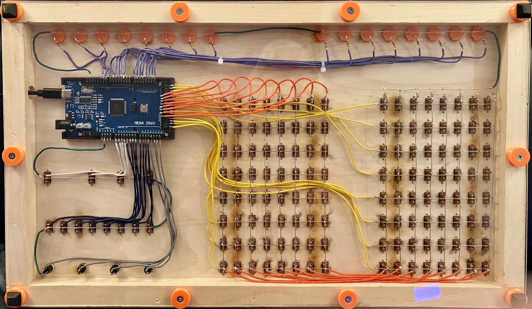

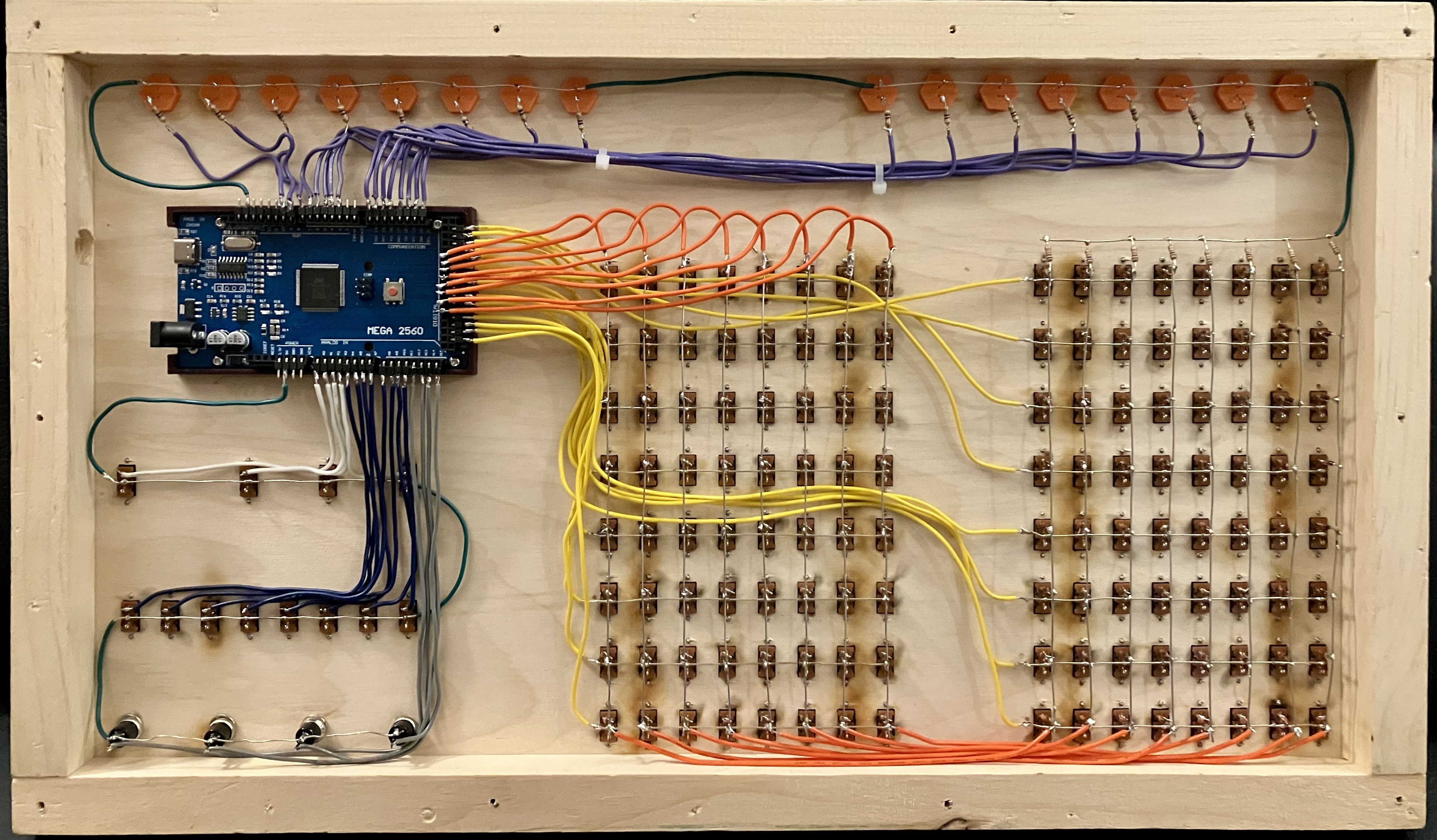

  • Wiring (Part 3)
    Michael Gardi04/27/2026 at 18:58 0 comments
    Just finished the wiring for the NRI Model 832. In the absence of a any PCBs (other than the Arduino MEGA) that's a lot of wire. Hopefully I haven't messed up too much. Let the testing begin.

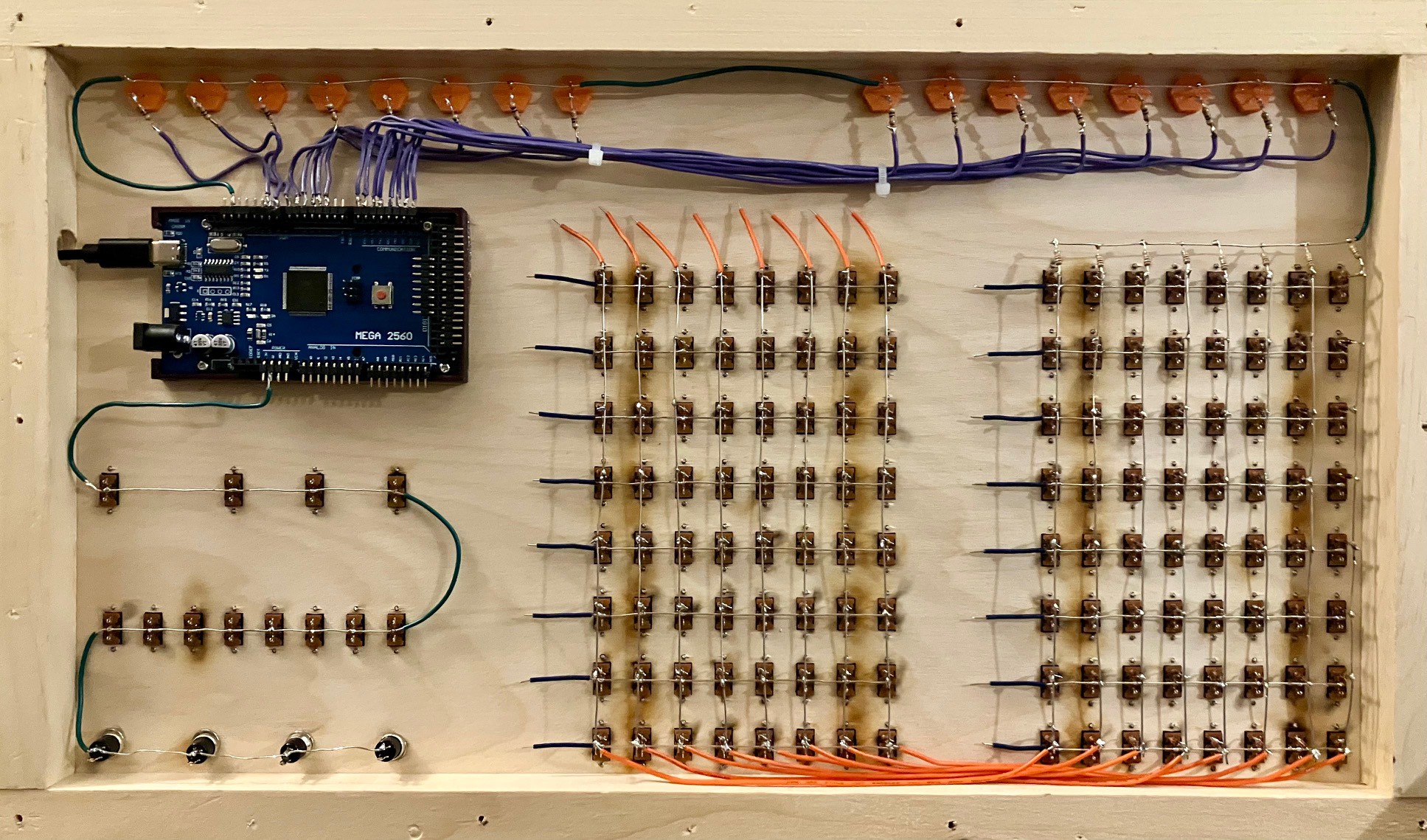

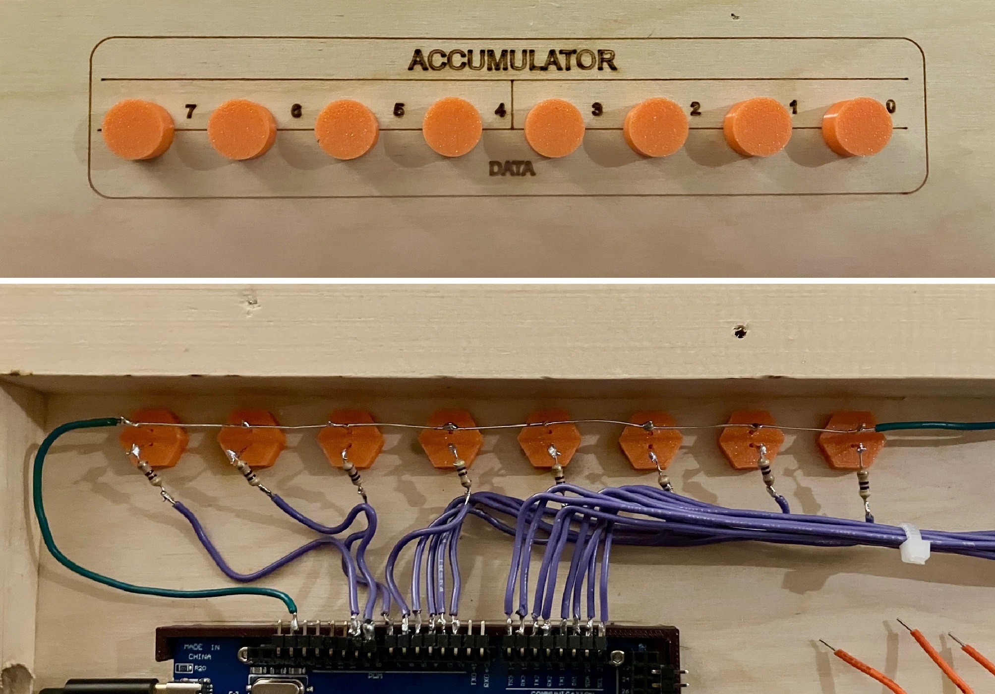

    I ran the script and guess what, none of the lamps turned on. A quick check showed that the output pins defined were in fact going HIGH each in turn.  What?
    It took me a few minutes to realized that the Arduino pins did not have enough Amps to drive the lamps. On closer inspection of the lamp description it turns out the lamps require about 300 mA whereas an Arduino pin only puts out 20-40 mA. I had assumed since they were basically LEDs they would not require so much current. Sigh.
    I considered running the lamps on a separate power supply and using some switching transistors to drive them. I even ordered some 2N2222 NPN transistors. As much as I really liked the look of the old timey lamps, in the end I decided that this just added too much complexity for this version.  It took minimal rework to switch to LEDs.
    I used some Panel Mount LED Sockets that I had designed for another project.
    Here is the rewired panel so far.
    Note that the 470 ohm limiting resistors are just wired inline.
    Now when I run my little test program I get blinkenlights.

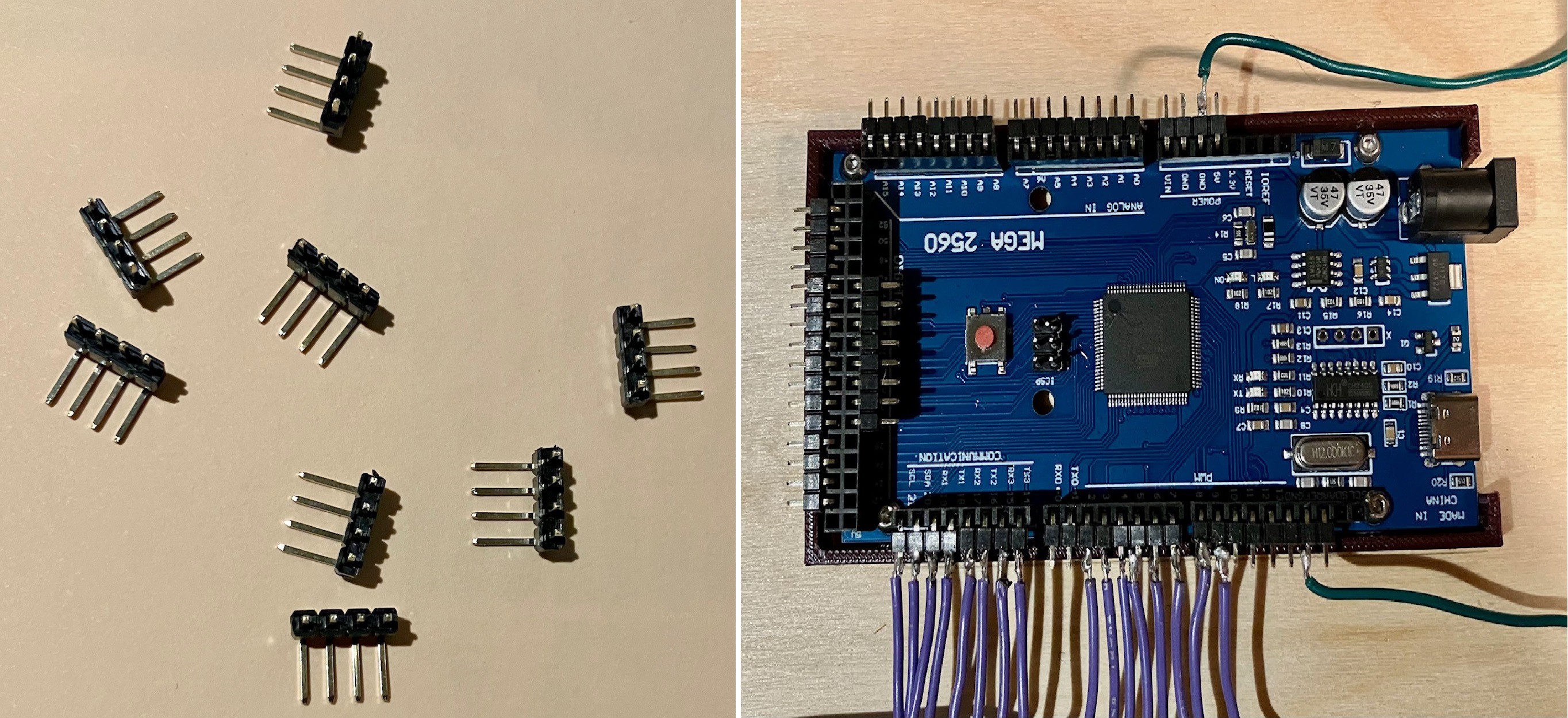

    I started wiring the lamps first. There is a wire going from each lamp to a pin on the Arduino MEGA.
    I slid the long pins of some male 90 degree headers into the MAGA's female headers and directly attached the wires to the appropriate pins via the short pin of the header. Also attached were two ground leads.

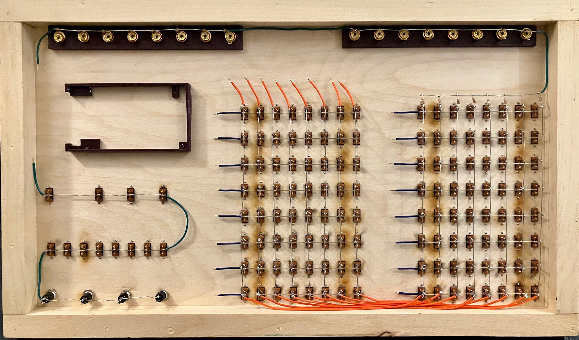

    While I waited for my Arduino MEGA 2560 to arrive I decided to get a start on the wiring.  I created a 3D printed holder to mount the Arduino development board and glued it in place.
    Preliminary Wiring Including ROM Switch Matrix

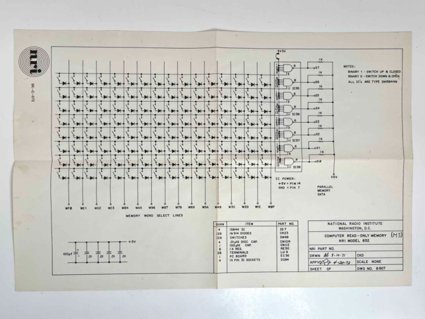

    The biggest part of this job was to create the ROM switch matrix which is basically the same thing that is done to read the switches on a keyboard.
    Original NRI Model 832 Keyboard Schematic

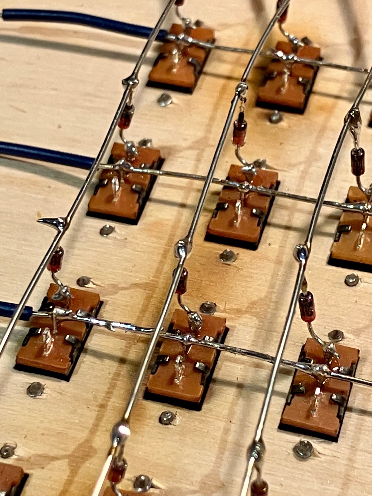

    There is a diode for each switch to prevent "ghosting", a phenomenon where pressing three or more keys simultaneously causes an unintended fourth key to register. (NOTE: My implementation is a little different than the one in the schematic.)
    ROM Matrix Wiring
    The diodes are mounted in such a way as to elevate the common "column" wires safely away from the "row" wires. Looks a little like magnetic core memory to me. I had done something like this for the Core Memory Panel of my Working Digital Computer project.
    The rest of the work was to run a ground wire to each of the remaining switches, bulbs, and buttons.

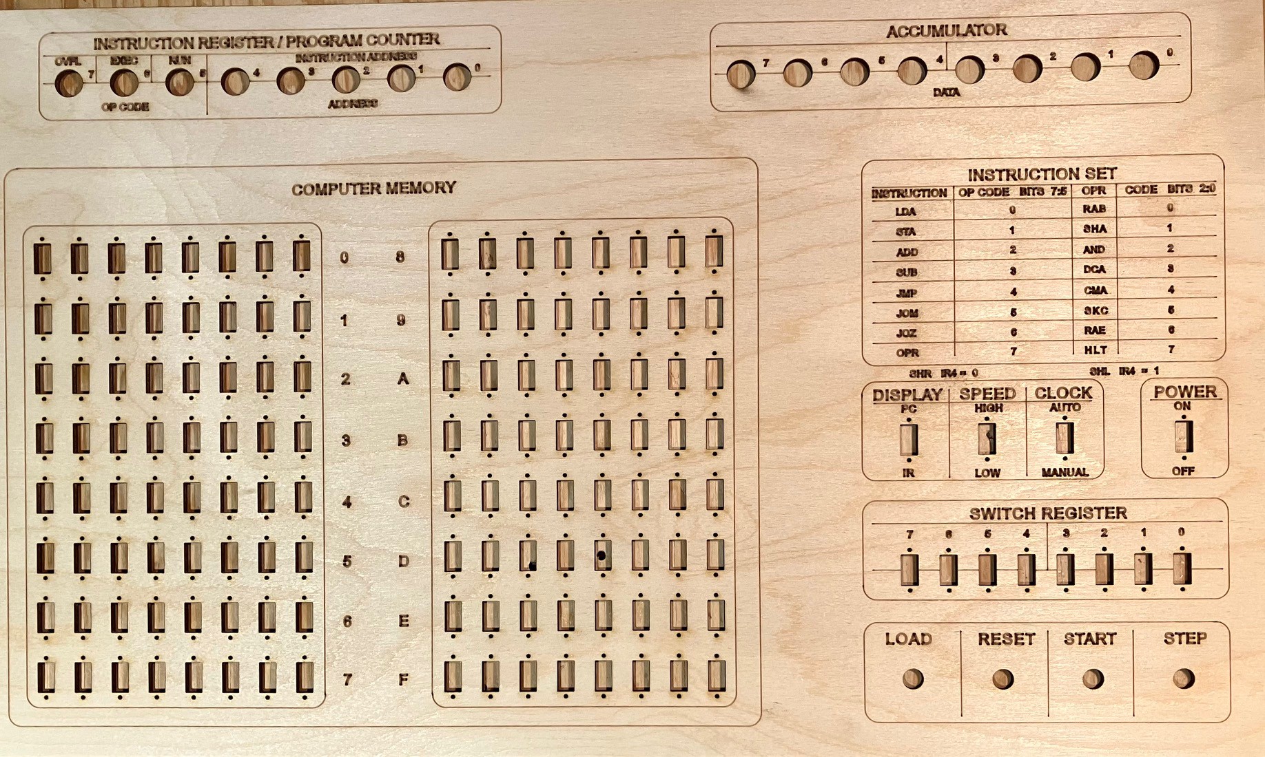

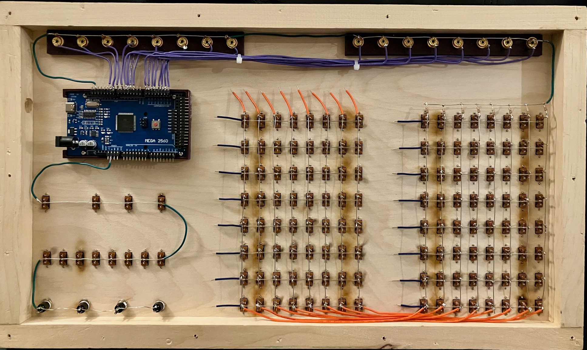

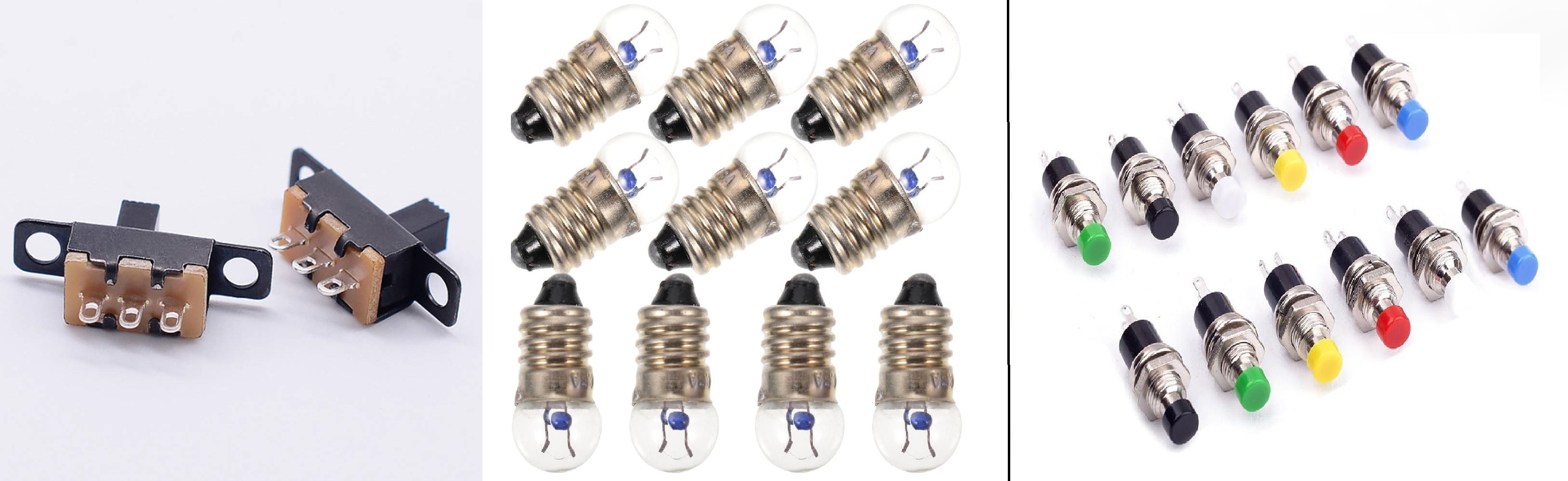

  • Populating the Front Panel
    Michael Gardi04/18/2026 at 02:05 0 comments

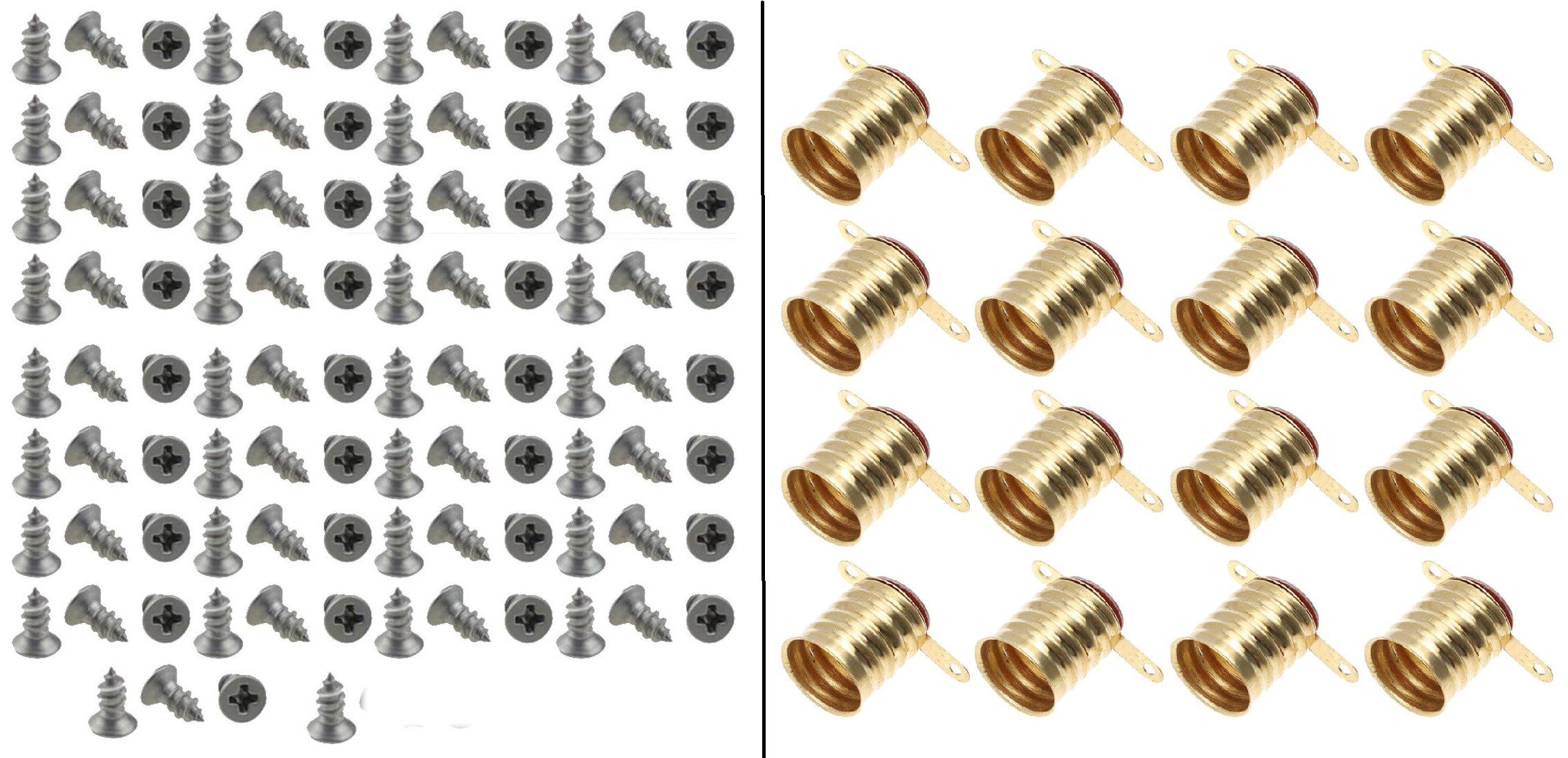

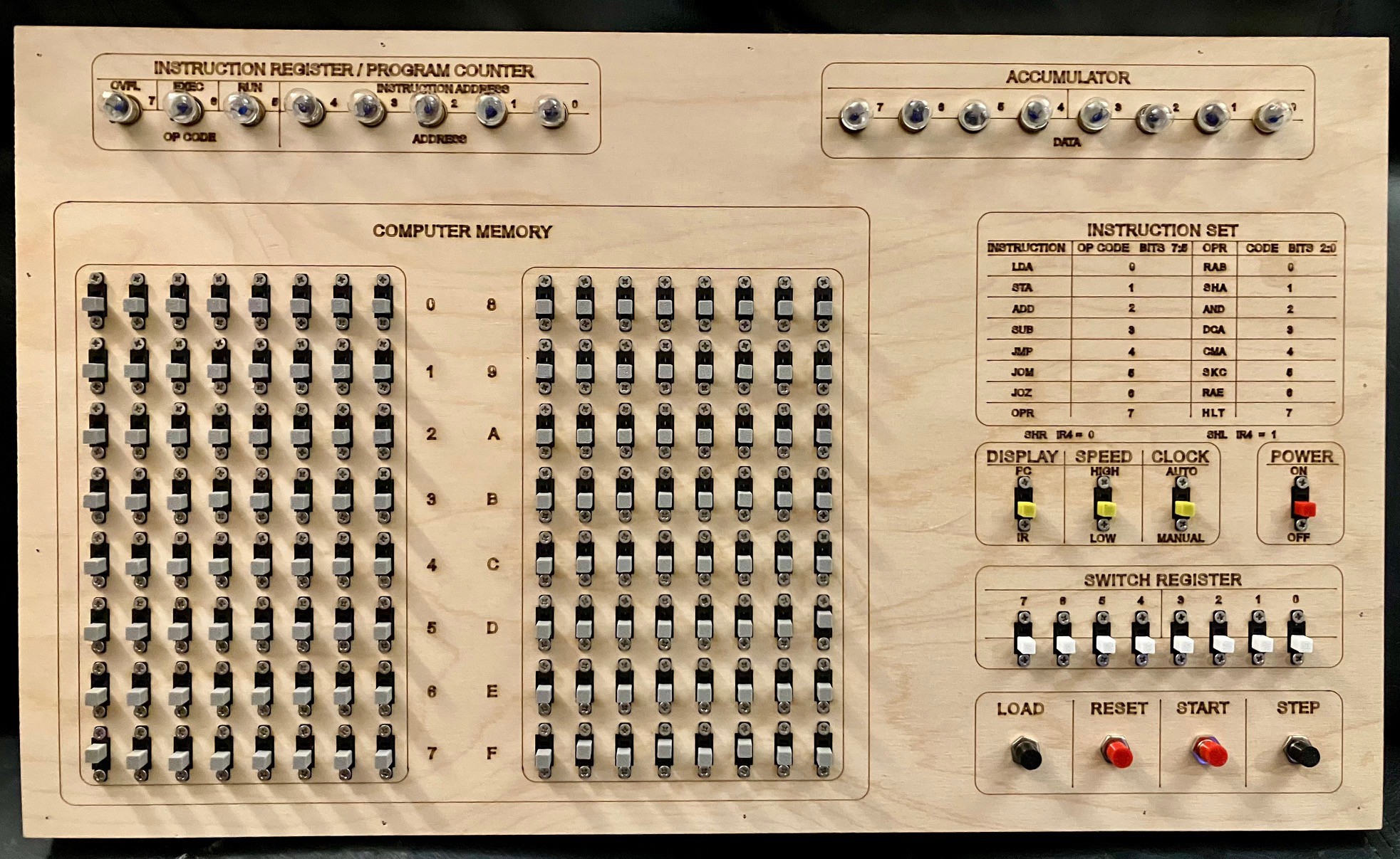

    With the front panel lased, I added the switches, lamps, and buttons.
    Slider switches, all 140 of them, are attached with 280 M2.5 x 6 mm screws. I did these all by hand to ensure that I didn't over drive them and ruin the wood. Lasered starter holes for the screws helped. I panel mounted the 4 push buttons.
    I found some E10 sockets for the lamps that (luckily) fit perfectly into the pre-cut 10 mm holes. The sockets are anchored from below with 3D printed friction fit socket holders.
    Finally I 3D printed and added coloured caps for the switches and buttons.
  • Lazing The Front Panel
    Michael Gardi04/15/2026 at 18:44 0 comments
    No I wasn't being lazy creating the front panel, but lasing the panel from plywood was pretty easy.

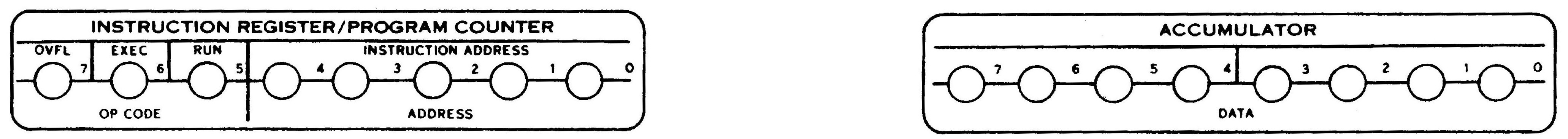

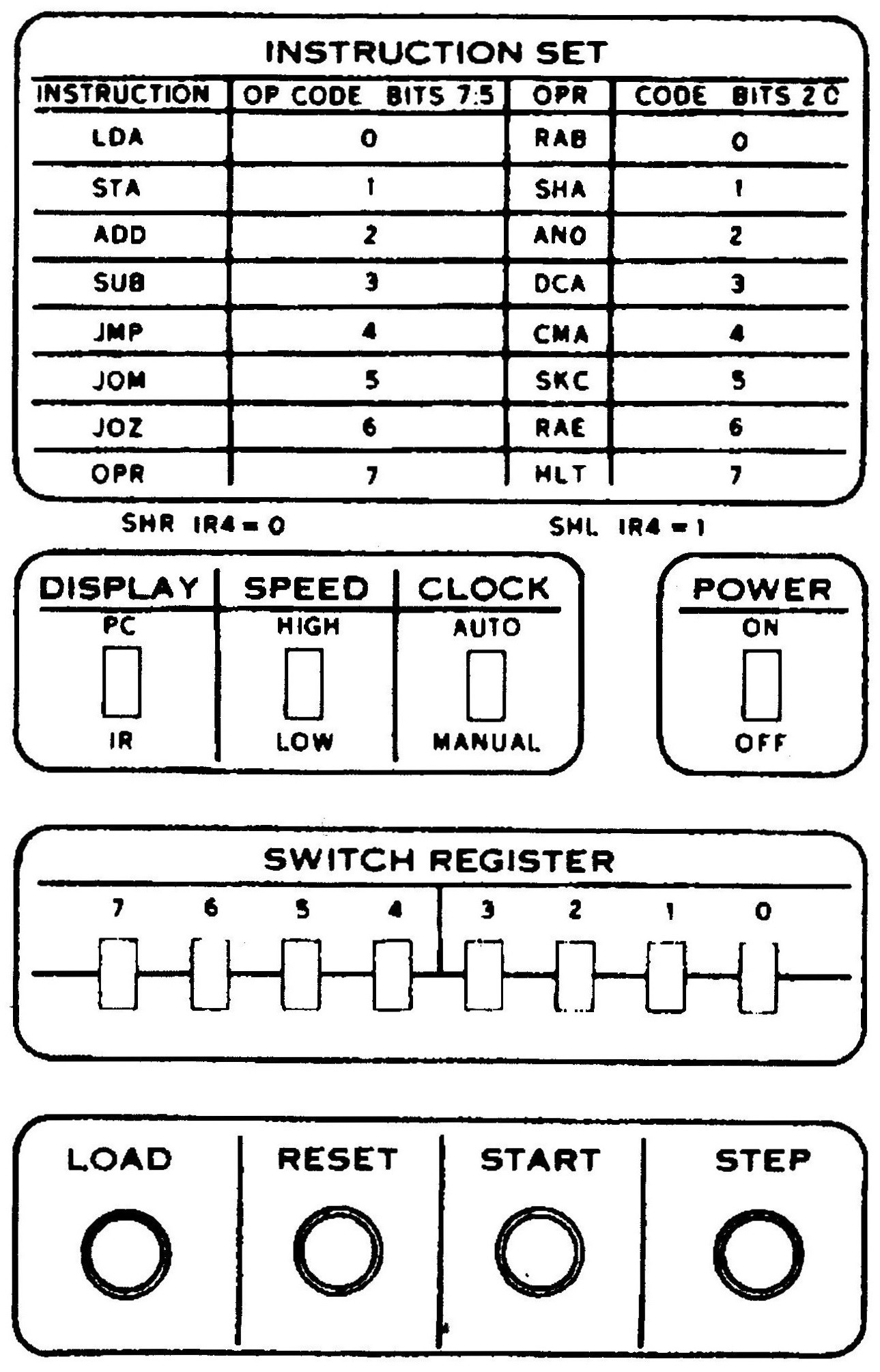

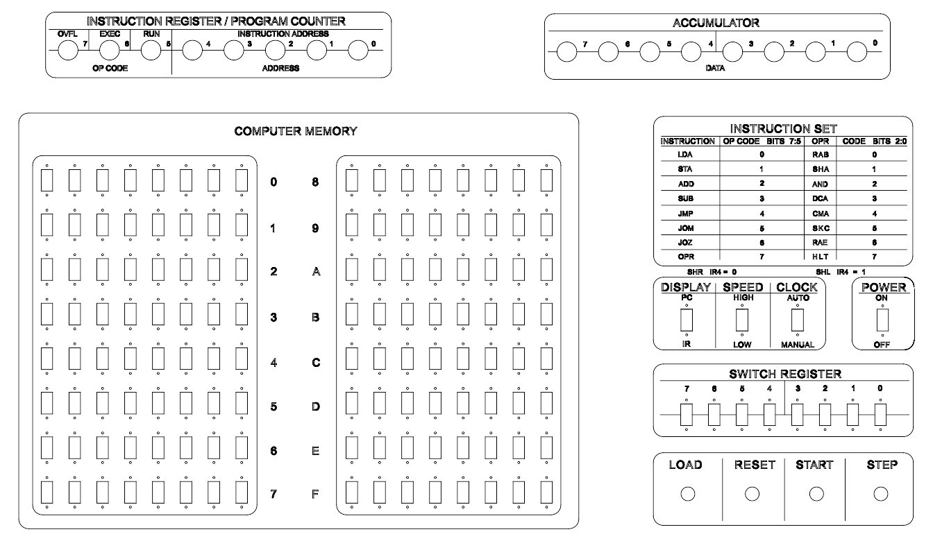

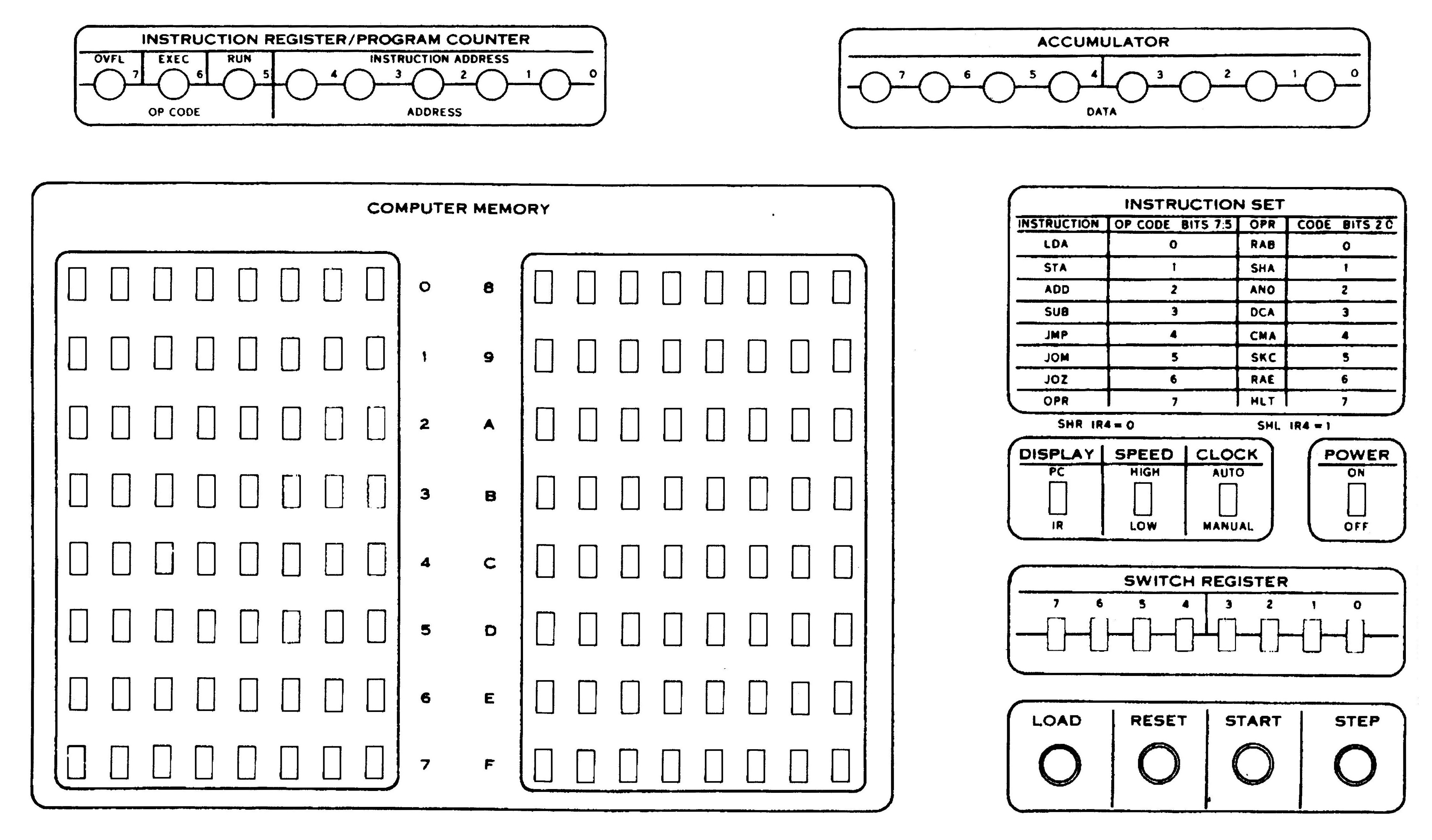

    There were some diagrams in the Reference Manual that showed the text and outlines of the front panel that I was able to organize into a layout for the Model 832.
    I brought the above image into Autodesk Fusion as a "Canvas", basically a background picture. You can "calibrate" the image to be the millimeter size you want in the real world. Then its a matter of "tracing over" the elements with CAD based lines, circles, and text. The result is saved as a DXF file (which I have posted to the Files section above).
    DXF files (sometimes called cut files) can be loaded into the LightBurn Software that drives the 100W laser at Kwartzlab (my local makerspace). The front panel was created in two passes. First the text and outlines were added onto the birch plywood sheet I was using with vector engraving which follows path lines, tracing graphics like a pen to create deeper, faster lines.  On a second pass the holes for the switches, lights, and buttons were cut out using a much higher power. Here is the result.
    Pretty happy with the way that it turned out.

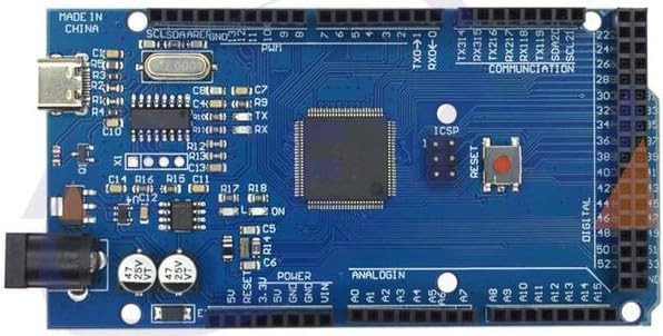

    I mentioned already that I had decided to use an Arduino development board to "drive" the NRI Model 832. It's more than powerful enough to emulate the simple Model 832 computer. The problem is that all of those switches, buttons, and lamps require a lot of IO lines. To enumerate:

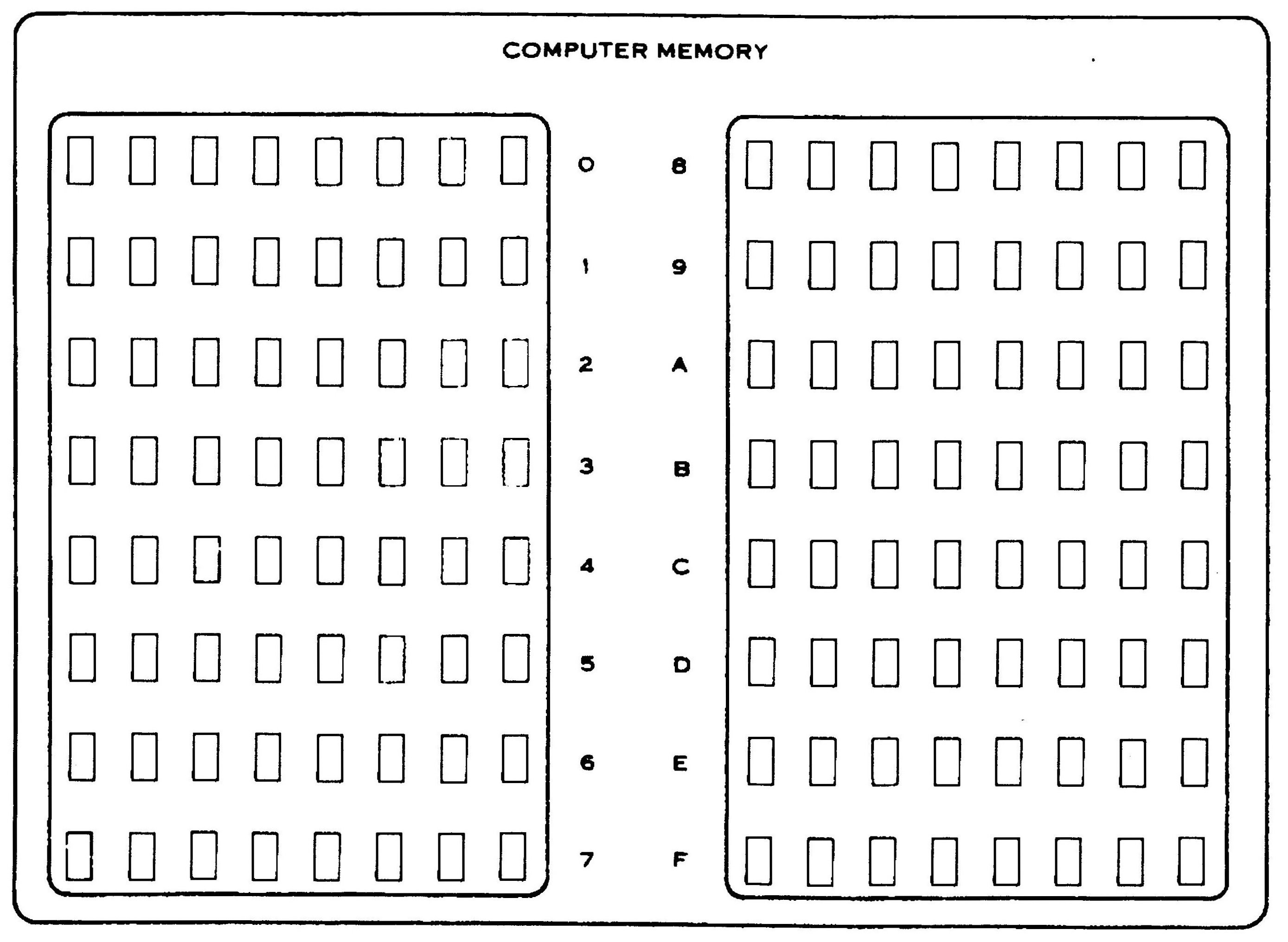

    • ROM memory switches need 24 IO ports, 16 lines for the switch "rows", and 8 bits to read the switch "columns".
    • Lamps require 16 lines, one for each.
    • Switch register switches 8 lines.
    • Control switches and buttons another 8 lines.
    For a grand total of 54 IO lines. Well as chance would have it the Arduino MEGA 2560 has 54 available digital IO pins (more if you use the analog ports as digital).  Done.
