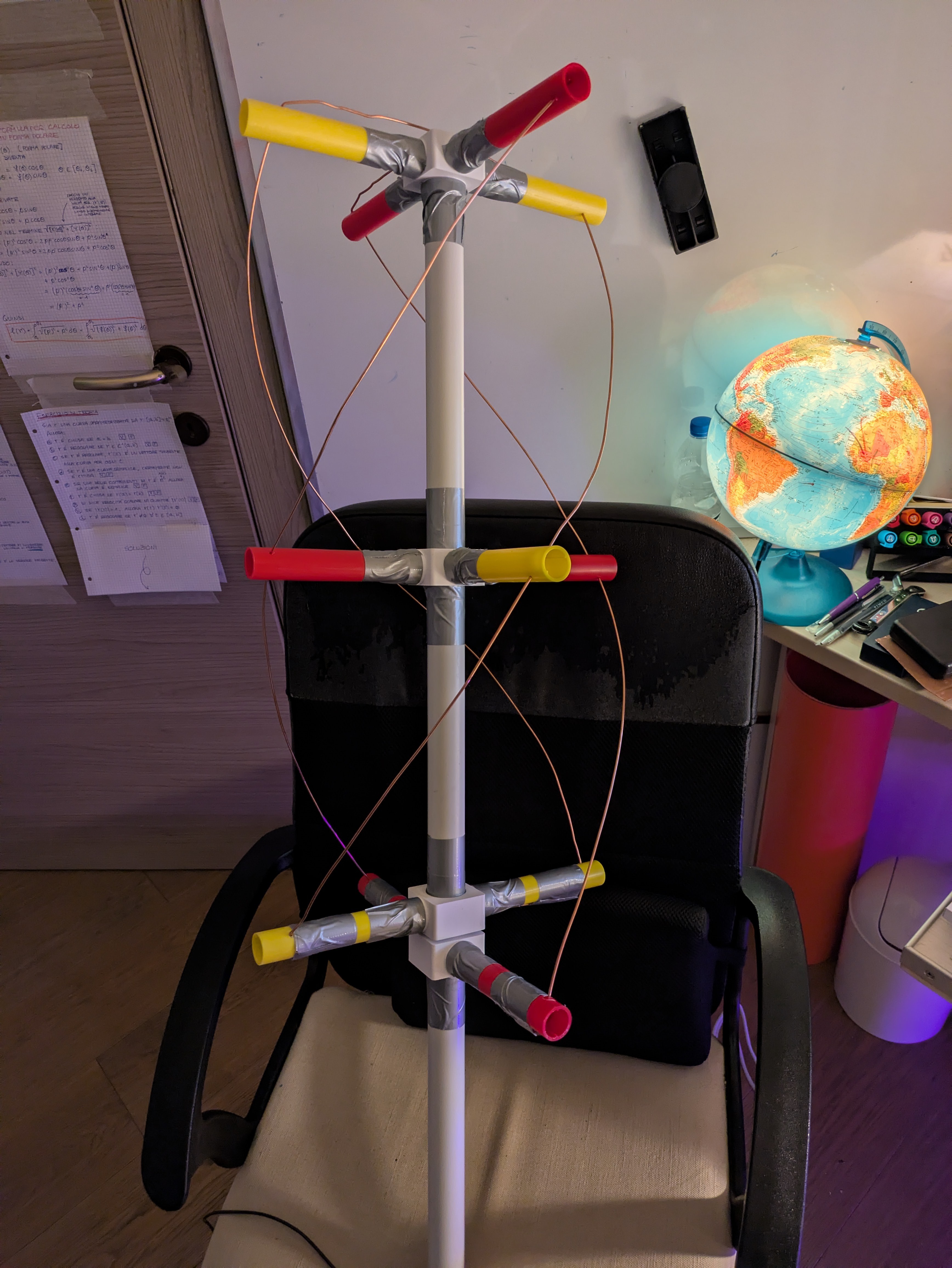

    I used one central 32mm wide PVC pipe as the main pole for the antenna. Then, I cut 12 smaller rigid plastic poles from trash I had lying around (6 red for the outer loop, 6 yellow for the inner loop).
    I 3D printed some adaptors to connect the smaller poles to the main pole.
    Twisting the wire can be a little tricky, but if you pre-cut the wire to the (almost) right length (value provided by the calculator) and fold it and twist it a bit before inserting it in the antenna structure, you'll be fine.
    Instead of a balun or a coax cable around the main tube, to limit common-mode currents, I inserted 5 ferrite cores at the top part of the coaxial cable inside the tube.
    Make sure to solder the top coaxial connector correctly with the correct loop sections.
    If you need it, at this link you'll find a good video that lets you see how to build a QFH antenna and how to properly solder it: qfh antenna build video
    The completed antenna:

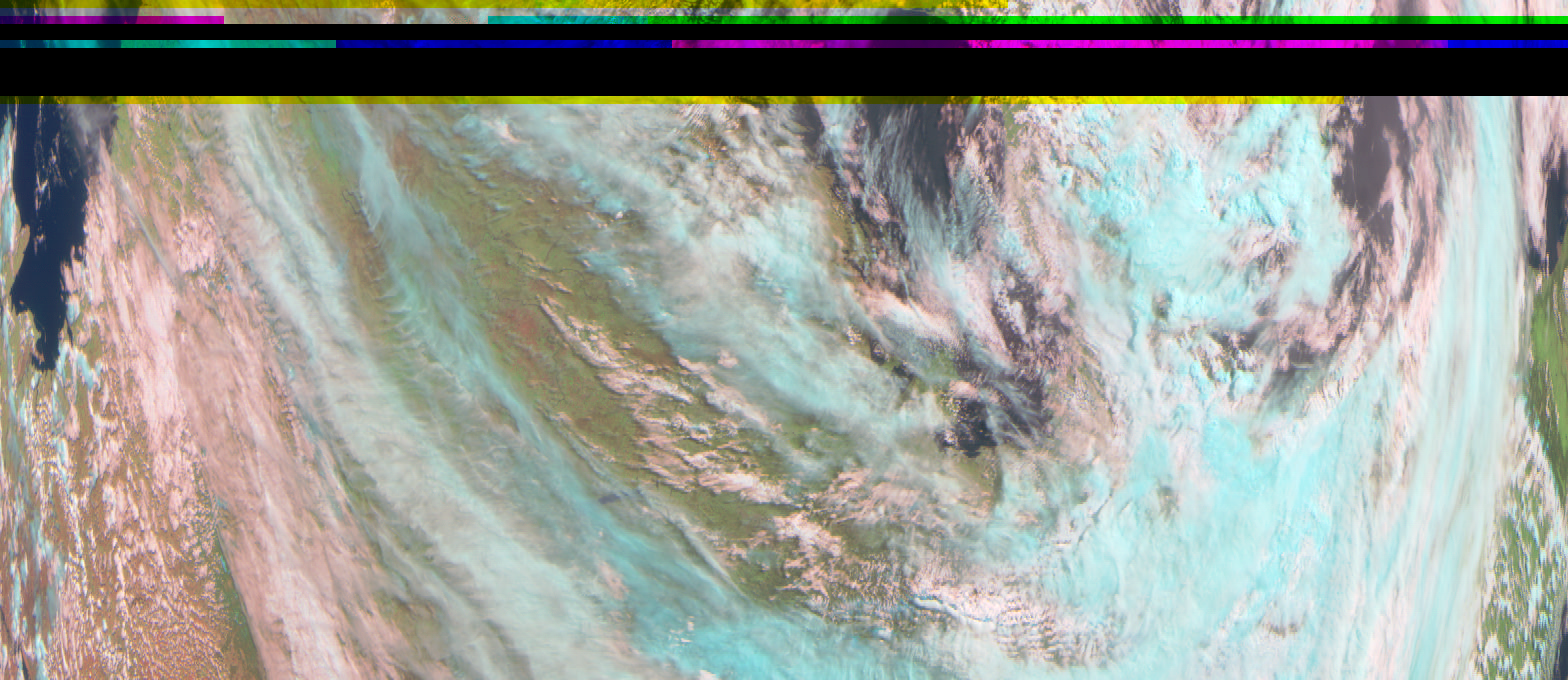

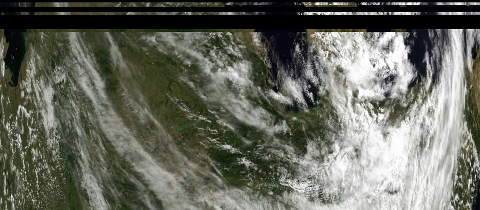

    I first tested the antenna with my NanoVNA to get an idea of how good the antenna I built was. I had to do some tuning (very small), but in the end, the antenna was luckily very well matched with 137.9MHz. I managed to get an S11 of about -20dB at 137.9MHz, which is really nice in terms of antenna efficiency (1.22 VSWR).
    Then, I attached the antenna to a filter and an RF amplifier and tried receiving some data from Meteor-M 2 4 passage. The test was successful, and I managed to achieve about 15dB SNR on SatDump during the passage. I was holding the antenna with my hands and a chair for some part of the passage, so not the best setup, but it was enough.
    Here you have the data I got:
