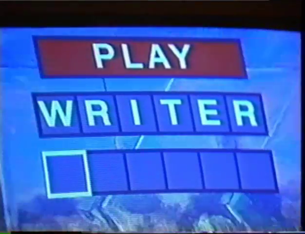

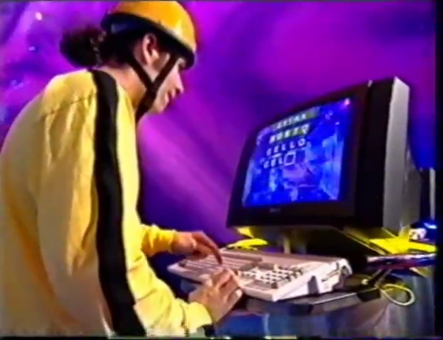

A challenge would appear on the Amiga screen—simple words, but with the keyboard alphabet shifted forwards or backwards. The player couldn’t proceed until they solved it.
The Amiga was chosen because of its genlock capability, allowing studio cameras to film the display without flicker.

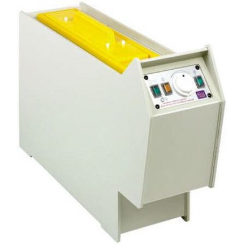

The company I worked for had a proper PCB prototyping setup, so:
* Artwork plotted at 2:1 * Reduced onto presensitised board * Etched in an RS tank * Drilled by hand

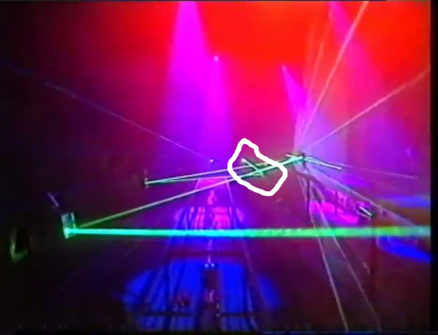

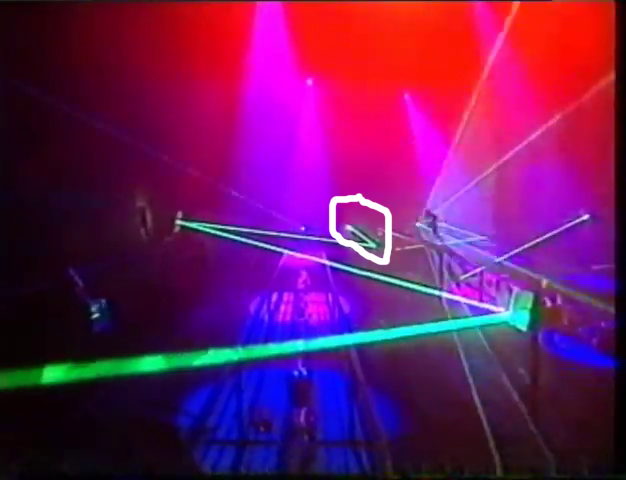

They produced blue and green light. The blue was removed using internal optics, leaving the green beam, which was fed into a built-in galvanometer scanner. The system switched the beam between two paths to make the maze more difficult.
We only had a single optical sensor. The beam switched paths in milliseconds, so the Amiga software simply ignored that brief gap.
You can see the two beam paths in the screenshots—the sensor sat at the final section where both paths converged.
Granada built the frame from 20 mm box section steel, with a raised walkway down the middle. The beams ran roughly at knee height.
