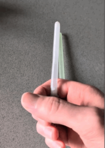

More than a few years later, in late fall 2024, I was planning a trip to Disney World with my girlfriend, who was in a Mandalorian-driven Star Wars phase. Little did she know I was planning to propose to her there. To make that trip a bit more special, I came up with the idea of making glowing lightsaber-inspired necklaces for us to wear - one green, one red. Given my past experiences, I decided to run this with solar and supercapacitors, so that it would never need batteries replaced. And it worked!
However, these necklaces were not perfect. They looked great from a distance, but up close they were clearly handmade. The lightsaber blades (case epoxy) were tricky to get perfect, and the solar panel "box" that formed the hilt was hard to get quite right (hot glue plus cast epoxy worked but wasn’t as elegant as I had hoped). The necklace was also just rather large. While small enough to be a necklace, it is rather too large for daily wear. Currently they are hanging in the window as a window decoration, they glow at sunset every evening (hundreds of cycles now and no obvious degradation, about 30 minutes for the red and 3 hours for the green one). It actually worked rather well at Disney World, where we would alternate between bright sun and dark ride line, charge and discharge (the solar panel, when lit by sun, shuts off the light circuit).

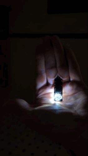

I had planned to dedicate time to making a “perfect” version of the lightsaber necklace, but as a year passed and it became apparent these were not going to be daily wear items, I decided to come up with a version that would be even smaller and simpler which might be worn more often. Thus, the scintillation solar necklace idea was developed.
The second version of the necklace is a ‘diamond’ (moissanite) with LEDs set behind it. They sparkle, controlled by an attiny mcu (unlike the fully analog lightsaber version). It reuses the same solar charging and super capacitor circuit as the original, but uses an LED boost driver instead of carefully selected LEDs to set the LED current. The idea is to create the ‘sparkle’ of the diamonds in sun artificially by switching between four different LEDs behind the stone.
