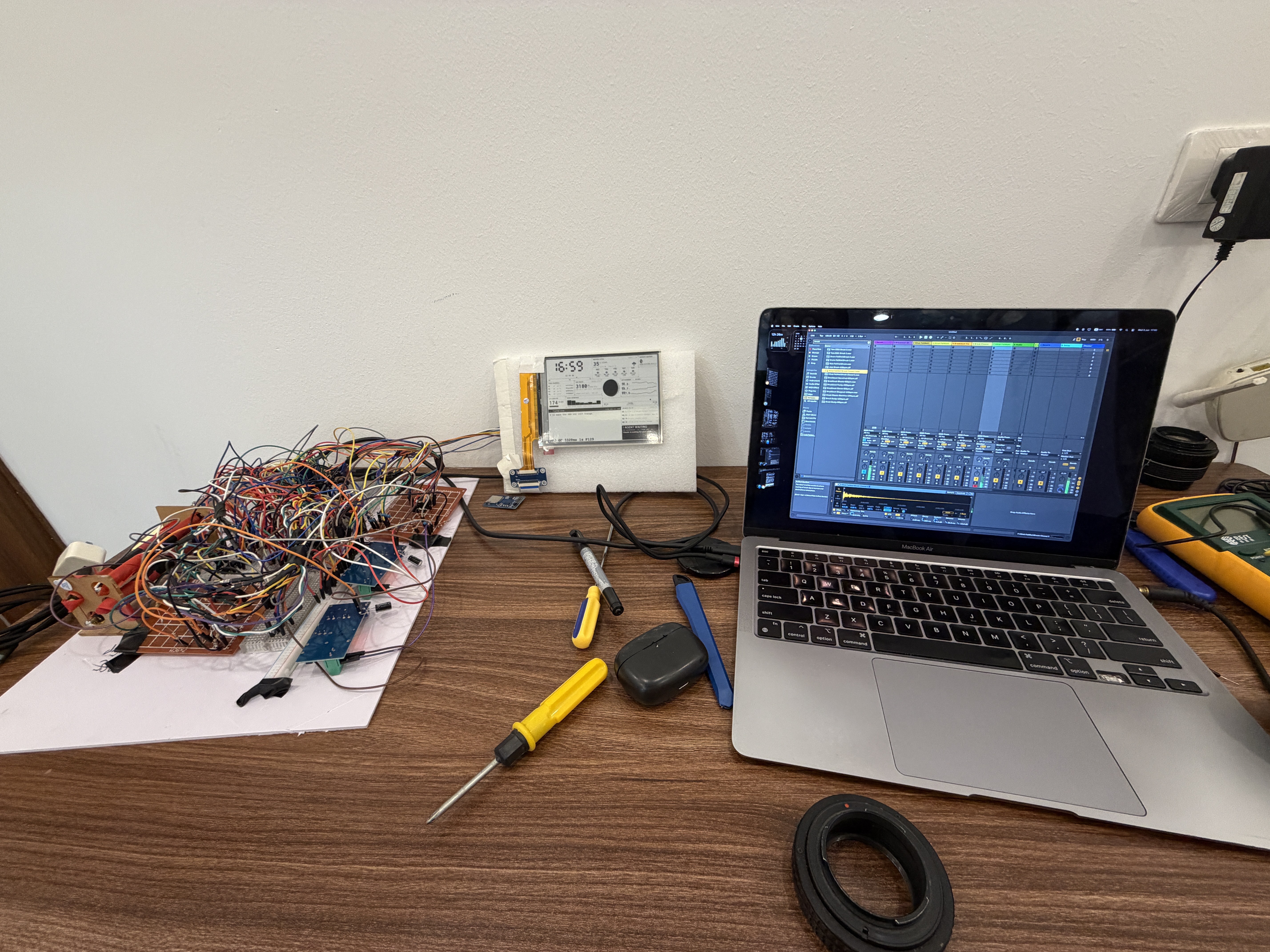

    Just for fun I wired up the coincidence circuits and the individual tubes to work as a midi device and I've been making ambient music all day while I work. I've also set up some space-based APIs like the ISS velocity/sensors, international seismic activity, moon phase, sun arch, all to create either midi notes or knob variables. Currently I have the individual Geiger tubes triggering drum breaks, the ISS controlling filter cutoff, muon events are a massive stab with lots of delay and reverb and so on. so much fun.

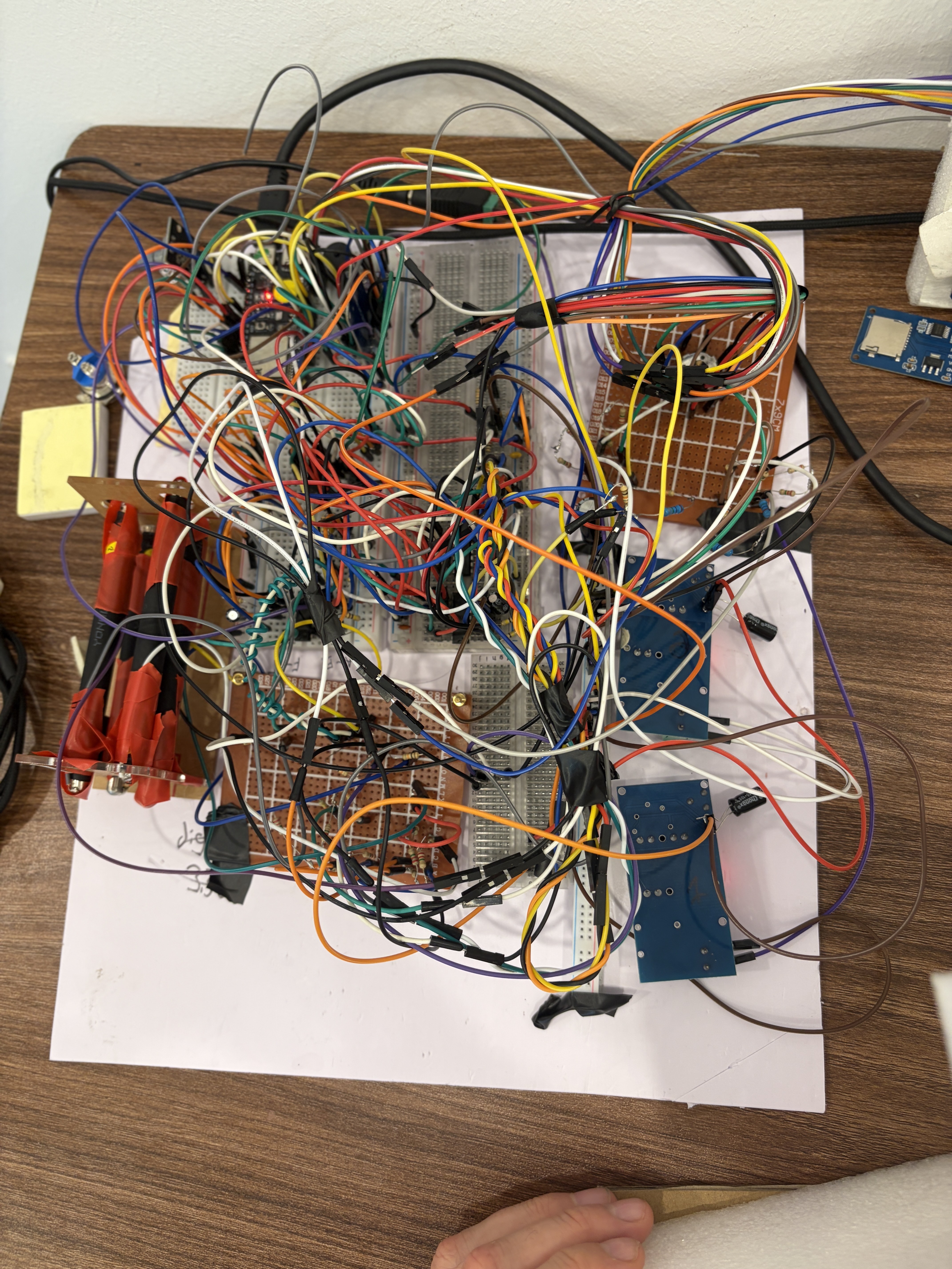

    The last round of debugging
    Getting six channels online was an accomplishment, but I spent two weeks chasing noise sources. First it was loose wiring, then I was missing a capacitor and so on. I did a full audit of the board layout, then brought it home. I've been building it at the school I work at's maker space, so the drive home on a motorbike in Hanoi through rush hour was a good durability test for the tubes.
    Everything was working when I got it home, but I still had an unacceptable amount of noise, tube 3 would get stuck in continuous discharge for hours, then re turn to 40% lower counts than the other tubes, t4 and t2 would randomly dip to 50% counts. After 3-4 days on my bench at home, and just leaving tube 3 unplugged, I decided to meter every connection in the anode chain and immediately noticed my high voltage boosters were sitting around 530v, which is way too high. My target was 410v, so I tried adjusting the pan pot and it was bottoming out at 520v. After some deliberation with Claude we decided to add some resister chain shunts out of each HV booster, running parallel to the 5v gnd rail. This worked beautifully and it's currently about 18 hours into a soak test with completely distribution counts from all tubes. The only downside is that the HV booster whines are so frickin loud now I need to wear headphones while I work and set up some baffling (that actually helps quite a bit when the headphones are off)

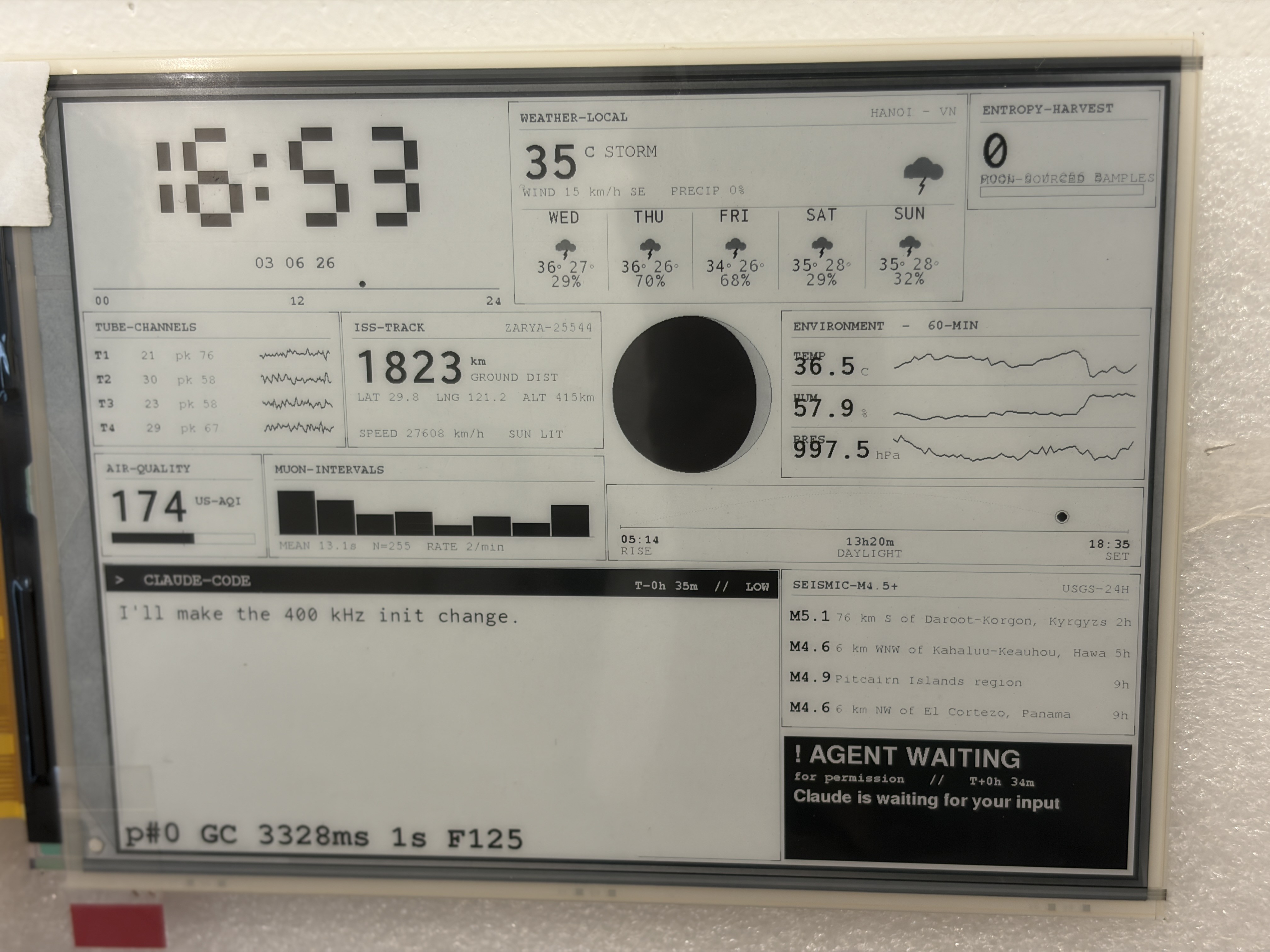

    context: I'm building an e-ink smart clock, that uses 4x geiger counters to detect muons/high energy particles, and uses that to give users a cosmic oracle experience, and RNG based games/events. Press a button, ask a question, then a cosmic ray hitting the earths upper atmosphere answers.

    Going from two working tubes to four meant rebuilding the entire analog front end. Two more pulse conditioning channels, two more stretcher networks, and expanding from one coincidence gate to six — one for every tube pair. That took about a week and a half and it was the hardest stretch of the project so far.
    Everything that went wrong
    My spare HV boost modules got lost in the mail, so I'm sharing one booster per two tubes instead of one per tube. This works, but it means the tubes on a shared supply interact with each other. When one tube fires, the voltage sags briefly and the other tube sees it. With uncalibrated J305s that already have different individual characteristics, this made the count rates confusing to interpret. Is tube 3 reading 40% lower because the tube is weak, because the conditioning circuit is wrong, or because it's sharing a supply with a tube that's hogging current? Hard to tell when three variables are moving at once.
    I lost a full day to my cheap USB logic analyzer. I was using it to monitor signals on the breadboard and was getting unexplainable voltage into the chip it was monitoring. Turns out it was backfeeding power through its input pins;  it wasn't just monitoring, it was supplying voltage to parts of the circuit that should have been off. Once I figured that out I had to go back and manually test every channel on both 74HC14s and the 74HC08 gates to make sure nothing had been damaged by the phantom power and that there was no signal leakage between channels.
    Then tube 4's 74HC14 channel mysteriously died. Just stopped responding. Replaced the IC, verified the new one, moved on.
    At this point tubes 1 and 2 were counting reliably and their coincidence channel looked clean. But tube 3 was still reading about 40% lower than the other three, and tube 4 would randomly get overwhelmed with noise bursts with counts shooting up to nonsense levels for a few seconds before settling back down.
    I spent days checking and rechecking. Swapped components, reflowed solder joints, traced every wire. Eventually I documented the coordinates the full breadboard layout and asked Claude Opus 4.7 and GPT 5.5 to look at it. They both identified the same problem: tubes 2 and 3 were getting...

    The display swap
    While waiting for the HV boost modules I started working on the e-ink display. I'd originally planned to use a Waveshare 3.97" (800×480, 4-level grayscale) but switched to a Good Display 5.79" wide-format panel (792×272, monochrome) because it had a much faster full refresh on paper (3.5s v 0.7s). Trade-off is losing grayscale, but for a clock and oracle readout, monochrome with good typography is plenty.
    What I didn't expect was spending a full week debugging this thing. I've realized it doesn't do partial updates without RAM buffering, I just assumed it had partial updates, and my little esp32 is just barely enough, so to avoid this again, I just went and ordered an e-reader HD display and we are going to call it a luxury experience. I'll go more into it later, I've put the display on the back burner now that the HV boosters have arrived.
