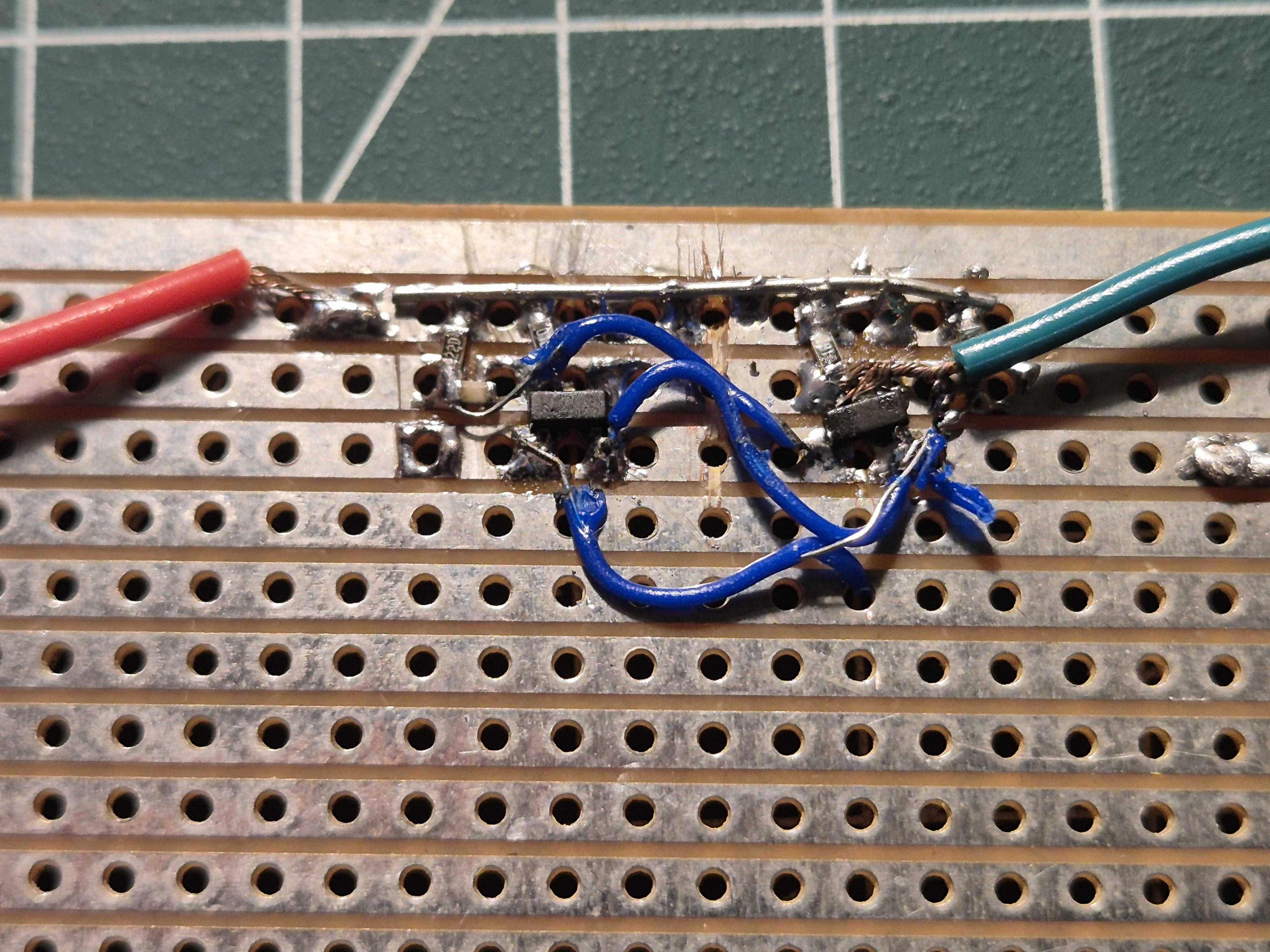

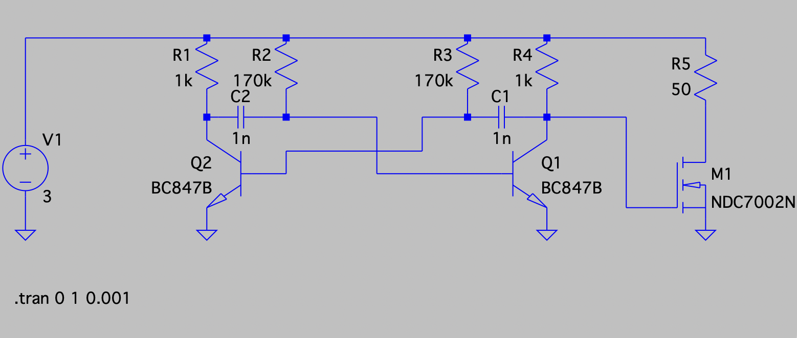

We discovered this oscillator circuit on Hackaday and thought it was neat how it leveraged transistors in a unconventional way to make an oscillator. We simulated and built this circuit on protoboard and managed to get it working!

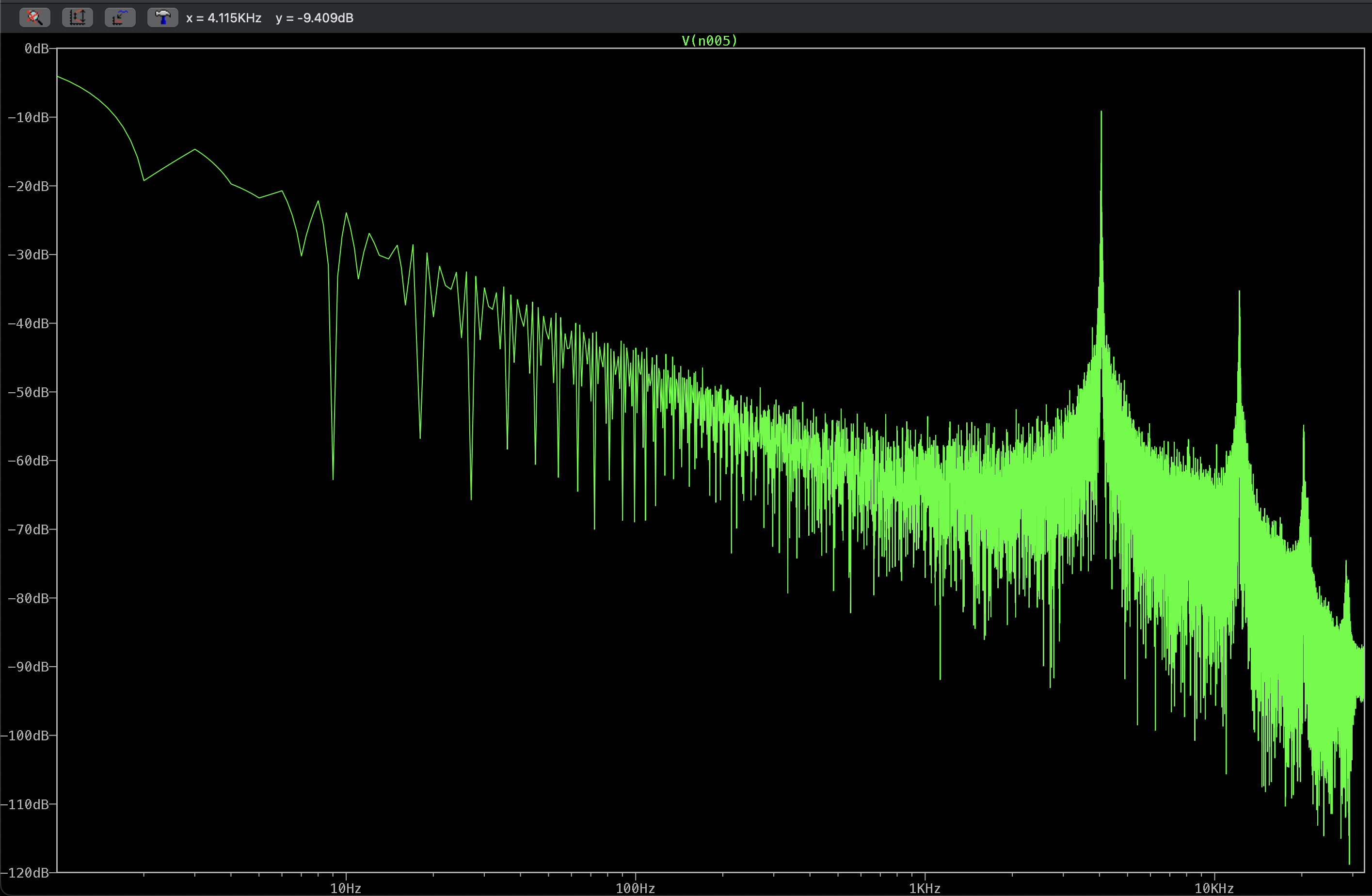

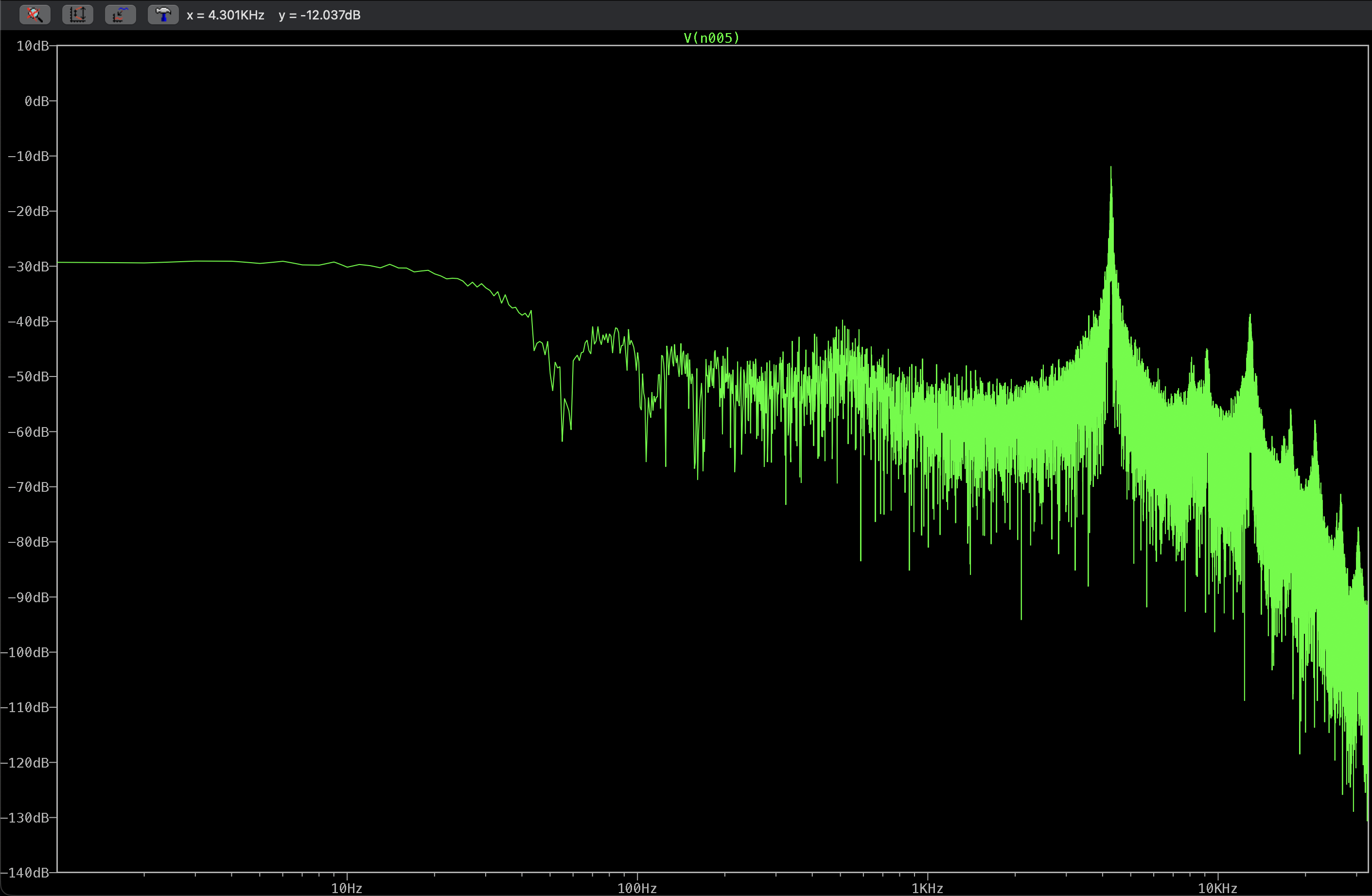

Astable Multivibrator SchematicThe FFT of the simulated output of this circuit getting 4.3kHz
We initially did some calculations to get the oscillator to the right ball park but soon discovered that the particular characteristics of the NPN transistors effect the frequency that it oscillates at! We discovered this when we tried changing the design to match the transistors we had on hand (BC847).
We are hitting 4.115kHz on the peak of the FFT with the BC847 compared to 4.3kHz on the 2N2222 model.
Here's the protoboard circuit that we managed to get to oscillate! We only had SMT parts available so we soldered up some 0402 resistors & SOT-23 BC847 NPN transistors and got successful oscillation!

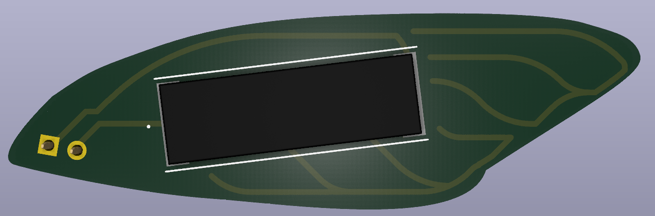

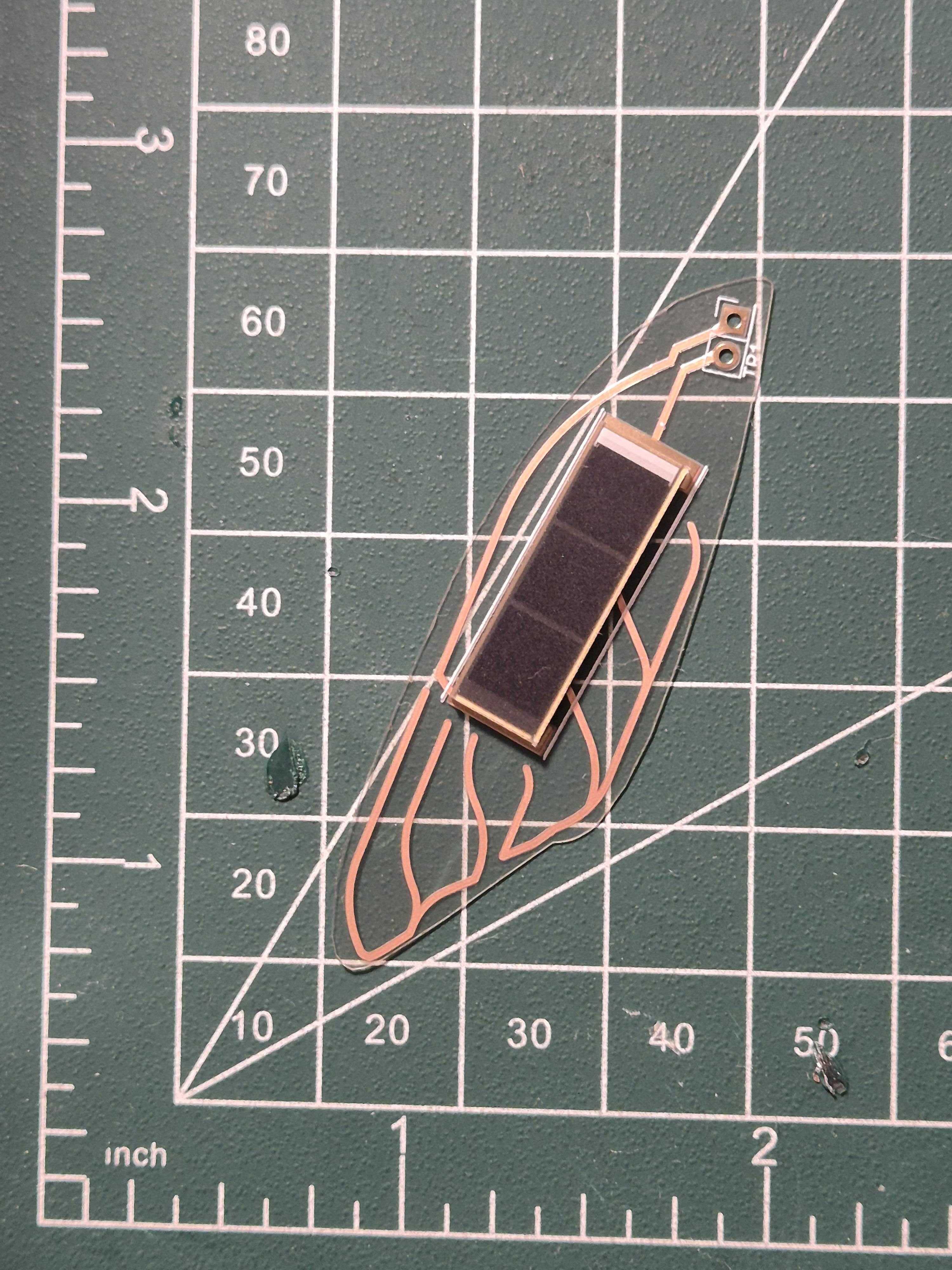

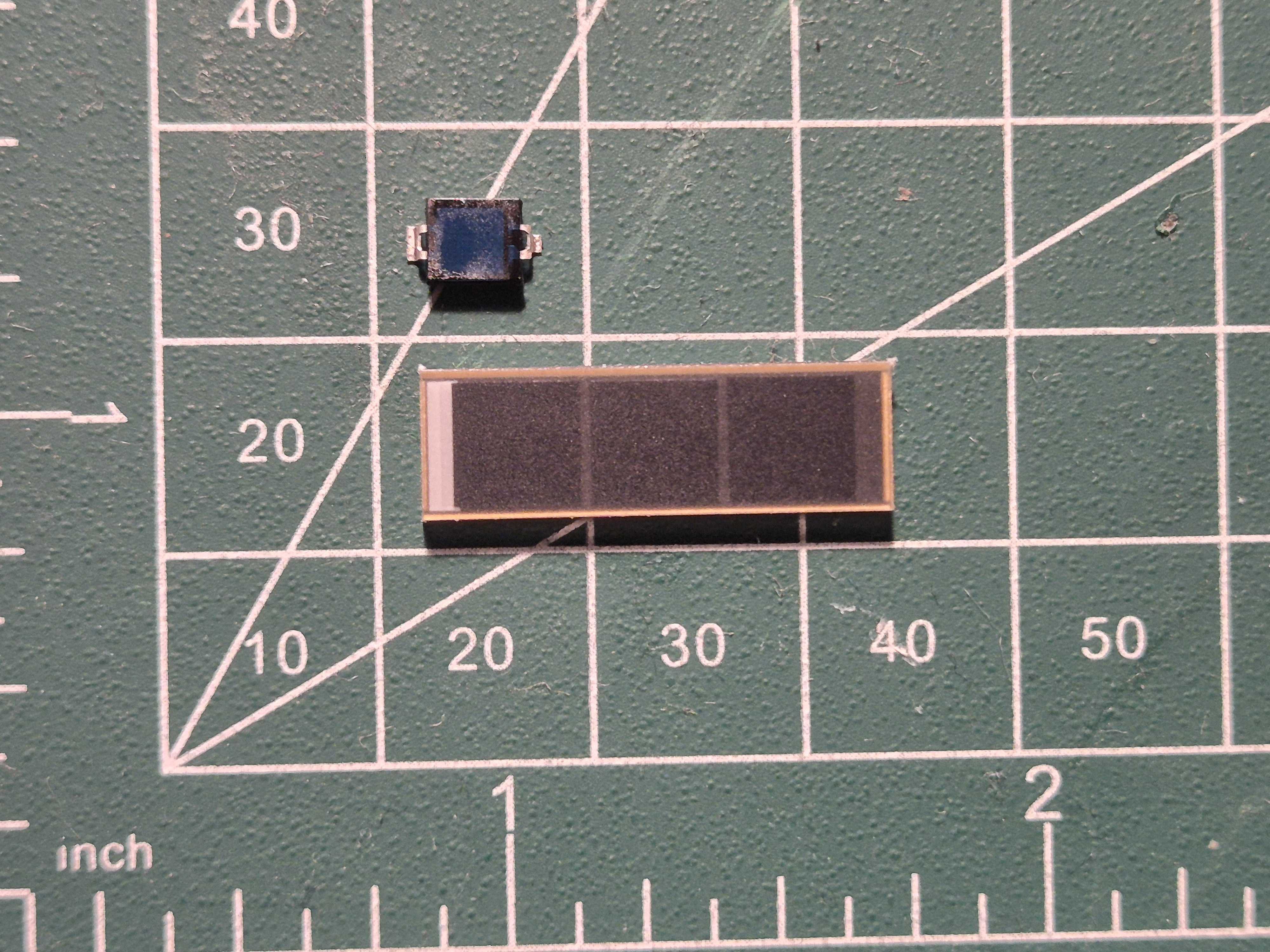

The initial thinking for solar cells was to use BPW34 photodiodes which was inspired by this photodiode powered BLE chip. This made sense to go on the wings and it was the initial starting point of the project concept as it would look cool and capture plenty of light while the blue shade would add some nice contrast to the design.
After exploring the power we'd get with the photodiodes, it seemed less feasible. As an option, we kept the photodiodes on the main board design but depopulated it and rather went with KXOB25-03X4F-TB to make it more feasible to achieve its ambitious goal.
Here are the BP34W and KXOB25-03X4F-TB cells side by side.

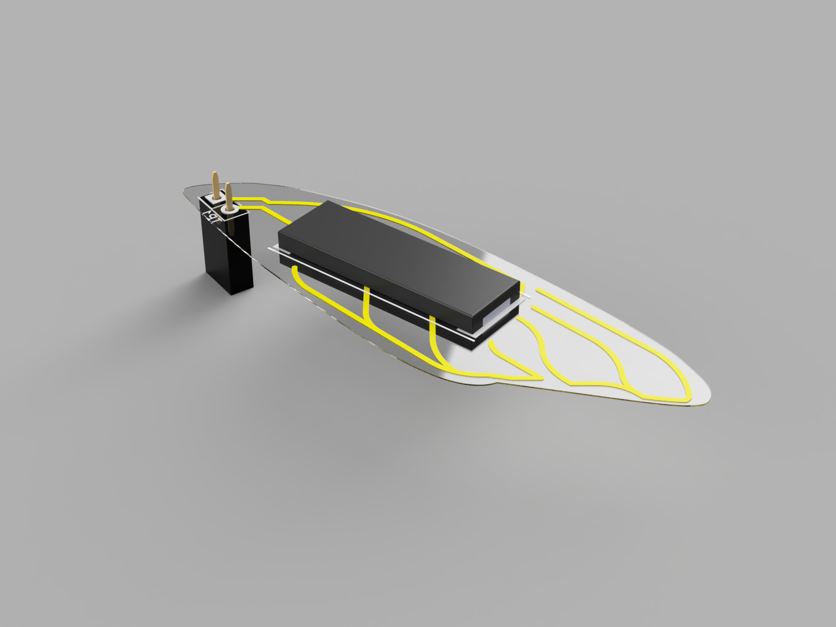

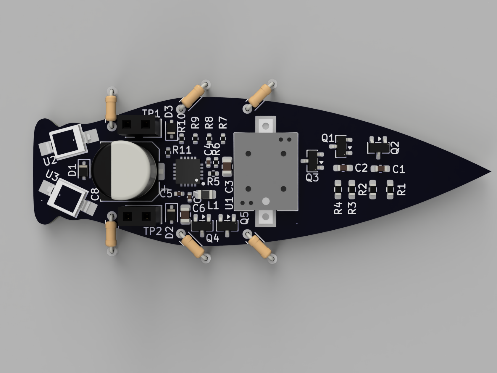

We used tracks in a combination of functional and aesthetic ways, playing with the inherent rigidity of pcb design and the organic shapes of the cicada's wings and veins.

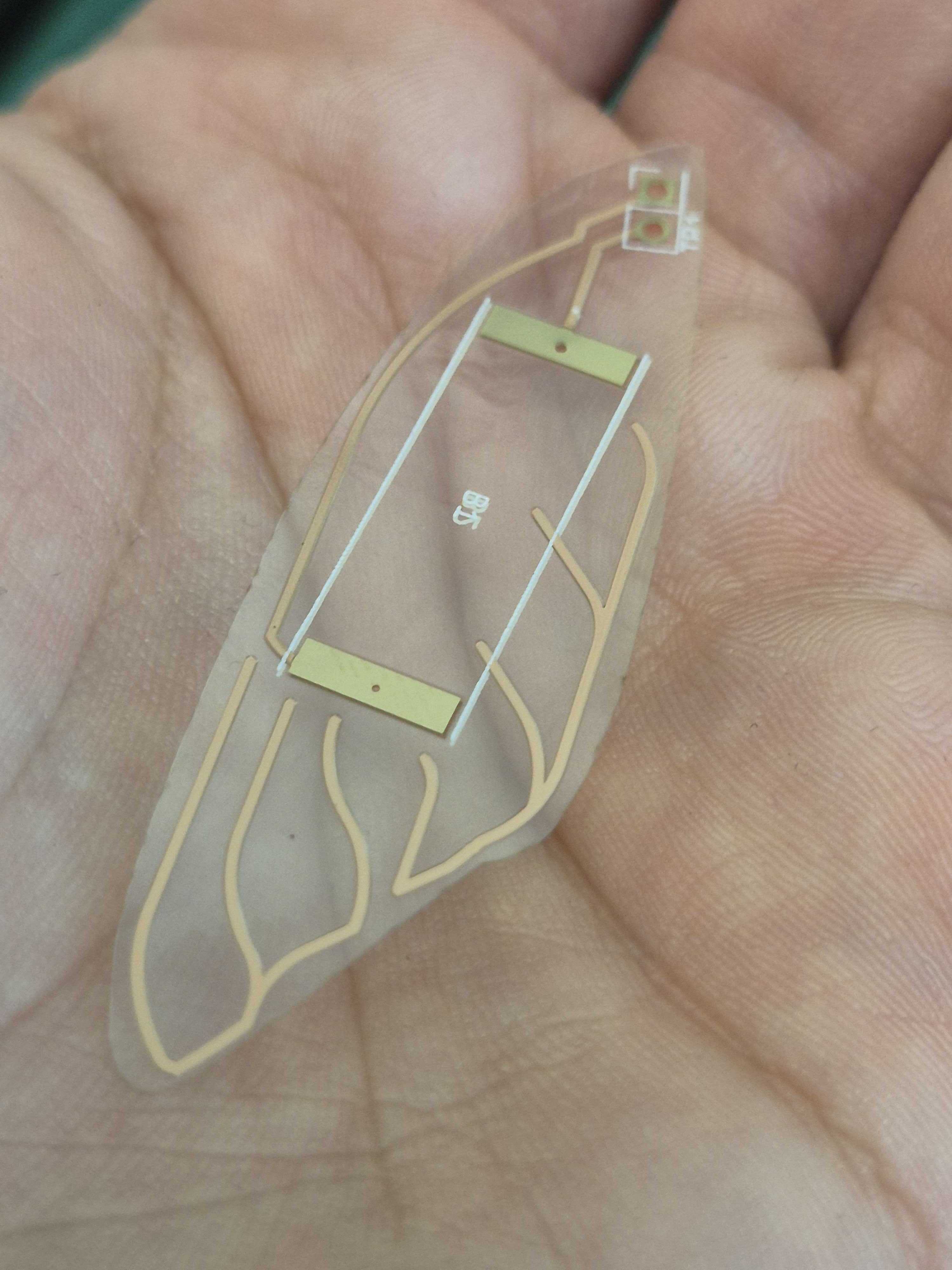

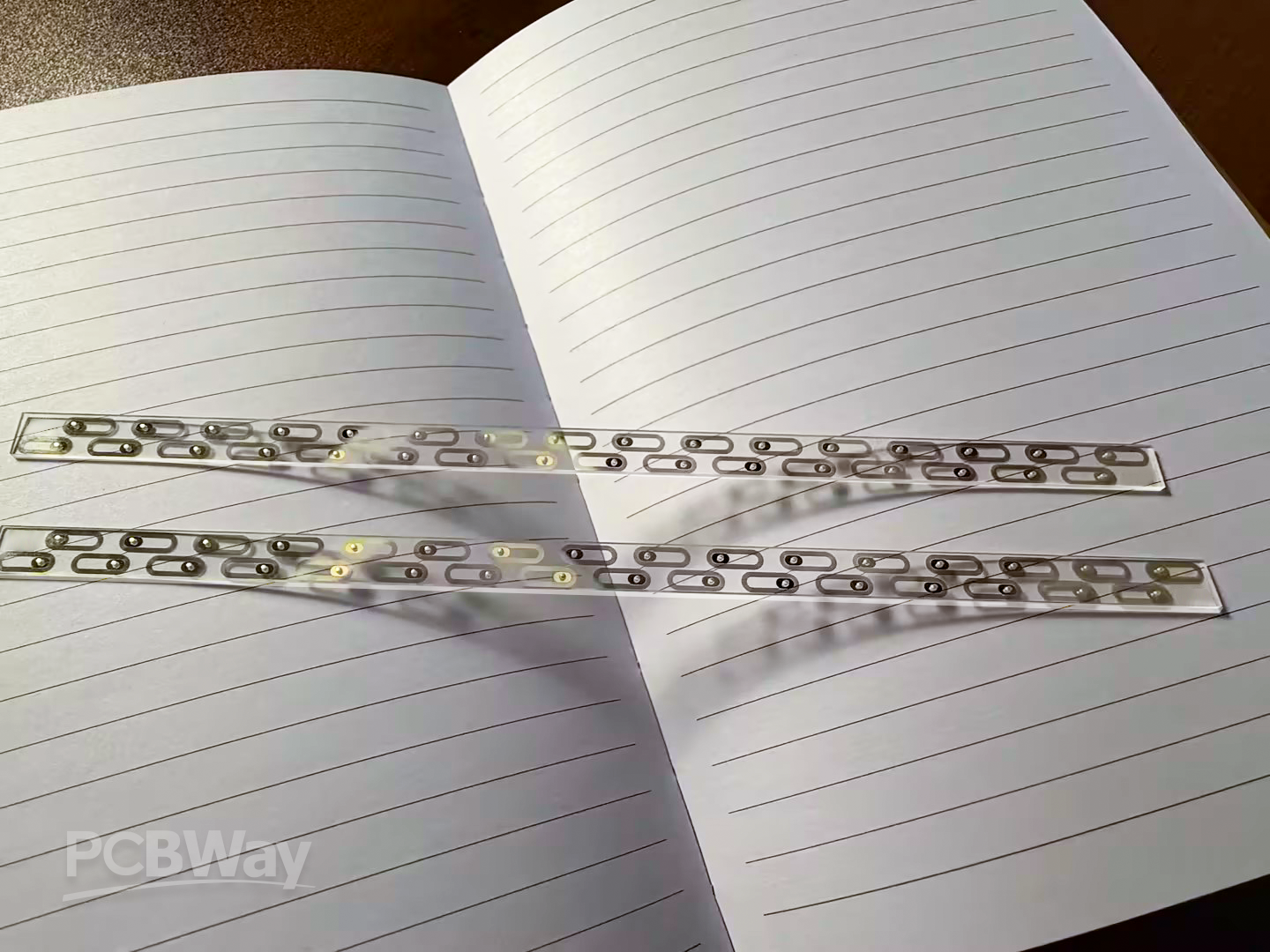

The original plan for the wings was to have them made from PCBway's new glass PCB material. We think 1mm thick glass would look great and also want to try out this new material.
Since the process of getting glass PCBs isn't as straight forward as transparent FPC, we have decided to start with transparent FPC for now while we explore the glass PCB option with PCBWay.
The problem with the FPC approach is the 0.24mm thickness of FPC which we plan to stiffen a bit with some clear acetate sheets.

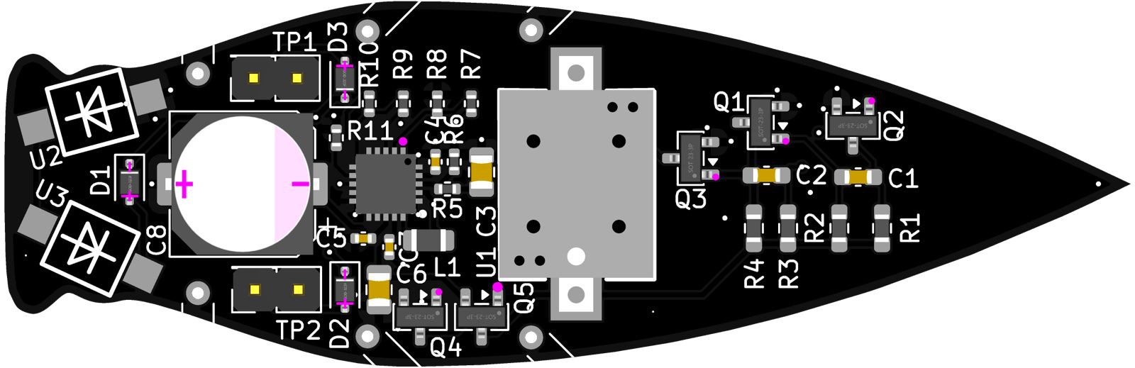

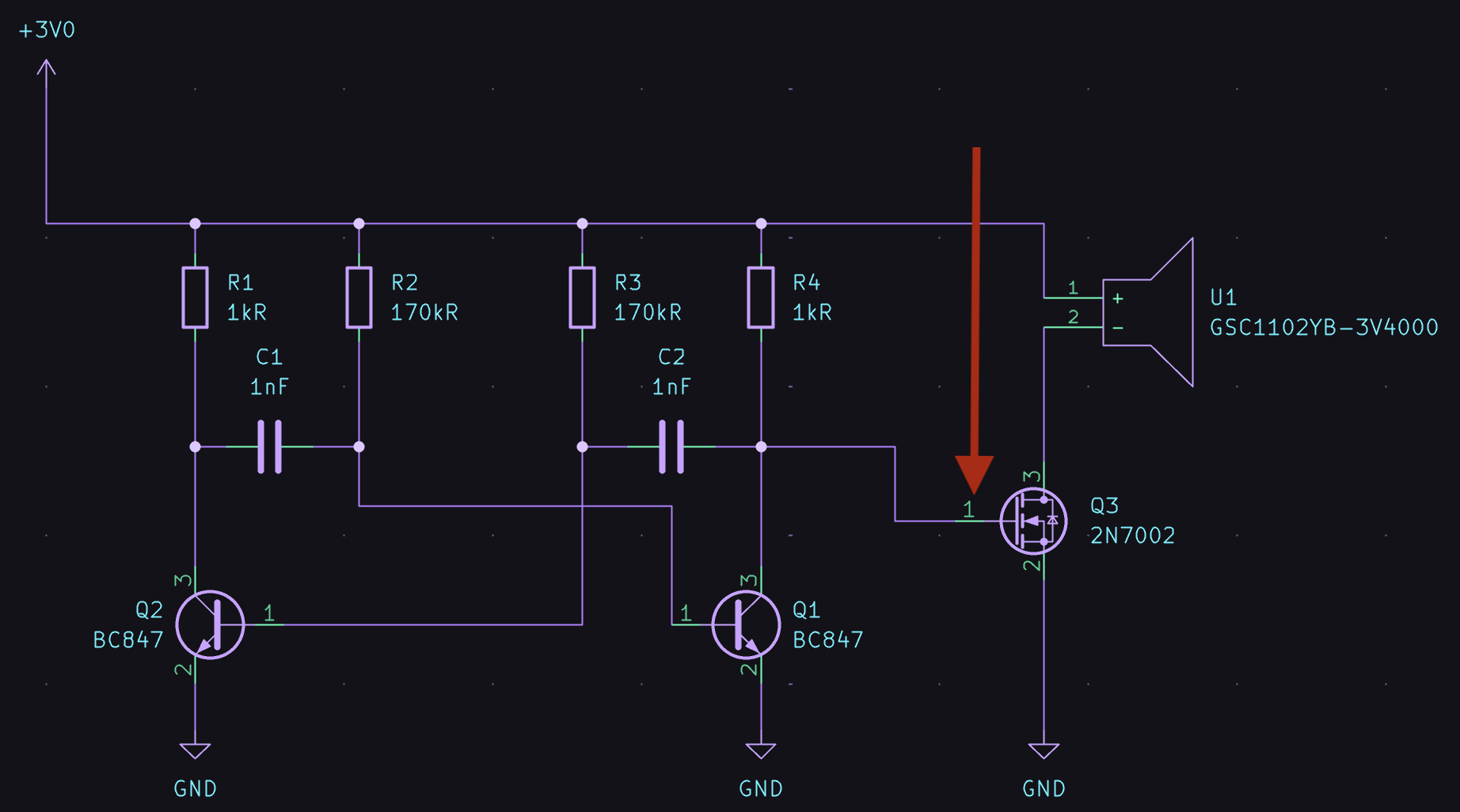

The git repo contains most of the gritty details along with a markdown detailing the calculations behind the system's operation, Fundamentally it consists of 2 solar inputs feeding into a BQ25505 energy harvester PMIC. This charges a 1mF capacitor to 3.6V. When charged, the VBAT_OK pin goes high and turns on power to the system.
The system that's powered consists of the above mentioned oscillator circuit connected to a N-Channel FET which drives a Piezo buzzer (GSC1102YB-3V4000) which is resonant at about 4kHz.

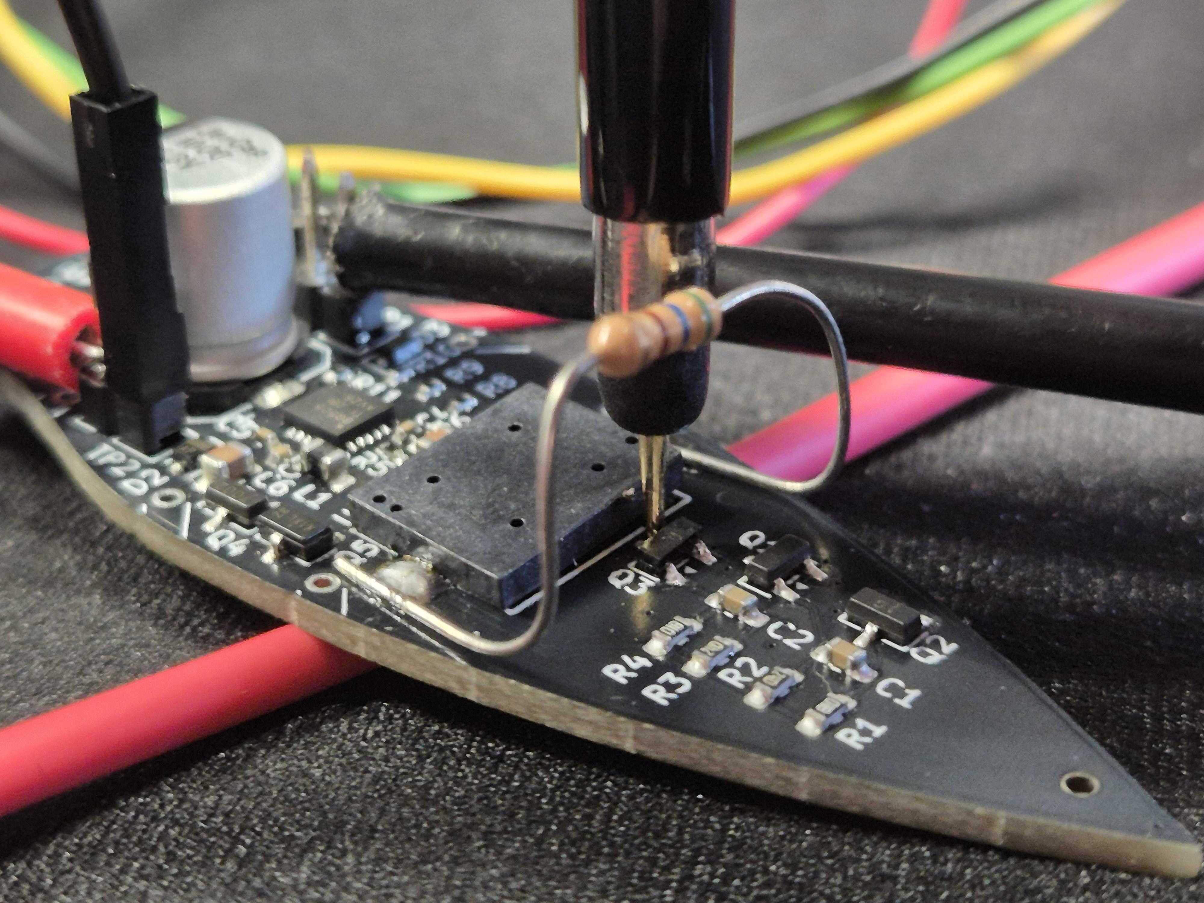

    As soon as the PCBs arrived, I could resist but attempt to power it up!
    Powering it from the bench, we got no smoke and a little current draw (large at first for that 1000uF cap).
    But no sound . . . Great! Lets see whats going on here.
    Investigating why no sound:

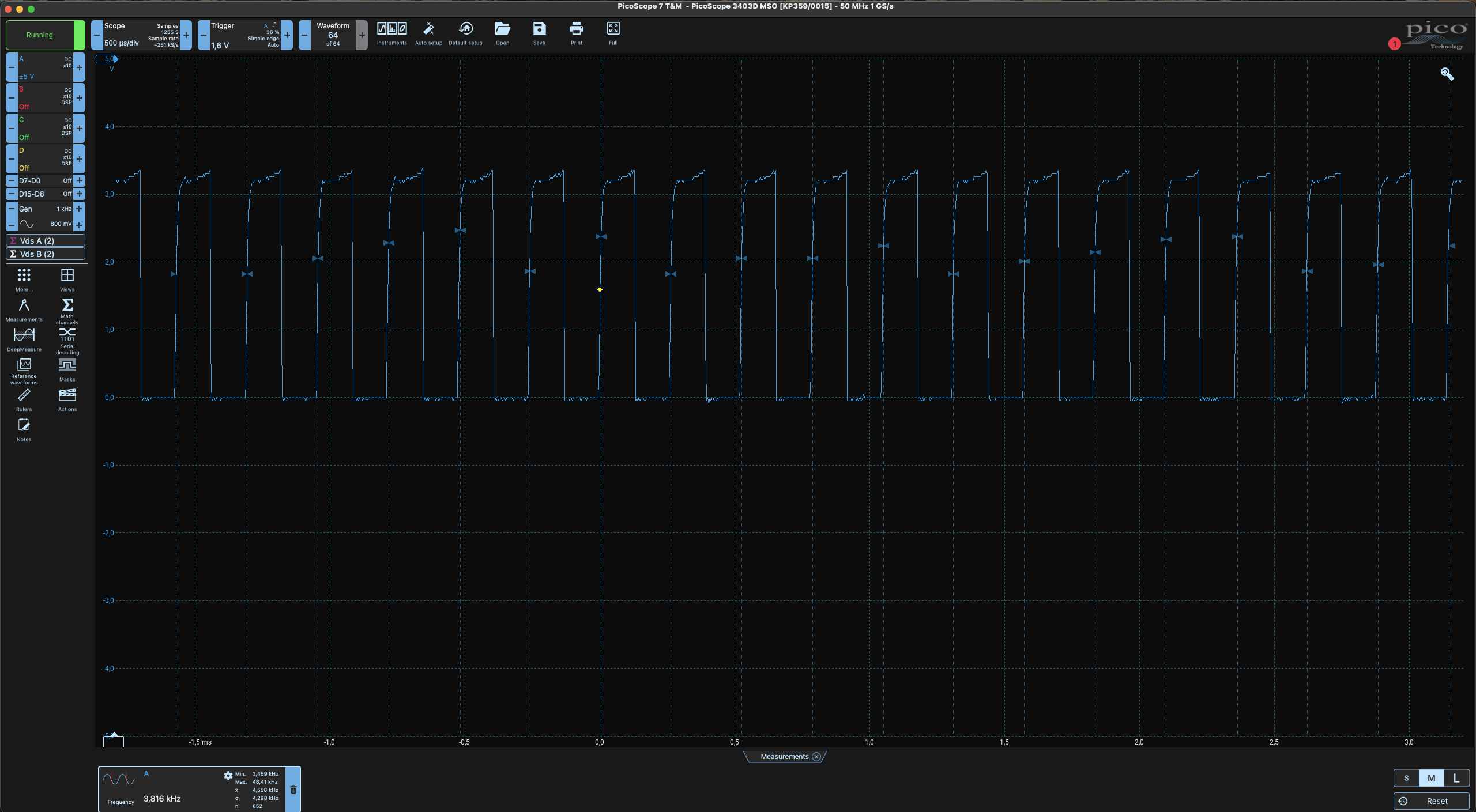

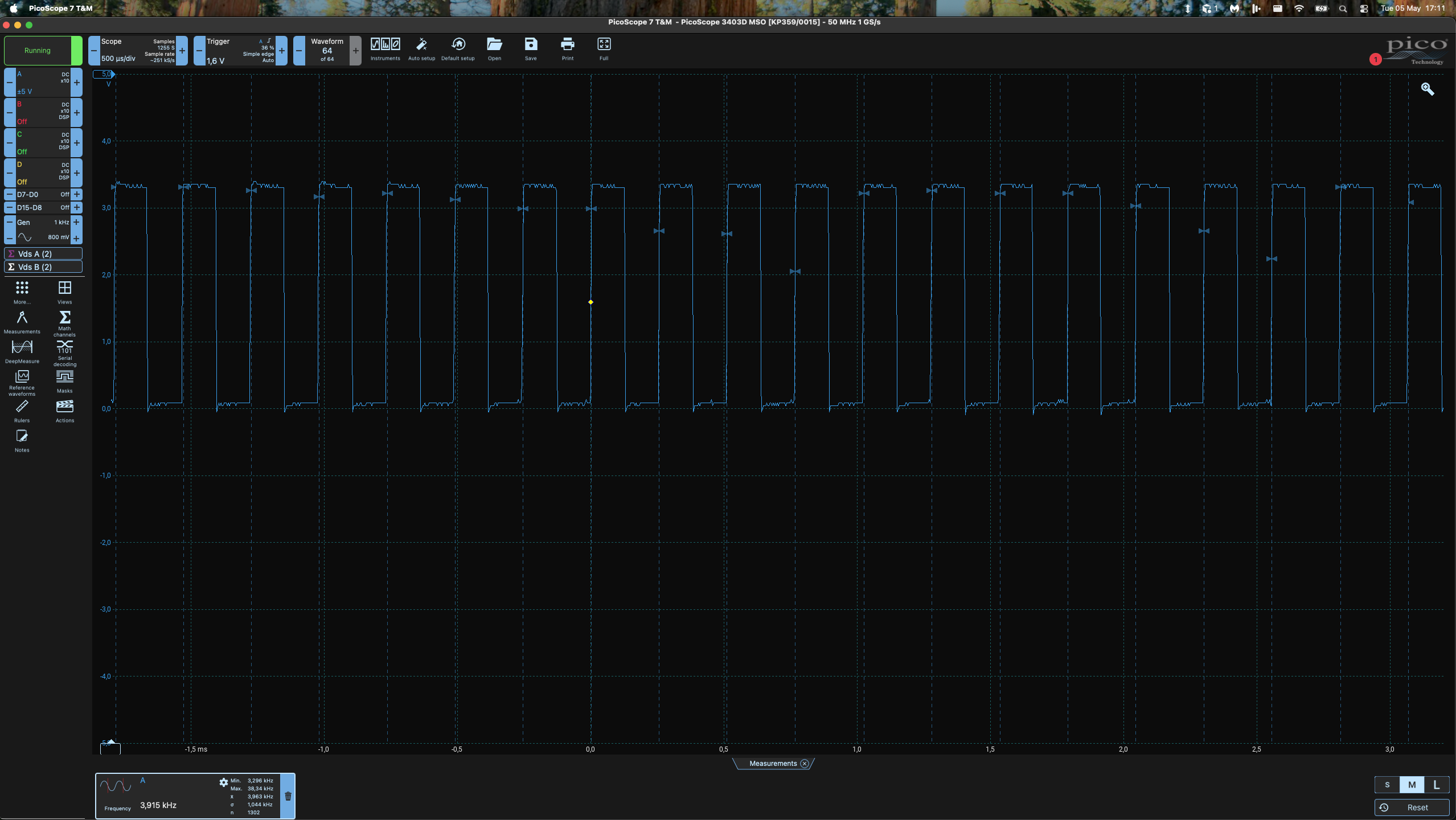

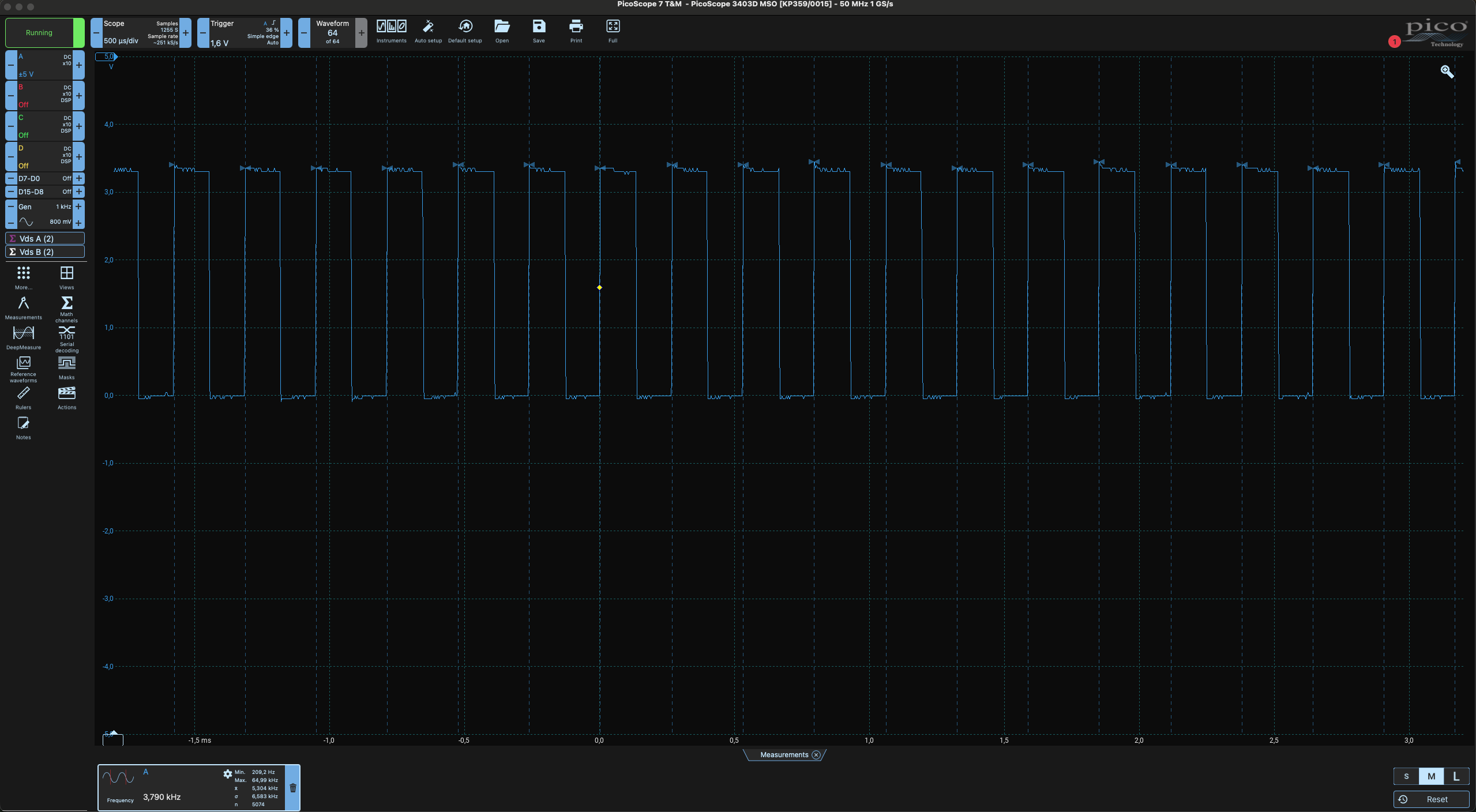

    The first thing to check is our astable oscillator, so I checked the input to the gate of the piezo driving FET (Q3).
    The output looked good and hit the mark we expected (3.3V @ ±3.915kHz):
    Ok, great! So it must be something to do with the load / FET we are driving the load with.

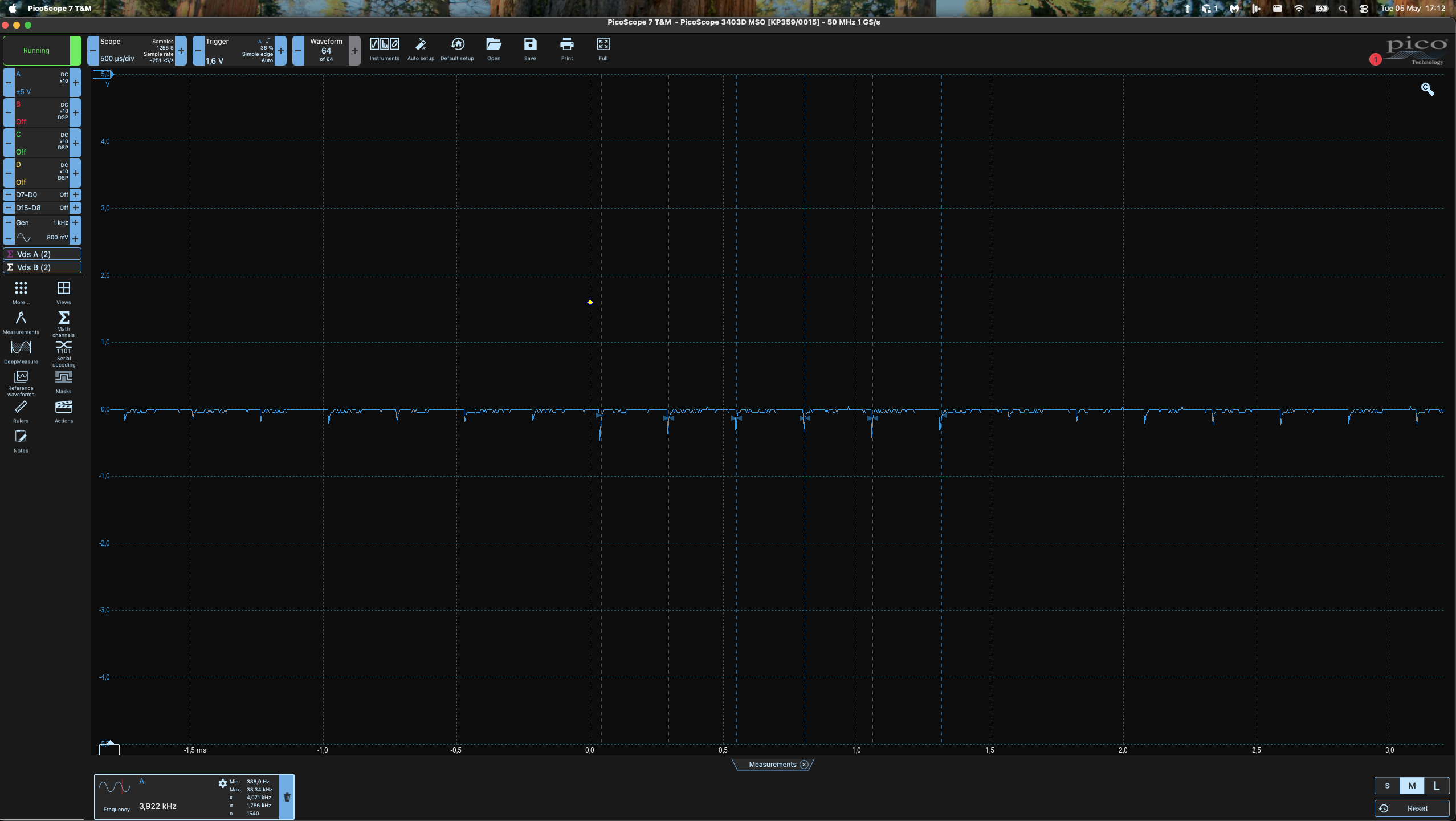

    Measuring the voltage on the drain of Q3 show us that the FET isn't turning on enough to pull the load to ground:
    Strange, lets see what happens if we change the load and just check the Q3 FETs operation?
    I disconnected the buzzer's positive leg and hooked up a 560Ω in series, Here's what's coming out of the FET (Q3):
    Alright so it seems we need some change in loading on the FET to get it working?
    Turns out this might have to do with capacitive loading from the buzzer . . . What if? We make a bleeder circuit with this 560Ω in parallel with the buzzer?
    The output seems to sing well as show here:
    So this bleeder circuit is needed.

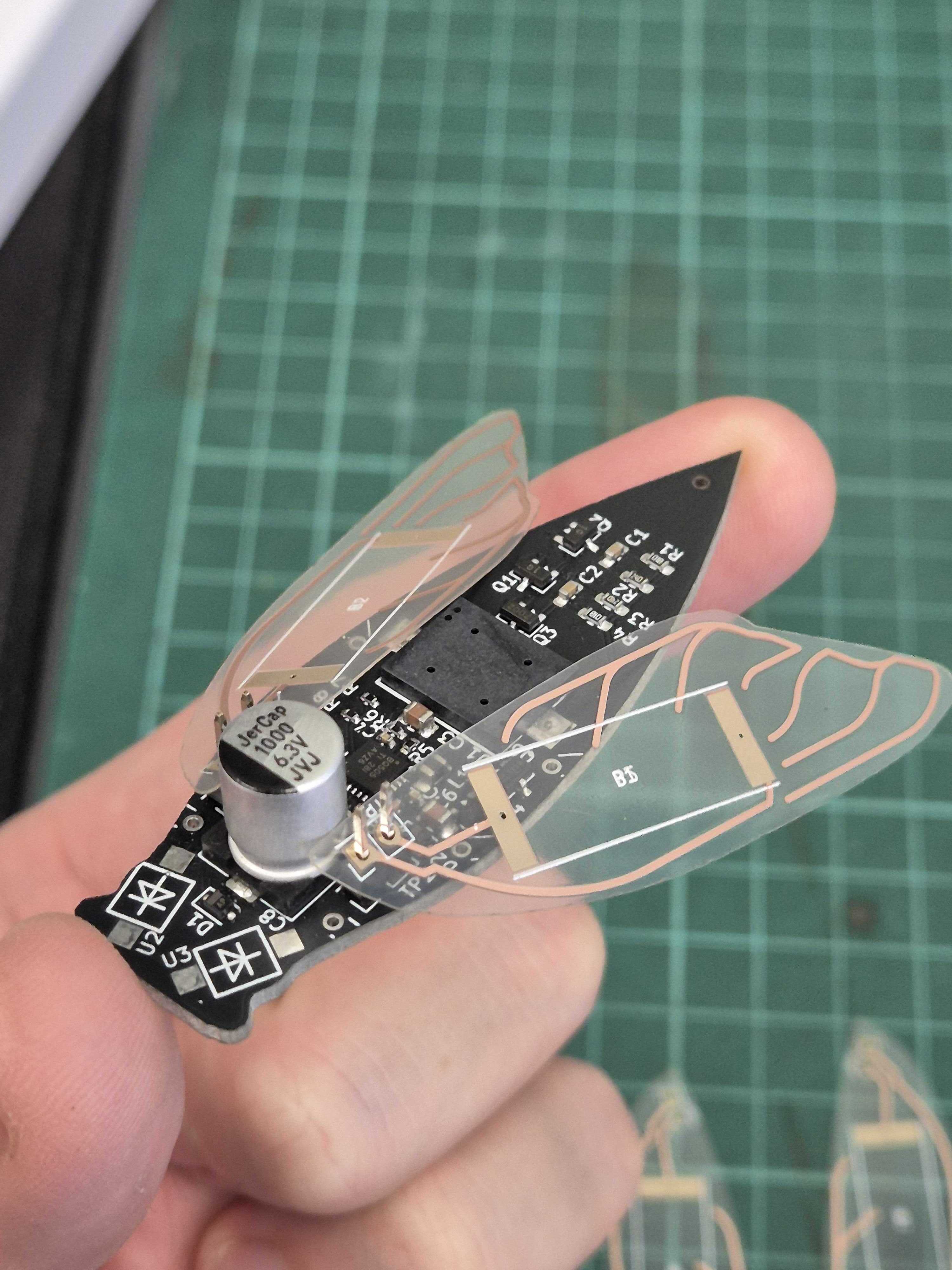

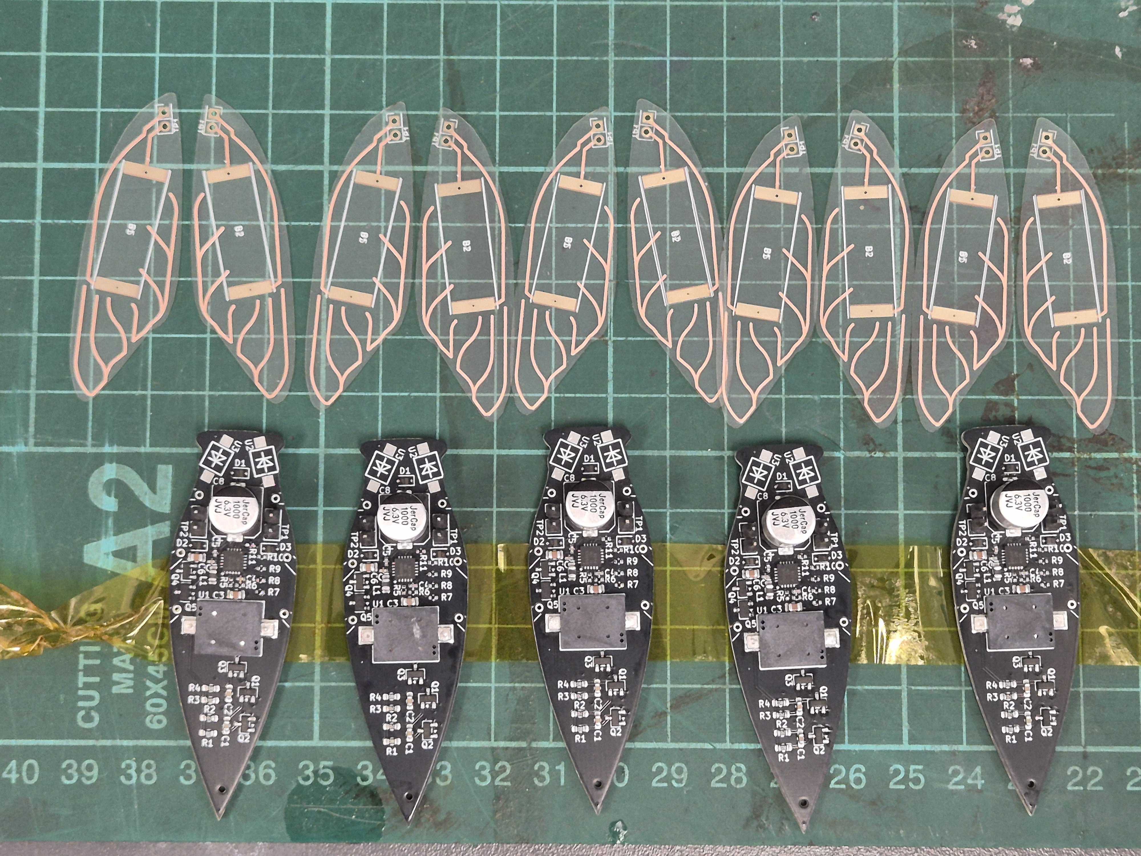

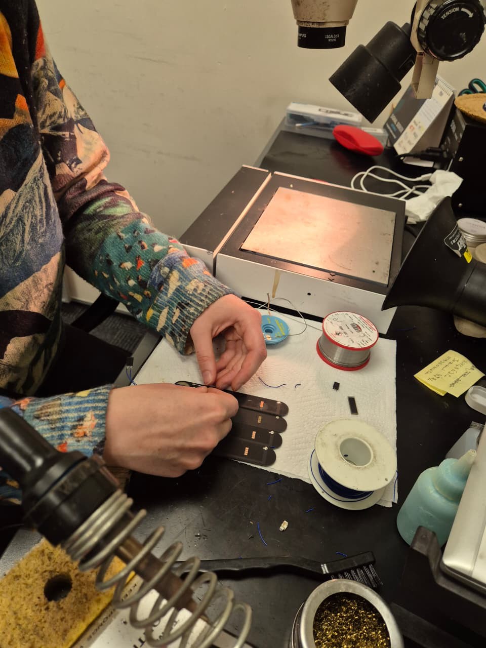

    So the PCBs arrived today and we're really impressed with how they came out!
    Here's all 5 assemblies:
    And here's a wing up close:
    Testing the wing's fitment on the PCB:
    We plan to do the full assembly soon, but for now we're impressed & excited to get it up and running!

    The wings are going to be made with JLCPCB's transparent FPC process which puts them at 0.24mm thick. This may be a issue with the weight of the solar cells but could add some nice organic curves to the wings.
    Transparent PCBs Trigger 90s Nostalgia | HackadayWe are also attempting to get the wings made in glass at PCBWay as this would be more rigid and make for an interesting optical clearness.
