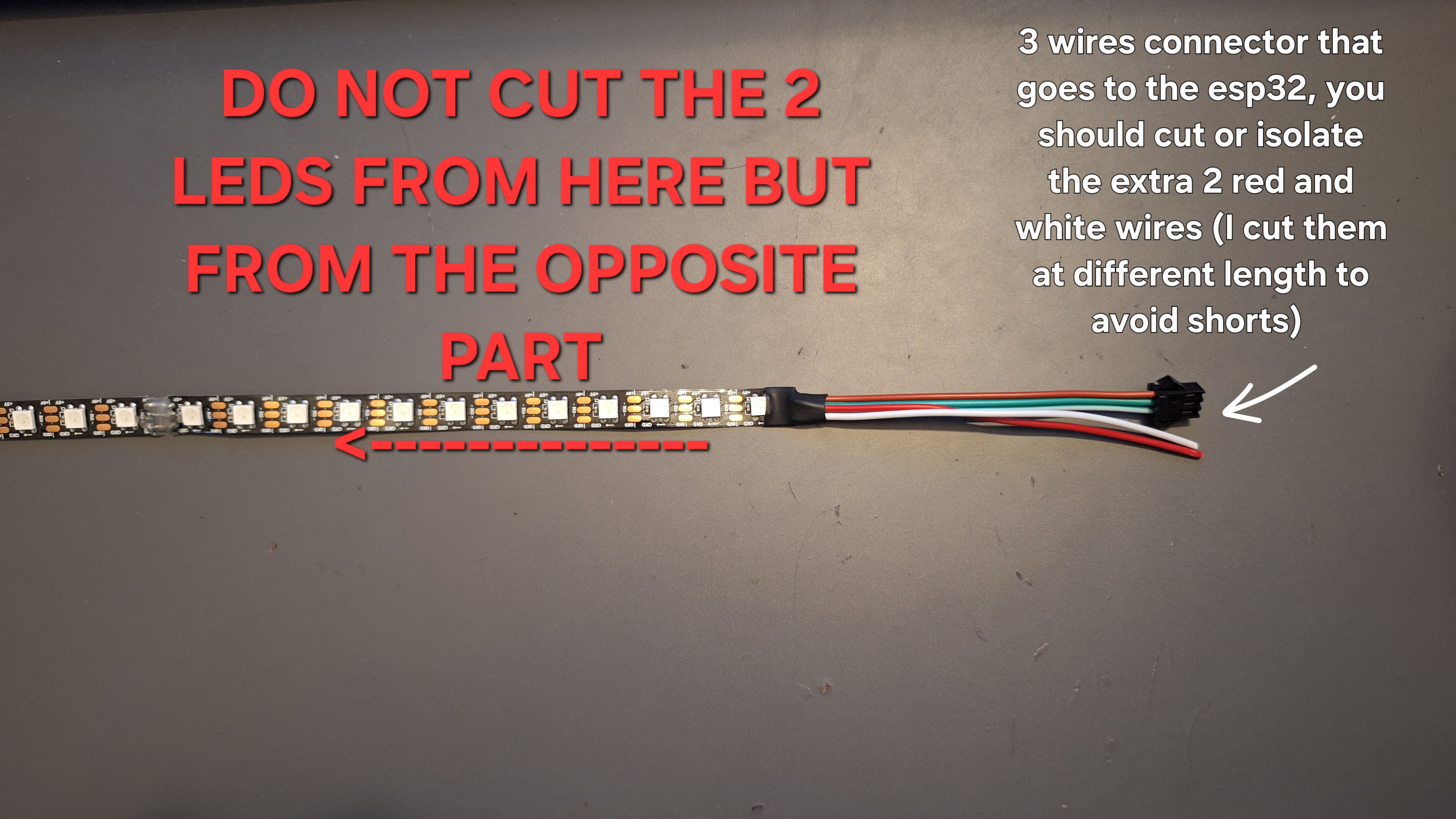

📍 Step 1:
- First, cut 2 individual LEDs from the end (leaving 72 LEDs total)
2. Cut at different lenght (or apply some electrical tape) the 2 extra red and white wires
📍 Step 2: Create LED Groups and measure space between piano tiles

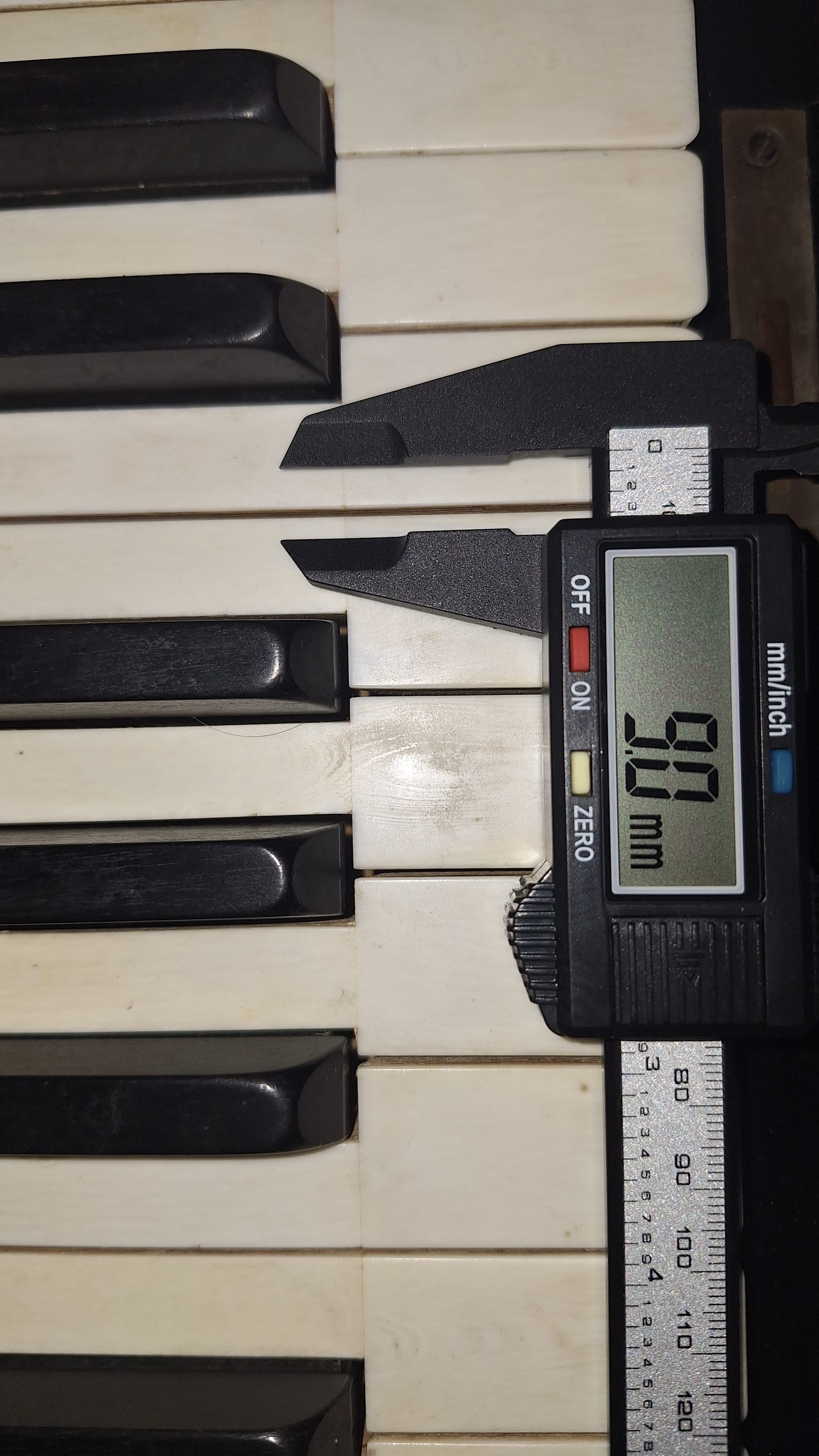

- Cut the remaining 72 LEDs into 6 groups of 12 LEDs each. Each group should have 12 consecutive LEDs with the connector side preserved on the first group
- Place 2 group of notes on the piano in order to align them (more or less) in a tile (every led should be right up one piano key) starting from C (Do) and ending with B(Si). Measure the space between the 2 groups. (in my case around 9 mm)
📍 Step 3: Connect LED Groups
- Solder 3 wires with the same distance you have found (depending on your soldering skill you'll need to add 1 or 2 mm to the measure you found(in my case I opted for 10mm) between each group
- Once finished check if every led aligns correctly to a piano key
- Apply hot glue to the soldered connections for stability and insulation
