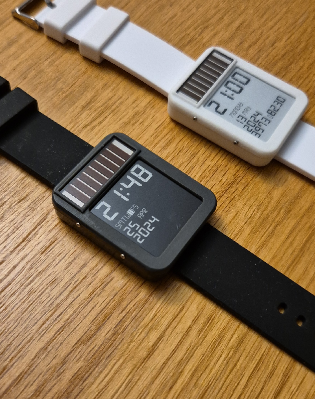

This project tries to mimic the 90s solar digital watches that run forever. But with newer technology (eInk/WiFi/BT/Lora/GPS, ...). The challenging part of this project is to minimize the ESP32 on time to sub "ms" levels while updating the display. This was done with re implementation of SPI in the wake stub code of the ESP32. The requirement for a feature to be added in is that it can be power gated and off when not needed, and overall does not use much power (and fits in the space!). The project name comes from Light-weight - Light powered eInk.

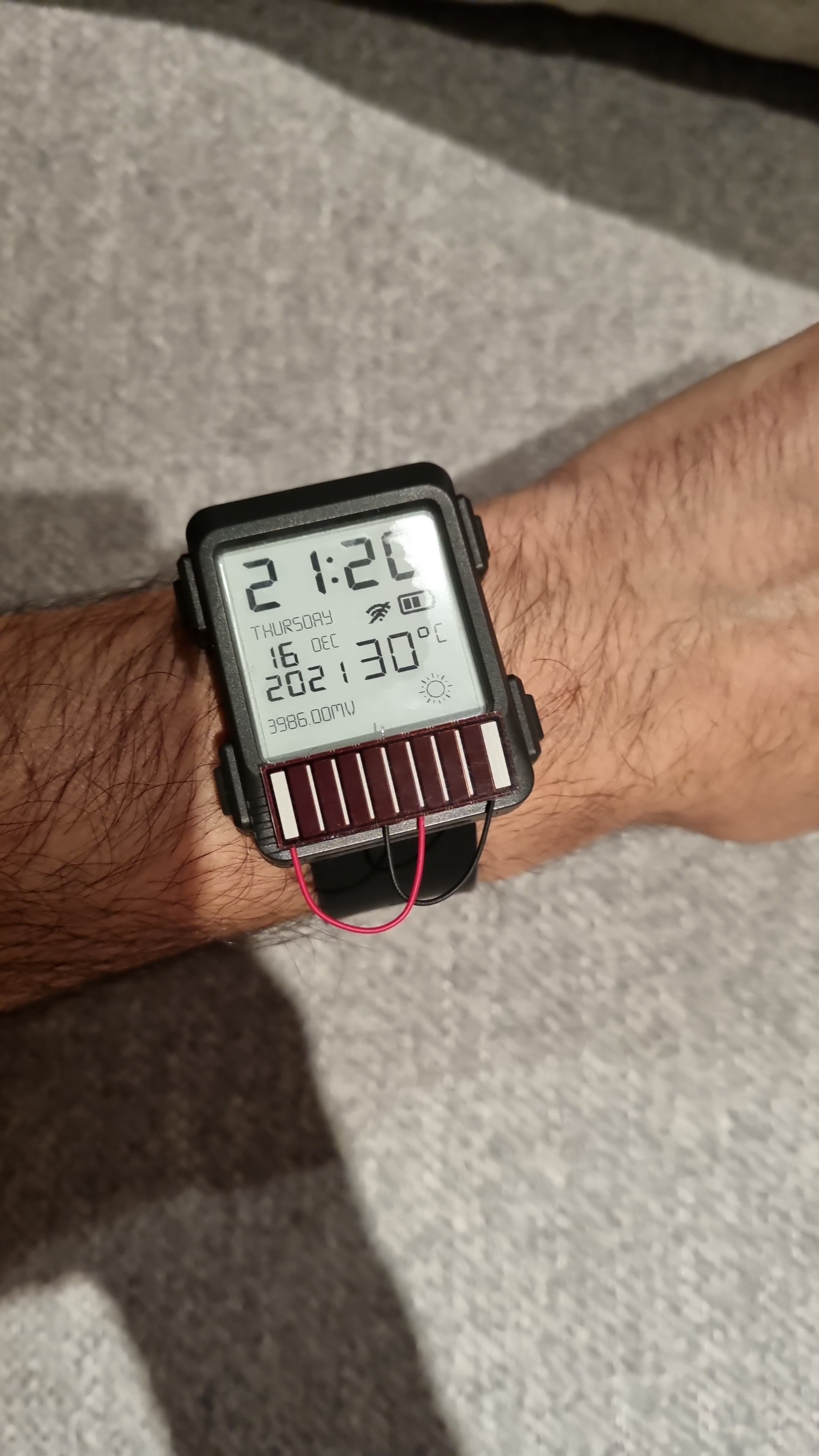

After receiving them in 2023 and when there was supply again, I started working on it. Build many PCBs that did not work, trying to get Touch+Solar+DC/DC+RTC+Display working. After many tests and trials (with many failures), I managed to have a watch working, using 2.7V only (the eink and the ESP32 seem to not care running on 2.7V), and the battery was 2 months (instead of 1 month of Watchy), with the solar giving an extra month (3 in total)!
Also because the watchy buttons were a PITA to work with, I decided to use the touch function in the ESP32, and that work quite well i have to say (also makes the case smaller).

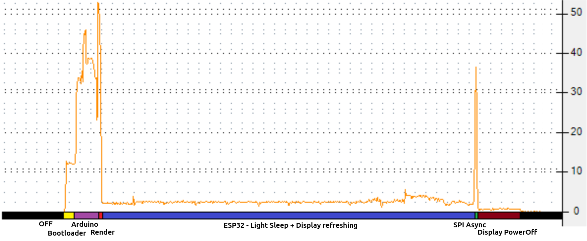

This is the graph of typical GxEDP2 update with Arduino:

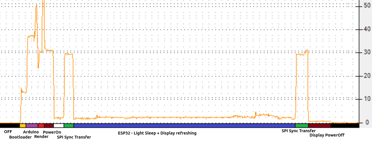

This is what i managed to get before hitting the wall (look at all that power in Booting from Flash!):
The power usage is sadly not on any particular piece of code. Just on the flash sending the data to RAM in order to boot, so there is nothing you can do (other than remove most of the functionality and reduce the binary size to the minimum).

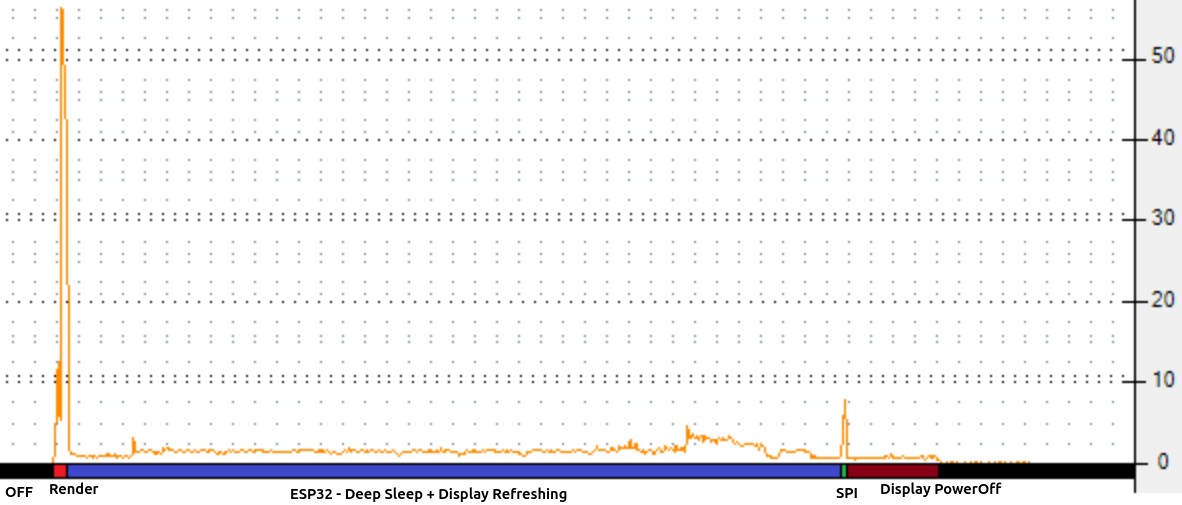

And finally, this is the result, how the consumption looked with the boot part removed:
I implemented code to handle the SPI communication and to update the region of the display controller buffer. With this I could boot+send+update display in less than 1ms. Also, I could just power of the ESP32 to deep sleep again, while waiting for the display to update, saving me 1mA on light sleep!
With this I finally managed to have a watch with a battery running 9 months (until I decommission it for a newer HW).
Since then I have polished the code, the case, added LORA (yeah!) even GPS (was a bad idea), and I am still building the project up.
