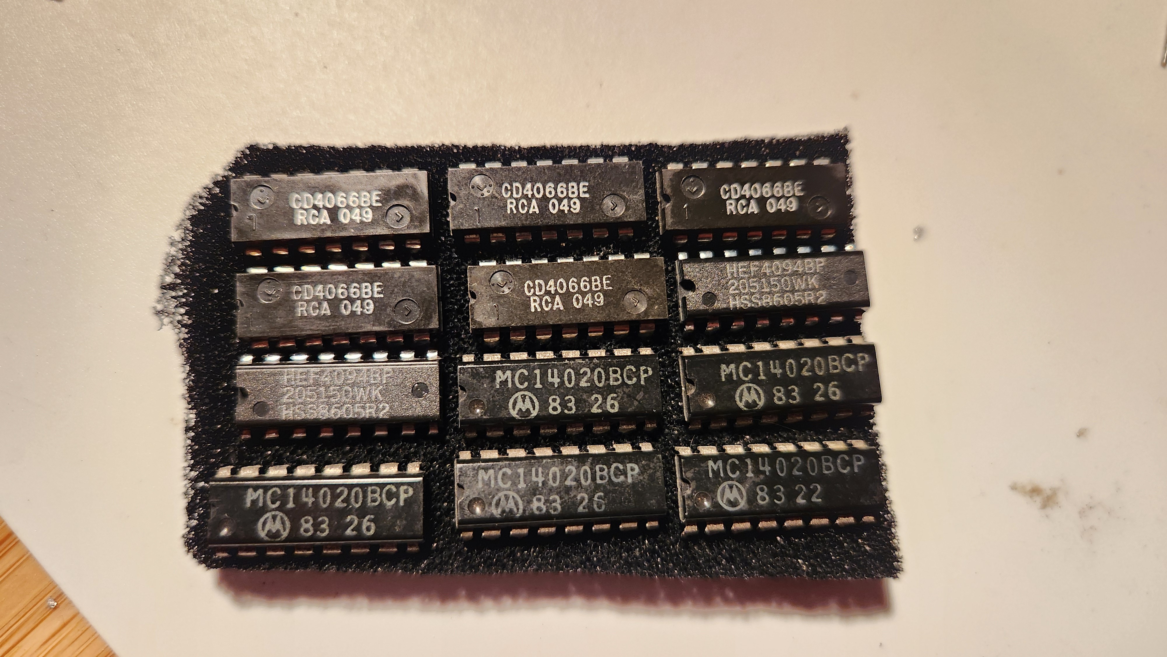

A shopping trip
There's a fantastic shop in London called Cricklewood Electronics. It sells pretty much every commonly used chip in existence, including lots of classic 40xx series logic chips, and is probably one of the last walk-in component shops in the UK, with hundreds of those little drawers behind a counter. At a time when postage from the US is extortionate due to supply chain issues, this has proved a saviour for me this week - I managed to get this selection of switch arrays, shift registers and frequency dividers for under £15. I'd highly recommend Cricklewood Electronics if you live near London and need immediate, low-volume chips. More on what these chips are for later.

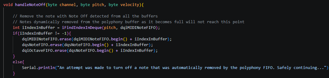

Design 1 - Enforced 6-voice full polyphony

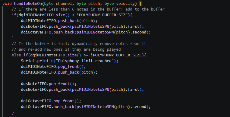

In this design, our ESP32 microcontroller uses a priority encoder to limit the synthesiser's polyphony to 6 notes. This means that if more than six notes are played at once, only the six most recently played notes are forwarded to the synthesiser's six voices.
Apologies for the C++ code dump, I'll try to explain it as best as I can.
On each Note On / Note Off event, the ESP32 extracts the pitch (eg. "A", "C#", "E") and octave (eg. "3", "4", "5") from a MIDI message. This is carried out by the function psiMIDINotetoSPN which takes a MIDI note between 0 and 127 and converts it into its SPN "Scientific Pitch Notation" format eg. A3, C#4, E5. psiMIDINotetoSPN outputs a std::pair, the first element being the pitch and the second element being the octave number.
We then create two "deques" (double-ended queues, a data structure in C++ similar to a FIFO buffer but with the ability to delete intermediate elements). This allows us to implement the "6 most recent notes played" idea. Read more about deques here: https://www.geeksforgeeks.org/cpp/deque-cpp-stl/
One deque dqsNoteFIFO consists of the pitches of all notes currently being played, and the other deque dqsOctaveFIFO consists of the octaves of all notes currently being played. Both deques move in phase, and may contain duplicate elements if multiple notes of the same pitch, or multiple notes in the same octave, are played simultaneously.
Now back to hardware - each deque element is then assigned its own synthesiser voice. This can be implemented using six multiplexers in parallel, with each multiplexer selecting one of the twelve TOG outputs. Each multiplexer output is then passed through one of six frequency dividers, which divide our square wave down across 8 octaves. Another six multiplexers are then used to select the octave required for each voice from the frequency divider outputs.
The six outputs of the final multiplexers should now correspond to the exact notes played on the keyboard.

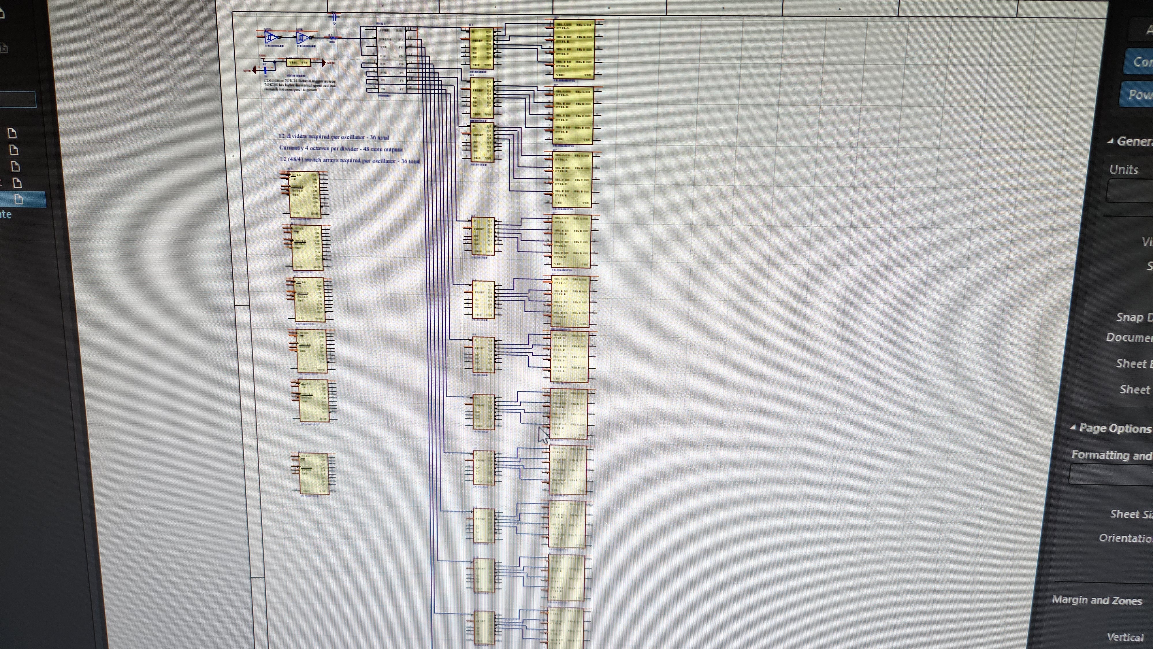

Design 2 - Unlimited voice paraphony
I'm thinking that six voices of polyphony might not be enough. An attractive design with unlimited voice paraphony is possible with only a little more hardware.
First, let's discuss the difference between polyphony and paraphony. A fully polyphonic synthesiser has an individual VCA and VCF for every oscillator, which means that every note can have independent control of its volume and timbre. A paraphonic synthesiser on the other hand mixes all the voices into a single VCA and VCF, meaning that volume and timbre of individual voices cannot be controlled, only the overall volume and timbre. Whilst this reduces the musical expression of the synthesiser, the architecture is simple and easy to debug.
Rather than creating a set number of voices, an unlimited paraphony synthesiser divides down our TOG output into every note possible on our keyboard. This is achieved by using 12 frequency dividers, one on each TOG output, then using analogue switch arrays to turn on the notes we want to hear (that are sent through via MIDI). For a 4-octave keyboard, this results in 49 individual audio signals. Annoying to prototype, but won't be too much trouble on a PCB. These 49 voices are then fed into a summing amplifier where they are combined into a single audio signal, then into the VCA and VCF. 49 notes are far too many to have individual amplifiers and filters for, especially considering the average human only has 10 fingers this seems a little wasteful.
This design was what the chips I bought shown right at the beginning of this article were for.
Here is the start of a rather terrifying Altium schematic of what this would look like. Yes, a lot of hardware, but it's basically the same thing repeated 12 times. As each piece of hardware is allocated one unique note in this design, troubleshooting is much easier than with the MUXes, as issues can be localised just by recognising which note(s) aren't playing.
Advantages of this design:
- Very easy to debug
- Unlimited number of notes can be played at once
- Simpler control circuitry - no need for FIFOs to dictate which note is allocated which voice
Disadvantages of this design:
- Requires more ICs - a single oscillator requires 12 dividers and 12 switch arrays
- We no longer have individual velocity control of each note; we're throwing potentially useful notewise MIDI velocity data away
From an engineering perspective, it's really difficult to make a decision here, as both are good designs for mutually exclusive reasons. This feels like it's going to be more of a musical decision based on what I personally want from the synthesiser rather than an engineering decision.

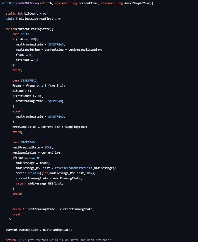

This initial code uses repeated polling at the MIDI data rate (every 32 microseconds) and a state machine to determine when transmitted MIDI messages start and end.
The basic logic for reading MIDI signals is as follows - the received MIDI signal is HIGH when idle. When the MIDI signal goes LOW for the first time, this represents a UART start bit, and we know to start reading MIDI data on the next cycle. When 8 bits of data are received, a UART stop bit pulls the line HIGH again and we know that a MIDI byte has been received.
This entire loop is triggered by a timer on the ESP32 that triggers every 32us. The state machine helps to ensure that complete messages are read without transitioning back to previous states when 0s and 1s are detected in the data (which could be misinterpreted as start or stop bits if not careful).
Whilst my code is probably logically correct, I experienced some serious issues when hooking this up to my keyboard over a MIDI cable. I experienced lots of MIDI messages displaying "0xFF" which indicates that the ESP32 was encountering framing errors when attempting to sample data. If frames are sampled in incorrect locations, then low data bits may be misinterpreted as MIDI start bits.
Doing some simple timing analysis of the timer values on each Serial print, the sampling times were often nowhere near 32us, and a single error causes an irrecoverable offset to all subsequent samples.
I think I had overestimated how fast the ESP32 is. The ESP32 runs a lot of other processes in the background on top of the code it's running, and because it isn't very powerful it struggles to keep time well. This is an issue I experienced in some of my previous ESP32 projects that required a high data rate, I didn't think this would be an issue for something like MIDI.

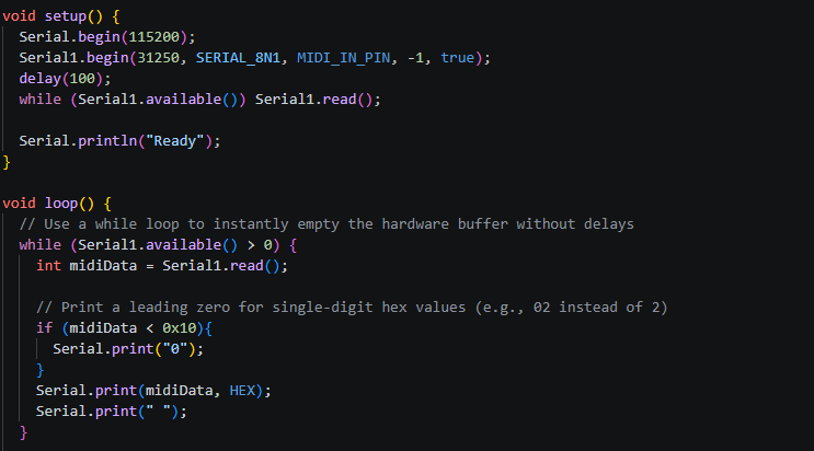

Therefore, I needed another solution. I tried to stay away from an interrupt-based receiver as I don't know enough about interrupts to make design decisions (example code for this looks quite complicated and I don't really want to waste time).
I forgot one of the golden rules of engineering projects - to just get something working as soon as possible. The ESP32 already has a hardware UART receiver which runs in parallel with the main CPU, which is much easier to interface with, is virtually immune to timing issues (as it's hardware; should achieve similar performance to an FPGA implementation) and handles all the framing automatically.

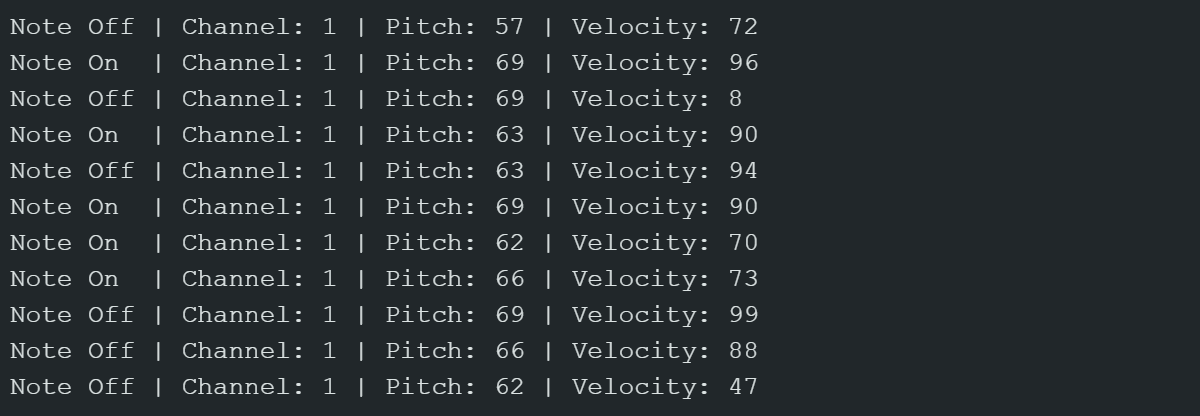

With this implementation, MIDI transmissions always synced up with key presses on my keyboard, which indicates that the timing / framing was working perfectly. However, the MIDI messages didn't appear to match the data I'd expect for Note On / Note Off events and their respective key numbers. This points to an issue further upstream. I'm currently using a jumper wire from the midimuso CV-12 MIDI to CV converter taken just after the input MIDI signal is passed through the optocoupler. The 4N35 optocoupler that comes with the kit doesn't actually meet the MIDI 1.0 specifications as its rise time is too long (10us compared to 2us required). As several sources online state that they're having issues decoding MIDI with the 4N35 too, over the weekend when it cools down a bit I'll drop into Cricklewood Electronics to see if they have any faster ones (the MIDI specification recommends a 6N138 optocoupler which should be reliable for serial data up to 100,000 baud).

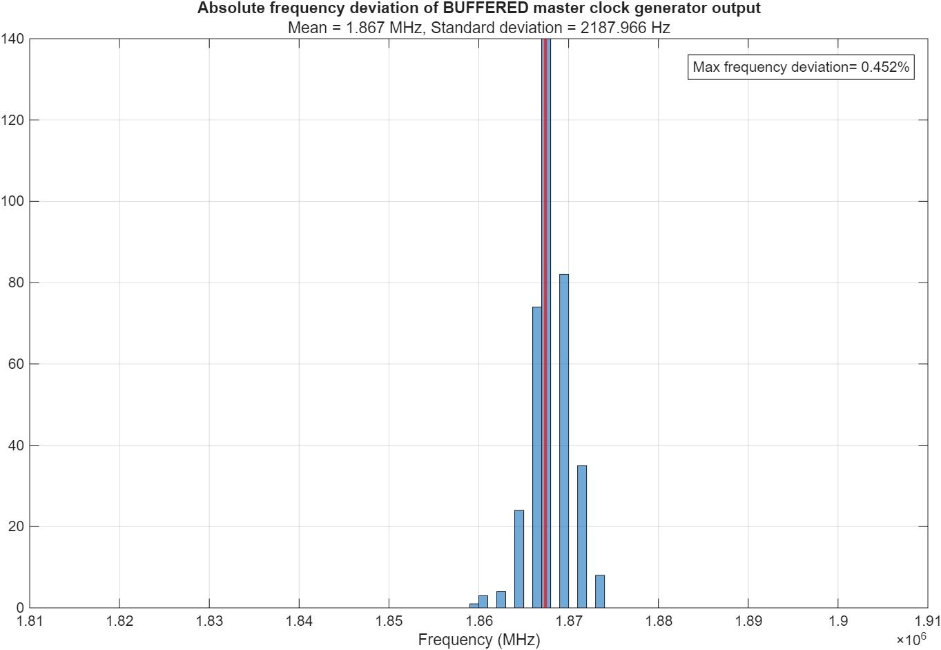

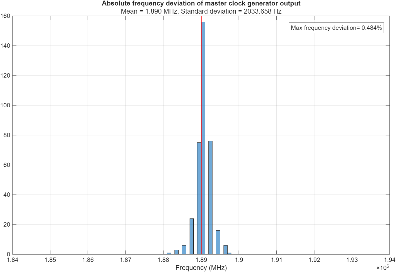

With the circuit still assembled on a breadboard, I connected different parts of my oscillator up to a precision oscilloscope taking measurements at a set period to measure their stability over a 100-second period. In hindsight I should have taken more measurements but I think the results give a sufficient picture as is.
The master clock generator always maintains stability within 10kHz of its setpoint, which was better than I expected. This corresponded to a maximum frequency deviation of around 0.5% at the source. This surprised me a little as I didn't expect the potentiometer used to control the tuning to be so stable. Bear in mind this entire circuit is still on a breadboard, using discrete components costing fractions of a penny each.
After passing the clock generator input through the buffer, the clock frequency appears to decrease slightly to around 1.867MHz. This reduction in frequency may be caused by the CD40106 hex-inverting buffer's input capacitance. From the data, the CD40106 appears to have no noticeable impact on the VCO's frequency stability.
In both cases before and after the buffer, the distribution is close enough to be Gaussian to convince me that these frequency variations are near-random.

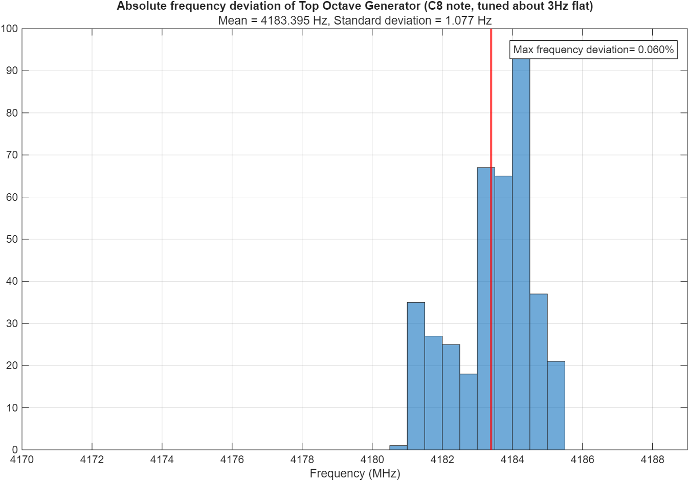

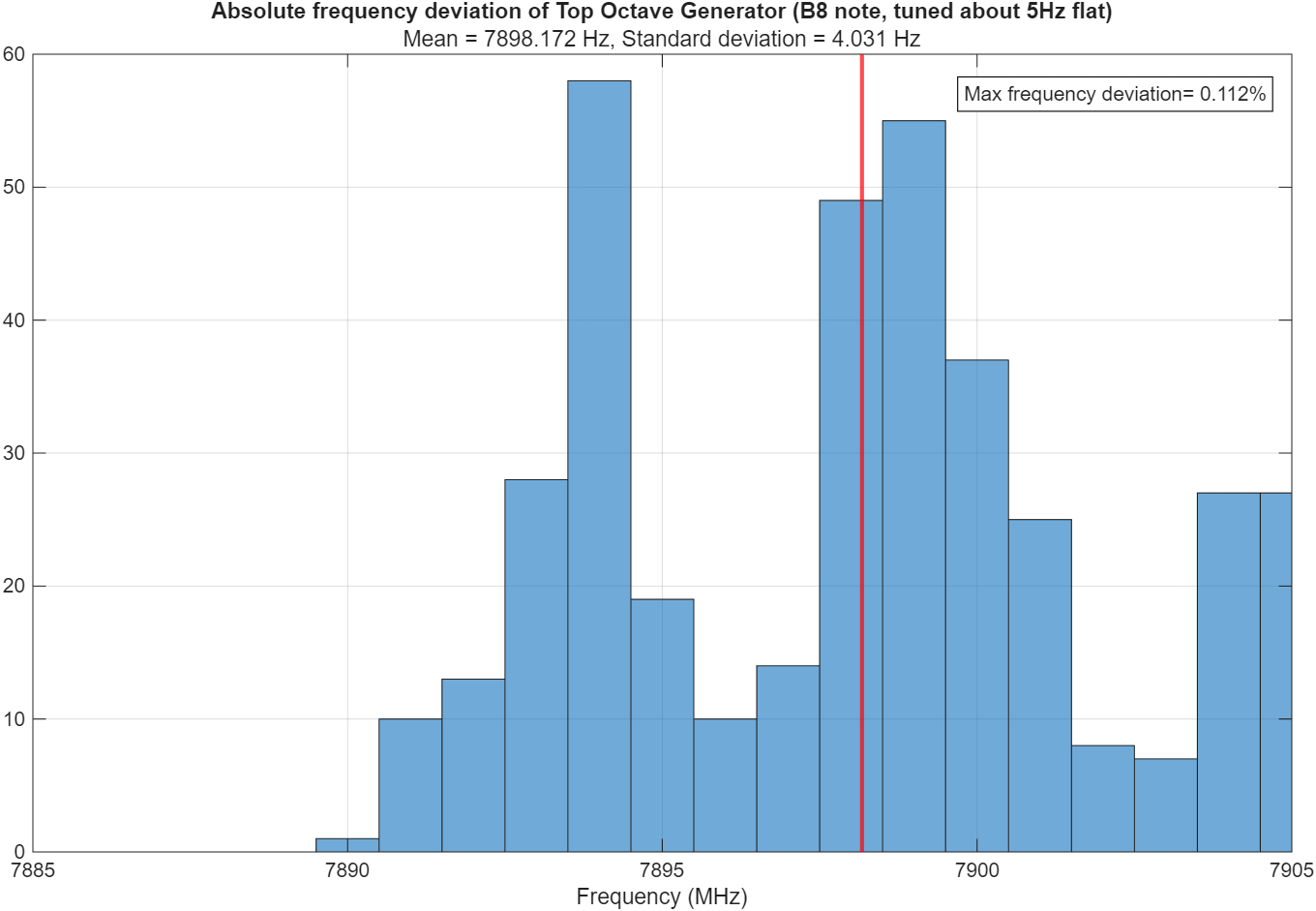

The frequency stability of the TOGs astonished me. This is C8, the lowest note the TOG outputs. The TOG output achieves a frequency stability of 0.06%, which, amazingly is lower than our 0.1% frequency stability we proposed right at the beginning of the project for frequency stability to be inaudible. Indeed, connecting a headphone amplifier to the output of the TOG and listening to the tone generated, even with the curse of my perfect pitch I can't hear any pitch variation.
The reason for this isn't directly due to clever design inside the TOG, but due to the intrinsic effect of clock division on percentage frequency jitter.
To understand this, assume our input clock signal has an absolute jitter t seconds due to frequency instability and a period T1. (Jitter is the average time variation of a clock signal's positive edge from its ideal time). When we divide our clock frequency by a factor N, the absolute jitter does not change, but the duration of the clock pulse multiplies by a factor N.
The percentage jitter before clock division is given by
and the percentage jitter after clock division is given by
This means that, simply because our clock period has increased (from frequency division), the variations in time of the clock edges is less significant compared to the clock period, assuming that absolute variations in the jitter remain the same before and after the divider.
Of course, we cannot assume the absolute jitter is the same before and after the TOG, as the TOG will introduce its own noise. Our TOG divides down our master clock by a factor of between 200 and 400 depending on the note generated, and we're only seeing about a factor 5 reduction. Regardless, this is still a fantastic result and meets our 0.1% stability requirement.
The note with the largest percentage frequency deviation is B8, which as we would expect from the theory just discussed, is the highest note on the TOG (which corresponds to the lowest factor N division).
This tells us that the envelope of frequency jitter of any note we generate will lie within 0.06% and 0.11% of its set value. A fantastic result, and good enough for me.

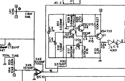

The RS-505 Paraphonic master VCO uses a varactor diode to control the oscillator's pitch. A varactor diode is a reverse-biased PN diode which functions as a voltage-controlled capacitance. Remember - the RS-505 is centred around a second-order LC resonator, so in order to vary the VCO's frequency we either need to change the resonator's effective capacitance or inductance.
Whilst standard diodes and BJTs can be used as rudimentary varactor diodes by reverse biasing them due to their voltage-dependent parasitic capacitance, this variation in capacitance is far too small (on the order of picofarads) to give us the tuning range we require. Therefore custom varactor diodes must be used, which have a much larger capacitance range (on the order of hundreds of nanofarads).
Finding through-hole varactor diodes is very difficult. Whilst the RS-505 Paraphonic design is a cool one, I think the additional complexity it brings is just not worth the additional circuitry or the unusual components. The ES-50 VCO achieves very similar (possibly even better) stability using fewer components, and is also a RC oscillator, meaning oscillation frequency can be controlled by a variable resistor, which is much more common and easier to work with.

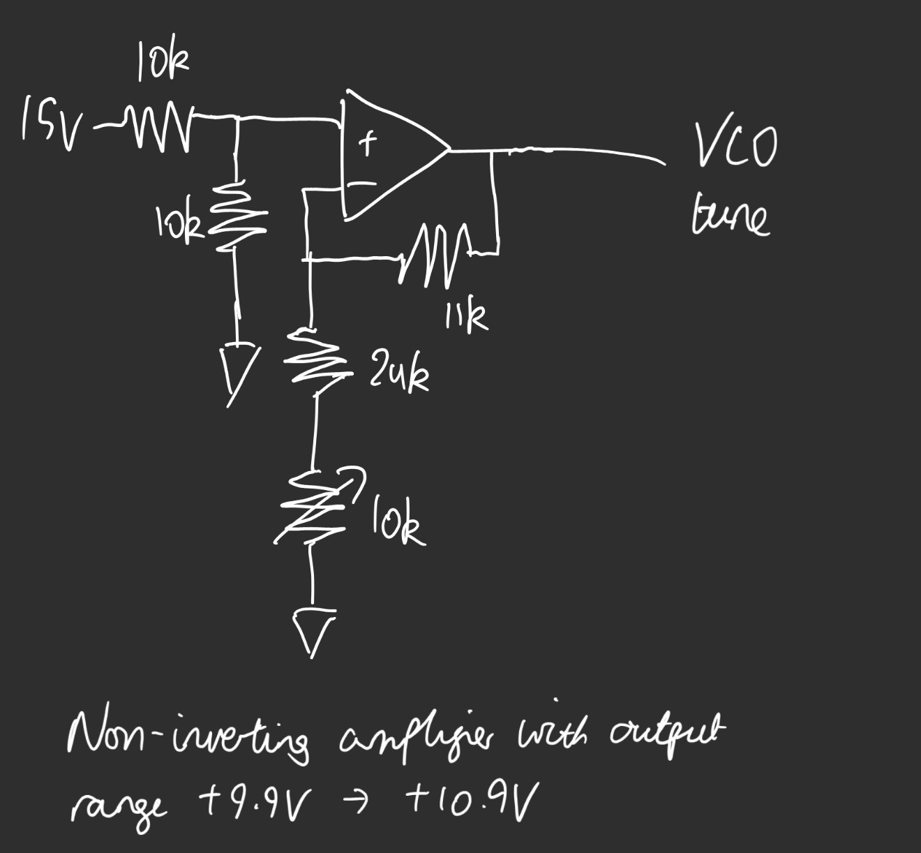

The ES-50 tuning can be controlled coarsely by varying the 10k potentiometer VR4. In the ES-50 schematic, a negative supply voltage is used for tuning, which is then inverted to give a positive voltage at the output of the op-amp. As my home power supply doesn't have a negative supply rail, in my design I'll replacing this with a positive supply and a non-inverting amplifier set to have identical output ranges.
Potentiometers easily come disconnected, so it seems like a better decision to place the potentiometer on the ground path of the non-inverting amplifier rather than the feedback path, so that the gain goes to 1 rather than infinity if the potentiometer becomes open circuit.

The most important MIDI messages for now are the "Note ON" and "Note OFF" commands, which contain data equivalent of trigger/CV in a two-byte message.

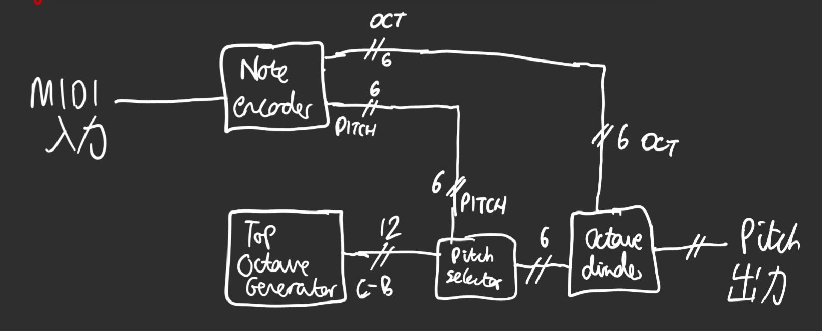

This is my current design for a controller interface that takes our MIDI signal input and converts it into a polyphonic pitch output.
- The note encoder takes our input MIDI message and identifies Note On / Note Off events, and outputs 6 pitches (eg. C, D, E, F) and their corresponding octaves (eg. 2, 3, 4, 5) that are played.
- The pitch selector receives the 12 outputs of the TOG and the 6 inputs from the note encoder, and buffers 6 waveforms from the TOG as decided by the note encoder.
- The octave divider takes each of the 6 waveforms sent from the pitch selector and divides their frequency by the required power of 2^n to reach the desired octave.
This is the least hardware-heavy method of implementing polyphony that came to mind. An important design decision was placing the octave dividers after the pitch selector rather than before it, which reduces the number of frequency dividers required from over 70 on a 6-octave keyboard to just six.

In my master VCO design, I'd like to use the LC tank from the Paraphonic for its faster rise time, and the simpler negative feedback of the Lambda to reduce component count and complexity. Over the weekend I'll finalise my design and confirm it performs as expected.
How can we interface the master clock to the rest of the VCO?
As previously mentioned, the master VCO will feed into a top-octave generator, generating all 12 notes on the highest octave of the keyboard, followed by binary dividers to generate all notes in lower octaves.
Our top-octave generator, the M082B1, uses integer division of the master clock by precise factors to obtain all the notes of the highest notes on the keyboard.
Application information from the M082B1 top-octave generator datasheet For example, to obtain a C# from our master clock generator (the lowest note in the top octave), the top octave generator divides our clock frequency by 451. In order for the sounding pitch of this note to actually be C#, we must precisely tune the frequency of our oscillator to a multiple of 99680Hz. This is a weird frequency, but I think it's specifically been chosen so that the integer division very closely approximates the true ratios between pitches.
I avoided talking about this until now, but both the Lambda and Paraphonic both have a DC voltage bias input which can be used to finely vary the frequency of our master VCO. This voltage can be set precisely to DC creating a fixed oscillation frequency, or modulated to create vibrato effects.
This is another reason why these analog clock generators were used, instead of a crystal oscillator which cannot change its oscillation frequency at all. The existence of this DC bias may also allow us to implement a phase-locked loop architecture in the future if we're feeling very fancy.
I must admit, over the past week I haven't had much opportunity to experiment with tuning or integrating with the TOGs due to time, this is definitely a task for over the weekend, and I'll report back on the success of this in next week's update, where if we're lucky we might be able to get some sound.

This is the master clock generator / oscillator from the Korg Lambda ES-50, released in 1979. The Lambda was considered a budget synth at the time of its release, so the electronics might be skimping a bit compared to Korg's cream of the crop (don't get me wrong, it's not a bad synth by any stretch of the imagination!)
While it looks a little complicated, analysis based on the Barkhausen criterion mentioned earlier simplifies the analysis a lot.
- This oscillator is centred on transistors Q3 and Q2, which are both configured as common-emitter amplifiers. As collector voltage of a CE amplifier is 180 degrees out of phase with the base voltage, the total phase shift in the loop is 360 degrees with a resonant frequency determined by C5 and R16. This satisfies the Barkhausen criterion.
- Transistor Q1 is a PNP transistor configured as an analog buffer, creating additional stability.
- C3 and C6 I believe are decoupling capacitors. Whilst they do slightly influence the resonant frequency of the oscillator, I don't think they're meant to.
The result is a near square wave at the collector of Q1. As the oscillator runs at quite a high frequency, despite C5 being tiny its rise time is likely to be significant. A quick check using the rise time approximation of a first order system gives t_r = 2.2RC = 150ns, which for the oscillation frequency of 2.3MHz makes up around 70% of the square wave on-time.
Is this acceptable? I'm not sure, and I suppose this is the purpose of the 4069 buffer after R9 to sharpen up the clock edges, but from my simulation the 4069 doesn't appear to have much effect, at least from a signal integrity perspective. Long rise times are generally bad for flip-flops as it increases the chance of them entering a metastable state during state changes.
On the other hand, as the oscillation is first-order, there will be no overshoot, undershoot or ringing of the clock, which is good. This could be a design compromise to prevent this from happening.
