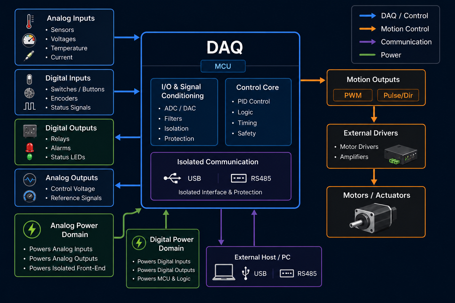

System Overview
is architecture separates key functions while keeping them tightly integrated:
  • Analog and digital inputs
  • Analog and digital ioutputs
  • Motion outputs
  • Isolated communication
  • Separate power domains
Designed specifically for noisy environments.

    Some of the key architectural decisions include:
    • Galvanically isolated analog inputs
    • Separate analog and digital power domains
    • Isolated communication interfaces
    • Differential analog inputs for improved noise immunity
    • Higher-current analog outputs capable of directly driving external circuits
    The analog input section is fully isolated from the MCU and digital power domain.
    Even the analog ground is not shared with the microcontroller ground or the external communication ground.
    Isolation is achieved using isolated DC-DC converters and isolation stages rated up to approximately 1.5 kV for the analog section, and several kilovolts for communication isolation.
    This significantly reduces the impact of:
    • Ground potential differences
    • Industrial switching noise
    • Noise coupling through shared return paths
