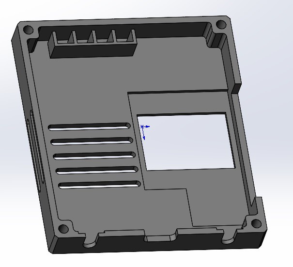

  • Project Log #4 — Mechanical Design & Enclosure
    Ilya Egorov7 days ago 0 comments

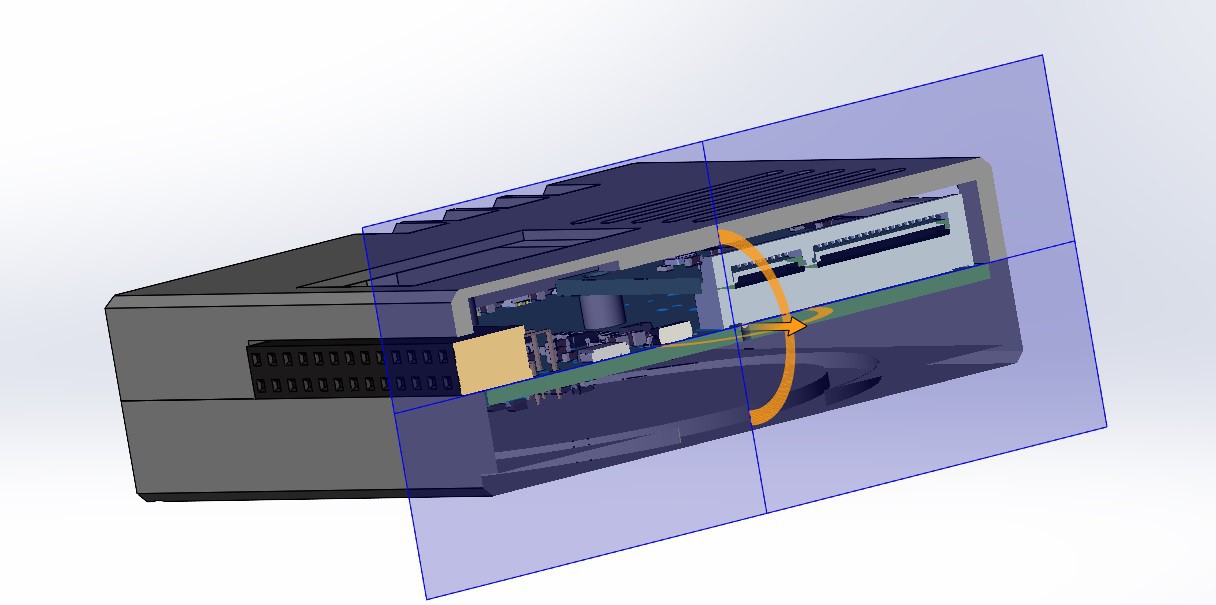

    Design Constraints
    From the very beginning, the enclosure had one hard requirement: when DevPocket is magnetically mounted to a smartphone via MagSafe, it must not extend beyond the phone's footprint. This drove the outer dimensions to 64.6 × 74.6 × 20 mm — compact enough to sit behind most modern smartphones without sticking out.
    (Photo : all devpocket mechanics)
    The 20 mm thickness is not arbitrary — it is dictated directly by the internal stack-up. From bottom to top: the LiPo battery sits on the underside of the main PCB, then the board itself, then the mPCIe module plugged in on top. There is no wasted space; the enclosure height is exactly what the electronics require.
    (Screenshot: cross-section view showing the internal stack)

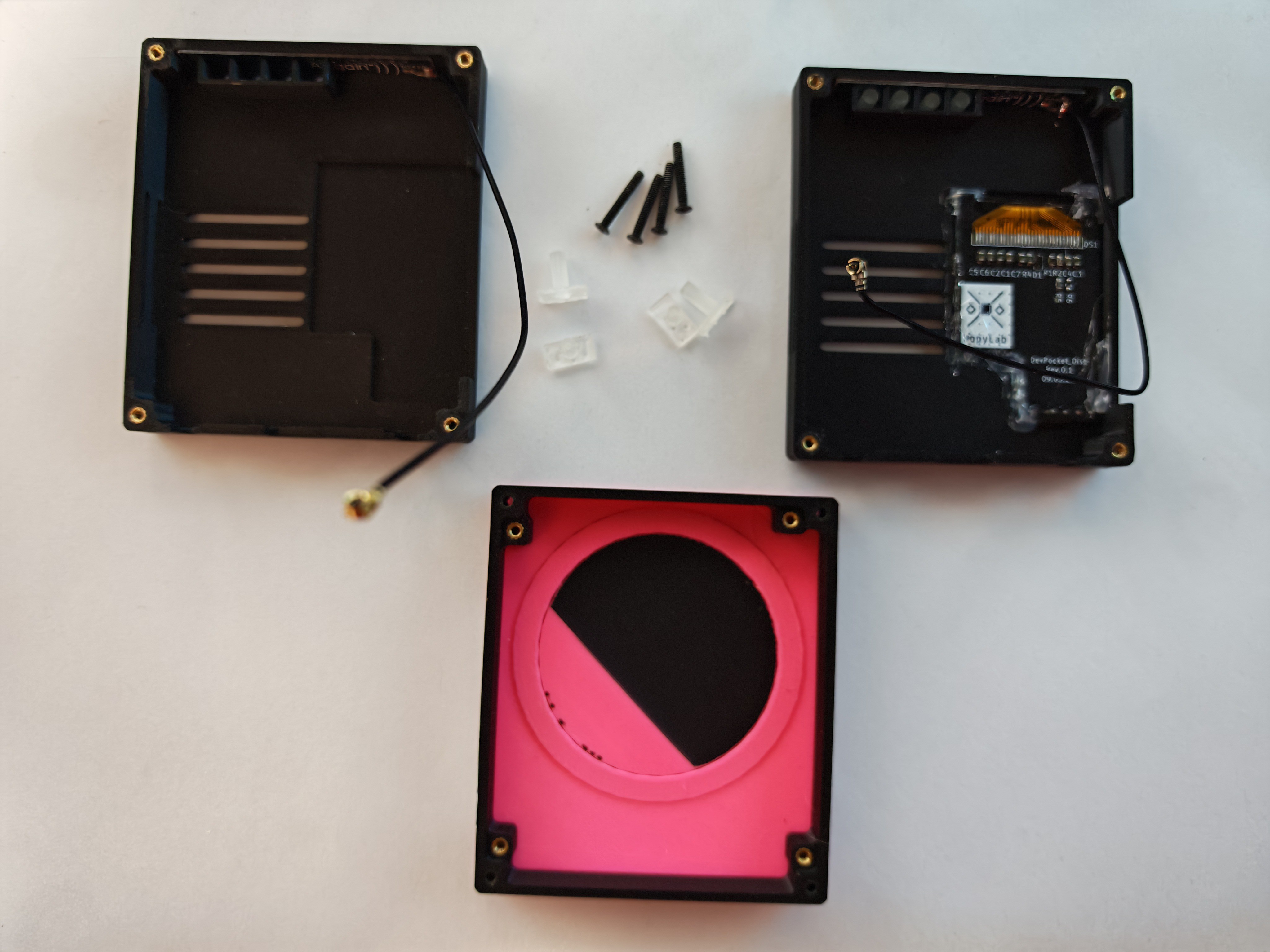

    Fabrication Method
    The enclosure is FDM 3D printed, chosen from the start of the project. FDM is the obvious choice for an open-hardware project: the files are on GitHub in both STEP and STL format, anyone with a printer can reproduce or modify the enclosure without any tooling costs, and iterating on a new revision takes hours rather than weeks.

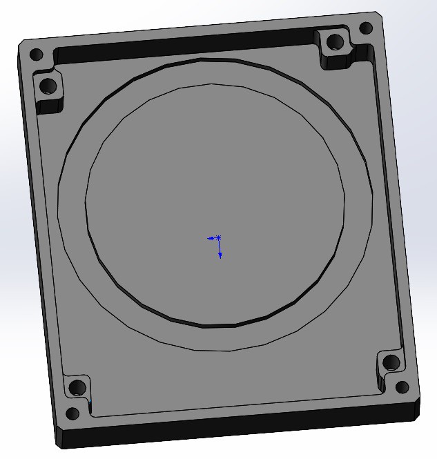

    Bottom Shell — MagSafe Ring Pocket
    The bottom shell has a dedicated recessed pocket for the magnetic ring. The ring is a standard neodymium magnet ring sold on AliExpress for MagSafe-compatible accessories — it comes with a self-adhesive backing, so installation is simply press-fit into the pocket. No tools required.
    The pocket dimensions match the standard MagSafe ring geometry: 56 mm outer diameter, 46 mm inner diameter. This allows DevPocket to attach magnetically to any MagSafe-compatible phone case, a ring stand, or any ferromagnetic surface.
    (Screenshot: bottom shell with the MagSafe ring pocket)
    Top Shell
    The top shell carries all the user-facing cutouts: the two tactile buttons, the USB-C connector, and the antenna port. It also includes channelled light guide channels — individual tunnels for each of the four WS2812B LEDs, with dividing walls between them to prevent light bleed between channels.
    (Screenshot: top shell showing button cutouts and light guide channels)
    Two variants of the top shell are published on GitHub:
    • Standard top — for bare DevPocket use
    • Sensor module top — with ventilation slots for air circulation around the ENS160/AHT20/BMP280 sensors, plus a slot for the display board that mates with the lid connector automatically when the case is closed
    The top shell is the part you'll most likely customise when designing your own mPCIe modules — the rest of the enclosure stays the same.
    Fasteners and Heat-Set Inserts
    All threaded connections in the enclosure use M2 × 5 × 3.2 brass heat-set inserts pressed in with a soldering iron. Installation temperature should be approximately 10–20 °C above the filament's print temperature — for PLA around 225 °C, for PETG around 245 °C.
    The knurled outer surface of each insert melts into the surrounding plastic and locks permanently as it cools, giving a clean metal thread that survives repeated assembly and disassembly without stripping.
    Two screw types are used:
    ApplicationScrew
    PCB to bottom shell (standoffs)M2 × 4 DIN 912 — socket cap head (hex key)
    Top shell to bottom shellM2 × 14 countersunk — DIN 965 / ISO 7046, 90° head, Pozidriv drive
    Using countersunk screws for the shell halves keeps the outer surface completely flat — no protruding heads on any face of the device.

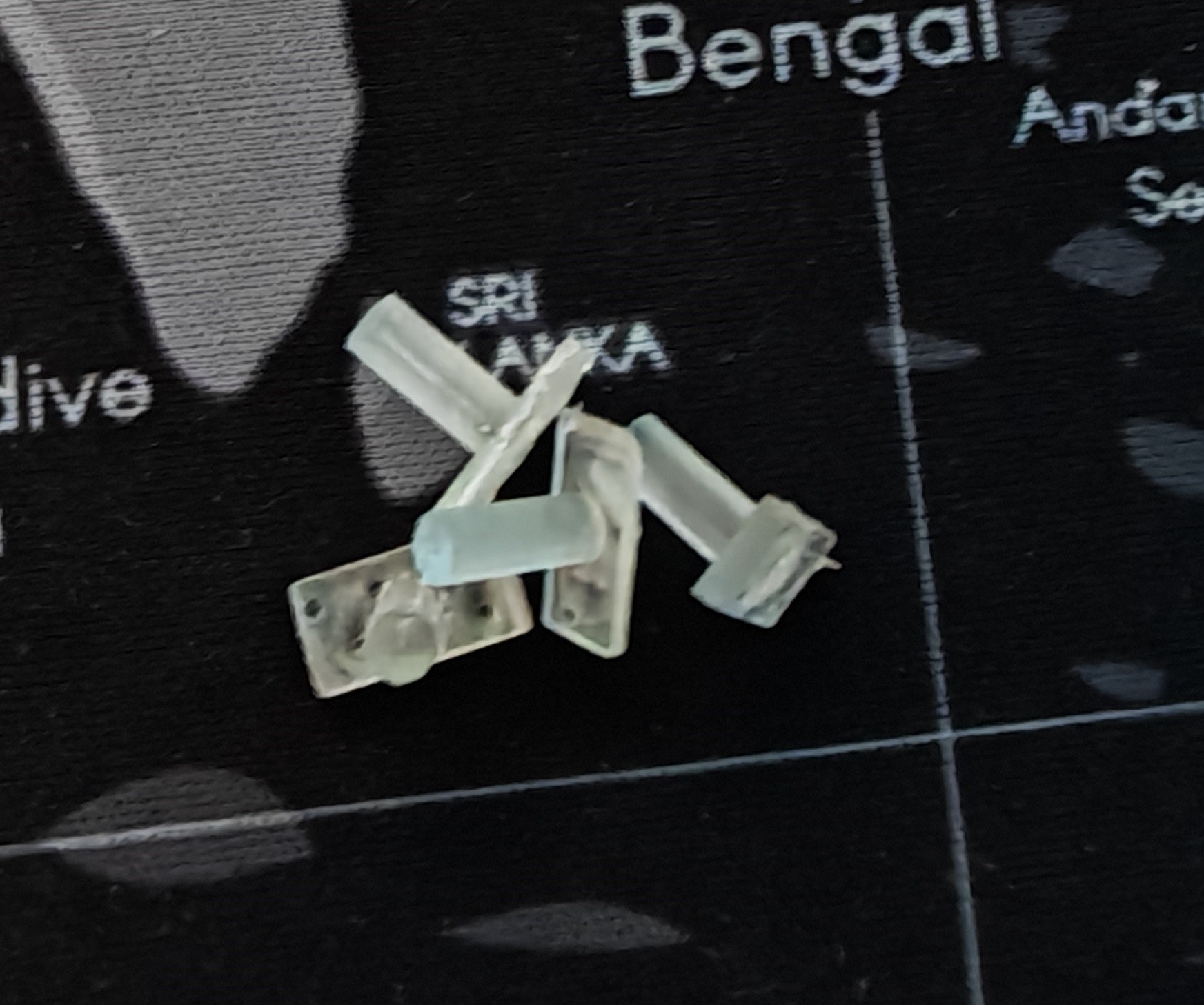

    Light Guides
    The light guides are custom-designed parts, printed on an SLA 3D printer in clear resin. SLA was the right choice here: the smooth, optically clear surface finish of SLA parts transmits light from the WS2812B LEDs far more efficiently than the rough, semi-opaque surface of an FDM print.
    (Photo: light guides separately)
    Each guide is shaped to route light from the LED position to the face of the enclosure, with the dividing walls in the top...

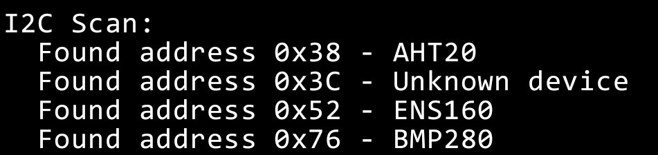

    Reading the Sensors — How the Script Works
    On startup, the script runs an I²C scan and initialises each sensor in sequence, printing the result to the console.The ENS160 is the most demanding sensor to initialise — it requires a hardware reset sequence (RESET → IDLE → CLEAR → STANDARD), and its Part ID (0x0160) is verified before proceeding. Once running in standard mode, it receives live temperature and humidity compensation data from the AHT20 on every reading cycle, which is mandatory for accurate eCO₂ and TVOC figures.Readings are updated once per second. The console microREPL output looks like this:
    (Screenshot: console output with sensor init and live readings)
    While the script is running you can interact with it via micro-REPL or any serial terminal:
    CommandAction
    dataPrint a fresh sensor reading immediately
    statusShow which sensors were found and ENS160 init state
    scanRe-run the I²C bus scan
    helpList available commands

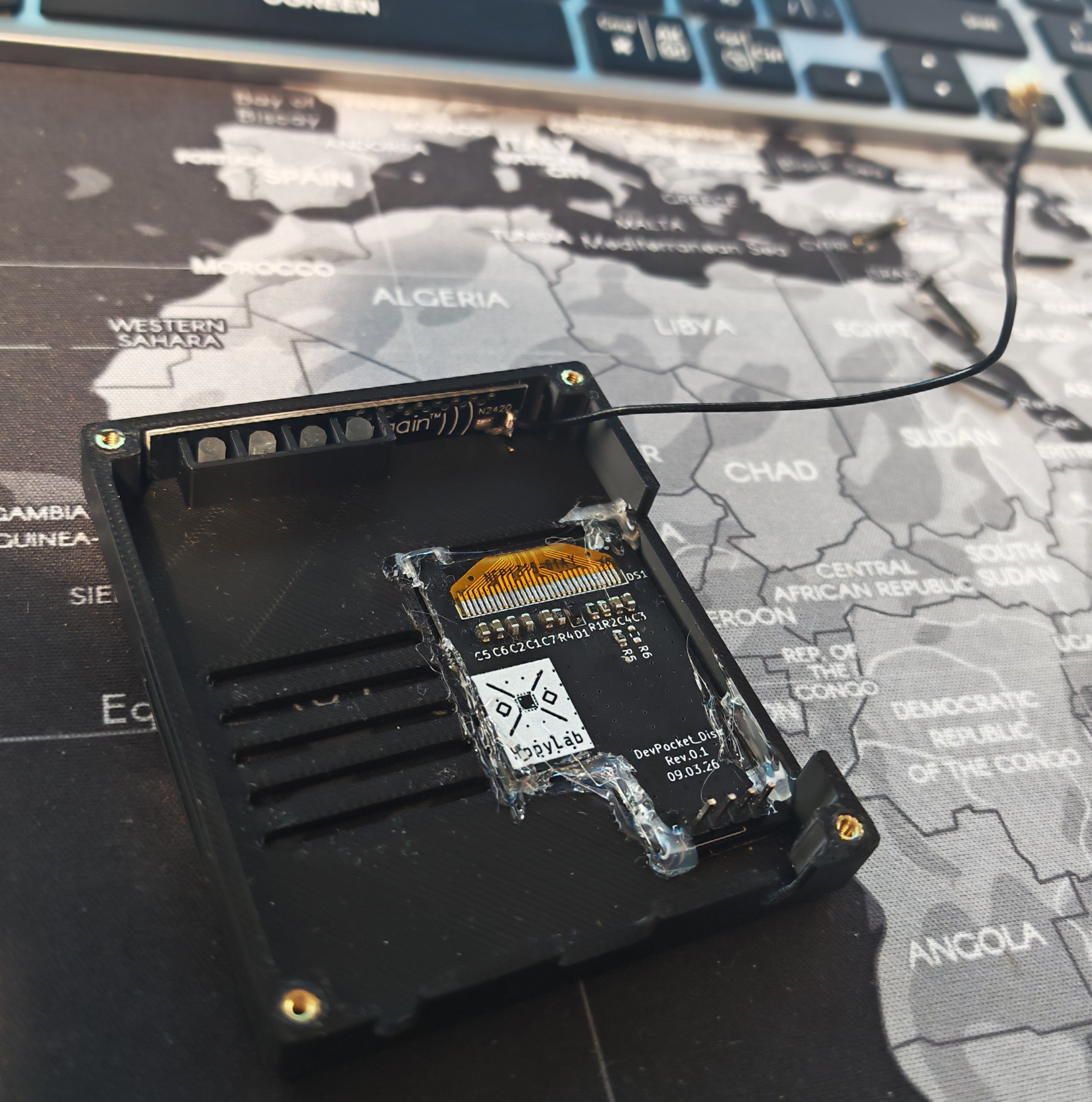

    Going Fully Standalone — The Display Lid
    When I designed DevPocket I included two dedicated connectors on the main board: one for an OLED display and one for an LED matrix. The idea was to make a PCB that mounts inside the top lid of the enclosure — when you close the case, the connectors mate automatically and the display(LED matrix) is live without any extra wiring.
    (Photo: top lid with the display board glued in)

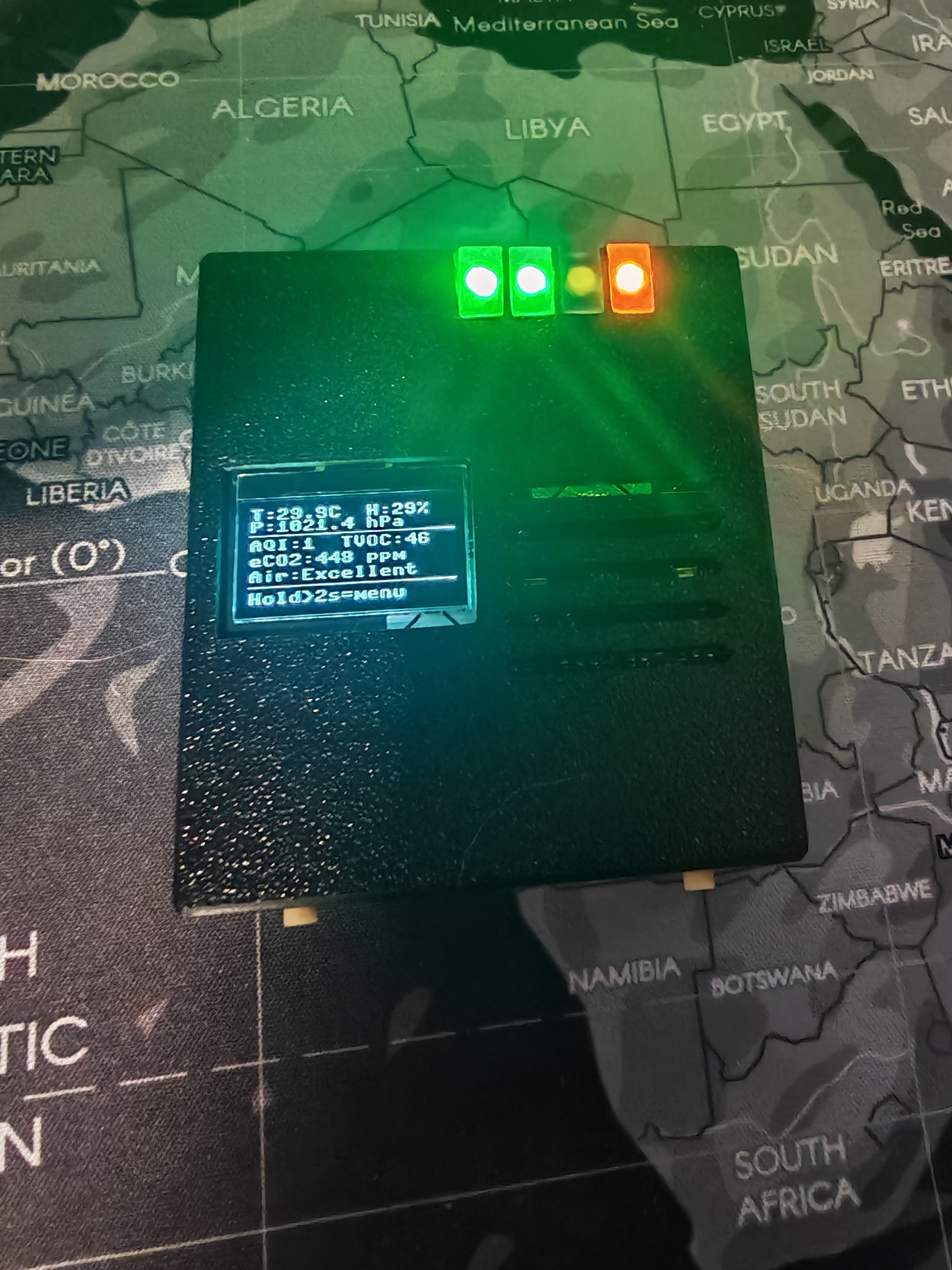

    The display board uses a standard 128×64 SSD1306 OLED. It connects to the  I²C bus as the sensor module, so the whole system — sensors, display, and main MCU — runs on two wires.
    The OLED layout for the air quality script fits all key data on the 64px height.Temperature and humidity sit on the top line, pressure on the second. Below the divider: AQI, TVOC, eCO₂, and a plain-English air quality description. The bottom status bar shows either a sensor warning (!Sensor miss), charging state, or the button hint (Hold>2s=menu).
    (Photo: DevPocket with the sensor module and display running)

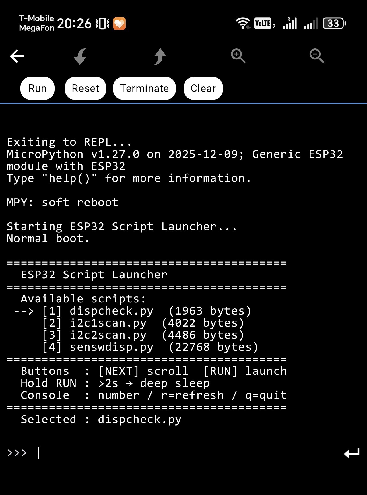

    Returning to the Launcher
    Since this script runs inside the launcher (described in Log #2), exiting back to the script menu is built in. Holding the NEXT button (GPIO13) for more than 2 seconds triggers a clean shutdown: the sensor power rail is cut via the PWR_SENSORS GPIO, the OLED shows "Returning to menu…", the LEDs are cleared, and a KeyboardInterrupt is raised — which the launcher catches and uses to return to the script selection menu. No reboot needed.
    (Photo: DevPocket with display in the script selection menu )

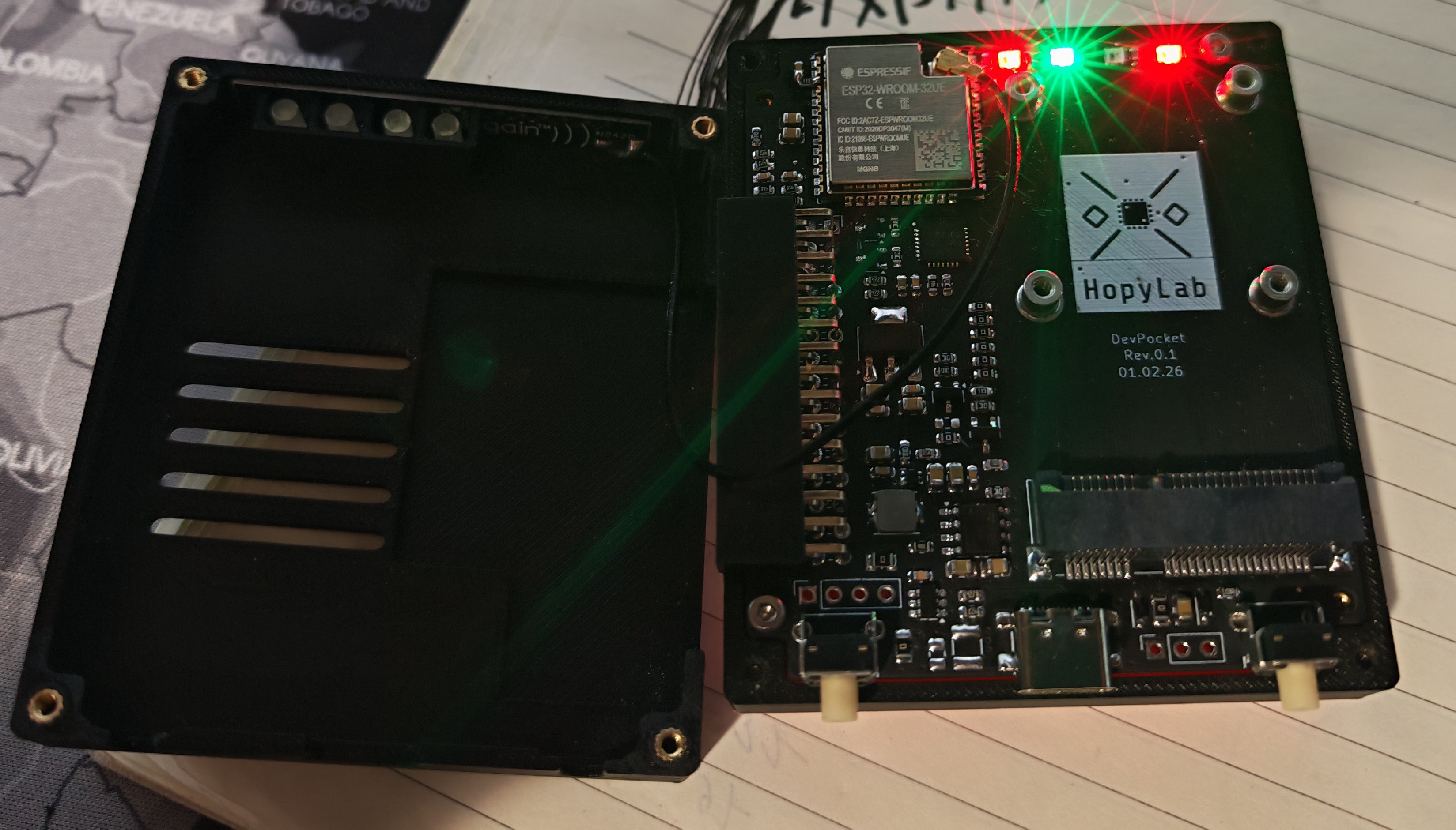

    The first boot went smoothly — no magic smoke, no unexpected behaviour. I went through the hardware checklist one by one:
    • Power system — the TP4056 charged the LiPo correctly via USB-C, the TPS61023 boost converter brought up the 5V rail cleanly, and the AMS1117-3.3 LDO delivered stable 3.3V to the ESP32
    • Microcontroller — the ESP32-WROOM-32UE enumerated correctly over the CP2102GM USB-UART bridge and responded to flashing without issues
    • WS2812B LEDs — all four addressable RGB LEDs responded to a test pattern
    • Tactile buttons — both GPIOs registered clean transitions with debounce
    DevPocket then connected to an Android phone and was immediately recognised by micro-REPL. One small surprise: the phone started charging the device over USB without any prompt or permission request. This is standard USB host/peripheral negotiation behaviour — the phone detected DevPocket as a device and pushed VBUS. It's not a problem in practice, but worth noting for battery-conscious use cases.
    (Photo: DevPocket during first power-on)

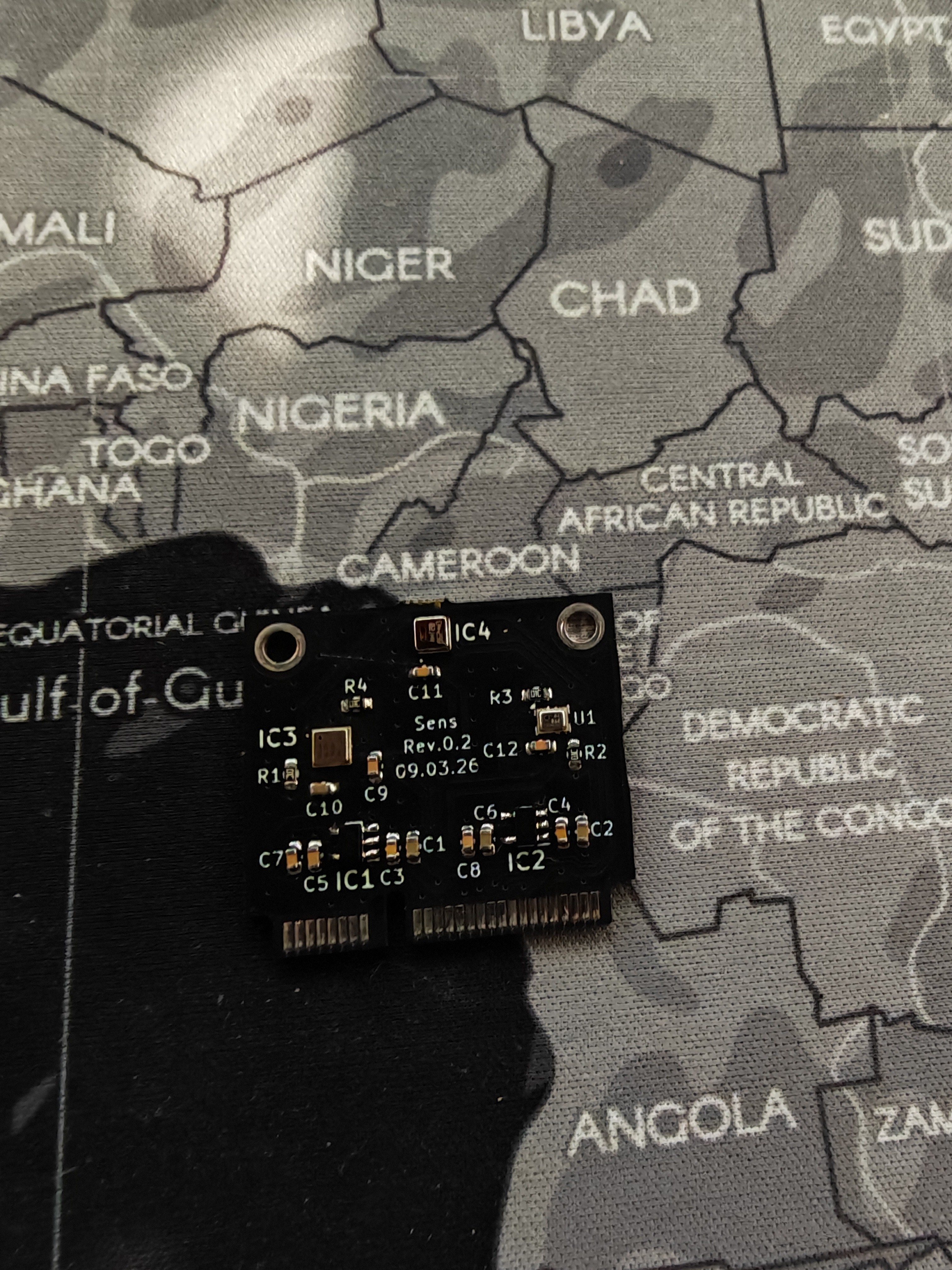

    First Module — Air Quality Sensor Board
    The first mPCIe module I designed alongside the main board is an environmental monitoring module — something I've wanted to carry around for a long time to assess air quality wherever I happen to be.
    (Photo: mPCIe sensor module)
    The module fits the standard mPCIe half-size form factor and plugs directly into DevPocket's expansion slot. It carries three sensors on a shared I²C bus:
    SensorMeasuresI²C Address
    BMP280Barometric pressure, temperature0x76 (SDO → GND)
    AHT20Relative humidity, temperature0x38 (fixed)
    ENS160eCO₂, TVOC, AQI0x52 (ADDR → GND)
    Power architecture is a two-rail design. The ENS160 requires a separate 1.8V supply for its VDDIO digital interface, generated by an XC6219B182MR-G LDO. The sensor core VDD runs from 3.3V via a second XC6219B332MR-G LDO, providing local regulation and decoupling independent of the main board's rail. The BMP280 and AHT20 run directly from the module's 3.3V rail.
    All three sensors communicate over I2C1 (SDA/SCL routed through the mPCIe connector from ESP32 GPIO32/33). The ENS160 INT line is routed to IN1 on the connector for interrupt-driven readout when needed.
    I²C Scanner — First Utility Script
    Before writing any sensor code, I ran an I²C scanner to verify that all three sensors were electrically present and at their expected addresses. This is a universally useful tool — any time you're debugging an I²C bus on an unknown device, you just run it on DevPocket.
    (Screenshot: I²C scanner output on Android via micro-REPL)
    The scanner swept addresses 0x08–0x77, and all three sensors responded at their expected addresses: 0x380x52, and 0x76. No bus errors, no address conflicts — the module schematic checked out.
