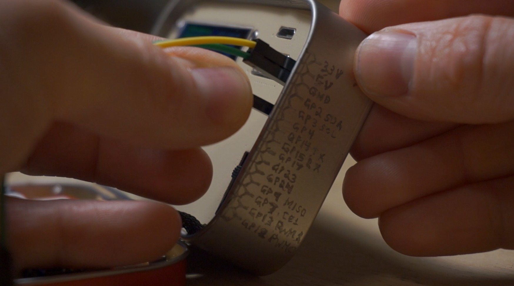

3. Frame and Fit
Fitting everything inside the Altoids Tin required stacking the Raspberry Pi and UPS board on-top of one another and soldering them together, as well as removing some connectors and components to free up space. The frame was 3D printed to flex enough to fit inside the Altoids Tin, with the front panel holding everything inside.
4. Finishing Touches
I painted the front panel a nice beige, like a vintage desktop computer.
I also engraved the labels for all the GPIO pins on the side of the tin.
