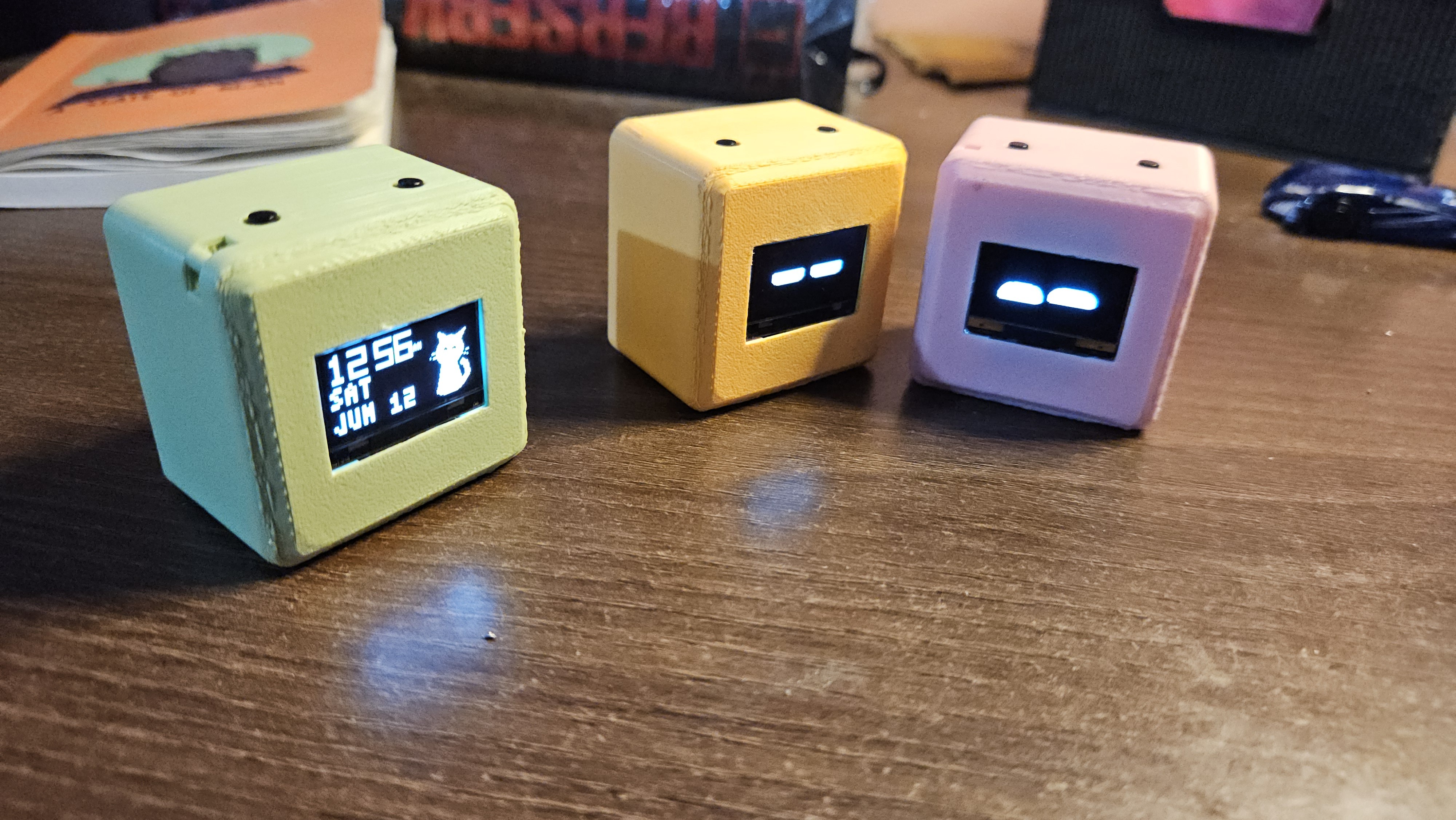

MiniSoul is built on the ESP32-S3 SuperMini with a 1-inch OLED display, coin vibration motor, and passive buzzer.
Touch inputs drive the behavioral engine which models personality across six factors: Curiosity, Fear, Joy, Anger, Sadness, Desire. Each interaction affects these factors over time, making the robot's responses feel shaped by its history with you rather than pre-scripted. Every unit develops subtly differently.
Two months in. Hardware foundation complete. Behavioral engine being designed now. One month from a first finished version.

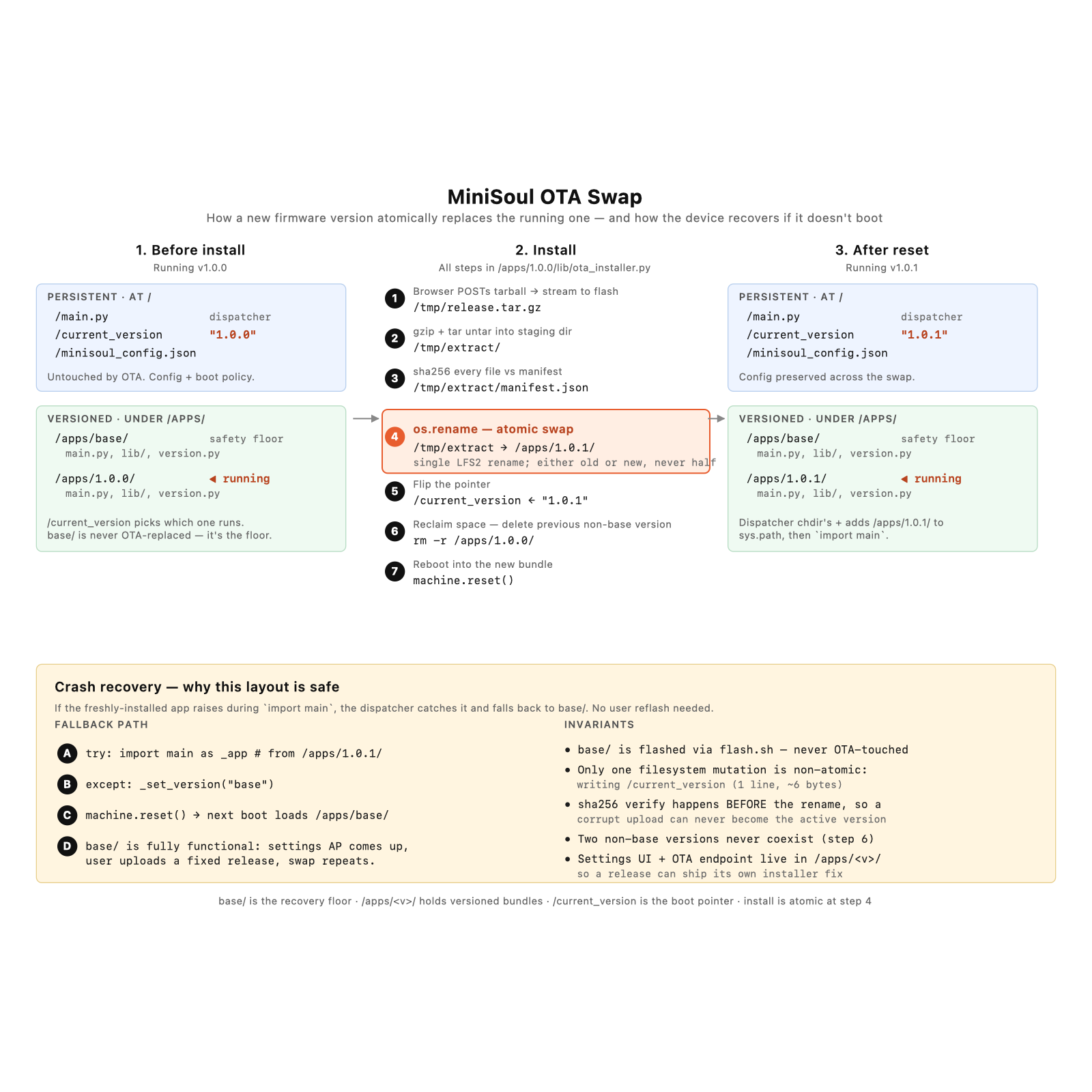

  • Making the updates over the air (OTA)
    Sritabh Priyadarshi4 天前 0 comments
    I've been working on MiniSoul with a deadline 10 days out, and I'm falling behind since I'm not getting enough time for it. Every small window of free time, I'm putting toward it.
    Once I hand MiniSoul over, I can't change the hardware, but I can always update the software, as long as I build in the ability to update the firmware. That's what I focused on over the last week.
    I know I won't catch every bug at once, and I might not ship every improvement I want. But this gives me peace of mind.If something breaks, I can fix it with a new release.
    Here's a small visualization of how the flow works, made with Claude which gives a pretty good picture.
    Check how it looks in action.
