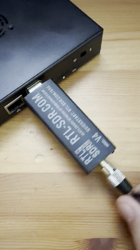

The problem
I want to use my CM5 in its CM5io case to run some RTL-SDR software, but the RTL-SDR sticks out a lot from the front. This makes it take up a lot more space on my shelf, and it feels fragile to have such a long device cantilevered out from the USB port like that. It also has an unsettling amount of play:
wiggle wiggle wiggle

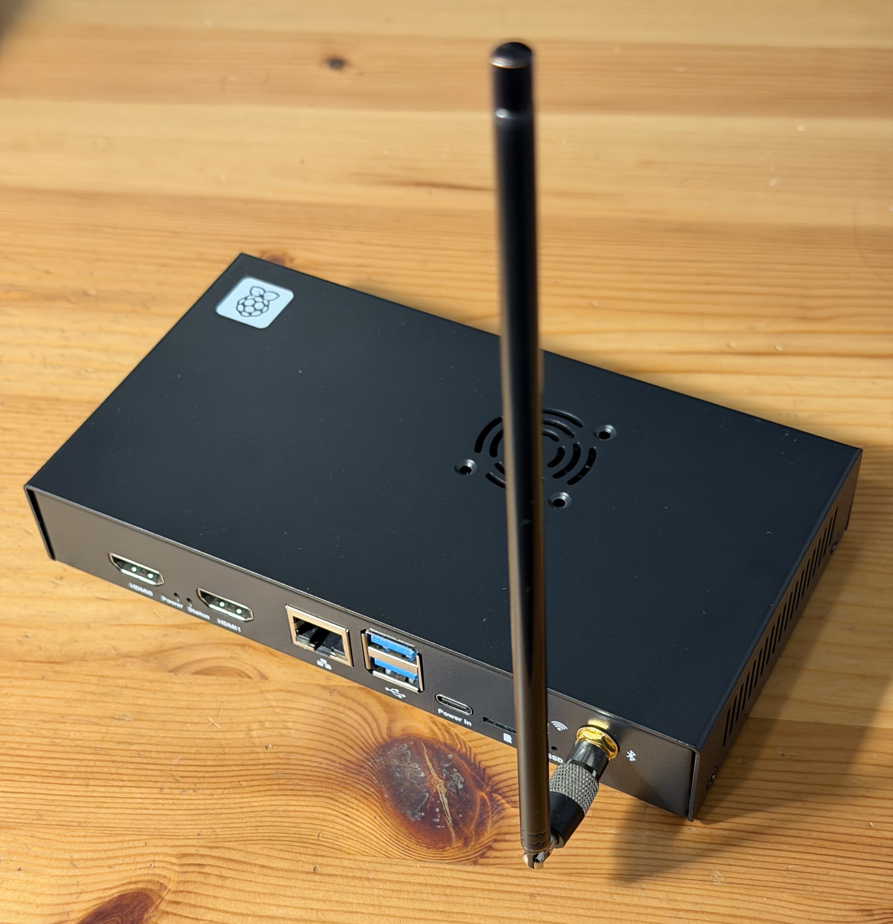

By putting the RTL-SDR inside the case, we can tidy things up a lot:
So how do we accomplish this?

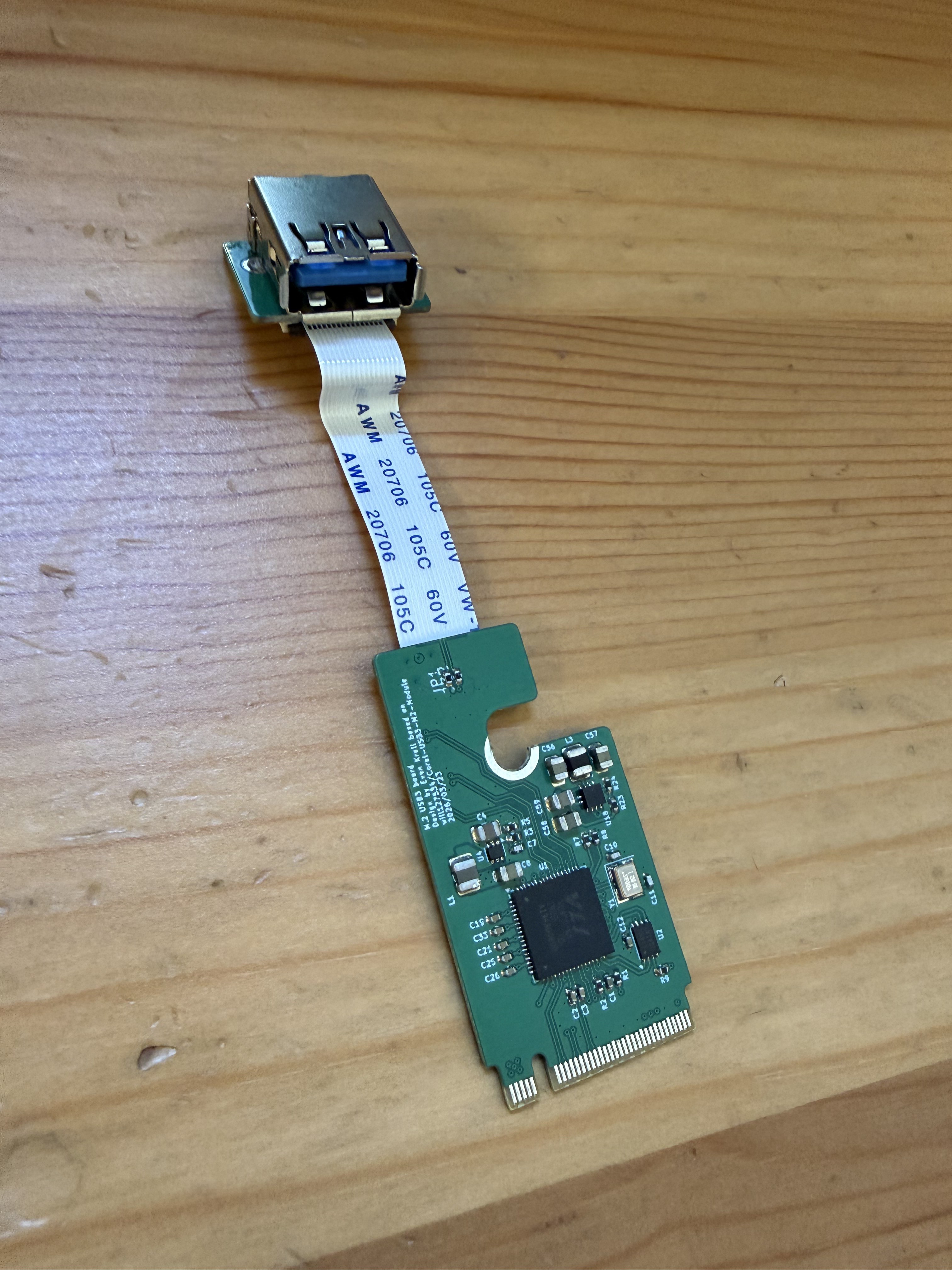

PCIe-USB adapter board
The CM5IO board doesn't provide any USB ports internally. I suppose I could've made a whole new CM5 carrier board with one of the USB ports available internally, but it seemed like less effort to make a PCIe to USB adapter board.
The schematic is mostly copied from Will Whang's Coral M.2 module, but instead of a Coral TPU, I have a USB port.
I made a few changes to Will's design to fit my needs:
  • USB3 port instead of Coral module
  • Added a 5V boost converter for USB power
  • Changed some part numbers for availability
    • I picked passives I already had on hand, and swapped the SPI flash for one that was in stock on DigiKey.
  • The board is designed with mousebites so it can be split into two parts, which are connected via an FFC. (5V, ground, and USB2 D+/D- are routed through the mousebites so you could theoretically use this as a single board; this also lets you order it from JLCPCB without paying for two boards.)
The FFC allows the USB port to be wherever the RTL-SDR wants it to be. This flexibility was important because USB port datasheets don't seem to indicate how deep a USB connector/device will sit when fully seated, so it's hard to know. If I had designed this as a single board, I probably would've had to go through at least one extra iteration on the board design.
My board design files are at https://github.com/EvanKrall/M2-USB3-cm5io.

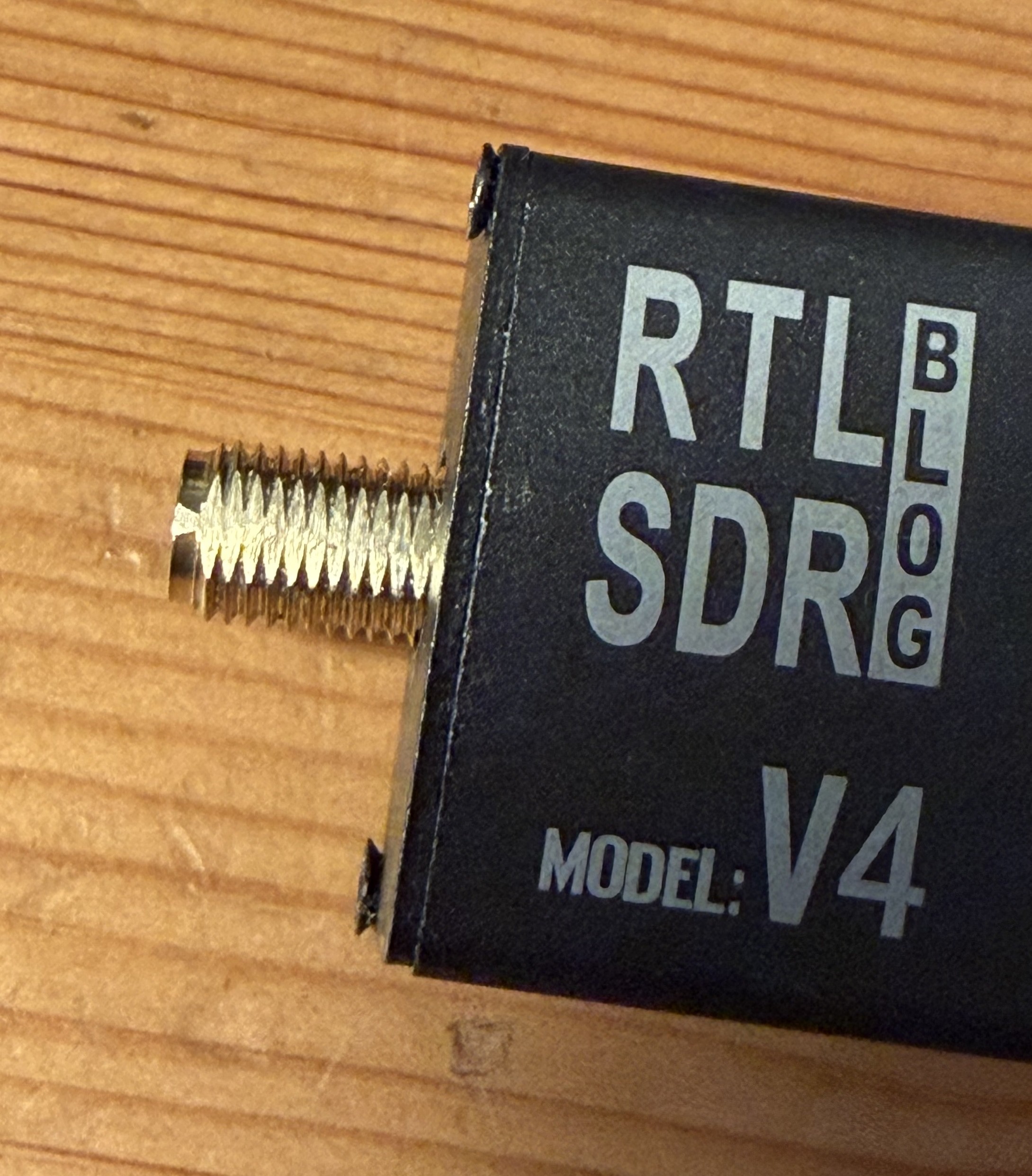

RTL-SDR minor modifications
The antenna hole in the CM5IO case is D-shaped, to fit RP-SMA connectors with a flat side, but the SMA connector on my RTL-SDR.com V4 dongle is round. To get the round peg into the D-shaped hole, I decided to file down the threads on one side of the SMA connector:
This only took a minute or two with a file. Make...
