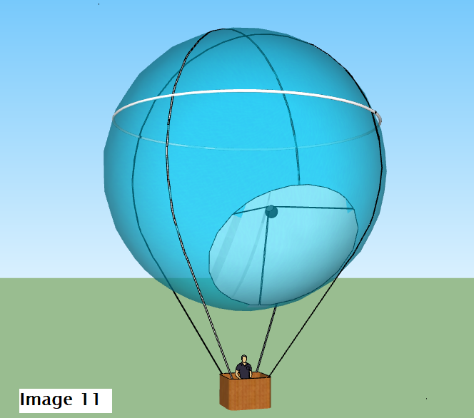

  • The Tropical Ring Update
    Michele Lorenzi05/09/2026 at 21:15 0 comments
    Note: The SketchUp 3D model (Image 11) illustrates the updated harness system.
    Background: Why the Exoskeleton Was Abandoned
    Early designs of NIMBUS included a rigid exoskeleton—a network of structural tubes surrounding the envelope. While functional, the exoskeleton presented serious drawbacks: significant added weight, manufacturing complexity, and structural bulk that worked against the project's core philosophy of simplicity.
    The Tropical Ring Update eliminates the exoskeleton entirely, replacing it with a lighter, more ingenious tendon-driven solution.
    The New System: Two Belts and a Ring
    The core idea is to harness the sphere's own geometry to do the structural work.
    Two continuous belts wrap around the upper hemisphere of the envelope, crossing at the North Pole at 90° to each other. They run downward through a rigid Tropical Ring before anchoring to the four corners of the gondola.
    Why "Tropical"?
    The ring does not sit at the equator. Instead, it sits approximately 20–25° above the widest point (similar to the Tropic of Cancer on a globe).
    This positioning solves a major structural problem:
    • Self-Retaining Geometry: Because the ring is smaller than the sphere's maximum diameter, the curvature prevents it from sliding downward.
    • Zero Bonding: The wider lower hemisphere holds the ring in place naturally—like a ring held on a finger by a knuckle. No brackets or adhesives are required.
    The current material candidate is Aluminum 6061, with a planned upgrade to Carbon Fiber (CFRP) to further reduce mass.

helge wrote 05/26/2026 at 18:52 point
The way this project looks like some LLM spat it out is almost as bad as the fundamentally flawed appraoch at its core.
There's only natural convection inside. Light a candle indoors with no draft and hold your hand directly above it at a distance of 20-30 cm. I'm sure it'll only take you seconds to understand what the problem is.
Michele Lorenzi wrote 05/26/2026 at 22:09 point
Thank you for your comment, you certainly took some time to consider my idea (or the llm's idea), I appreciate it.
