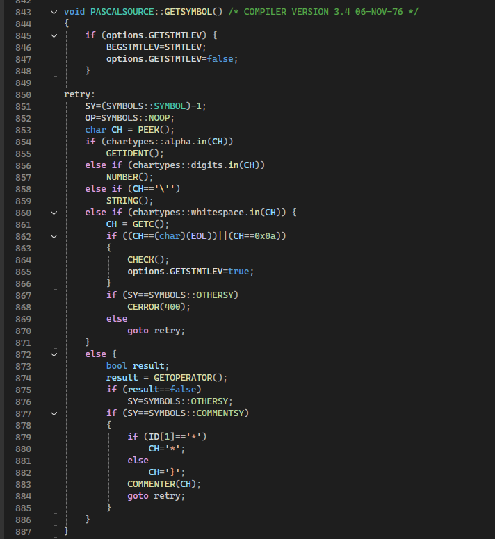

    Likewise, when thinking about tokenizing an input stream, I have an Eliza-based method, as well as a complete rewrite of the UCSD Pascal compiler's INSYMBOL function to choose from.  Maybe.
    This version shamelessly uses the use of goto in C++, but it also makes for a good use of a C++ implementation of Pascal-style sets to check for different character types.  All in good fun.  So you thought that writing a tokenizer is trivial?  Wouldn't it be nice if we could specify something that works like BNF, without having to use LEX or YACC or Regex?
    Be very afraid.

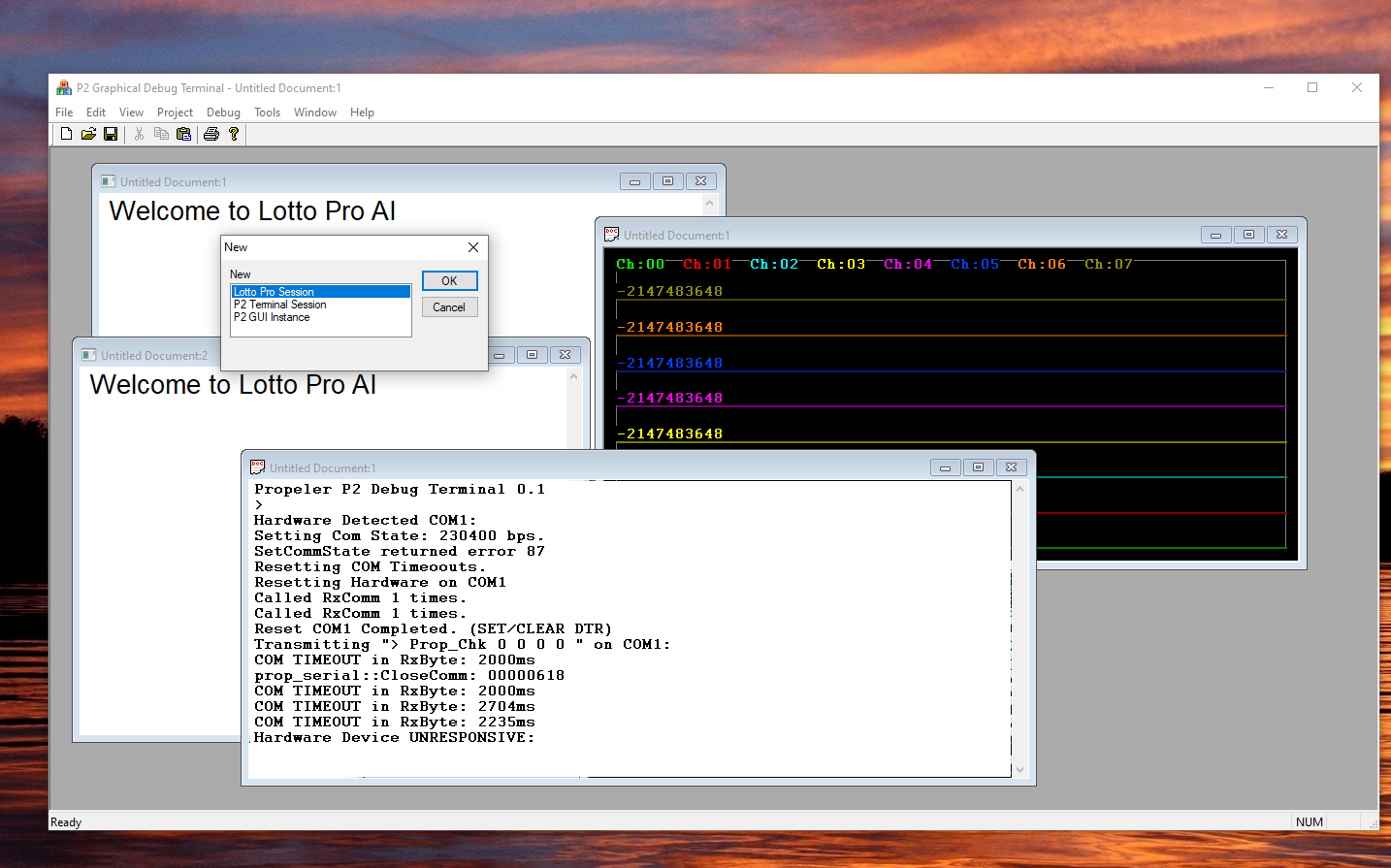

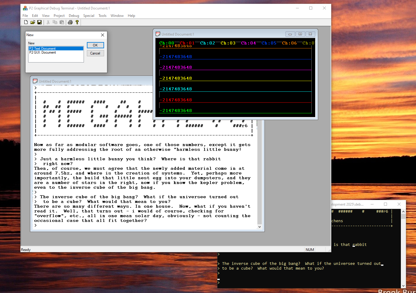

    Well, then again.  There is a version of Propeller Debug Terminal that I wrote back in 2019, which is able to host an instance of Eliza, as well as an instance of Mega Hal.  So, maybe now is a good time to work on also getting it to host an instance of Lotto Pro, when built as a library instead of as a standalone application.
    So that will be the next step then.  Get "Lotto Pro running", as close to as-is as possible, inside Propeller Debug Terminal, that is, as a statically linked library.  Then it will be possible to start the aforementioned complete rewrite of the core of the application, so as to perhaps try to make some kind of collection of "mixture of experts models" that all run in parallel, and which can make use of each other's strengths and weaknesses.

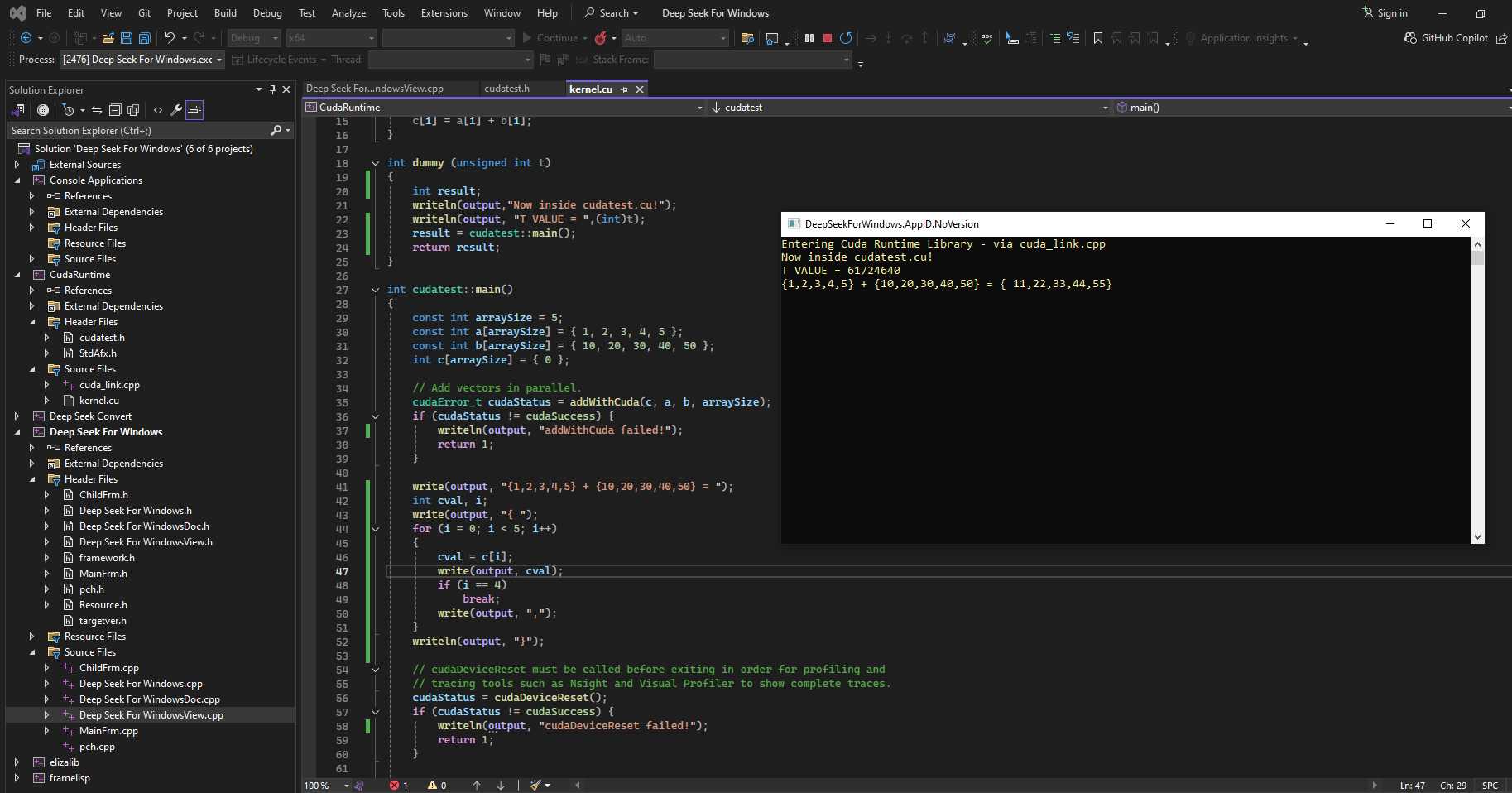

    For a very long time now, like ever since Windows 95, there has been this technology called "Microsoft Foundation Class", and one of the very nice things that is available in MFC is something known as "Document View Architecture".  Which in turn is a VERY nice piece of tech, even to this day.  That is, when you can get it to do whatever it is that it is supposed to do.  Unfortunately, in practice, that often requires a minefield of tricks...
  • Not sure yet: "Whether I am going to need bigger boat."

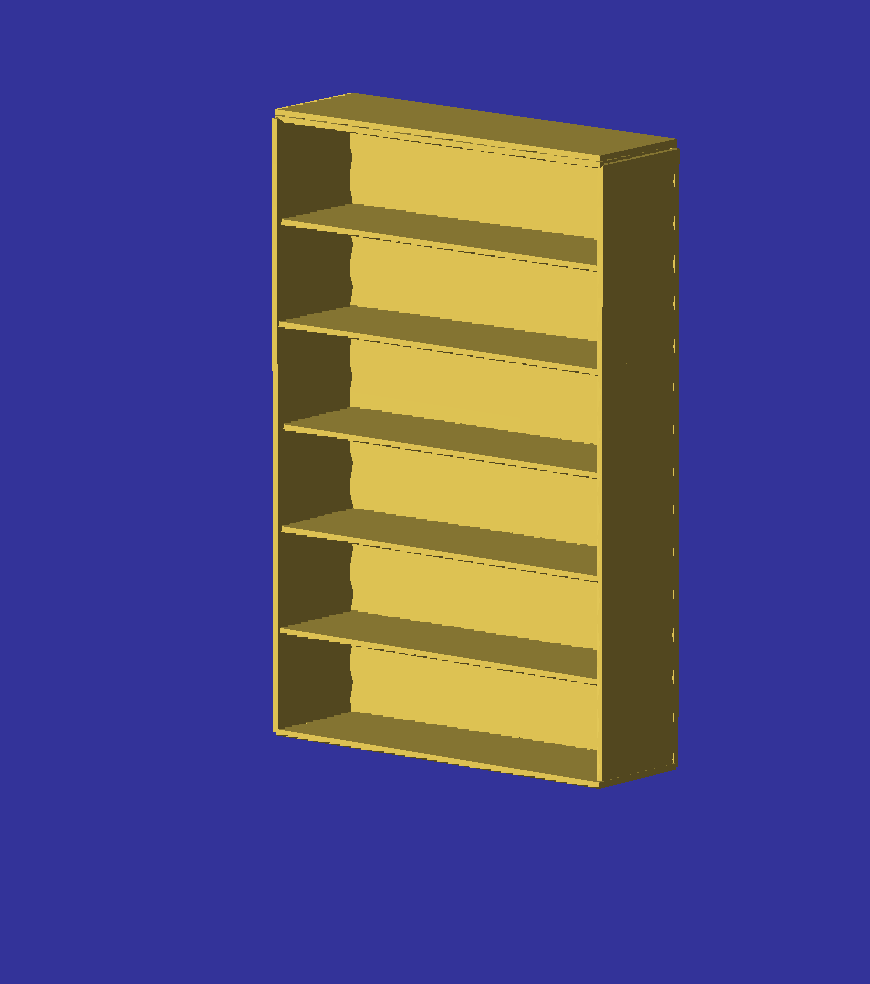

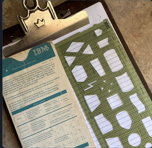

    Or perhaps a bookshelf.
    Well, anyway.  It has been a while since I started a new log entry.  At least I have a catchy title for this one.  Now I think it is time to get busy with some serious project integration.  Elsewhere, I have suggested that this project is actually something like 20 or maybe more projects, all of which need to be brought together into a cohesive whole.  So perhaps the best way to go forward is to take an inventory of all that has been accomplished so far.  Make a list.  Check it twice.  Chase down some of the naughtier issues that need to be addressed, as well as showcasing some of the nicer things that can be done within the current framework.  Then spool up another homegrown AI that will be trained, of course, on every article that I have ever written for Hackaday, so that I can have yet another conversation with it, as if to ask, "Where do we go from here?"

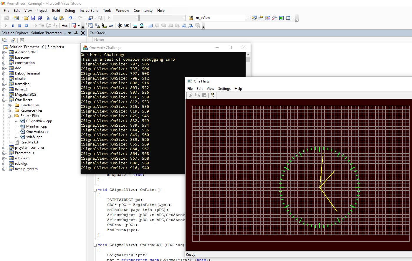

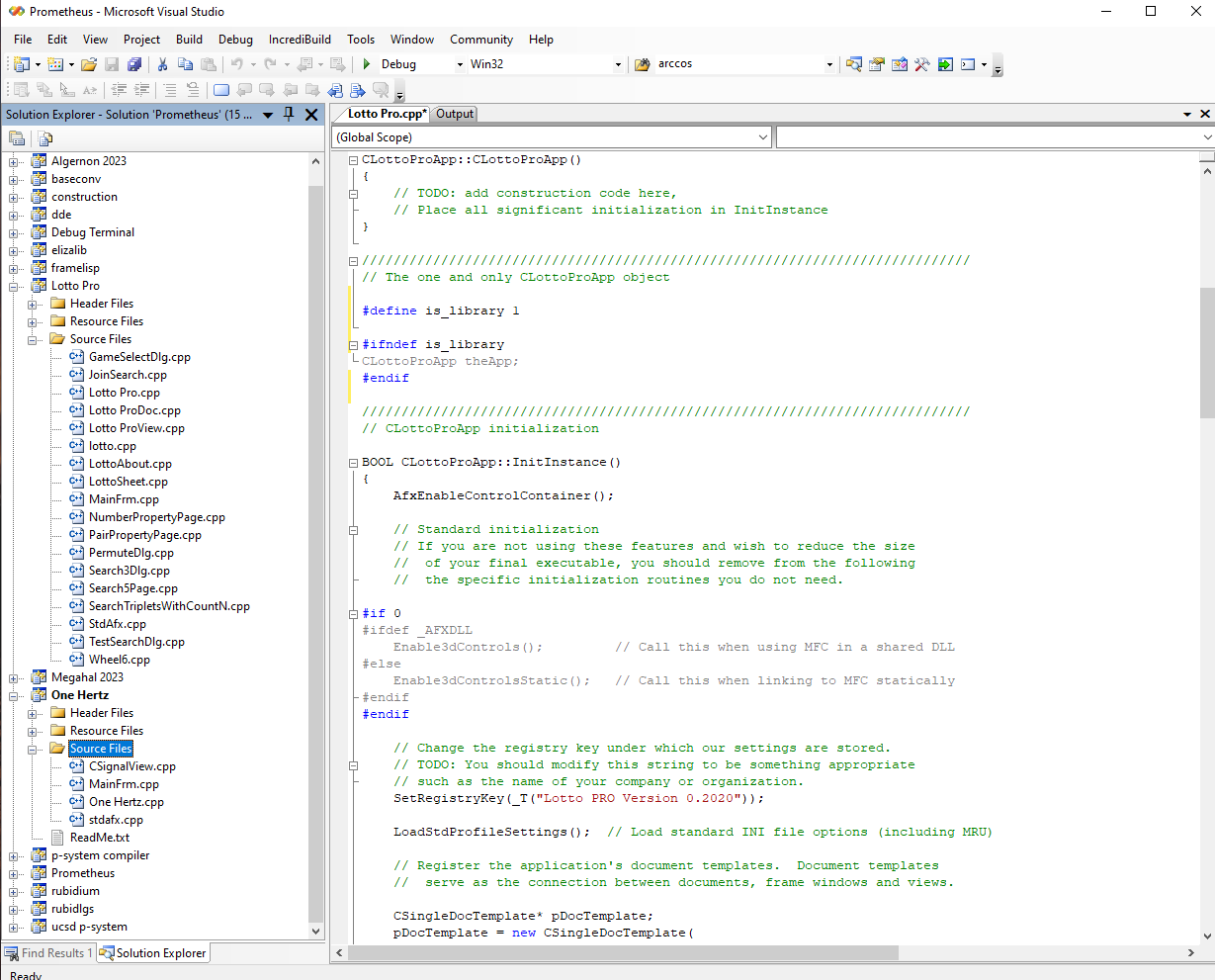

    Just looking at the code base that went into creating an entry for the "One Hertz Challenge" reveals the magnitude of the problem.
    Yet, as long as vibe coding is the new meme, how hard should it be to integrate all of that, along with the "world model" stuff, into an LLM, perhaps by using some of recently available online tools to rewrite all of this?  Or else, there is yet another question that needs to be addressed, and that is "whether any of the latest development tools can handle project integration?"
    That is, if nearly all of the heavy lifting has been done.  The next step, therefore, is simply, dead simple, so crazy simple that it will drive a whole bunch of DIY types crazy, when they realize what they have been missing out on, all of this time.  Let's take the code base for the program "Lotto Pro" that I was talking about earlier, at the beginning of this project.  The one that looks at pairs and pairs of pairs of numbers and their respective probabilities in Lotto-type games.  Yes, that one.  Let's turn that from an application that is Lotto-specific into a library that works with many different types of data.  Don't worry.  Eventually, source code will be provided, but for now, just enjoy the ride.  Just in case you want to make your own LLM+AI aware version of DOOM, this is where you are going to start.  LIke this:

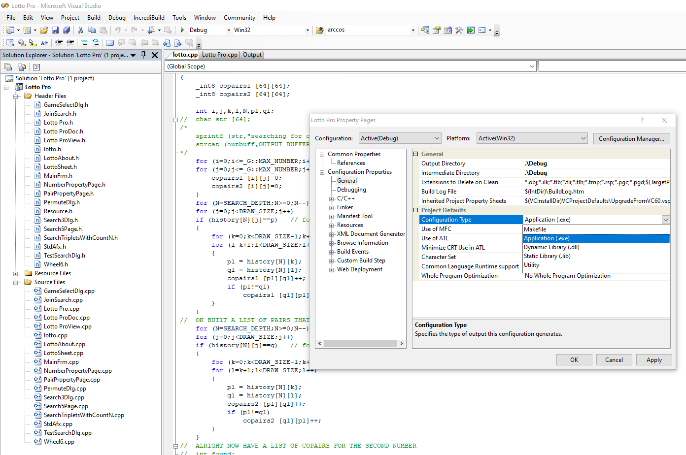

    In pretty much any version of Visual Studio, you will find a project properties menu, and what you want to do is navigate from the "General Project Defaults" list to the "Configuration Type", where you will want to select whatever it is that you now want instead, whether that is an application, static library, DLL, or whatever.  So, let's select "static library" for now.  Then, just to see what happens, we compile it, and get something like this:

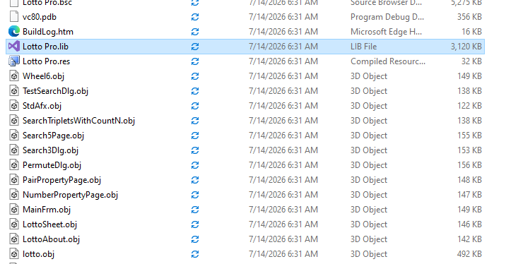

    Now we have something.  The same thing that we had earlier, only different.  An old project that can be dropped into another larger project that allows us to build applications like the previously mentioned "One Hertz Challenge" project.  It is of course, where it can get really weird, really fast.  Creating workspaces that turn dozens of projects that were originally created as standalone applications into libraries, that might later be turned into ActiveX controls under Windows, or DLL's, or perhaps they might get ported to Type-Script or another language for use as browser add-ons.
    Remember: A 1000-mile journey begins with a single step, and a 100,000 line project begins with a single idea and a few lines of code. But in the meantime, here is one little tidbit, to help indicate the direction that this project is headed.
    Pretty simple, at first blush.  Take the old application.  Change the project type from application to "static library", then add the "new" library project to the existing workspace used to develop the codebase for the "One Hertz Challenge", as previously stated.  Then the fun begins.  Lots of...

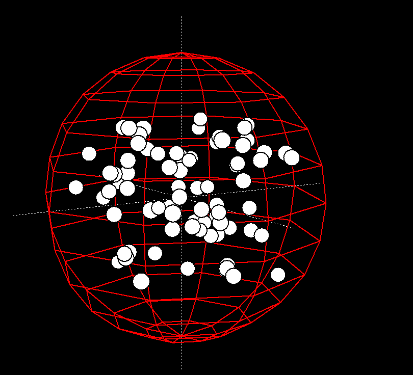

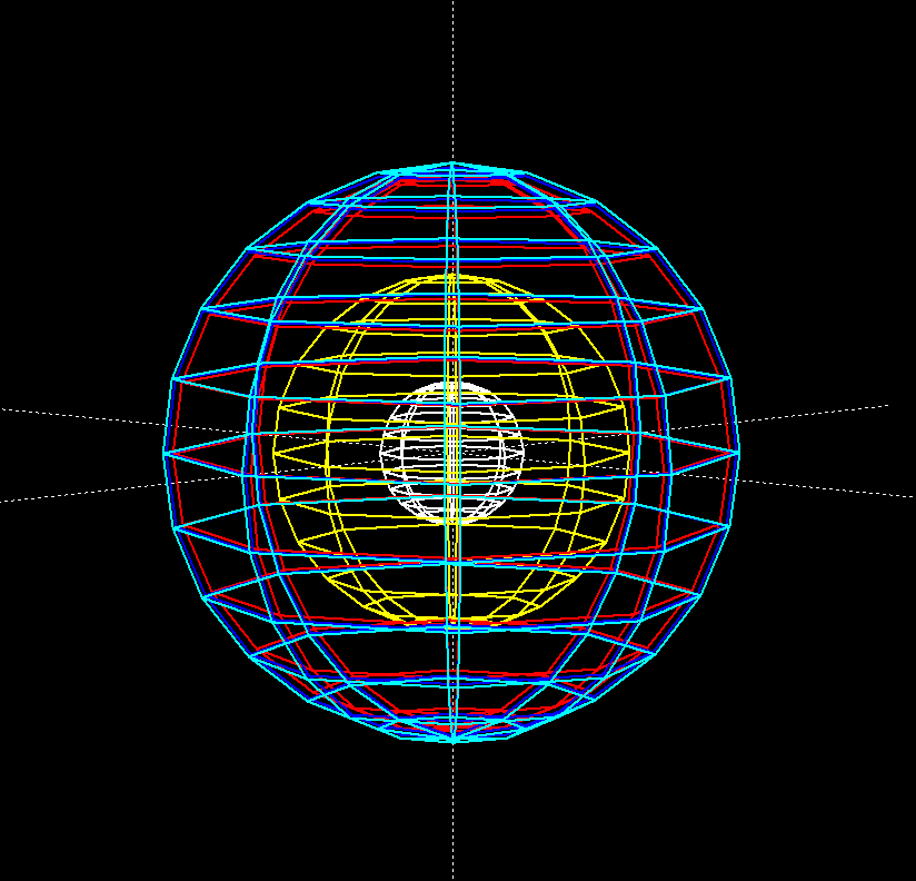

    So now I have this idea, which I have had for a while, actually, and a plan seems to be coming to fruition as to an interesting approach to text generation, chain of reasoning, and all of that.  Really, it seems pretty simple.  Maybe as simple as this:  Well, almost.  This, I mean:
    Of course, we could put some simple spheres inside a sphere, and let them bounce around, as if to simulate the kinetic theory of gases, or else we could simulate a Lotto-type game.   Or we could imagine replacing the sphere with a human brain, and imagine a way of modelling random neurons firing, and perhaps even tracing out the path that some of the sodium and potassium ions might be taking, or else we might want to think in terms of specific ganglionic structures, and how the flow of different neurotransmitter substances might affect things. Really, it is all just physics.  Or is it?
    Not that things might not get a little bumpy, of course, if we wanted to model something else, perhaps with nearly exactly the same code.  Like when we decide to put a sphere inside a sphere, which might be inside another sphere, and so on.  Setting the stage perhaps for other such fun things as "thermonuclear initiation", or maybe just "plate tectonics".
    But that is not where this train is headed.  Yet.  Or else, maybe in the brain we might have the hippocampus, and the cerebellum, and a bunch of other hierarchically connected, as well as "otherwise connected" structures.  Yet one approach is still to take the Lottery simulation and subdivide a three-dimensional space into a collection of interconnected realms, which would, of course, allow multiple simulations to run in parallel, on the one hand, while at the same time providing some completely general methods for partitioning.

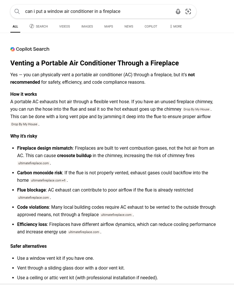

    So maybe I need to change the subject.  Let's look at a real-world problem, along with a possible application for AI in order to solve it.  Let us consider the utility, therefore of the "kinetic theory of gases" and its application to a potentially very simple, and hopefully not dangerous problem, such as "Can I put a window air conditioner in a fireplace?"
    As I said earlier, hold on, it is going to be a bumpy ride!  I do, after all have an ever increasing list of AI blunders, of varying degrees of severity or seriousness.  Now what is happening here should be obvious.  The AI in this case, I think, is suffering from a form of near-sightedness, and it is actually a particularly dangerous one, or could be, whether in this situation or not, but definitely in other...
