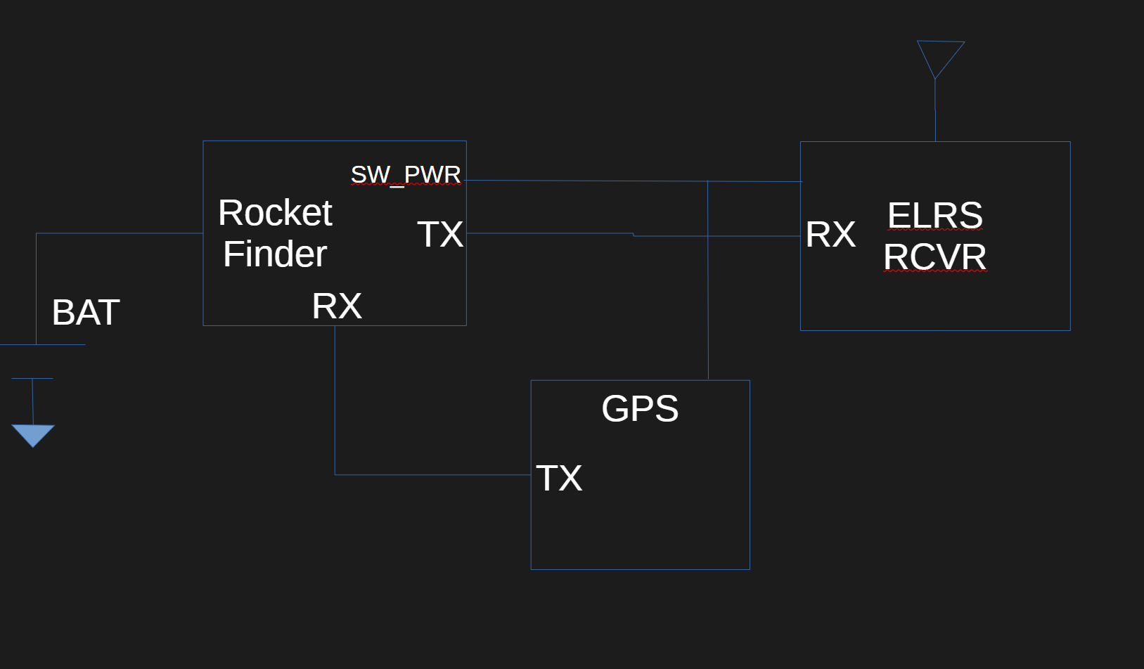

System Diagram:
There are only 3 or 4 components: The Finder, the ELRS receiver, the optional GPS module and a battery for power.
There is a hall effect switch on the Finder that arms it when a magnet is place nearby. It then supplies power to the receiver and GPS. It also emits a short beep every five seconds to confirm that it is armed and also help in locating it when the user is close enough to hear it. The GPS uses a UART to transmit its data in UMEA format, at 9600 baud, to the Finder, which decodes it and re transmits the GPS data, in ELRS or CRSF format, to the ELRS receiver that transmits it over its telemetry link. The GPS is configured to only send one message at a 5Hz rate. The message information includes Lat/Long, Altitude and number of satellites.
The user gets a display of the GPS coordinates and altitude on his handset. It might be possible to record the maximum altitude of the rocket. After the flight the user can use the GPS coordinates to lead them to the rocket/finder which is still beeping every 5 seconds. Once the user recovers the rocket the Finder can be disarmed by placing the magnet near the Finder, which gives a confirming set of beeps and goes to sleep with very low current drain.

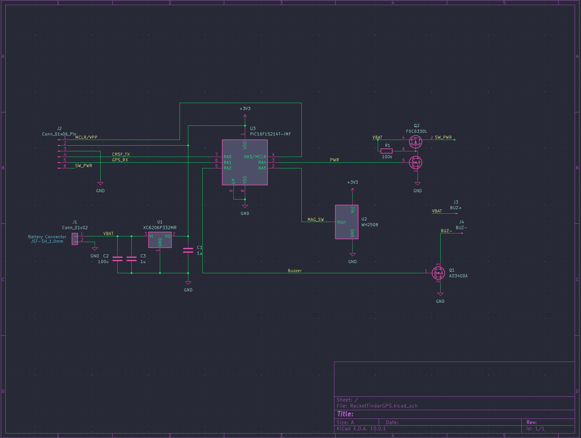

Schematic:
The micro-controller is a PIC16F15214 in a UDF8 package. It is internally clocked at 32MHz. The PIC has only one MSSP serial communication module, which is used to talk to the receiver at 430 kbaud. The UART signal to the GPS is much slower at 9600 baud so it is big-banged. The PIC is inexpensive -- about $0.5/each in low quantity. Programming the PIC is accomplished via the 6-pin JST-SH connector, which also is used to connect the ELRS receiver and GPS module to the Finder.
The hall-effect switch has hysteresis for debouncing and draws little current. And it's cheap, or at least it was in the time of no tariffs.
The FDC6330 load switch provides battery power to the receiver and GPS. Note that there is only 1 resistor on this schematic --...
